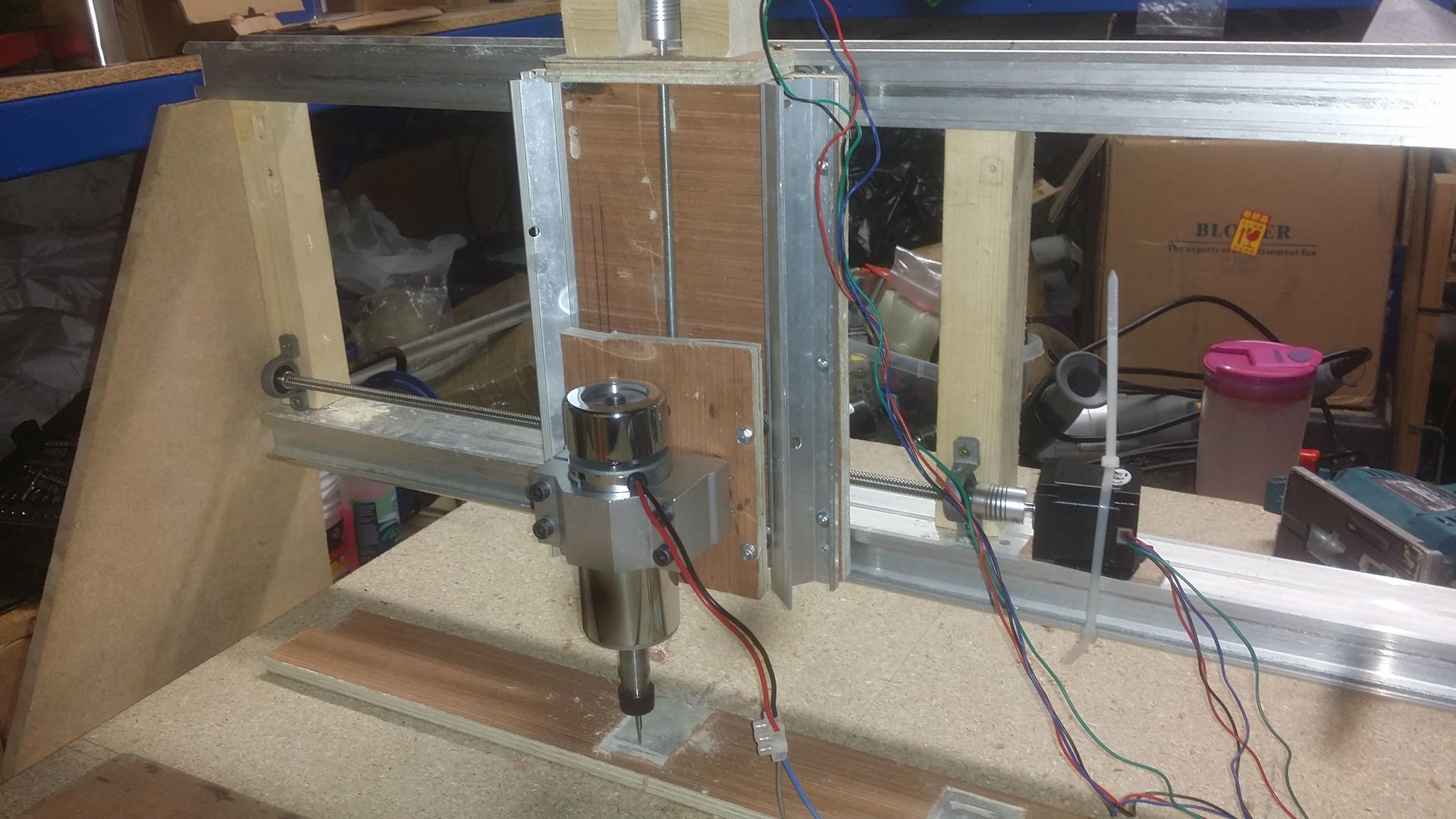

Most people would rather build a good cnc machine, rather than a cheap one.
And the ones that start out building a cheap machine, then go on to build a good one, when they see the limitations of the cheap one.
You get what you pay for.....
Re: Hi, I'm working on Cheap CNC
I don't know how you come up with a £900 ish price, but just the VFD and the spindle motor costs at least £300 or around that. Add driver electronics, three steppers, a PSU and that's another £300 ish, and you still not even have a single meter cable, motion controller is another £100-150 ish (unless you want to run parallel port in 2017...). I haven't even mentioned any building material yet. A machine that huge demands quite a lot of material for the frame, even if you make it a weak and light one, it will cost more than £300, unless you have some supplier who can give you material for free. What about software? Are you planning on buying one or plan to download/use a pirated Mach3? Buying a Mach3 license costs also about £150 (haven't checked lately, so it can be more), but you can of course buy UCCNC for about £50, assuming you buy their motion controller for another £100... ;) What about the linear rails? Those are pretty expensive as well, even if you buy cheap eBay quality, it will cost you another £300 ish, at least.
Another thing is that chain driven CNC may not be the best when it comes to precision, and also the movements will be very noisy. If you don't want to use direct driven screws than you should at least go for belt drive. Those are much better and also quieter, though I don't know, maybe more expensive as well.
So, my advice is if £900 is the budget limit then don't start, or make a very small one just to learn. For a machine with 900x900 table you must be prepared to spend at least twice that amount, and I think even that is optimistic.

I started my build with the tiniest bit of knowledge (which can be extremely dangerous :wink:) about CNC, after much research, and discussion on here, I came to the conclusion that to get a half decent CNC Router you need £1,500 (mine currently stands at £3k or just over) absolute minimum, and that's begging, borrowing (I'll not advocate stealing!!) materials to build the frame, wiring etc.
With this i know that for £20 i can get 6m of equal angle mild steel at 3 or 4mm thickness.
This is made straight and is strong combined with V Groove bearing with a 2.5mm Drop (groove) should work as the roller bed worked in the car garage i once worked in.
It might work for a garage door (or whatever) but believe me it's not straight, flat or even 90°. It won't give you any sort of accuracy without any sort of machining.

What steppers? What Ampage for the drivers, what drivers?
At the end of the day you can throw a CNC Router together using a cheap 3 axis board, cheap steppers, V bearings and unmachined steel and it will cut wood, however it will be slow and innacurate and if you're trying to do anything which necessitates a decent fit between parts then it will be frustrating.
If you're serious about CNC then read all the build logs and then ask yourself what you're expecting to do with the machine. Start a build thread laying out exactly what you want (materials, i.e. size, soft wood/hard wood/aluminium etc.) to cut/make, post up a sketch of what you're proposing and we'll tell you if you're on the right track and point you in the right direction. You might get a few very blunt answers but it's all part of the banter that goes on in this forum!!

Yea bro,got me a build thread. I'm not Normal I'm a wingitoutsidetheboxman aka Crazy.
It's served me well not going to technical with any of my creations,project or ideas.
So far i have a UGLY reasonably accurate machine,
Attachment 20691
lots of tweaking to do.
Using some 17's 1Amp with the most newton force i could find.
For the reason of them being cheaper than the larger size and i need to see it work to understand it (how my head works).Upgrades will come later better stepper drivers and motors.
I'm currently using some ball screws, as never wanted to use belt but wanted to use chain but hard to find sizes i wanted for the 17's.
Currently cutting 12mm Ply for testing.
Will be upgrading my machine as I go.
As for danger YES it's always good to mention it! But i'm quite aware that a computer guided ROUTER doesn't care if its wood or a HAND! But for those who aren't A ROUTER guided by a motor Will Not Stop if hits your soft easy to chew hand/finger or other body part. LOL
I'm cool with harsh if you state why (no point being a dick), BANTER is all good fun and welcomed.
