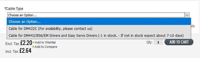

I have a quick question which lead do I need from Zapp?
Attachment 22851
Re: AM882 software ProTuner & windows 8.1
I think the second one. Just give Garry a quick ring at Zapp.

I already tried that and they didn't seem to know but have emailed tech support at leadshire so hopefully will get an answer Monday as they've all gone home now in China.
I couldn't see a pinout in the manual otherwise I'd just hack a cable together but the price of the cable from zapp is cheap enough the delivery will be considerably more lol. I have accessed for the pinout if they respond I'll have a goat making my own and post the results ;)
