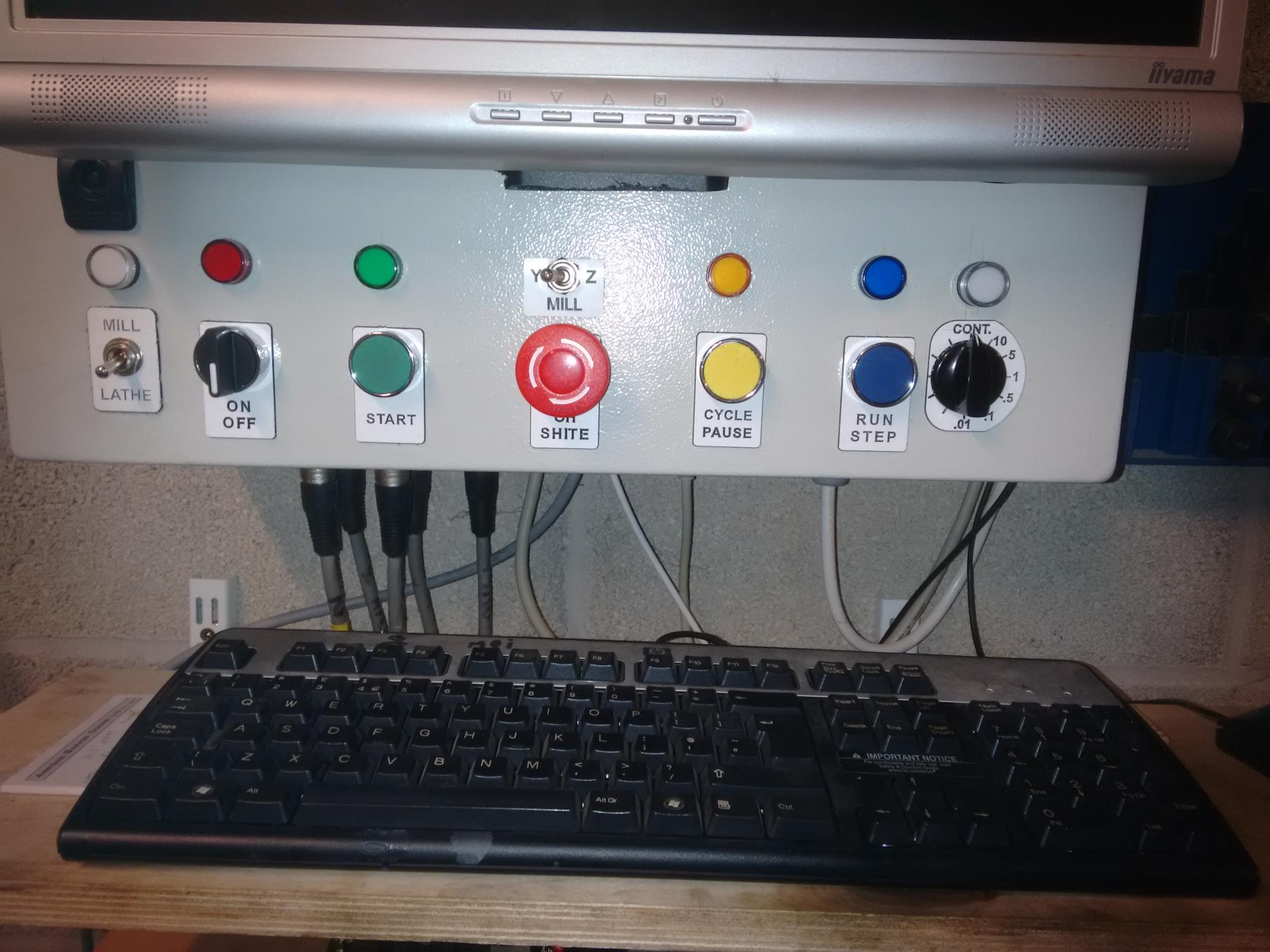

With the 7i76 and 7i76E there are about 34 input and outputs with 5 axis two mpg's and spindle control encoder for threading A & B + index.
So I have both lathe and mill wired to the card and use the two mpg to do both.
I just select which config I want ie just one at a time.
I used to use the lathe from the PP with just a 100 slot disc plus index pulse and it was fine for threading.
PP has 5 inputs two were required for the encoder one for the O'shite button and two spare (could be z and x home)
Attachment 20851

Loving the "O'shite" button, might have to get a few of them. Didn't think of running both from one card, would be good for testing to make sure it works ok. ultimately I would probably need both machines running at the same time.Quote:
