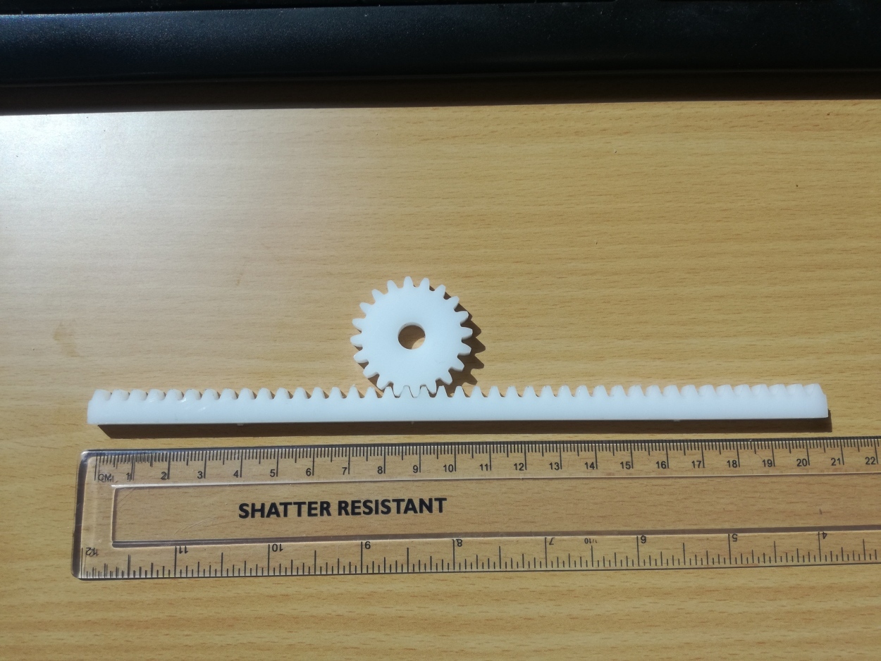

I had a little play with R&P a couple of months ago whilst looking at all sorts of possibilities for making a small router. Have a look here it's a good place to design your own gears as they output the result as a DXF or DWG (can't remember which now!!)
Below is a small one I cut out of 6mm thick Acetal as a trial, I think with a 2mm end mill.
Attachment 21417
Re: Workshop made Acetal / DELRIN Rack & Pinion
That's a good site thank you and your test looks good.
I ran a few this morning and think it will work well, I'm planning on using commercial metal gears on acetal rack, should be relatively low noise as well.
