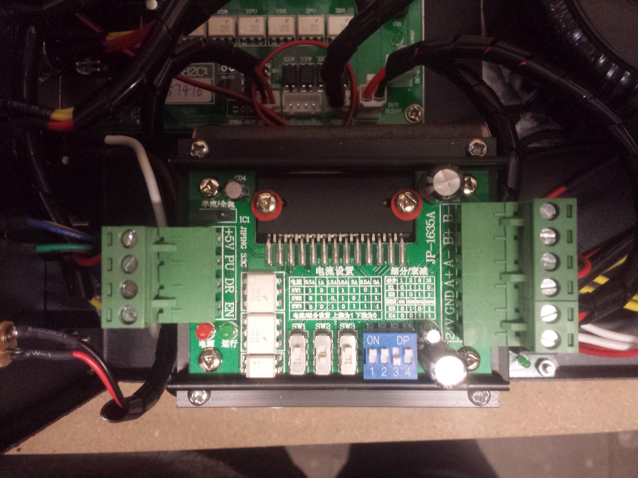

		7 Attachment(s)

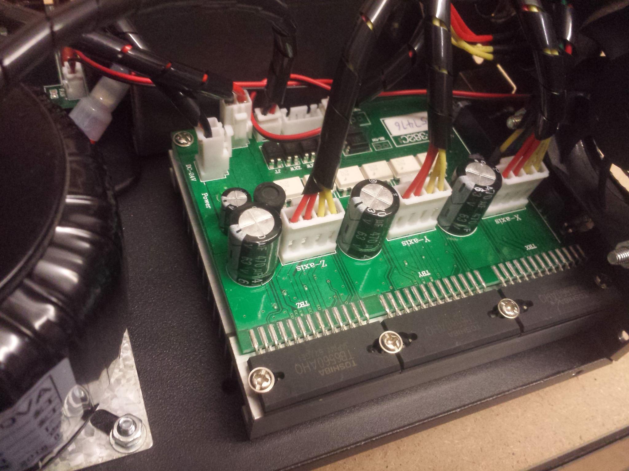

		9 Attachment(s)

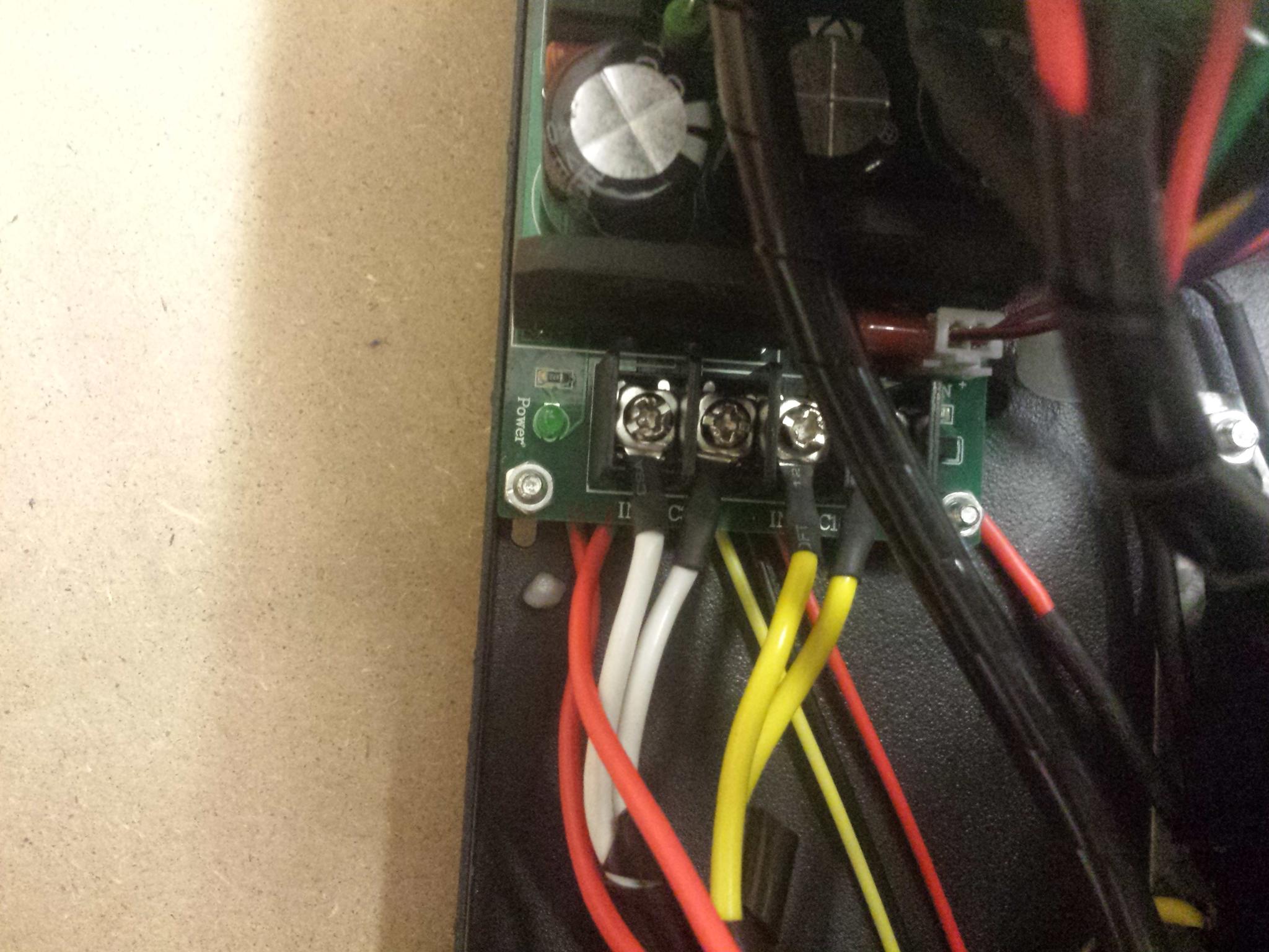

		8 Attachment(s)

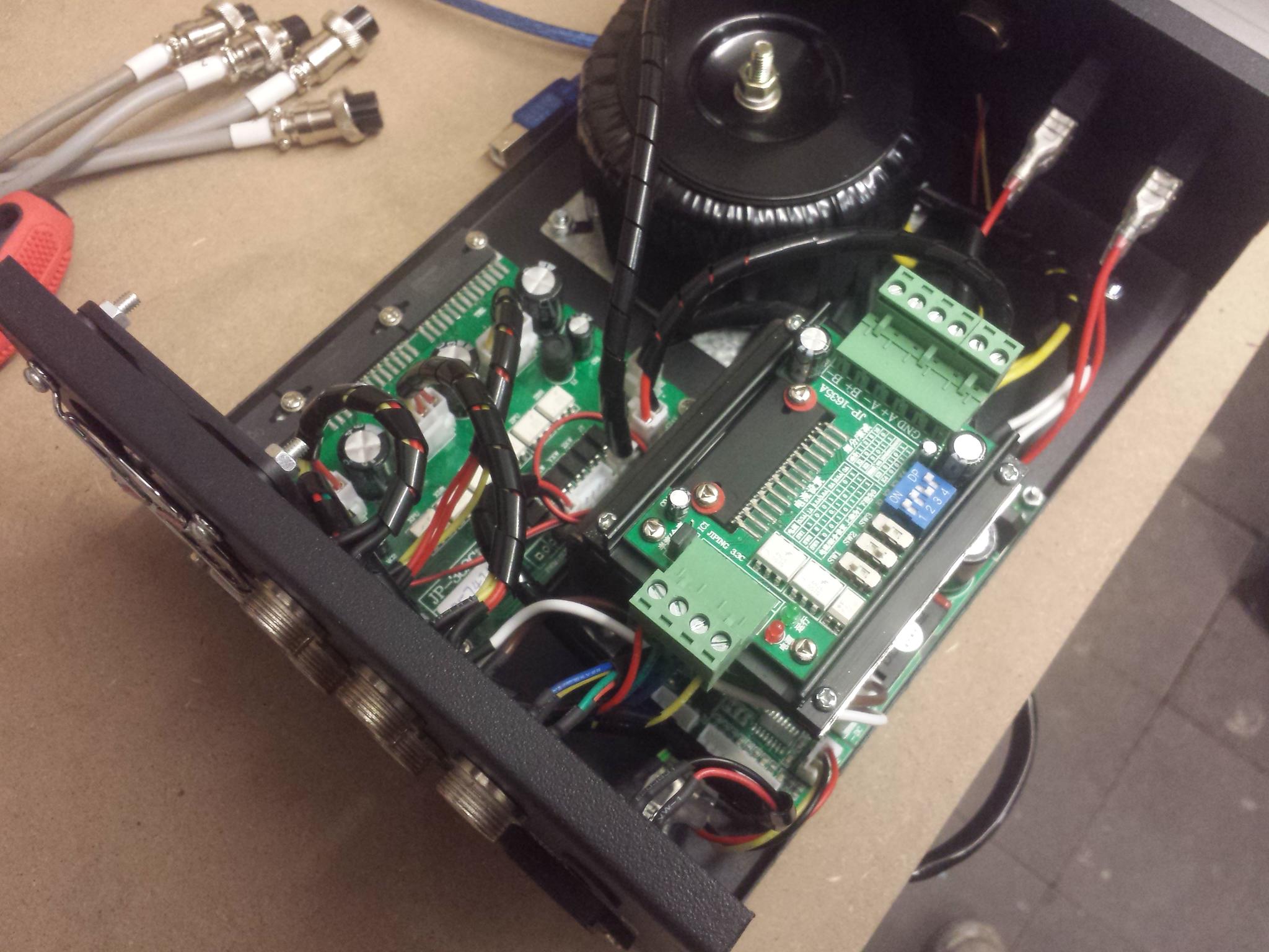

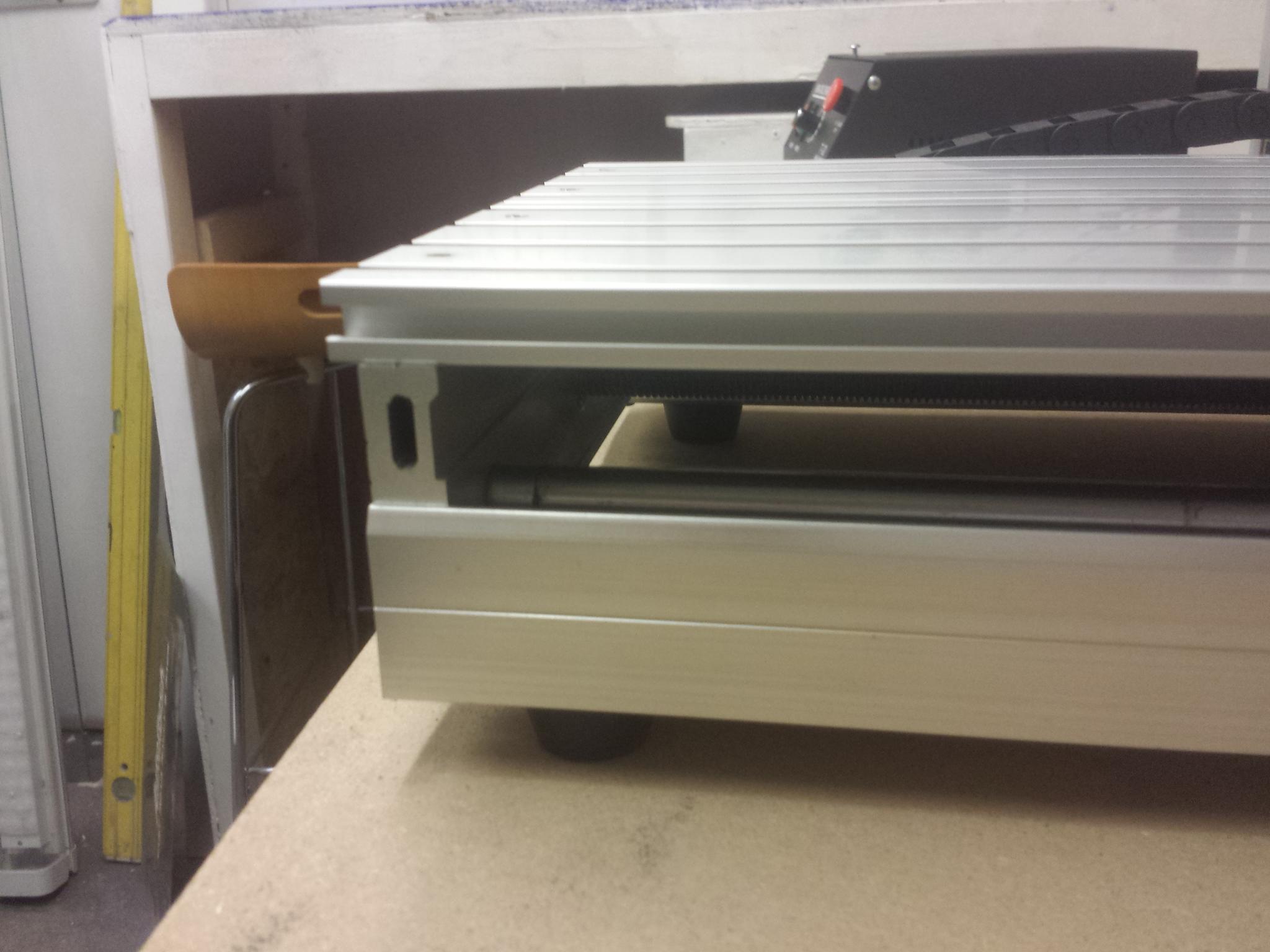

		I cant see any micro switches so I have ordered some of ebay.  I have also paid for the license for the planet usc controller registration which has arrived this morning :-)
There is also slight play in the z axis but this can be fixed by installing a washer
