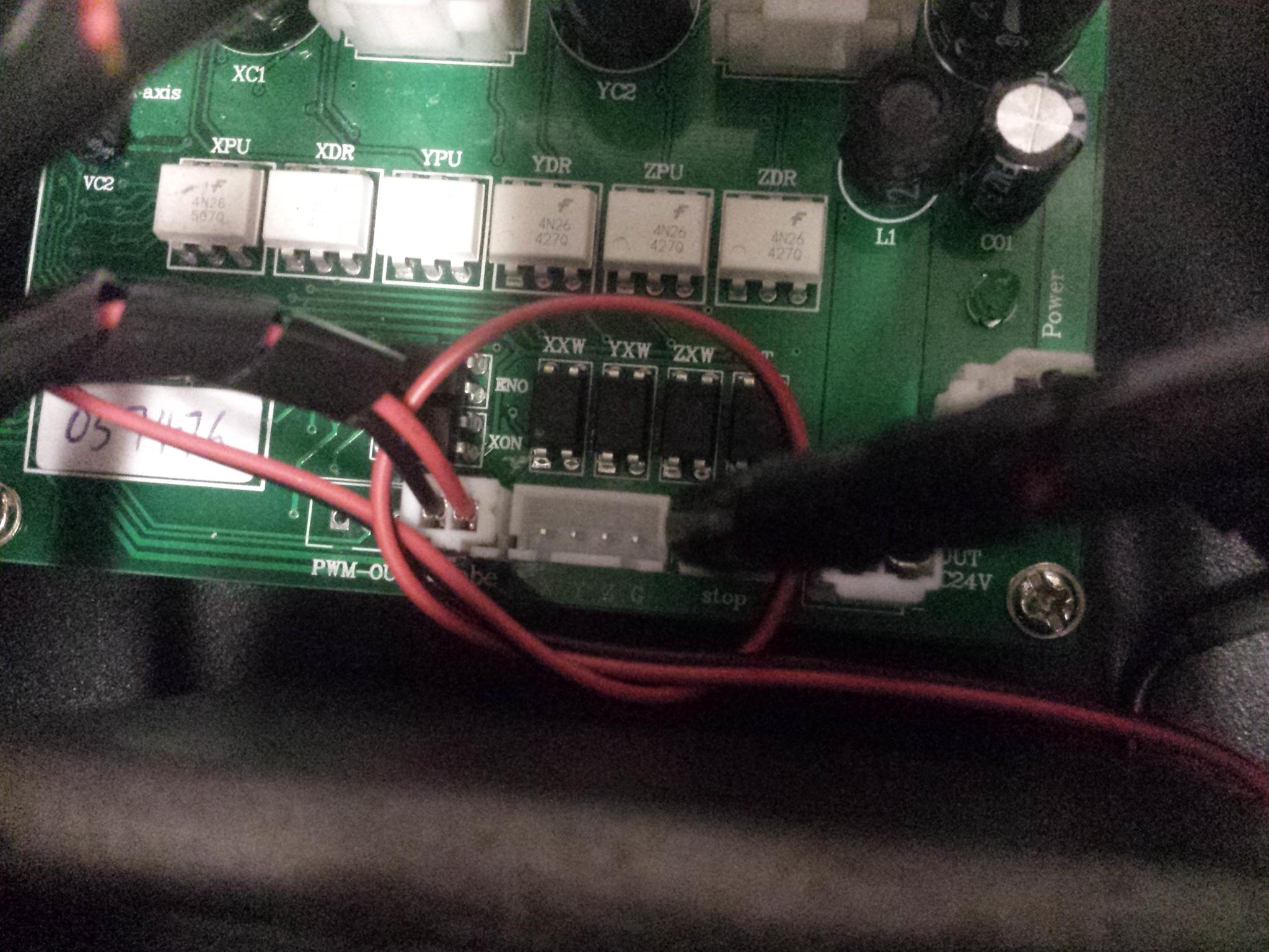

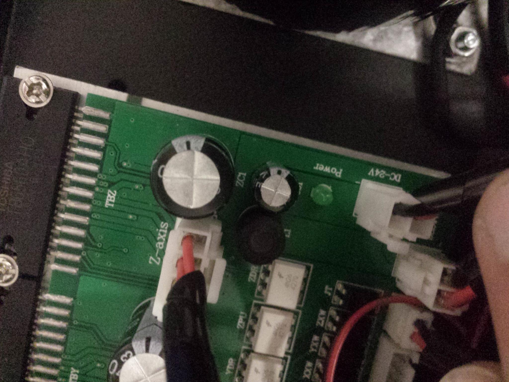

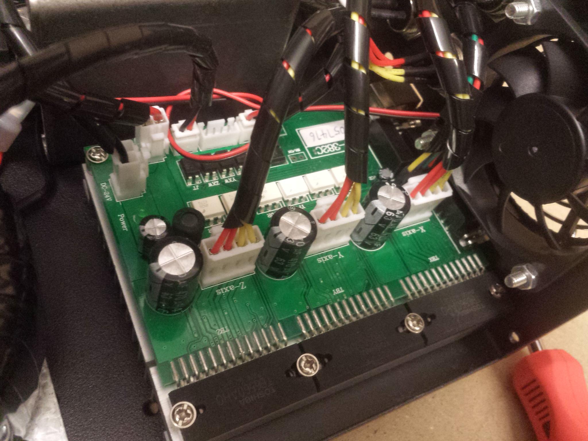

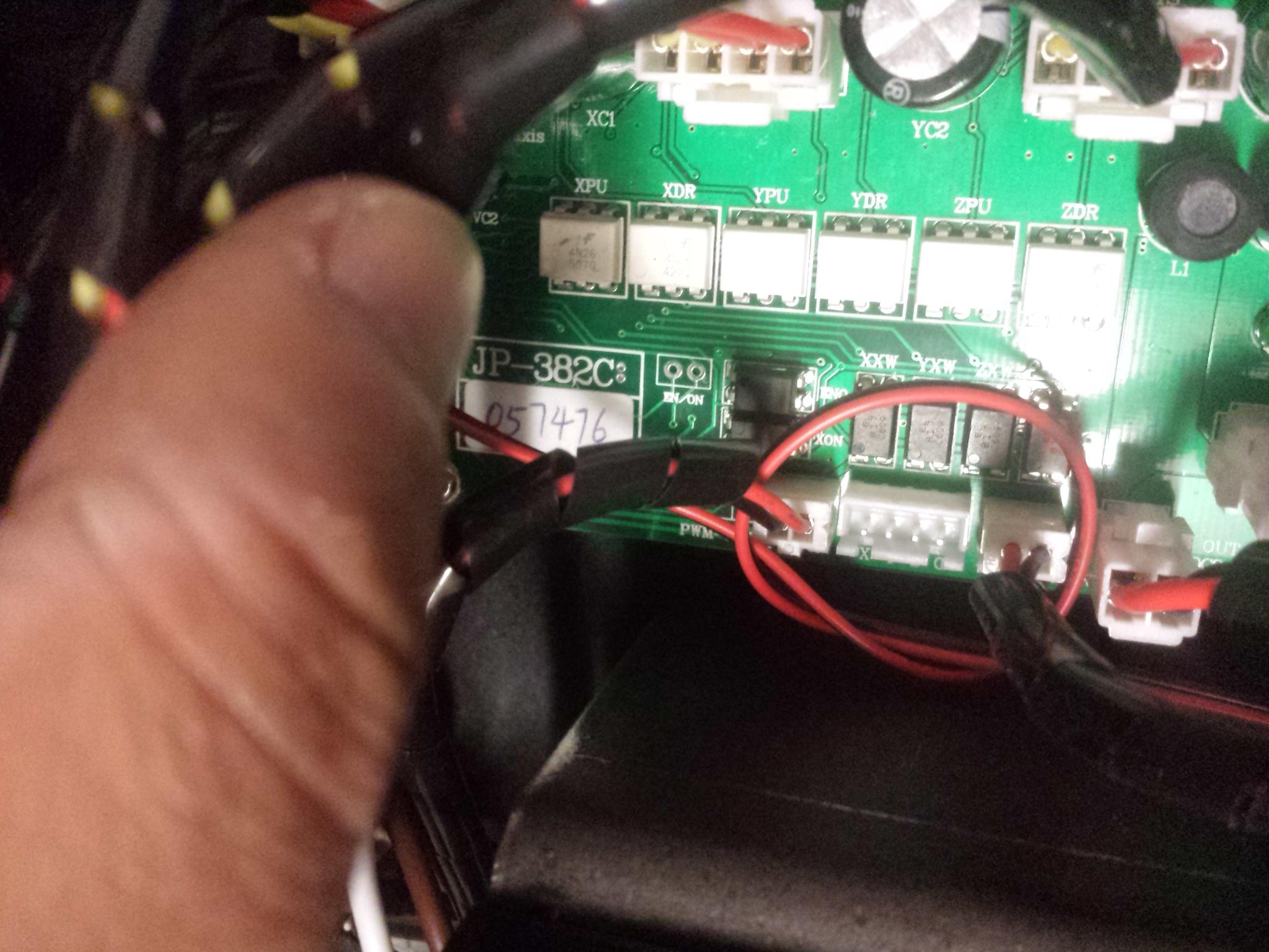

Well been trying to get the machine to work only to find that there is something seriously amiss with it. Firstly the emergency stop button does absolutely nothing when pressed.
Secondly the x axis isnt working properly. It spins the motor for a second then stops, but the illustration on the screen is still moving.
A few people have said that this is a cheap planet cnc copy and that they are basically crap. I have spoken to planet cnc and they have said it is hit and miss if these controllers work or not, they have recommended buying one of their control boxes.
Has anyone had any experience with these? Are they any good? Cost 550e so it more than i paid for the whole machine but if its worth it then I will get one.

That said check you're wiring I bet there's nothing that wrong with the electronics just dodgy connections.
Get that box with the electronics open and get some photo's from inside.

I wonder if the stepper driver for the X axis is turned up too high, there's a pot to adjust the current to the driver on the board inside the metal box. When you're trying to only move the X it overloads the motor but when you use X&Y together the power supply can't supply enough current to over load the X.
If there is a pot you must be very careful when you adjust it if you use a metal screwdriver otherwise you can short something out but it's really very easy and nothing to be scared of.

It could be anything from the crappy plugs at the back, broken signal cable to faulty driver.
Be patient inquisitive and buy yourself a multi meter to check continuity.
1. Open the box and ensure all connections are connected right. Especially DIR and STEP signals to the drive
2. Ensure all is soldered well and plugs especially
3. Swap cables and make sure that the cable is OK. Check motor and the cable to motor connection.
4. read particular motor driver documentation and see if some adjustment there is not wrong.
Anyway, if are persistent you will find the problem and demonstrate it to them. So no need of sending anything back.
There are not so many things that could go wrong, so just take your time. Its board, cable to drive, drive, cable to motor. Thats it. One of these is wrong.

Right chaps, im down the workshop armed with a multi meter. Can you direct me on what to do now lol
Re: New machine has knackered control box :-( Need a new one
There is something defo wrong with this board, Ive tried other cables etc and same result. Had the multimeter out and found the following out.
when you apply a jog to the y axis, all 4 pins outs (2 yellow and 2 red) rise to 12.9v and hold
When you do the x it rises to 13 then nothing except one stays on 26???
So I think this was the problem with my box.
Attachment 22019
I have decided to take the plunge and give up with this control box, as much as everyone have been helpful I'm just so out of my comfort zone with my lack of knowledge, it is easier to just buy a pre-spec'd box and assemble myself. I have no problem what so ever putting things together, its just going to take a bit of time learning what each part of a box/cnc setup does, going to be a steep learning curve but a fun one.
