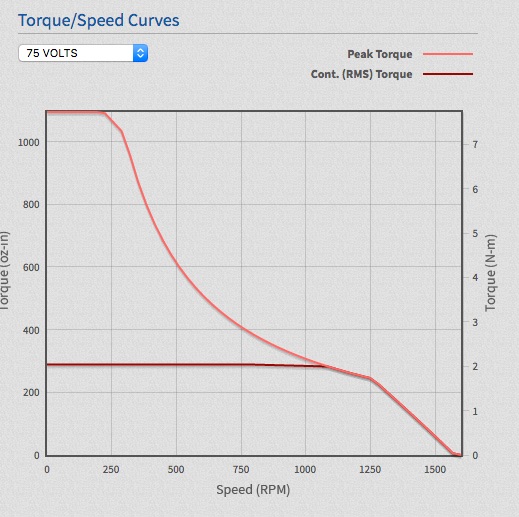

In the longer term I still favour going all-out for servos. Those Teknic Clearpath things look very impressive. If confidence in Sterling would just improve a little I'd be tempted to order.

The Clear tecknic servos do seem good, however you have to remember as they need the step/dir signal directly, it adds in a lot of extra potential for interference and losing/missing steps. If I was to use them, I'd be looking at adding differential signal drivers to avoid potential noise issues.
Plus I think they're more closed loop stepper, than what's more commonly referred to as a servo. Good in the fact they're better for direct driving ballscrews, but does mean top speed is limited.

Re Clearpath - they are true servos rather than hybrid servo/steppers. I take your point about interference. I might pose the question to Teknic and see what they say - they've been really helpful so far.

I have been puzzling about using Nema 23s with a reduction drive, but can't see how this will help in my situation. If I wanted to achieve 1000 rpm at the feedscrew the motors would have to run at twice that speed with the inevitable massive drop-off in torque. Even if the torque itself is multiplied by 2:1 (which it won't due to losses in the drive belts etc) the torque of the motor is likely to have dropped way below any mechanical gain. I can see how it helps with gaining torque at lower speeds, but looking at the torque curves of even the lowest induction and rotor inertia steppers it looks like less than a zero-sum game to me since their torque drops down to less than a third of their maximum. By the time any motor gets to having nearly 7000 steps a second they're going to have no torque at all. These topsy-turvy stepper things do my head in!
Attachment 22119
How do you get rid of attachments? Realised that the axes on the blue graph don't make any sense.
I'd like to get my hands on one to see, but the torque curves look more akin to those of a stepper system, than a servo system. Stepper and brushless motors are very similar, it's just stepper motors are synchronous (which is what gives them the detents), while servos are a/non-synchronous, which means you don't lose power/torque overcoming the detents.

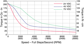

Regarding the Nema 23 v 34 argument. Compare them running similar voltages. You'll generally find Nema 34 graphs are using a high voltage driver, while Nema 23 are done using a relatively low voltage driver.
I've just had a quick look to see if I could find a couple graphs to do a comparison, but the Nema 34 graphs I found were mostly using a 110VAC supply (about 155VDC), while the Nema 23 ones were using 30-40VDC supplies. At those low voltage, torque drop of is very noticeable, and crippling Nema 34s with only 70VDC also makes for a very similar torque drop-off. You need voltage to over come the back EMF at speed. Without that voltage, torque at speed is very limited.

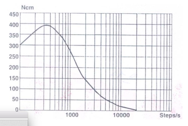

Attachment 22120Attachment 22121
Just as an aside, if the Astrosyns were geared 2:1 they'd only be producing 0.4Nm
Having looked at the torque curve more carefully I see now that with my table axes running at 2000mm/min that the motors should be producing something in the region of 1.7Nm - which should be fine and indeed seems to be so. I can also see why increasing the speed by 50% causes them to lose steps as they've lost 0.5Nm in torque:grumpy:
