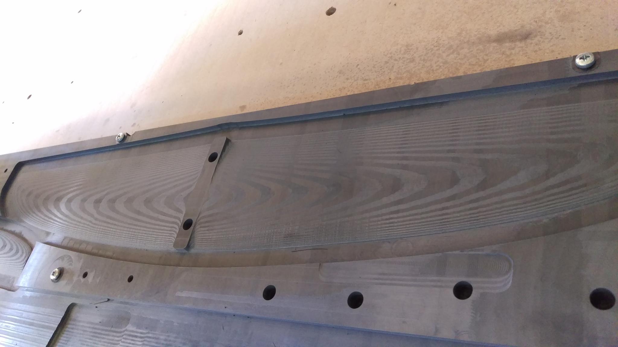

Hi guys,
Well, it's still there.... After changing from Gecko dive to AM882 drivers, I am still getting random X and Z this time, faults, as in the tool has missed 5 to 6 cm of travel in an instant.
Ran for 55 minutes doing a constant Z level face, with long straight lines, no errors.
Changed to a parallel operation, with constant Z changing, constant Y position every 3 seconds then move 1mm, and constant X reversing left to right while Z up and down.
The error that occurred within 5 minutes of the new operation starting, ended up shifting my X position by 70mm, AND shifting my Z up by 3mm - no fault detected by AM882 because speed too low for stall detection.... or because fault was not a stall.
Thought that the X/Z error was caused by a jam and motor loosing torque after overheating ( which still may have something to do with it ) So I started Parallel again while motor was boiling hot and pushed with about 40kgs force and was utterly unable to cause any kind of jam, let alone 70mm of jam.
Re-homed position, reduced speed by 50% and ran operation for 25 minutes , and through the previous anomily without error ( not a G-Code error ).
So now I'm thinking I have only ever had this error when running parallel operations with changing Z values..... Could there be something happening momentarily with the motion controller getting overloaded from all the commands and it be responsible?
Assuming this is not a lack of stepper power, or a machine jam related error then what else could cause it to jam at higher speed, but seemingly not at 50% speed?

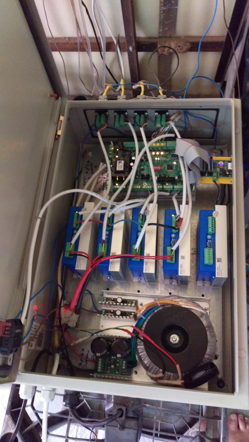

Hi guys... Sooooooooo angry right now !!!!!!!!!!!!!
I just video'd the problem for the first time, it was a vertical travel move, with speed turned down to 50% of my tools recommended speed.
After 8 minutes, the tool lifted vertically while unloaded with a slow retract speed, and the Z height travel jammed for 1/2 a second just before getting to full retract height. then plunged into the part. on the next down shift. It wasn't accelerating, it was at travel speed when it jammed on nothing
The previous other error was not caused by the Z axis, as it was an X axis shift, that also must have had to jam and remain in mid air - and be unloaded for 3-4 seconds wile being sent an X command but remaining Dead still in the X axis, with the Z axis moving up making the tool cut vertically in mid air.
Current Peak is set to 3.5A with Pro tuner in the AM882
Stall detect will not function as my cut speeds are low while I try to figure out what is causing these issues
Motors are NEMA23 381oz/in 3.5A Single Shaft Stepper Motor KL23H2100-35-4A, 0.9 degree.
Power supply is PS-10N68 - 1000W 68V Power Supply running 4 of the above steppers, ( two of the motors would have been on 50% current hold ) when the other motor stalled also.
The final thing is that I tried as hard as I physically could to get the Z and X axis to jam, and i just physically cannot, even with the motors hot............ any ideas?
Remember, they both effectively jammed at travel speed, basically under no load, .... but y?

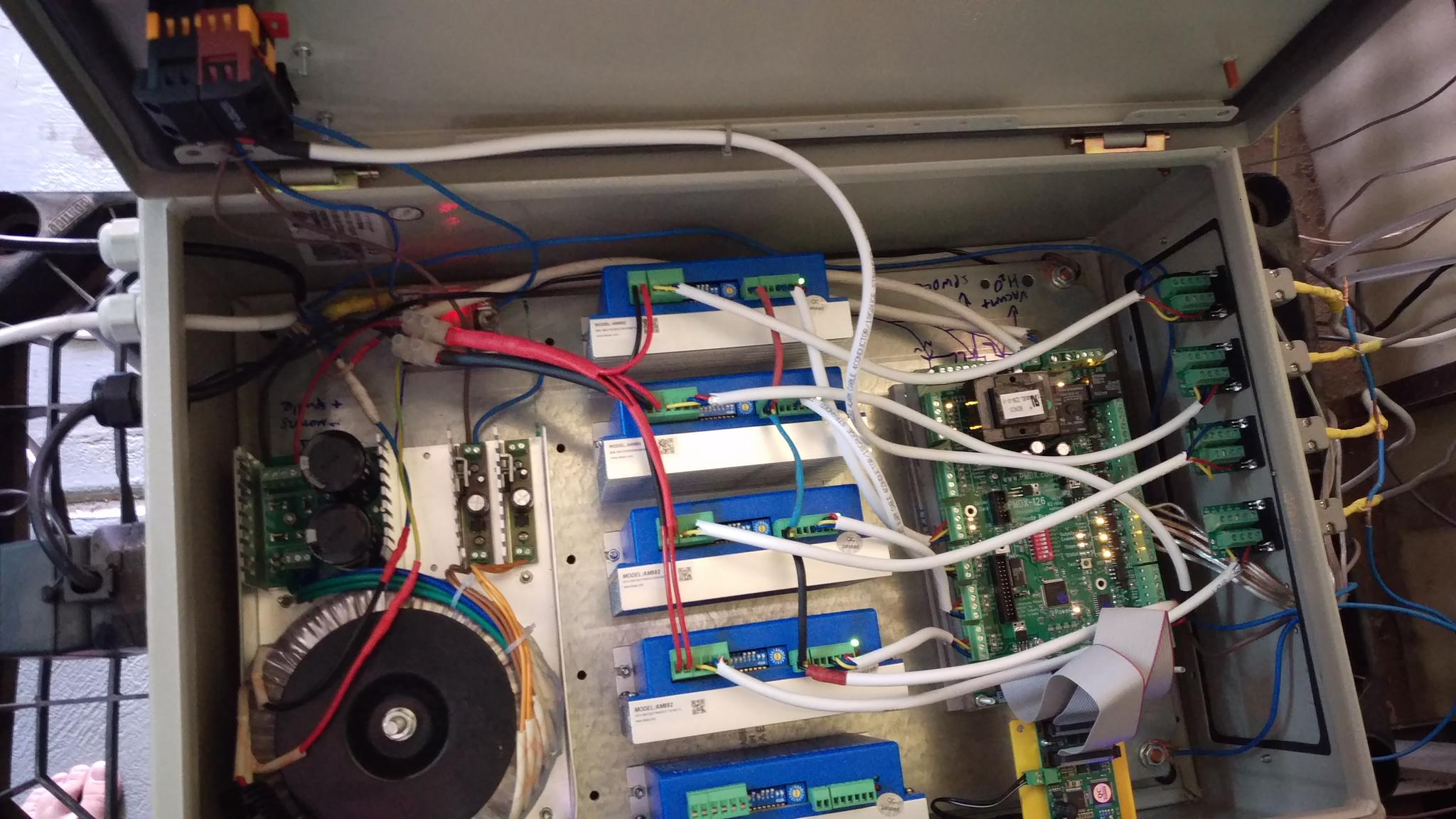

Is there anything still original from when the problem first appeared?
What BOB are you using?
I'm wondering if it's a faulty BOB causing issues with step/dir outputs.
Re: The Dreaded X axis stepper error.
The only original parts are UC400ETH, UCCNC + PC software and hardware, Spindle, motors + wiring..
More clues, just had fault number 3 for today on video, I had everything running, but no drill bit in the spindle, ( All electrics on and running, spindle was turning but with no BIT. This time the X axis jammed during a left to right travel movement. just after reaching retract height, under no load. AM882 stall detect SHOULD have picked up this stall, it was at 450rpm, but it didn't........ some kind of electrical interference?
Did another RUN everything turned on again, but this time the spindle freewheeling ( inverter powered but no power to spindle ).....18 minutes later, no fault
Ok - I've now noticed that the X axis jam that happened in mid air snapped the coupling in half.

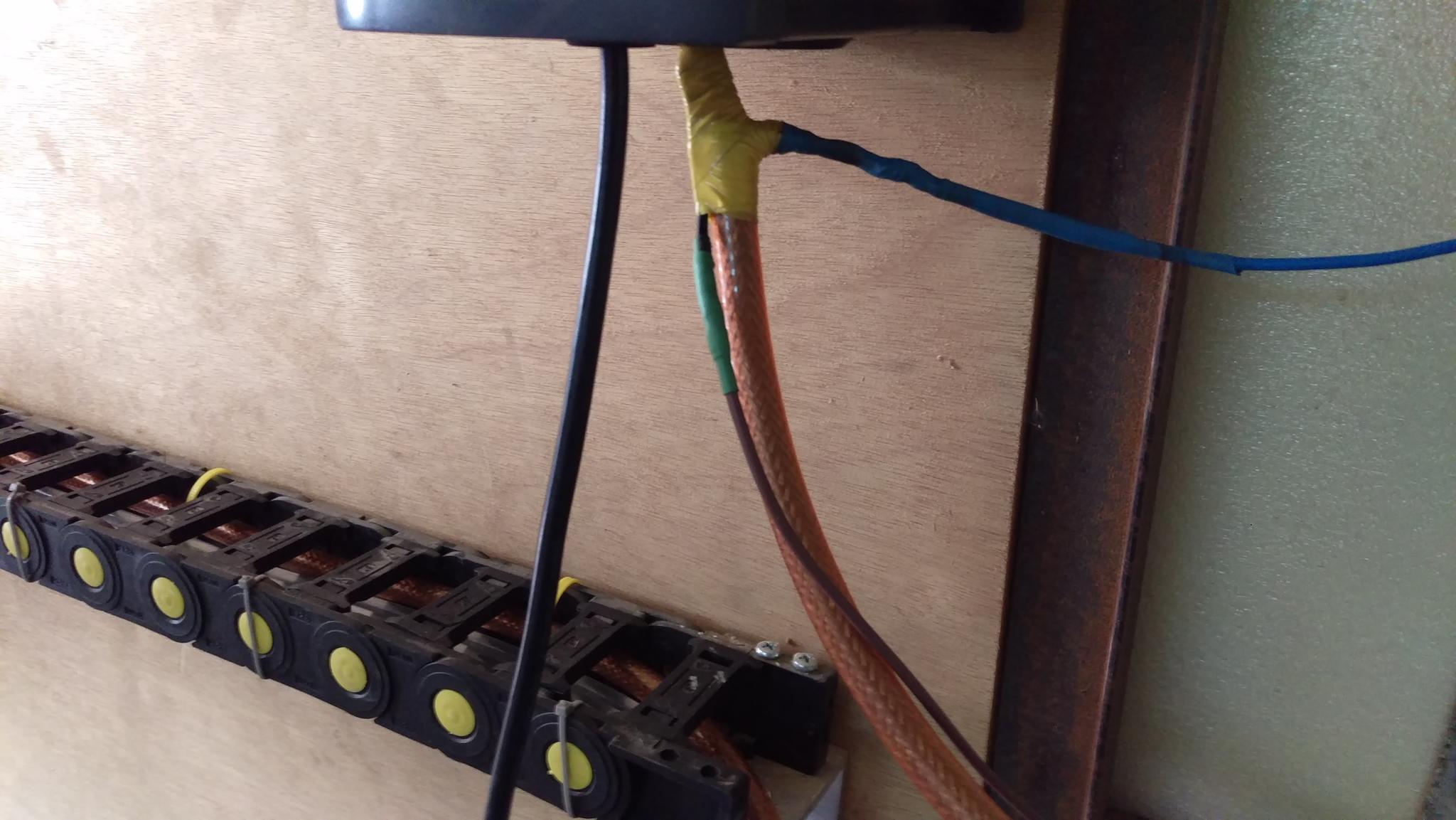

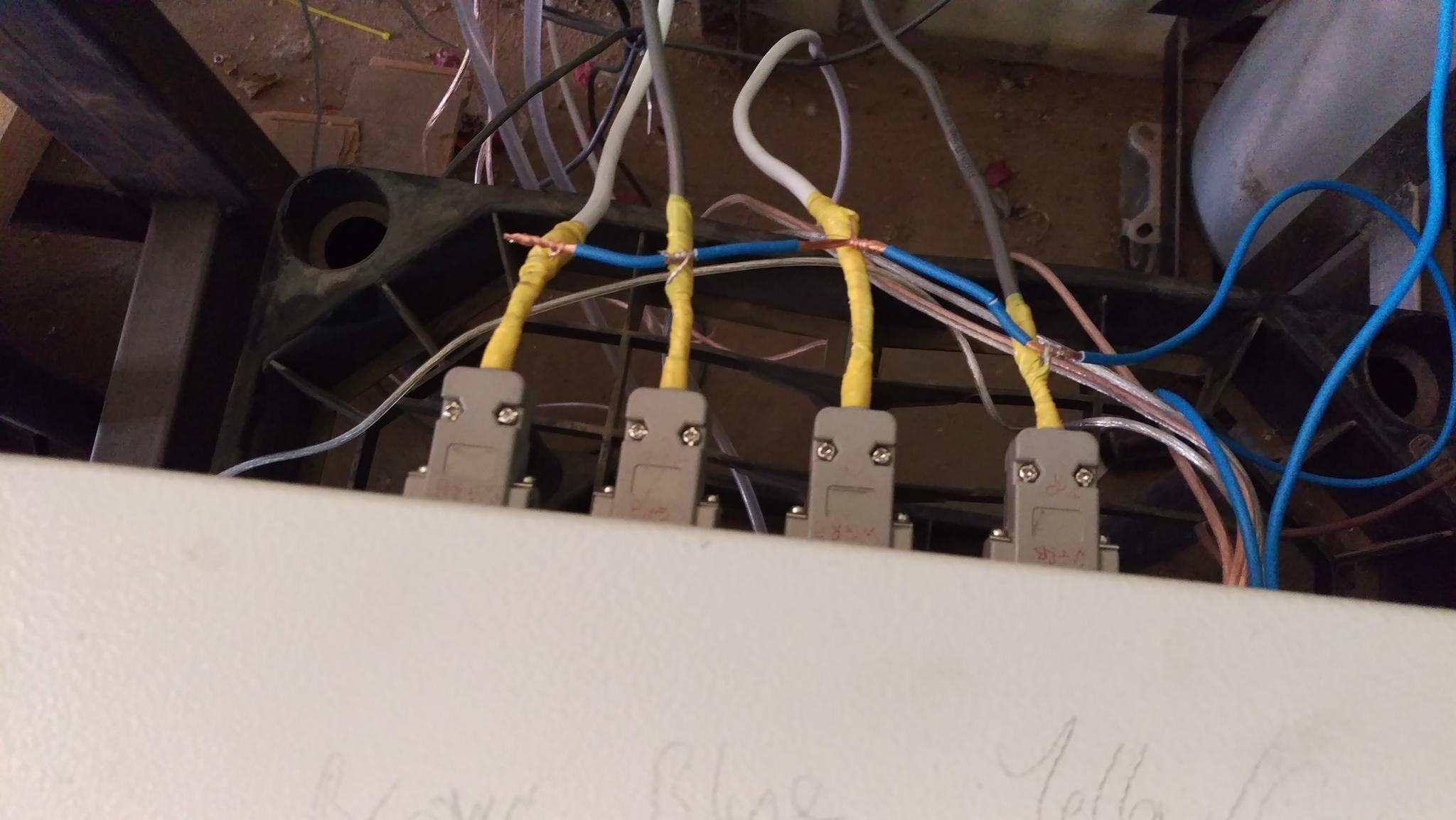

Just ordered some different spindle shielded cable - siemens proflex EMV
I do have the spindle running in the same 50mm cable carrier as the X / Y motors... would this normally be ok? I don't think I've seen a DIY machine that doesn't run this setup yet?
Normally it is not an issue to run the spindle and stepper cables in the same cable carrier. I have done that and never ever could relate any problems to that.
Right now I think you are a bit upset and inconsistent/badly structured in your efforts to finding out what's wrong. I think it would be a good idea if you could cool down a little, accept the fact that you have many problems and try to solve them one by one. I understand that you are upset and emotional but it does not help in fault finding. Remove the spindle from the loop by completely disconnecting it from the mains. At this moment milling air is perfectly fine. No need for a spindle at all. Try to solve all the other issues first since your machine is useless as it is anyway. Describe your machine, post a few pics of major parts and technical specs and settings. Answer questions instead of asking loads of new ones in a non-structured way, because at least I have problems with understanding your actual issues, there seems to be far too many and probably not related to each other, but I don't know.
The snapped coupler may be because you are using the type which is frequently sold on eBay as "flexible coupler" and basically is just a joke and they can snap and also cause other issues, but since you don't post any pictures or video it is difficult to say what can be the problem with each issue.

So guys,
I am fairly confident that I have diagnosed the problem correctly.
Background - I seem to experience random jamming in the X / Z axis, where by the stepper would loose any huge amount of steps - up to 5 or 10CM of error per event.
It only happened when running parallel type operations with multiple quick Z or X axis toolpaths, or both at the same time. I can run a parallel operation in the Y direction with Fixed Z height, and have no issues whatsoever for hours, but the other direction - within 10 to 15 minutes guaranteed motorStall in Z or X
I changed the power supply from 600W switching, to 700W torroidal, to 1000W torroidal.
I tried 2 x different Gecko drive motherboards
I bought new Ethernet cabling from the laptop to ETH400
I replaced the Geckodrive with a PDMX126 + 5 x Leadshine AM882 digital stepper drivers
I ran the motors under both 3.5 Amp peak setting, and 3.5 Amp RMS setting.
I observed stalls occurring randomly 10-20 minutes in, in every single one of those tried changes
I currently have the Max speed set at 80% of motors peak torque rating, and acceleration set at 10% of the slowest acceleration speed I was able to generate an inertial induced motor stall.
I cannot physically make these motors stall no matter how hard I push / pull / sit on the gantry while it's moving, yet it still stalls mid air unloaded.
After finally videotaping 3 stall events, none of which were cause by excessive speed, loading or acceleration, and also noting the AM882 failed to detect the stall.. I then unplugged the spindle and on the first attempt got to the end of the toolpath without error ( It had failed 100% of previous attempts, within 13:20, 12:00, 9:00 and 17:00 minutes on the recorded occasions - including 2 of those where the spindle was spinning in the air, with and without a tool in, and not cutting anything during the test run but with stalls both occasions. )
Based on the above evidence, that the stalls are not occurring in the same place, or even at the same time, and I can't find any mechanical issue with the machine, It has to be an electrical problem.
It is not effecting the Y axis, and the Y axis cabling does not run anywhere near the spindle cabling, but the X and Z axis runs right next to it the entire wire length.
So, I have ordered some heavy duty VFD cabling ( siemens Protoflex EMV ) and I am also going to re-wire the Z and X stepper motor cables, with some different Foil + wire shielded, and move them to either sides of my cable tracks, with the water lines in the center.
After re-doing the cabling, that is almost the entire electronics replaced, except the ETH400, and stepper motors themselves.
My toolpath is being tested by the UC400ETH retailer, to confirm they do not see any issues from it during the parallel operation, to try rule that out also.
Should be able to test in a few weeks when new cabling arrives, Let you know how it goes.

OK some decent picture of your control box would be good.
You need to earth the screen at one end only.
Do you have screens on the stepper wiring?
Do you have the machine frame grounded?

So this is what I'm at now.
I checked all the stepper motor shielded cables, made sure they were insulated at the stepper motor end and touching nothing, then at the control box end they all go to the star point.
The VFD spindle/Z axis block is now earthed direct to the star point. ( No other frame earth, just the one on the Z block )
The VFD cable shield is earthed separately onto the same star block, and it's insulated at spindle end ( not touching the spindle )
The other AC appliances ( VFD + Wood chip motor + 2 x pumps ) are all earthed at the same star point where applicable.
On the earth side - I'm using the house common earth..... how can I test if this is faulty?
Personally I would just earth the main frame not the Z block ( if you want to earth the Z block connect that to the main frame)
was a little concerned about the cable shielding pushing an AC signal back into the stepper motor shielding, but it seems to be going ok, 40 minutes into a cut now
Let us know how you get on.
Still no pics of the control box !!
5 Attachment(s)
The stepper ground is temporary as I was still trying to troubleshoot
dachopper
Ok It is always better to use twisted pairs for the step and dir wire from the drives to the control board just chop a cat5 cable up.
