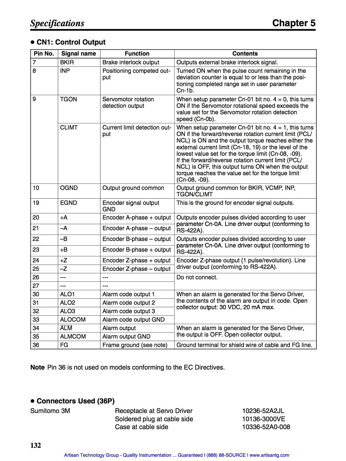

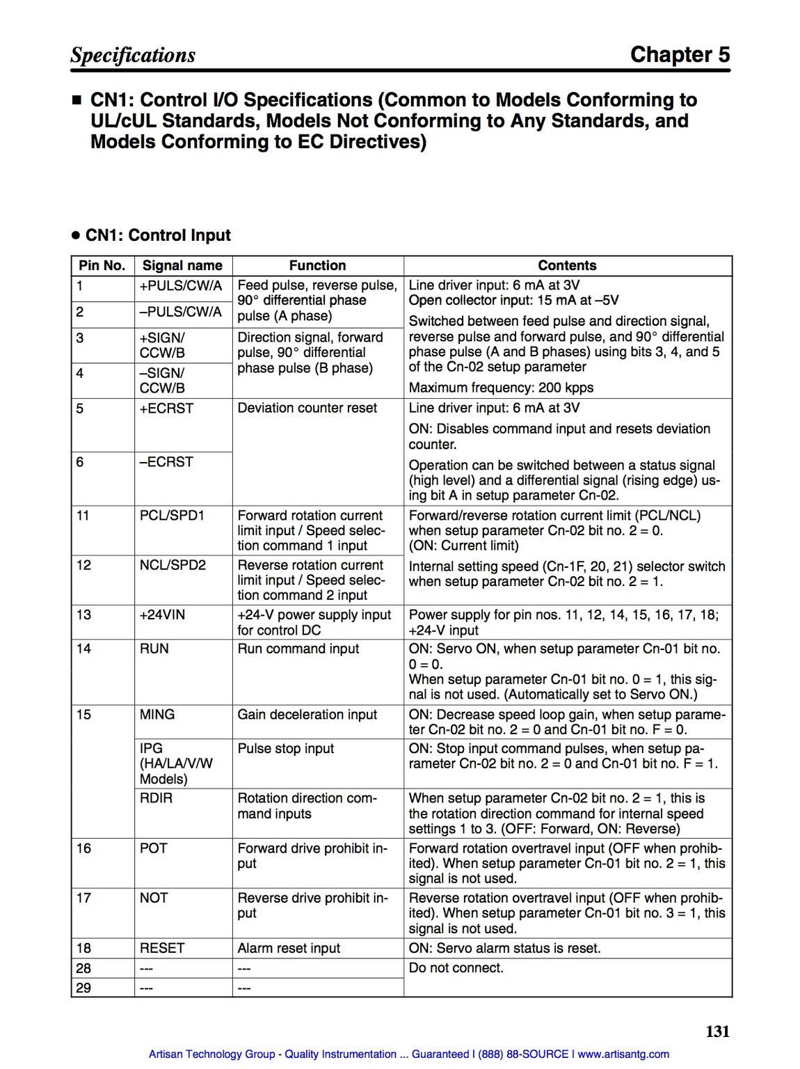

Attached are the pin-outs from the driver interface plug.
Attachment 22407Attachment 22408
Re: Help connecting servos to breakout board Mach3
Having looked at this a bit more, am I right in thinking that 1 and 3 relate to step and direction on the BOB and that 2 and 4 will be ground? What about enable?
I realise the second page I attached was not relevant.

You really need to know how the drives are set before you can test them.
However a quick look at those pinouts, and if you apply all the required power inputs, activating the RUN pin should at least get the servo to lock, however that depends on the related settings having not been changed from the default where activating the pin enables the servo.
