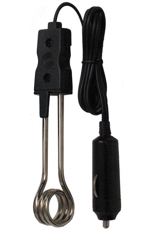

		What are you guys using for heating the baths?
 And what material should the containers be? PP should be alright?

		You don't need to heat the acid bath really, in fact in general the colder it is the better the result.
 I often see other stages using an aquarium heater or other similar submersible heating element. This would certainly get things warmed up quickly enough!

 As for heating the buckets, I like the one you linked, but I am limited on power in my current workshop. Wont be in my new one till end of November.
 Pretty much can't draw more than 3000w in total.
 Thinking of getting a couple 12v ones that I can then use one of these cheap controller boxes with. Safer too as those immersion ones don't always have earth on the metal case.
 https://www.ebay.co.uk/itm/172822446...r=471604592191 (This is 220v ones yes, they do 12v too)
		1 Attachment(s) Re: Best anodizing guide?
		Just tried one of these in a 500ml glass jar and it worked pretty well.
 Attachment 22911
 Took a good 10-15 mins to get up to temperature so would expect a lot longer with 5l tubs.
 Runs at 12v and draws pretty much bang on 10A so 120watts.
 Going to test wit 5L now!
 https://s1.postimg.cc/1kwvscfnsf/IM..._133301345.jpg
		The specific heat capacity of water is 4.184 joules/gram/deg, so to raise 5 litres of water from 20 to 80 degC, would take 1255200 joules (4.184 * 5000 * (80-20)), or 0.349 KWh. Now if you've only got 120W, that means it would take 2.91 hours (0.349 / 0.12) assuming you have zero heat loss.
 However, unless you've got insulated containers, I'd doubt you'd ever get to 80degC.

 Pretty much spot on. Tried it for the hell of it and got the top third of the water to 50c/
 The rest stayed at 16c (workshop room temp). That was nearly 1 hour.
 I am thinking 1000w min really as I don't want to wait too long for it and once one puts the part into the bucket the temp will go down quite a bit. So need it to be fast enough to recover from that.
