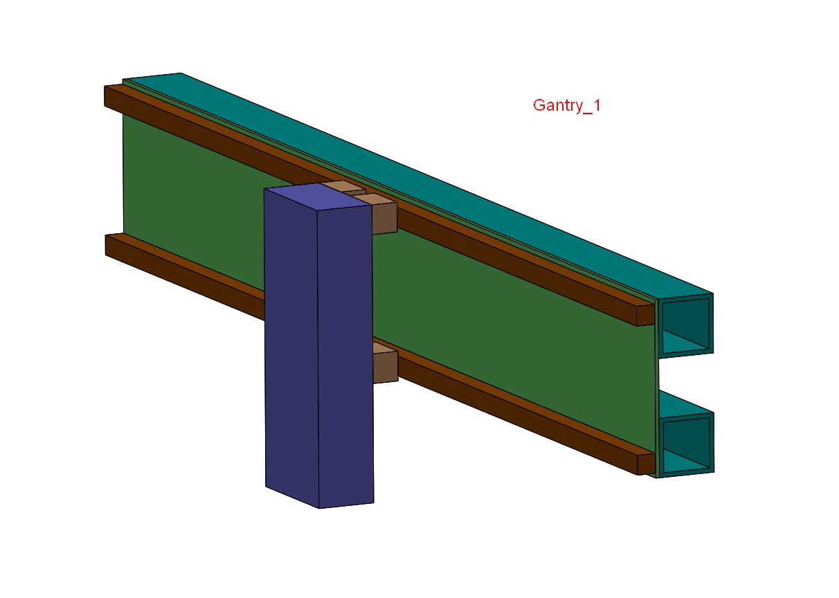

		First real post! Looking for advice on moving gantry design.
Proposed machine cutting area: 1220mm x 1220mm cutting area (1/2 plywood sheet)
Materials to be cut: Foam, Hardwood, Plywood, Aluminum to 6mm thick.
Proposed machine parameters:
	Floor standing
	Moving gantry with high wall frame
	Gantry beam length about 1500mm
	Twin X axis ballscrews, single Y and Z
	Non-production environment
	Need decent but not perfect finish on edges of aluminum plate.
	Would like to hold plus minus 0.1mm on dimensions
Materials available for the router build:
	80/20 extrusion 3030 (76mm x 76mm)
	80/20 extrusion 1530 (38mm x 76mm)
	6mm aluminum plate
	15mm plate
	20mm plate
Shop tools available:
	20 inch bandsaw
	Full size CNC knee mill
	Small CNC lathe
	300mm x 300mm CNC router
	Small shear, small pan break, air compressor, die filer, etc.
Experience:
	Amateur CNC machinist.  Built a couple of small CNC routers and some custom automated machinery for pool cue
builders.  Just enough knowledge to be really dangerous.

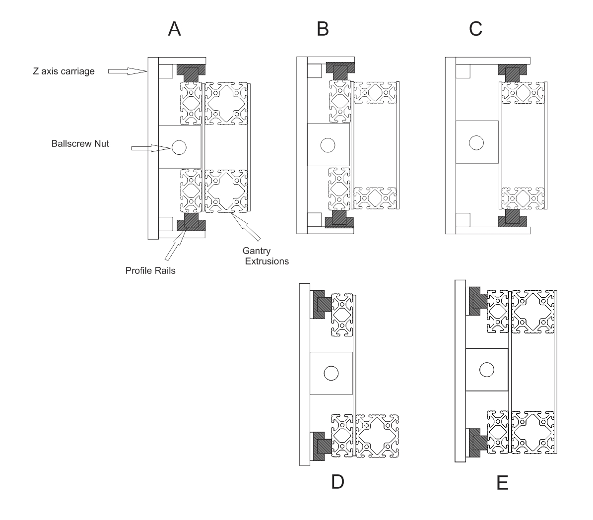

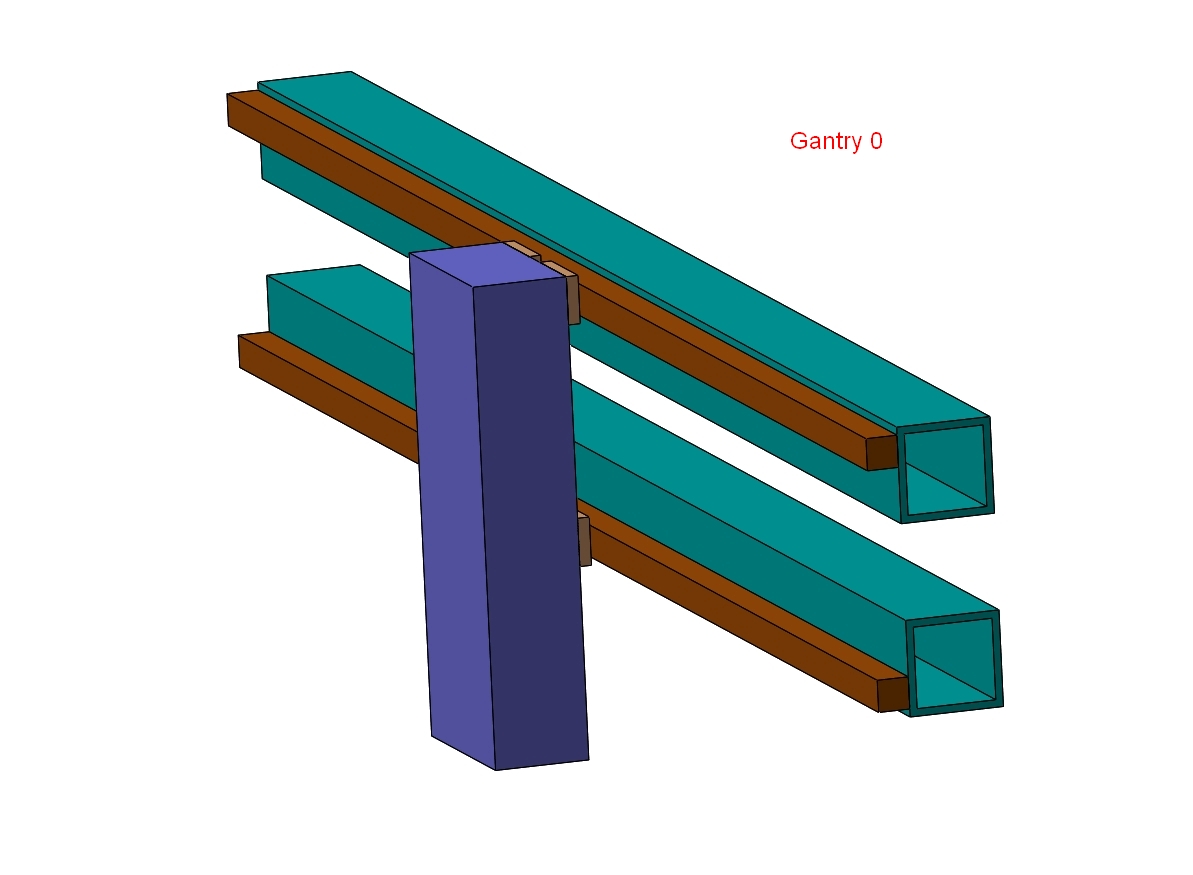

First picture is what my design looked like before searching around this forum for a while.  Looks like I hit all the usual problems
such as:
	Separated twin beam gantry
	Ballscrew between gantry beams
	Thin Z axis plate
	Z axis rails not on Z axis plate
	Single gusset plate to hold end extrusions to gantry carriage plate
Probably a lot more problems lurking in that design.  So I am starting over.  And the first thing I want to do is to settle what the cross section of the
gantry should look like using the materials available to me.  The second picture is of some gantry and Z axis plate cross
section views with different configurations of extrusions.  Trying to come up with some ideas that combine the recommended
box or L box beam construction with things I have on hand.
Do the drawings make sense? Any of my ideas decent?  Got any suggestions?
Thanks,
John C
Attachment 23219Attachment 23220
Re: Need advice on gantry design
		Consider the information here; http://www.cncroutersource.com/do-it...NC-router.html
That should be a guide to the best arrangement.
There was some discussion here about "stiffness", it's a pity more people did not contribute at the time. http://www.mycncuk.com/threads/7155-...stiffness+test
There may be some merit at looking at the numbers to see what each design offered.
		Here is the calculator I wrote some time ago if you want to compare sections
http://www.mycncuk.com/threads/2214-...ess-calculator
Of the designs you have drawn they all have the ballscrew next to the YZ axis which is compromising the gantry stiffness.
A popular design here is the L shaped gantry with ballscrew tucked behind.  Away from pc so will post example later or someone might post it.

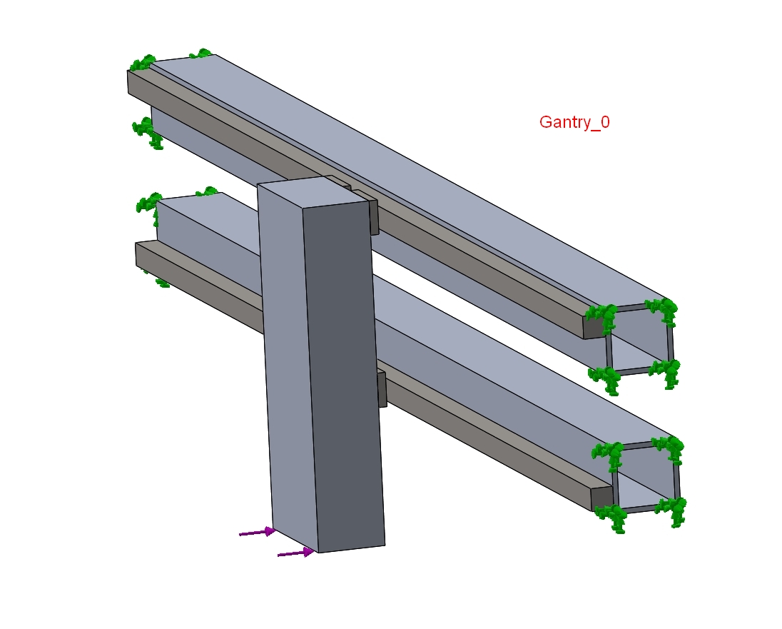

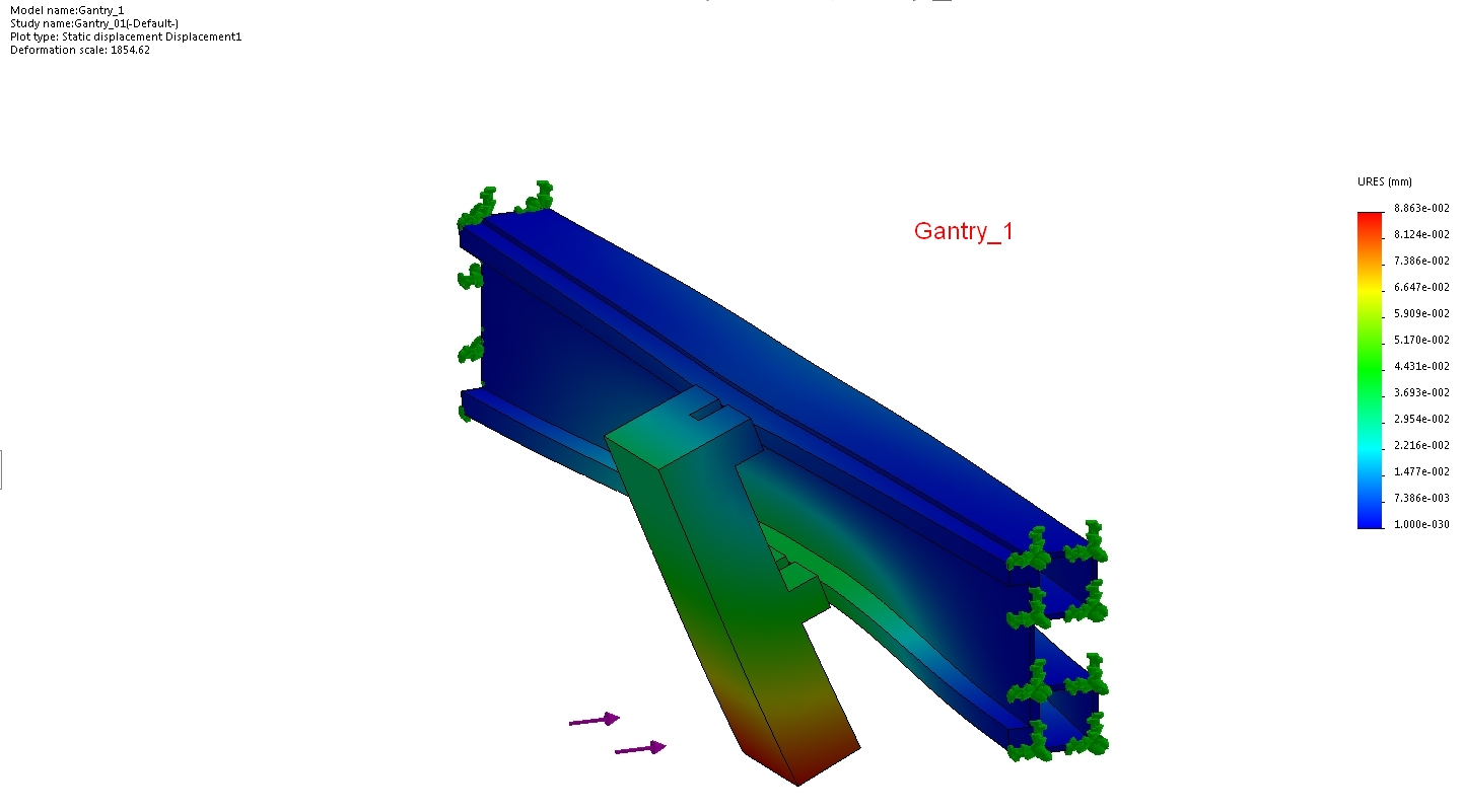

11 Attachment(s)
		Got some math working (I think) to compare different Gantry cross sections.  Would appreciate  any criticisms or comments on my methodology.
I have gotten my static FEA capabilities up and running and will attempt to analyze some different gantry configurations with it.  My FEA refuses to deal with complicated aluminum extrusion CAD so I will simplify the extrusions as a hollow rectangular beams with internal cavity adjusted so that the hollow beam and the 80/20 extrusions have the same moments of inertia.  Not looking for absolute displacement numbers, only comparisons between configurations.

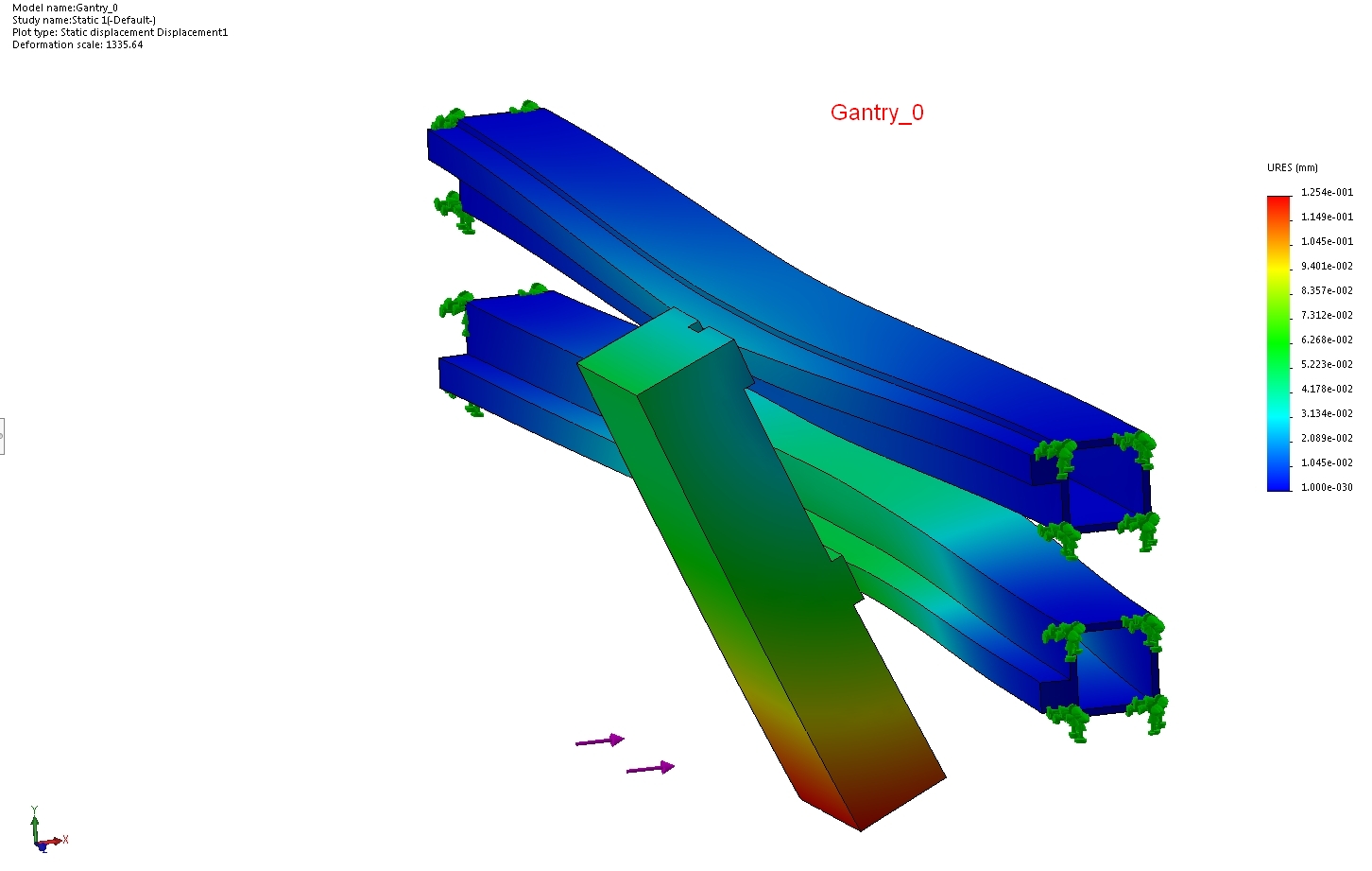

First image is my starting CAD design for the gantry. Called Gantry_0
Second image is the FEA geometry used.
Third image is the loadcase used.  I am fixing the beams ends in space and applying a line load of 500N at the bottom of the Z axis block.
Fourth image is the result.  About 0.125mm.  Means nothing except as a comparison to results from other configurations.
Attachment 23233Attachment 23232Attachment 23231Attachment 23230

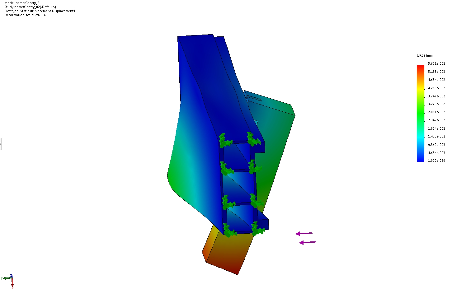

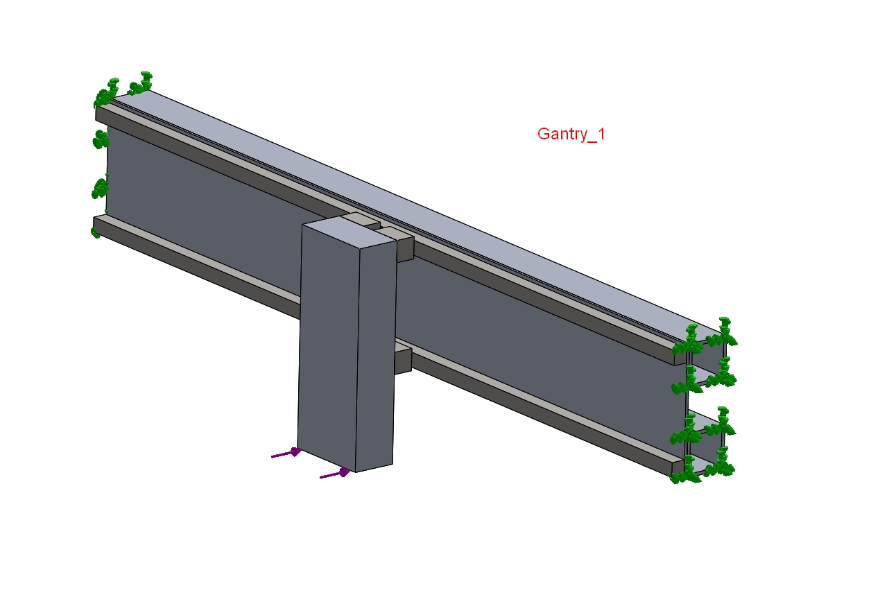

Next is my first configuration change where I box the beams with a plate underneath the rails. Gantry_1.  Again the images are Geometry, Loadcase, and results.  This time the displacement is about 0.086mm compared to the original of 0.125.  So the plate helped some.
Attachment 23236Attachment 23235Attachment 23234

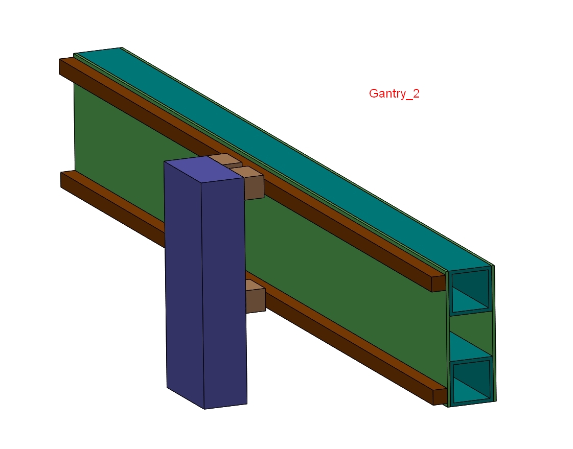

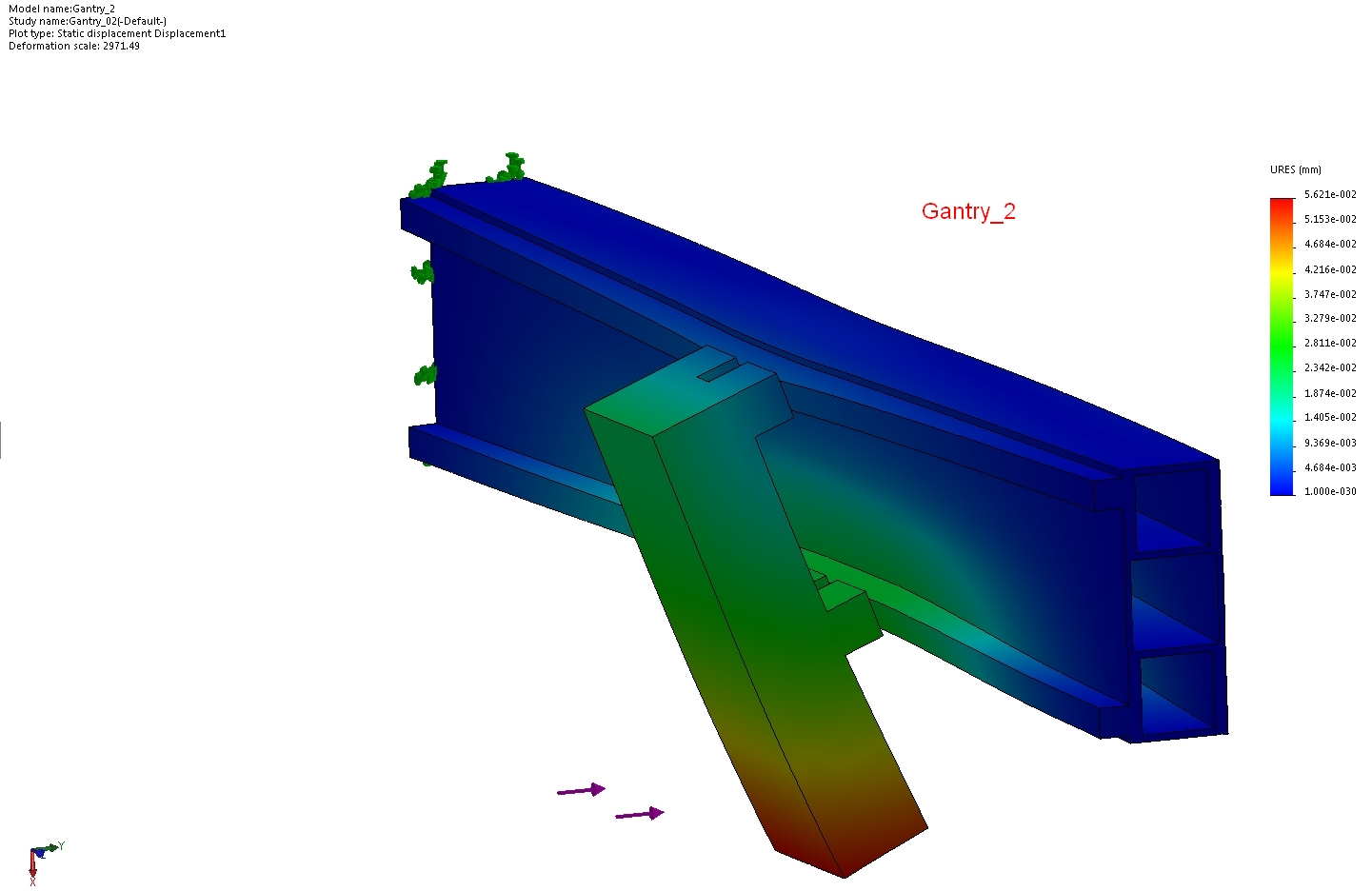

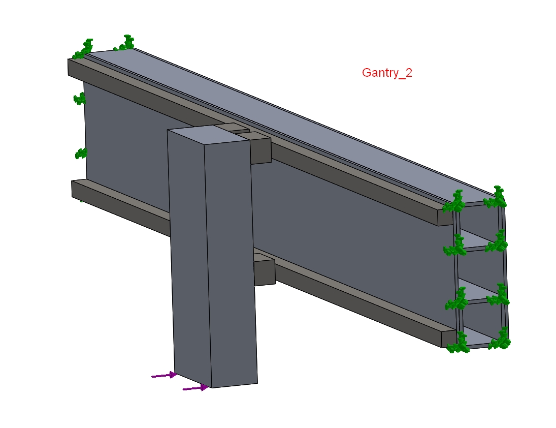

My next configuration (Gantry_2) is to box the other side of the gantry and see what I get.
Attachment 23240Attachment 23241Attachment 23242
Image progression is the same as above.  Resulting displacement is 0.056mm for further improvement in the stiffness of the beam.  Hard to see in the results image but the majority of the flex is in the lower beam at the Z axis attachment. See below.
Attachment 23243

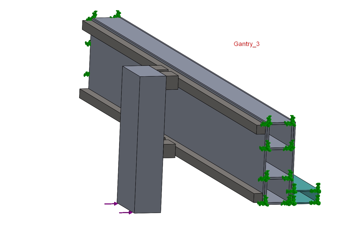

So I will add a half size beam along the lower beam to form an "L" shape to the gantry.   Just like the sticky above recommends, haha.  More to come.
John C
		A circular tube or L shape are among the best ideas I think. In my own build I used an L shape with a flat plate attached to the front, that seemed to work well.

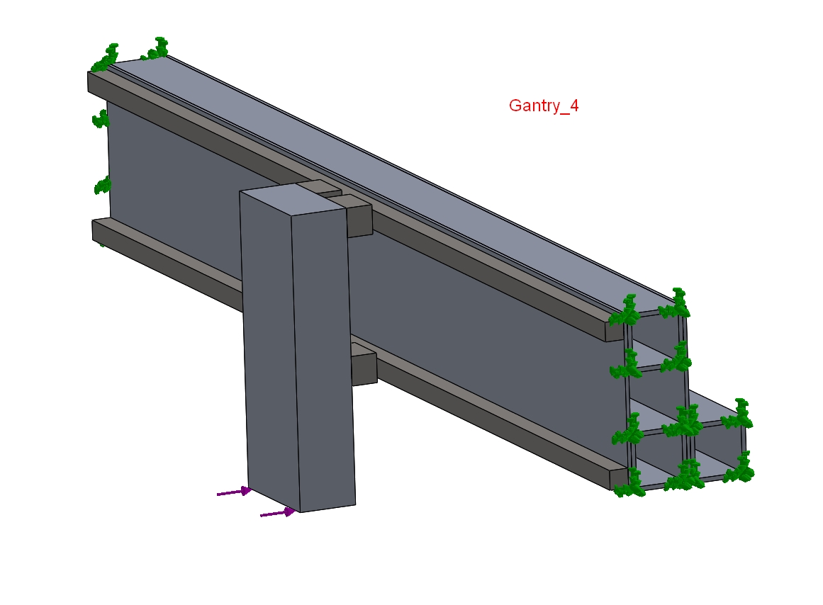

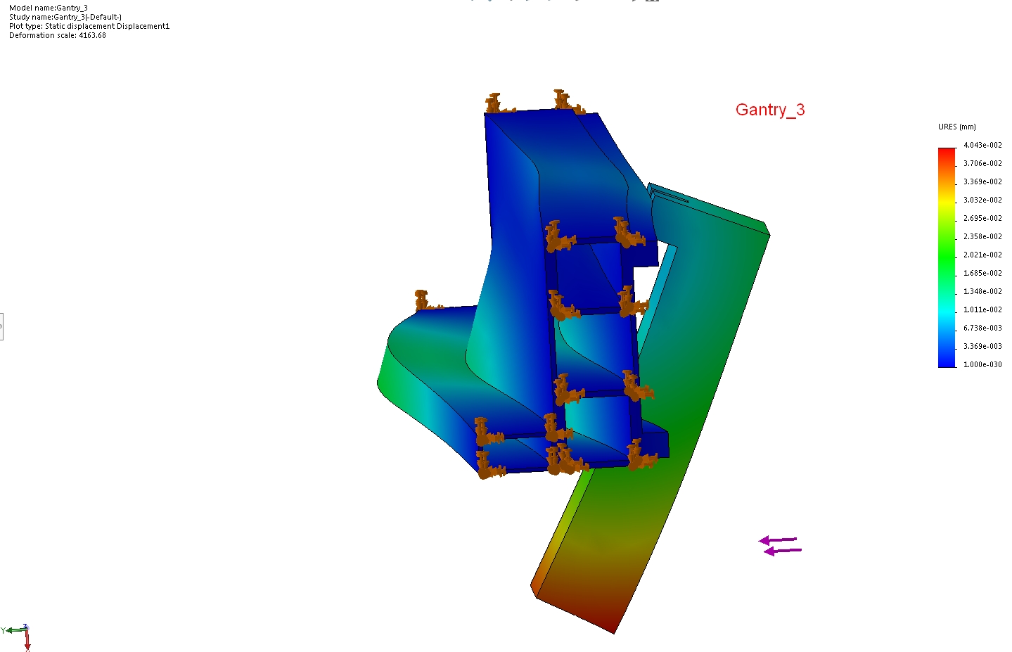

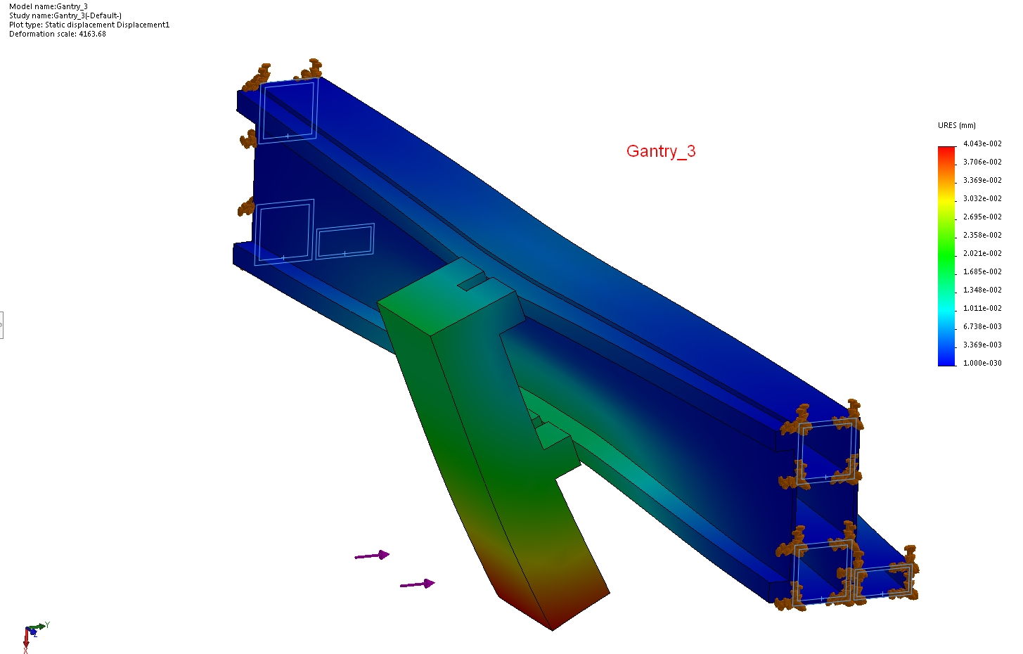

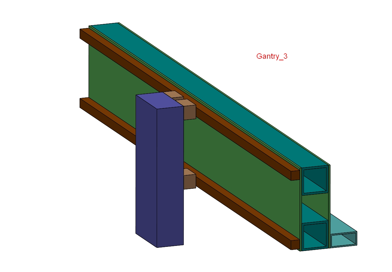

4 Attachment(s)
		I added an "L" shaped 1/2 size extrusion to the lower edge of the gantry and ran the deflection calculations again.  Got another 20% reduction in the displacement metric.  0.056 to 0.040mm.  Not as much reduction as I expected and the gantry is getting pretty heavy.  I will try a full size extrusion soon and see how that works as an "L" beam.  After that I might try 4 half size extrusions to form the frame of a 250mm square box tube.
Attachment 23248Attachment 23249Attachment 23251Attachment 23250
John C
		I don't think the weight will be an issue but are you also taking account of the spindle weight ?
Try a different L arrangement, http://www.mycncuk.com/threads/6565-...5076#post55076
Also try the Y rails on the top and bottom faces rather than the front face. This makes the rails further apart which is good and also allows the Z axis to be closer to the gantry.

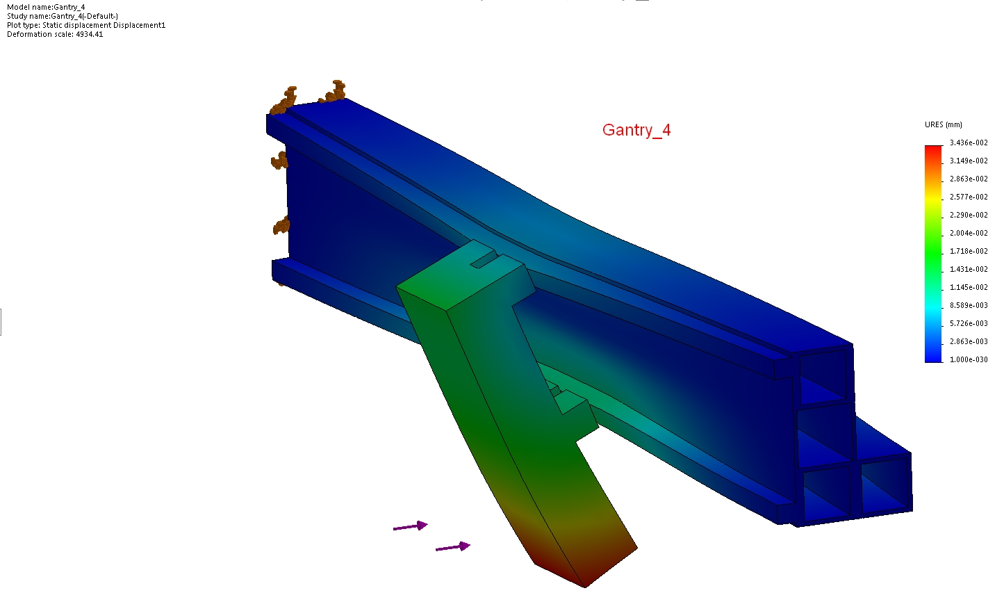

4 Attachment(s)
		An easy change to the configuration of Gantry_3 was to increase the size of the "L" extension to the square 76mm tube used in other parts of the gantry. Called Gantry_4 and shown below.
Attachment 23260Attachment 23261Attachment 23262Attachment 23263
With this larger "L" the displacement metric goes from 0.040mm to 0.034mm.  My gains in stiffness are getting less and less now.  The interesting thing here is that there is a more equal distortion level on the top and bottom of the gantry.  A well designed mechanism will show a more distributed deformation than one with very high and low distortion areas.  This suggests to me that I am approaching the limit of improvements in this configuration.   This configuration is probably OK as far as it goes.
I will next try flipping the horizontal and vertical sections of the "L" so that the longer "L" section is positioned is resist bending in the lower part of the gantry.

		Interesting thread John, good work.  Your simplified analysis is sound enough to draw conclusions and it is no surprise you are iterating towards the popular L shape !
Watch out if you reverse the L shape then you may gain for the current horizontal load case, but the spindle mass and plunging forces will cause more deflection vertically so I would say run vertical loading on it, and repeat on the initial design.
In general, as per Eddy's comments, putting the rails on the top and bottom, and moving the Z axis close to the gantry might get a little bit more stiffness, so that would make another good one to try out.  Plus lots of builders put an additional strip of steel inside the box section where the rail mounts.  This is to get good thread engagement but will also add some local stiffness and help spread the load into the gantry, again adding a bit more stiffness.
4 Attachment(s)
		I inverted the legs of the "L" gantry configuration and reran the loads.  As before the images are respectively, Geometry, Loadcase, Results, and another view of results.  Deflection decreased from configuration Gantry_4 of 0.034mm to 0.030mm for Gantry_5.
Attachment 23266Attachment 23267Attachment 23268Attachment 23269
Better than the decrease of about 10% in deflection is the more uniform deflection distribution over the gantry.  In addition the most distorted part is the Z Axis block which is fake anyway.  Pretty happy with this configuration but as mentioned above I will need to do some comparisons with the base gantry before committing to the Gantry_5 design.
John C

		Agree on the Z axis distance from the gantry.  Z axis design is probably next.  The Z axis plate will be as wide as I can make it with my already purchased ballscrews and the cutting area needed.  I bought some components early when I mistakenly thought the design was done.
Did vertical loadcase on the Gantry_0 design (twin separated beams) and the Horizontal "L".  Used 500N line loaded distribution in vertical direction.
Twin separated beams: 0.1mm vertical deflection which will be my vertical comparison metric
Attachment 23274Attachment 23275Attachment 23276
And the horizontal "L": 0.03mm vertical deflection.
Attachment 23279Attachment 23277Attachment 23278

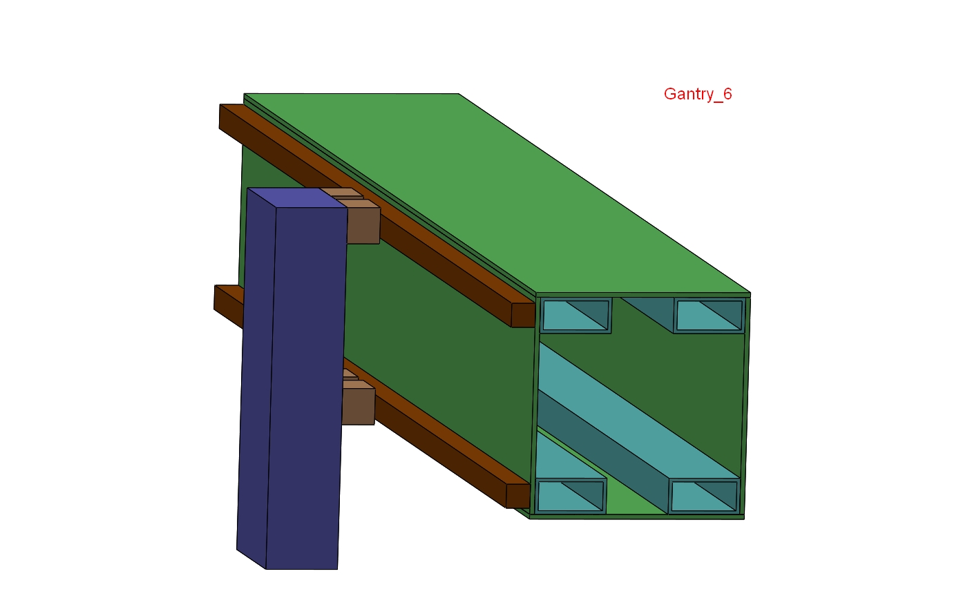

3 Attachment(s)
		To round out this discussion I did a box gantry also.  Deflection of 0.02mm is the lowest yet.
Attachment 23282Attachment 23283Attachment 23284
Dimensions of the boxed beam are the same as the widest dimension of the horizontal "L" gantry.
 So all this playing around with FEA has basically validated the advice given in the sticky threads at the top of the sub forum.  That is, use a box or an "L" beam.  I think I will.  Just gotta decide which one to chose.
Thanks to all.
John C

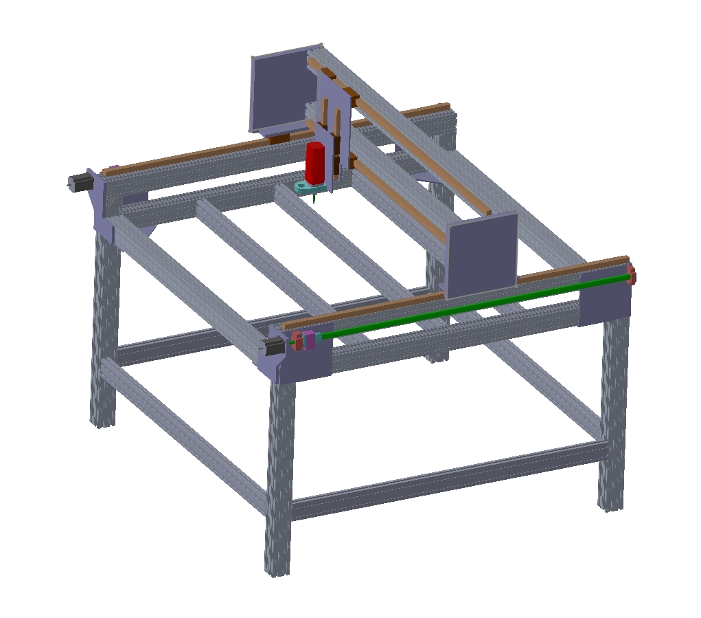

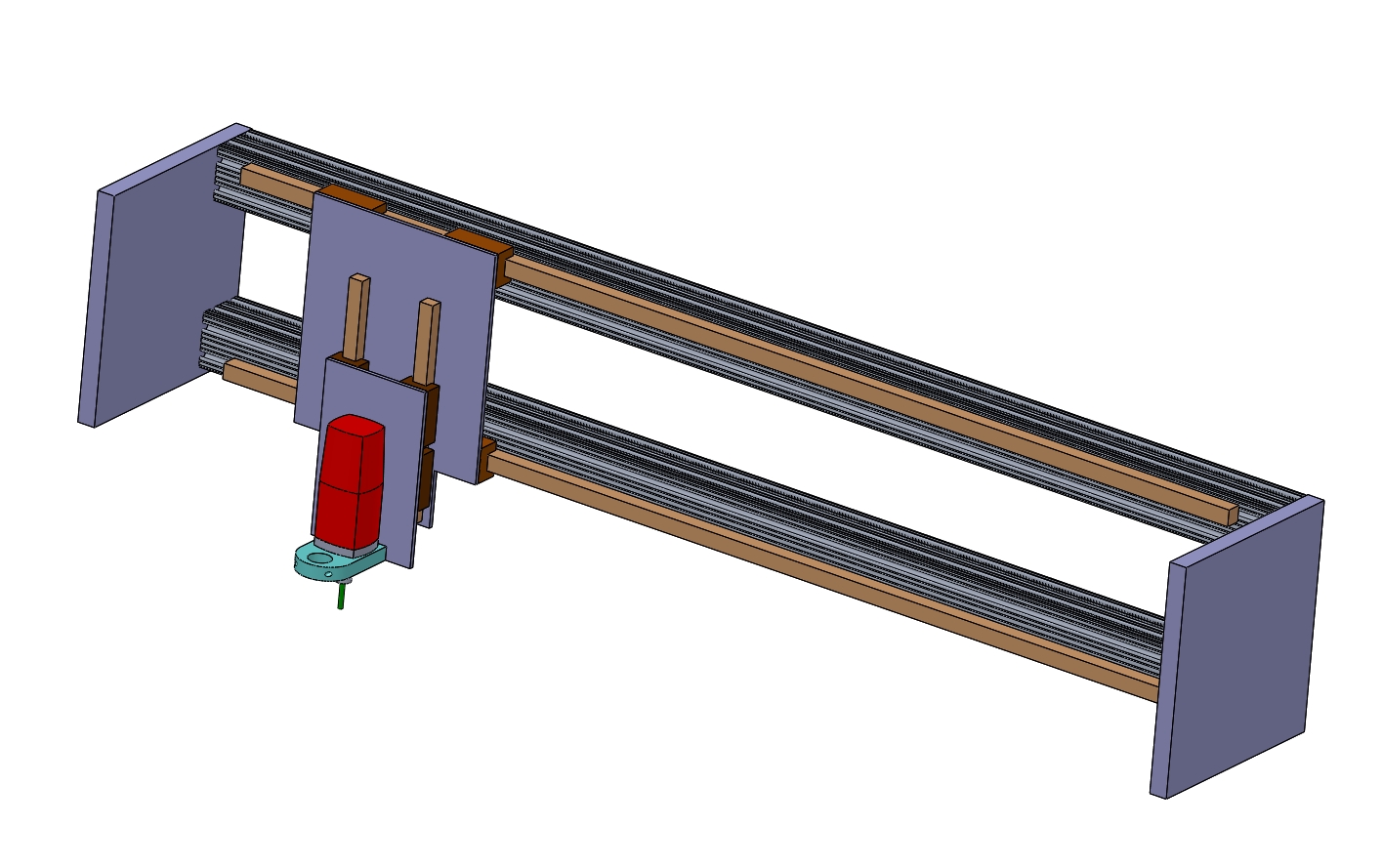

3 Attachment(s)
		Time goes by so fast when you are having fun.  9 Months since I did the math for the gantry and just now have a new  initial design for it.
Attachment 24016Attachment 24017Attachment 24018
But there is a problem.  My original estimate for weight for the gantry was 40Kg.  The weight estimate for this new much stiffer gantry configuration is 100Kg.  My question is:  Is a 100Kg gantry a problem?  The math says I need a stepper that can deliver 1Nm up to 600 rpm to power the two X axis ball screws that move the gantry.  That is with a factor of safety of 2.  Stepper size  looks doable.  Does a gantry of this weight pass a reality check?
Thanks,
John C
		Hi John,
Usually up to 80 kg gantry is OK for typical stepper and drivers, above that may be entering servo territory (=money!).
See post #2 here:
http://www.mycncuk.com/threads/6457-...80kg#post48417
I'm intrigued how you ended up with the design in post #22.  That thin wall, and very open box section looks like it will resonate in practice, and the intermediate extrusions (to space away for the ballscrew?) are going to flex locally.  The ends look fairly tricky to build and maybe a bit complicated.
		To get to this design you gotta remember that as much as possible stock on hand is being used.  Decided on a box beam as analyzed in post #19.  Turned sides inside out to get the offset for the Y ballscrew to fit between the rails.  Side plates don't cover the complete length of extrusions since 48 inch wide thin plate (5mm) stock is available but the rails (and extrusions) are 60 inch. Double plate gantry side supports have been recommended here so 16mm plate was used for those and the rest of the end plates.
As you can guess there is aluminum plate, sheet, and extrusions in abundance to use.  All sunk costs.  Below is what the structure inside the gantry looks like before adding the end plates.
Attachment 24020
Ends are complicated but the CNC knee mill in the garage will sort that out if necessary.  Could use some advice on how to simplfy them.
I am worried about resonance.  If people here think that resonance will be a problem with a manufactured box beam like this I will probably abandon it and try an "L" configuration.  Looks like a lot of people here are having success with less overkill than this.  How do the chinese big box beam gantries avoid resonance?
Thanks,
John C
		If you have a mill then things are much easier.  Are you going to weld this all together then skim flat?
If this is a fabrication then I would add a horizontal web inside the section joining front and rear faces.  Easiest way would be to mill short occasional slots in the front and rear face plates and puddle weld down onto the edge of the web.  Maybe even add 2 webs close in line with the unsupported edge of the extrusions.  This makes several smaller boxes and will tie the extrusions into the section and reduce resonance.  Some people fill open sections with all sorts of stuff but I would prefer adding a few webs (before considering filling).

3 Attachment(s)
		The box beam gantry configuration is the stiffest design.  But having fought resonance before I do not want to do it again.  Scared of those large thin sides of the box.  And the 100kg weight of the model. So tried another iteration.  This time its a simple "L" beam made of the three 3in x 3in 80/20 extrusions.  Ran the math and while it is half the stiffness of the boxed beam it is still over twice as stiff as the original twin separated beam gantry design. Comparison deflection metric is 0.05mm.  Going with this.
Attachment 24053Attachment 24054Attachment 24055
Be back for more comments after getting this style gantry modeled.
Thanks,
John C
3 Attachment(s)
		New gantry layout using three 76mm x 76mm T-Slot extruded aluminum beams in an "L" configuration.  Based on the FEA above.
Attachment 24076Attachment 24077Attachment 24078
This is a concept layout not a design yet but please give me comments and criticisms.  What have I missed? Gantry side plates are 25mm thick, Z axis plates are 19mm, and the extruded T-Slot beams are 1520mm long.  Y axis rails are 25mm HiWin, Z axis are 20mm HiWin.  Light preload.
Thanks,
John C
		Looks good John.  Some thoughts are:
You could centralise the end plates on the horizontal plates so they are directly above the X bearing carriages and bolt from underneath and not include the angle supports.  The bolts into the X bearing carriages may just about straddle this end plate but if the bolt access holes to the bearing carriages underneath is obscured then add a second horizontal plate to bolt to the carriages and then bolt these to each other.
One end plate could be extended rearward slightly to accommodate the stepper which then belt drives to the ballscrew.
Make sure the extrusions and joined to each other to get the section benefits.
Check how you are going to drive the gantry and connect the X ballscrew nut before finalising the exact layout otherwise you might need complicated joining brackets either on the gantry ends or the bed ends where the stepper and bearing blocks are fixed.
		routercnc,
Yes, I could use two 12mm horizontal plates instead of the one 25mm one.  That might make for easier alignment.  Could mill an alignment rabbet on the bottom of the carriage plate to square the two carriages to each other.
Ok.  Was going to direct drive everything but belts and sprockets might let me move a little faster with the 5mm ball screw pitch.  What are the pros and cons of direct drive vs belt?
I have ideas for both internal and external fastening methods.  Will try them and see what works better.
Yes this was just a layout, not enough detail yet for a design.  Looks like it might be time to put in the details.
Thanks,
John C
3 Attachment(s)
		Ran some more math on my triple beam "L" gantry.  With a little less simplification.  Generally don't see any major problem.  I think it is time to add the final details to the design and then start building the thing.
Using Fusion 360 now and its static FEA solver.  Not sure I will stick with this although the integration with industrial design capabilities looks pretty cool.
Attachment 24162Attachment 24163Attachment 24164
John C
