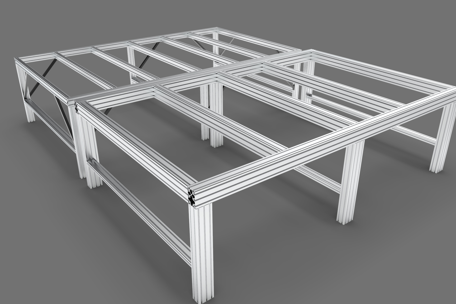

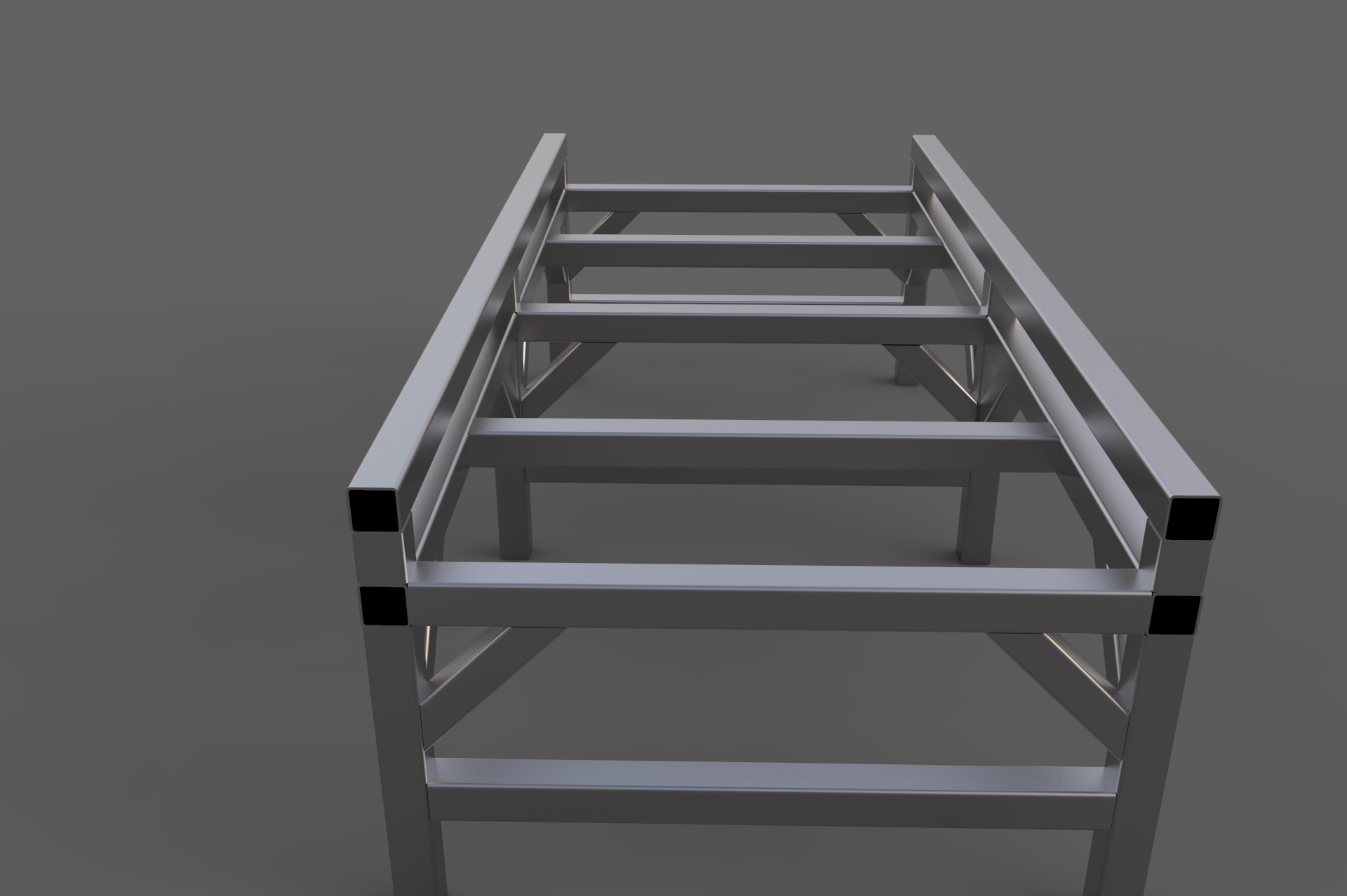

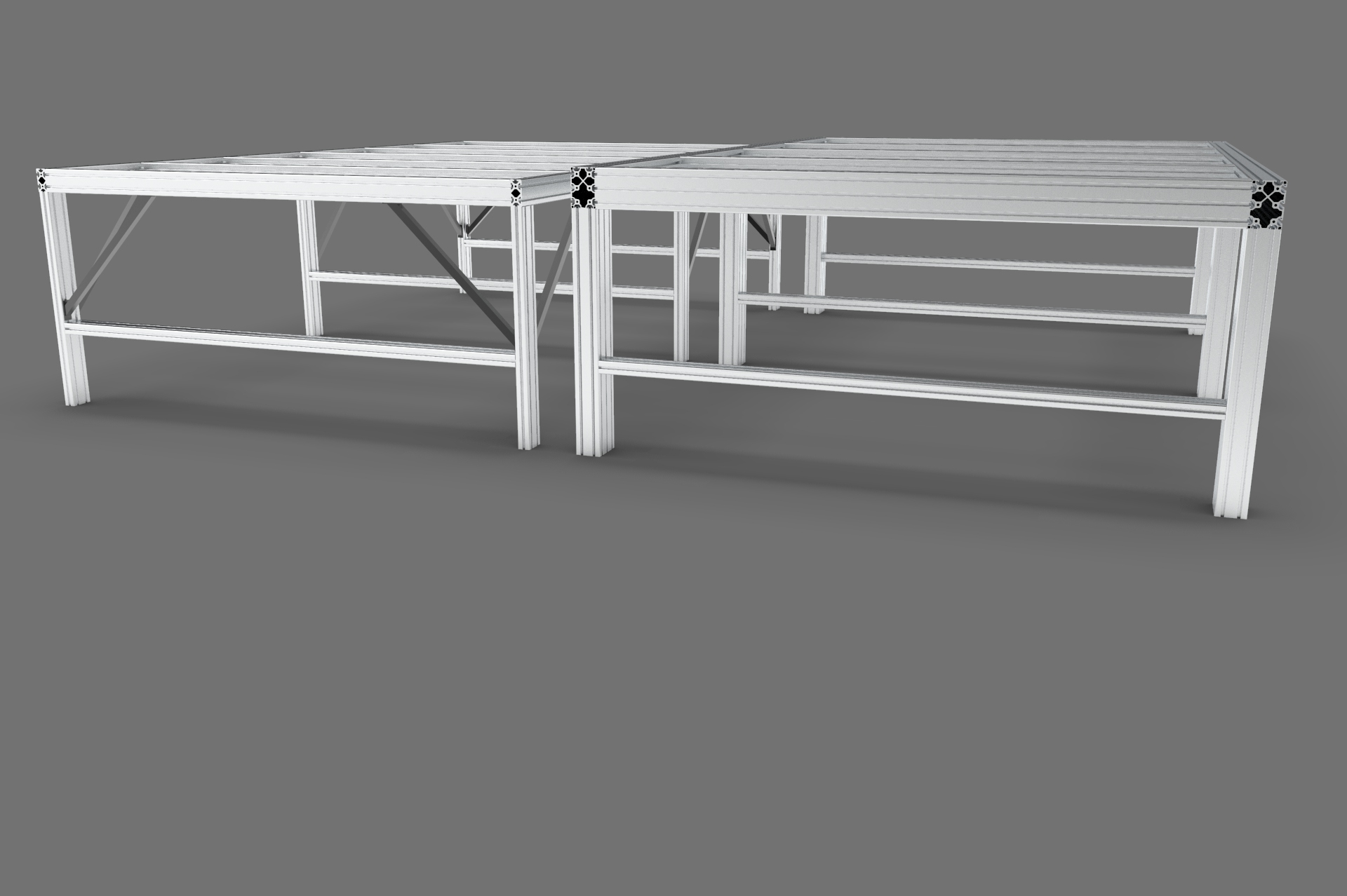

3 Attachment(s)
Re: welding steel base or just getting aluminium extrusion
I'm going to go down the aluminium extrusion route after all and for a few reasons, the obvious one is i aint welding all that steel and i defiantly haven't got the funds to pay someone that amount as well as having the funds to pay 3 months upfront deposit on a new workshop unit and then the frame on top lol. I know its worth the price what the guy offered but i just can't afford it on top of everything else.
Now there is 2 options and option 2 does have diagonal support i just couldn't be bothered to add them in lol
option 1
copy the cnc pro kit 4896 from cncrouter.com (frame bed only) costing me just under £1k which is using the 40x80 profiles but the heavier ones
option 2
80x120 with less profiles then the 40x80 costing just over £1k but these are the light profiles not the heavy ones
i know its way more expensive then steel but i am not as lucky as most of you with welding skills and i can always add to the frame once more funds come in. personally i prefer option 2 as it looks way more solid but would like your opinion and if and where i should add extra support.

I know you are going on other designs but all this generally means is.... someone that isn't an Engineer or a fabricator came up with a design, made it and it worked, and that then sets a president others follow. That does mean mean its good design all it means is someone proved it worked. In the same breath if that design had been done by someone with a lot of experience then that would have been the president and far easier to get a lot better result.
You'll not last long in the DIY CNC world with sensical observations and comments like that ;-)
Listen to what sluppit has said.
I took one look at your design last night, and immediately wondered how many tonnes you were planning on having on it, and why it wasn't using full length sections on the long edges. It looks to me like you've just kept adding bits, without really thinking about why you would need to add them, and ended up with an over complicated design.

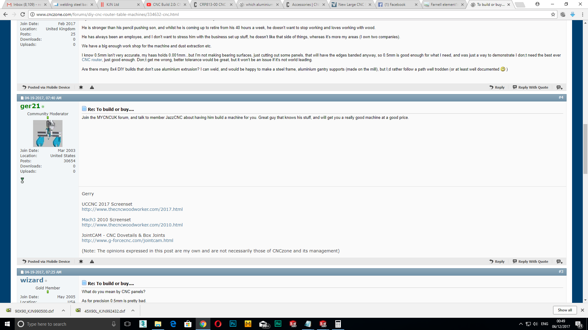

would this be useful i just heard of it watching a video but not sure of the accuracy
Attachment 23333
So design your base so that the two rails which must be in the horizontal plane bolt to it!
Hey Presto!
No machining!
No Epoxy!
If you pay for fuel I'll provide use of my Optical Clinometer which is good for ridiculous tolerance when you level the feet for the base and then set the rails.

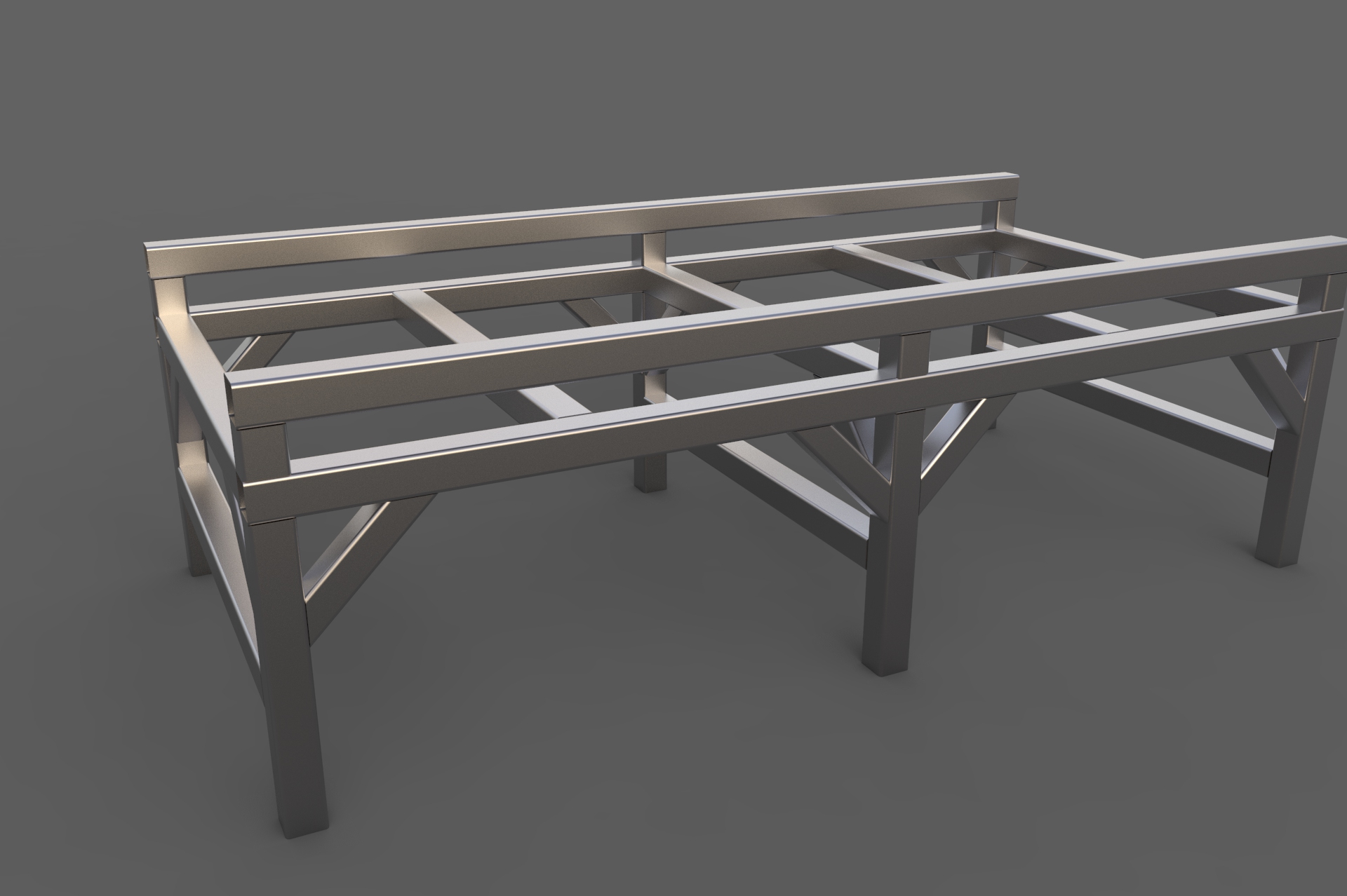

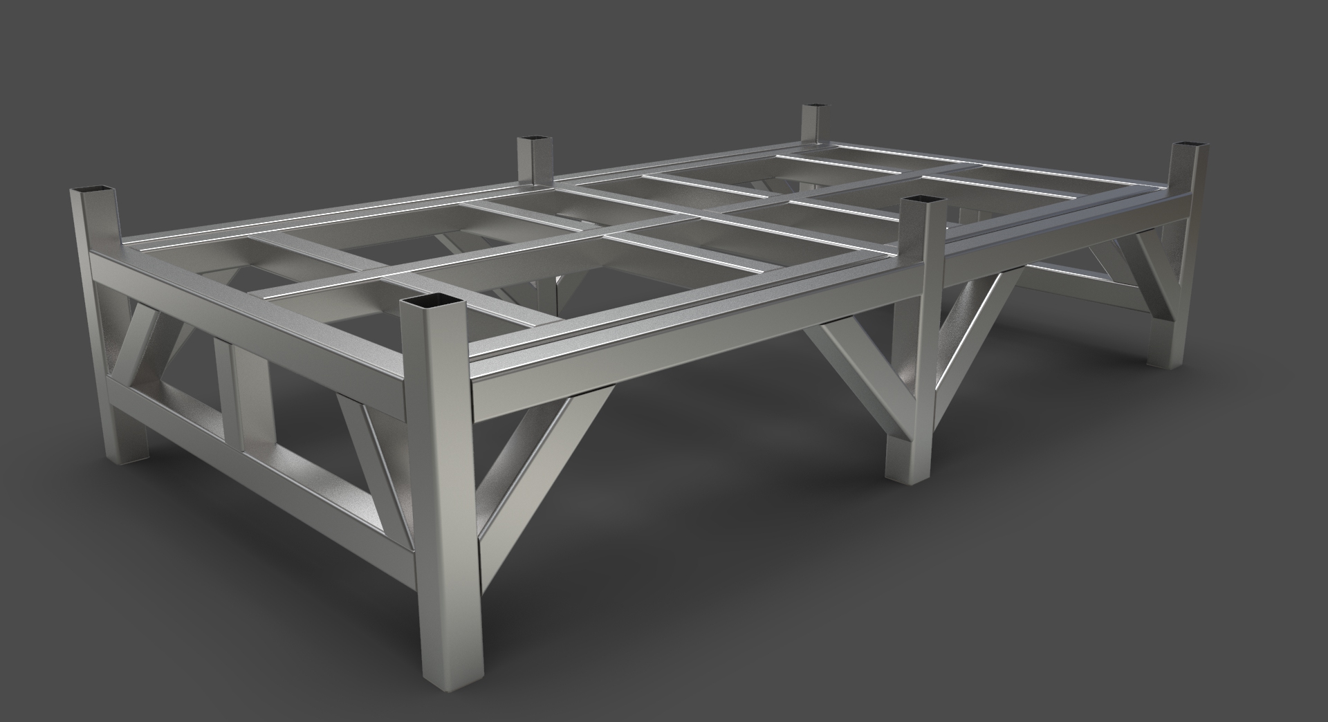

well after watching a lot of youtube video's i am starting to come up with a method and feel a little better however after getting the materials and all necessary equipment/tools then its still going to cost me £1k+ anyway but i suppose i learn a new skill trade in the process.
2 Attachment(s)
anything wrong with this frame and is the diagonal supports ott? i will be adding adjustable feet on aswell
cheers

For what's it's worth I was not confident welding either, so made mine in several welded parts which where more manageable then used bolted connections to fix them together and finally tacked it together once it was all squared up. It is actually not that critical to have the frame perfect as you will most likely need to level it with epoxy anyway and so long as the rails are parallel the support under them does not need to be perfect. Basically what I'm saying is I'd have a go yourself and spend the money you save on the other parts!
