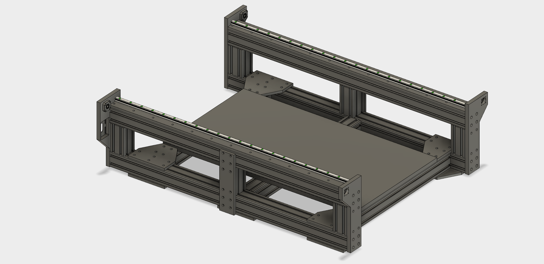

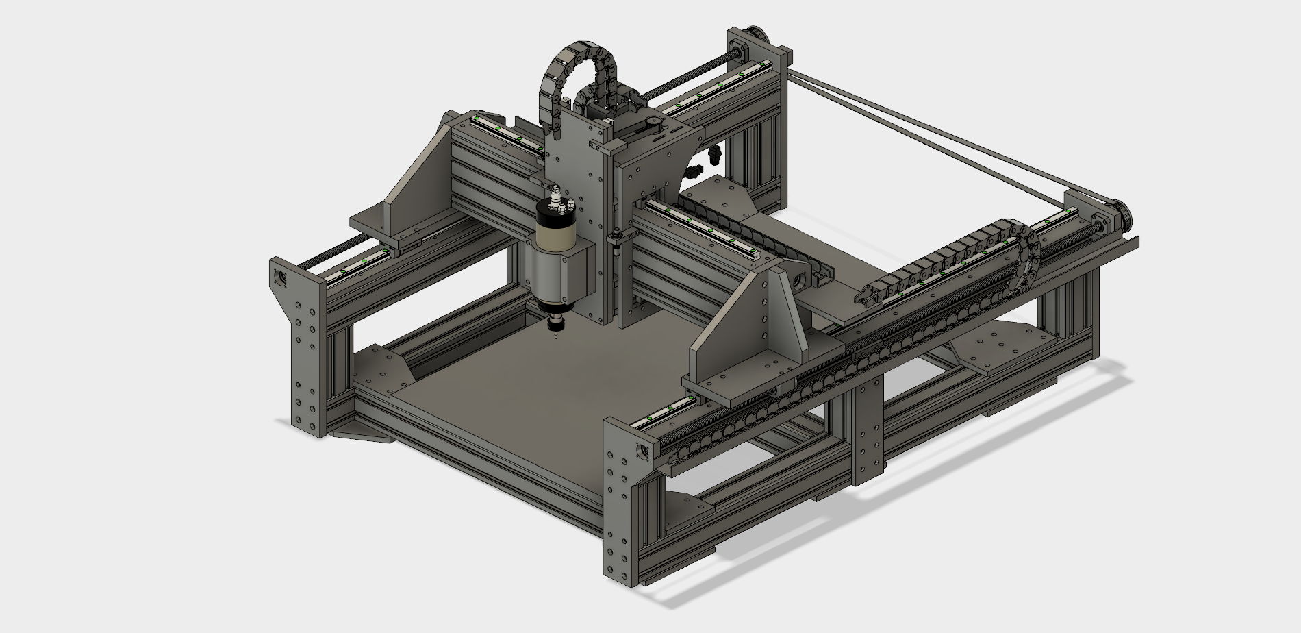

Aluminium Extrusion Router Build

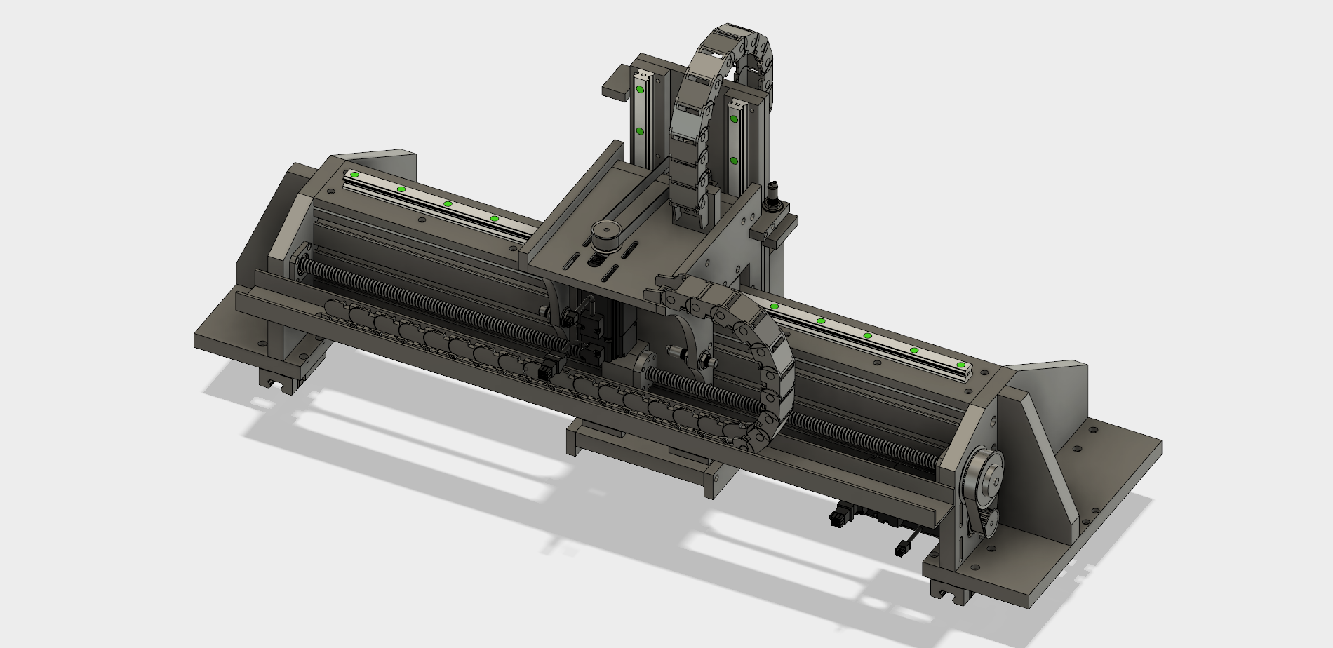

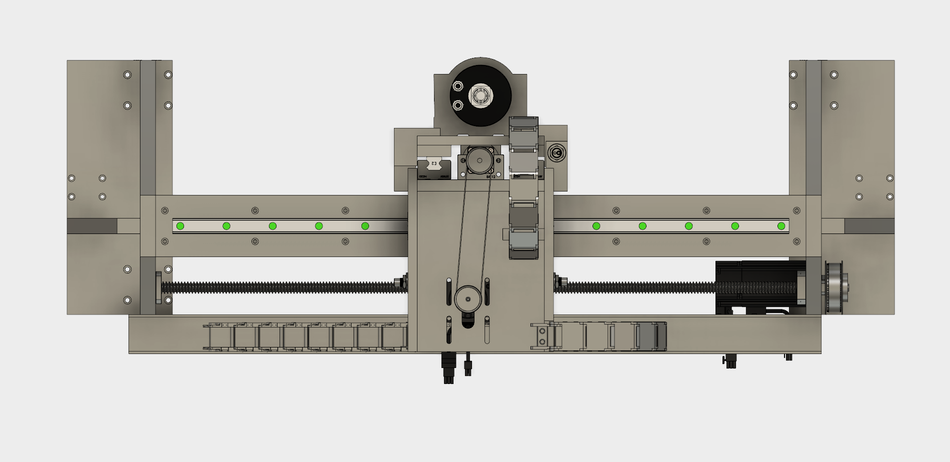

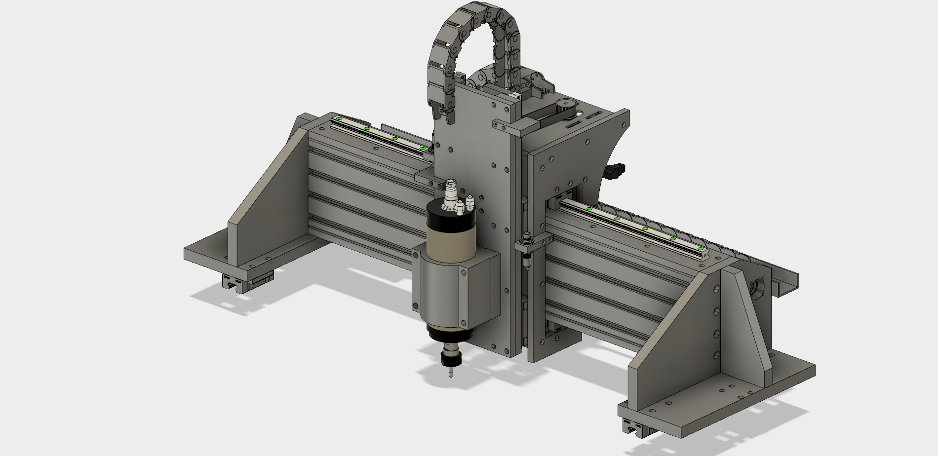

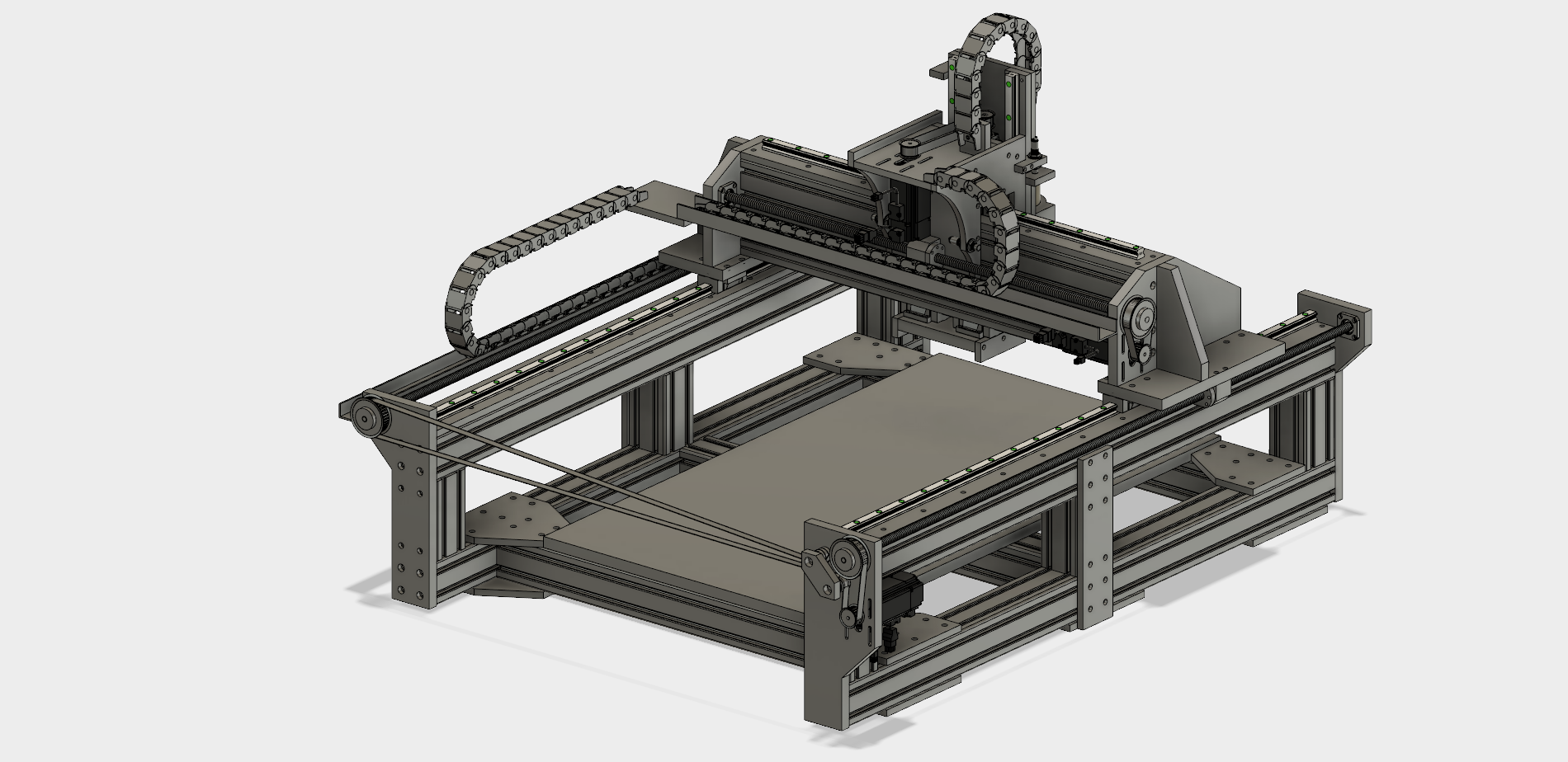

I've designed a router based on aluminium extrusion and would like to see if the experts on the forums have any advice or can point any silly errors that I've made.
The cutting area is roughly 600*1000 and it will mainly be used for hardwood cutting although it would be useful if I could do some aluminium as well. I've gone for a Z travel of 180mm as I would like to add a 4th rotary axis at a later date, but I'm not sure if that would adversely affect how it cuts aluminium.
I'm going to use Hiwin 20mm rails and carriages, with a 1605 ballscrew on the Z and 1610 on the Y and X axes. I was going to get the ballscrews from BST Automation and was wondering if anybody had used the 400W 60ST-M01330 servo motors that he sells, and if that is powerful enough to drive the X Axis.
I've designed it so there is about 40mm of spindle travel beyond the front of the bed, so I can cut the ends of larger items.
As for electronics, at this point I would love to use one of the CSMIO controllers.
Attachment 23388Attachment 23389Attachment 23390Attachment 23391Attachment 23392Attachment 23393

Not used those servos but the design is looking good and will run great with steppers

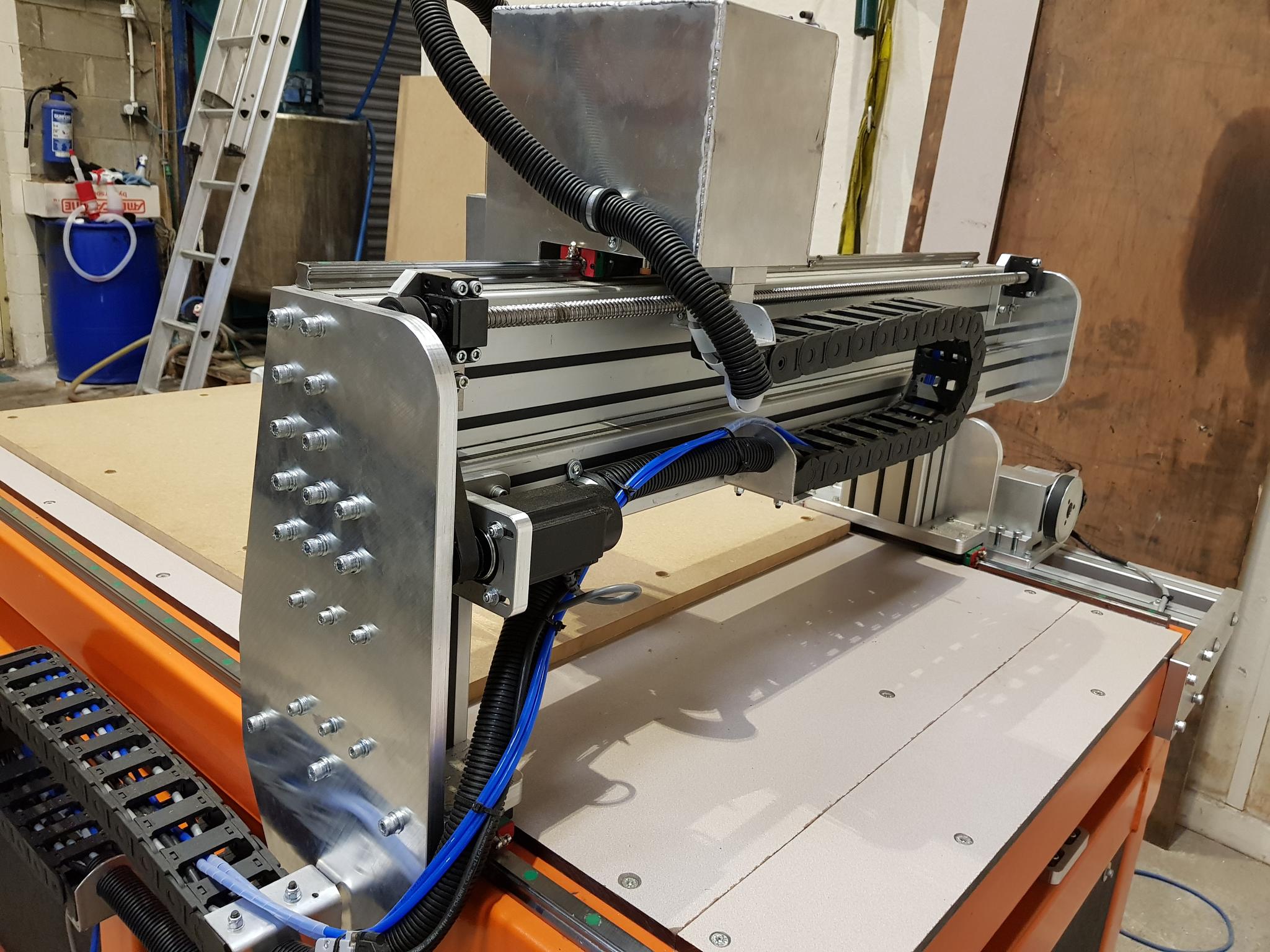

I managed to get some more done on the Z axis today and had a go at milling out the motor mount. I made a template out of 5mm HDPE to use with a template following bush in my router. With a 8mm end mill I made 0.5mm passed to slowly mill out the mount to the desired depth. For the large slot I used the same end mill, but for the small slots I had to drill a series of holes and file the sides flat.https://uploads.tapatalk-cdn.com/201...9f2a2d8b84.jpghttps://uploads.tapatalk-cdn.com/201...beb7432f7f.jpghttps://uploads.tapatalk-cdn.com/201...021e89c01b.jpghttps://uploads.tapatalk-cdn.com/201...c7456beaba.jpghttps://uploads.tapatalk-cdn.com/201...7a1e7fb0a2.jpg

I've got a bit more work done and have made the Z axis end plates. These were quite complex and I started with a large rectangle of 12mm aluminium. I used the table saw to cut the bottom leg and then drilled 16mm holes in the corners of the middle part to be removed. I roughly cut the shape out using a bandsaw and neatened the edges using an end mill in my router. The curved parts were roughly cut on the bandsaw and neatened up using an oscillating bobbin sander. Finally I drilled the bolt holes and the hole for the inductive proximity sensor. I've left the top motor mount a bit longer as I'm going to mount the Y axis drag chains to it and have yet to finalise the exact position of it. On a side note I've had a really good run selling a load of old car audio gear on eBay and have made over £1500 pounds so I'm seriously tempted to go with a complete CS Labs system, using their motion controller, simDrive servo controllers, servo drives and power supply.

Beautiful work!
Im amazed at the stuff you do with basic tools..
Keep it up!

Hi, thanks for the compliment, I'm quite surprised at how well the build is going myself. I have discovered however that the aluminium cuts a lot like high density hardwoods such as english oak, african blackwood or leadwood, although things need to be well clamped as the aluminium is a bit grabby. In others way it is easier as with a bit of cutting oil you can get really good cuts and keep the cutter cooler than when cutting the hardwoods. I cut a 35mm diameter by 12mm deep hole in one of the gantry end plates for the FF12 ballscrew support just with a standard forstner bit. With the addition of the cutting oil the bit never got very hot and when I had finished it was cool enough that I could hold it, definitely not the case when cutting the denser hardwoods with the same forstner bit.

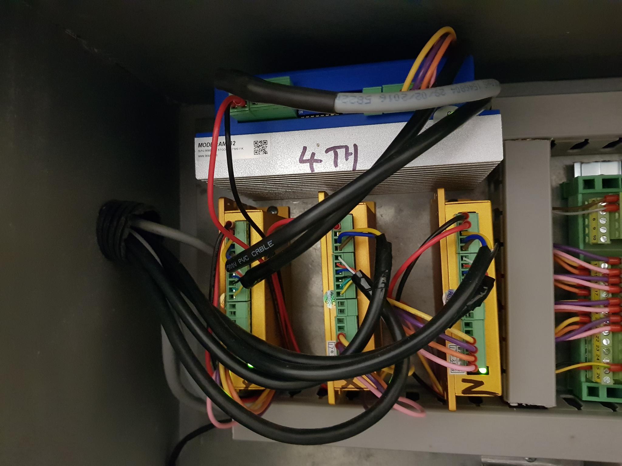

Would a 3Nm stepper be enough to drive the twin ballscrew X axis or do you think I would need a NEMA 34 motor. Having said that i would like a add a 4th rotary axis at some point and mount that at the back when the belt goes across to connect the X axis ballscrew so I might go twin motors on the X axis with the CSMIO to drive them. By ATC spindle do you mean auto tool change spindle?
No 3Nm won't be enough for 2 screws but would if had motor on each screw. Single motor you'll need 6 or 8nm nema 34.
I've used these on couple of bigger machines, nice drives and motors and never had any issues.

Hi Jazz, that Lichuan drive does look very nice, if I go down the nema 34 route instead of twin motors on the X axis. For the nema 24 motors I was looking at the Leadshine CS-D508 drive which appears to be very similar to the Lichuan LCD375H drive or maybe the Leadshine ES-D808 which I think is similar to the Lichaun LCDA808H that you used. On a side note I wouldn't mind supporting UK companies like Zapp but the price difference is huge. From Aliexpress I could get 4 ES-D808 drives and 4 ES-M22430 motors for under £600 and from Zapp the same price is nearly £1200! Even if you get charged £100 from customs this is a no brainer to buy from China. Even a CSMIO IP-S is roughly £150 cheaper if you buy it directly from CS Labs, and there is no customs charge as it's from the EU. I've got another small question, how much distance does the motor shaft have to go into the HTD pulley. If I used 15mm belts and pulleys which are approximately 25 to 30mm wide, if I loose 3mm to the mount would there still be enough shaft length to securely hold the pulley?
2 Attachment(s)
Re: Aluminium Extrusion Router Build
NFryer
I've also used the LCD375H and they are ok as well but let down by only being 50V which means running around 44V which ideally more would be better.

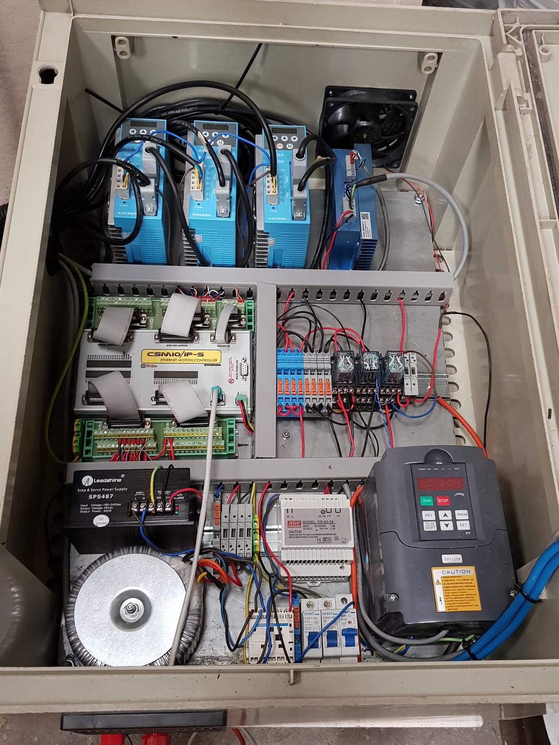

Finally I'm not the best with the electrical side of things. I shouldn't have a problem building a power supply for the drives, but I'm a bit confused with the wiring between the CSMIO and the drive. I was looking at the Lichuan drive and the Leadshine easy servo drive and both seem to accept 24V input with the use of current limiting resistors on the step and direction inputs for single ended. For the differential connection do you not need the resistors as in the data sheets, the differential connections are shown with a 5V connection. Can you not directly connect the drives to the CSMIO, or do you have to reduce the voltage for the differential connection.

NFryer
No don't need resistors the CSMIO Step/dir Outputs are 5v not 24v.

I've now got the inductive limit sensors mounted for the z and y axes. I've got a 2 core CY cable to supply the power and a 4 core CY cable for the signal outputs. I used a couple of 5 way terminal blocks to connect the power leads of each sensor. I also tested a sensor and it seems to work well on aluminium with the output dropping to 0V when it is approximately 4mm away from it.
I've also got the aluminium profile that I need to build the frame from KJN Aluminium Profiles. They provided me a very good customer and the profile seems to be cut very accurately and pretty much bang on square as well.
Finally I had a bit of a puzzling problem with the Y axis ballscrew. As I was moving the Z axis along it would get harder to move towards either end of the travel. After a bit of measuring and checking I found that the 15mm plate the ballnut mount is fastened to was actually about 15.5mm thick which was enough to cause the problem. I took it apart and skimmed 0.5mm from it around the ballnut mount and put it back together. I tried to put the ballscrew back and found annoyingly that I couldn't. Apart it came again to skim the whole area to the side of the mount to allow the ballscrew to slide in.https://uploads.tapatalk-cdn.com/201...49f52130d1.jpghttps://uploads.tapatalk-cdn.com/201...293200a1cc.jpghttps://uploads.tapatalk-cdn.com/201...4050034128.jpghttps://uploads.tapatalk-cdn.com/201...fd13088847.jpg

Hi everyone, just a quick question regarding the design of the linear power supply for the stepper motors. I'm going with a transformer power supply and know to take into account the mains power supply variations to calculate the DC output but what margin should you leave for the voltage rise caused by the motors back EMF. Also I'm using quite a large toroidal transformer as I've got 4 motors to power, does anybody use inrush current limiting, as there are some nice looking 16A Sedlbauer current limiters on eBay at the moment for £30. Thanks in advance for any help.
What size toroidal, what motors and what drives are you using? Too many varables
NFryer
I am using inrush current limiter, I think it's a MUST have with toroidal transformers. If you have a mains fuse of 16A then you can use that one, but if your mains fuse is smaller then you should use a smaller one.
Clive S
Hi Clive,
The drives and motors I'm using are the Leadshine Hybrid Stepper ones, HBS86 drive and 60HBM30-1000 NEMA24 motor. The drive has a maximum voltage rating of 80VDC. The toroidal transformer which I haven't got yet will probably be a 45VAC+45VAC 1000VA one from Airlink transformers. I did the following calculations to arrive at this, and if you see any obvious errors can you tell me.
The motors are 2 phase with a current of 5A per phase so 10A per motor. The motors have 4 power leads which means that they will probably be series wound so I think that the motors will pull approximately a third of the maximum, so about 3.3A per motor. I'm using 4 motors so the total current draw should be about 13A.
For the voltage I took the mains voltage +10% as a worst case so
45VAC + 10% = 49.5VAC
49.5VAC + 4% for transformer regulation = 51.5VAC
51.5 multiplied by 1.414 = 72VDC
72VDC - 2.2V for the bridge rectifier drop gives roughly 70VDC output.
Hopefully this is alright and I haven't made any obvious errors.
