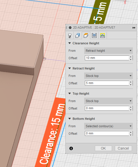

First of all, You haven't given us quite as much information as I would like - a screenshot showing the CAM model with the various heights shown would help, along with a copy of the setup/operations list on the LH side of the screen. So what I say here is guessing at what these might show but this is based on my own use of F360 (which I use a lot for design and CAM).

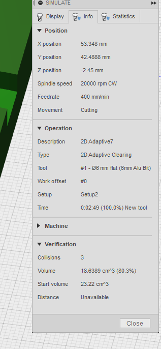

Based on what I think you are doing, two quick answers. First of all, F360 is doing exactly what you told it to. No more and no less. Secondly, it will cut your pocket to exactly the correct depth as you have it; the simulation shows the pocket depth being 2.45mm deep. That's not an error - in the operation tab, you told it to work with top height equal to stock top - and the pocket is 2.45mm deep from stock top. Best way to fix this is just to change "top height" to reference model top, not stock top. That should work OK.
What I am not sure about because I can't see exactly how you have set up your operations is whether it will start cutting from stock top (so cutting air for 0.45mm) or from model top. I would create one setup and then under that create two (or more - not sure what else you are doing) operations. The first is to face the stock and second is to cut the pocket. I've just thrown a quick F360 model together and tried the CAM operations. I used facing and pocket under 2D (you can use 3D pocket clearing but this just complicates things when you are really cutting a 2.5D feature) and running the simulation it seems to do exactly what you want - the pocket cut starts at the top of the model, not the stock.
