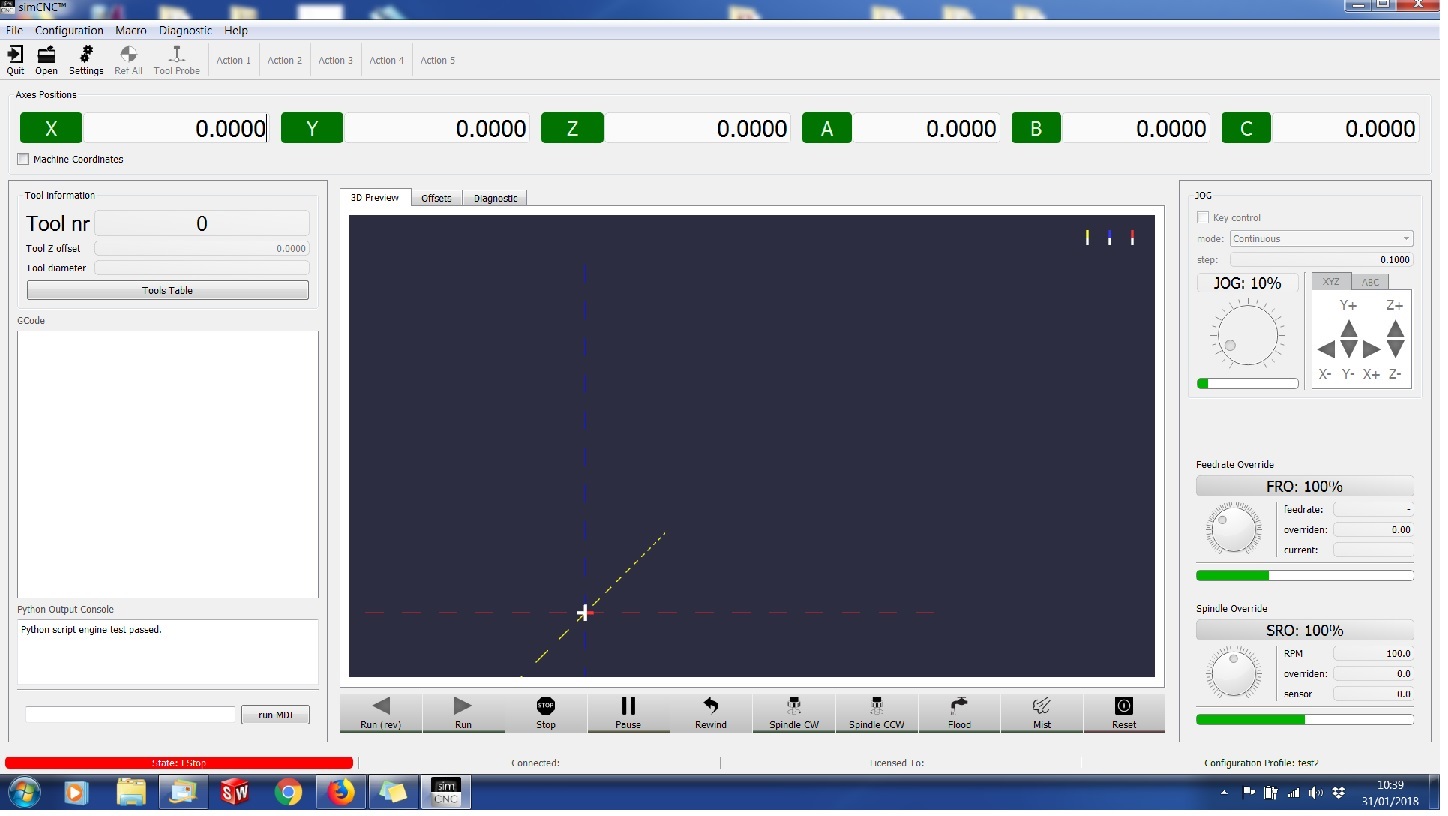

Here's the front end. That's far as I've got so far. I'm having trouble updating Firmware and until it's done can't use it in anger. I'll start a thread with any issues I find and why can't update firm ware etc. Thinking it's dodgy Firmware or loader because I've updated many these controllers without issues.
Attachment 23694

JAZZCNC
Attachment 23694
Am i right in thinking that it doesn't run without CS-LAB hardware connected?

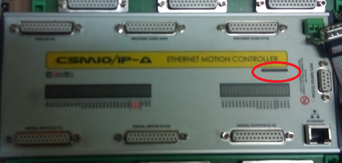

Is yours an earlyish one? The controller needs to be one of the newer FP4 versions for SimCNC. If you look on the front of the CSMIO, you should see FP4 in small writing to the right hand side below the yellow bar.
Re: Cslabs now have Own Control Software
Here is where it will say fp4.
Attachment 29584
