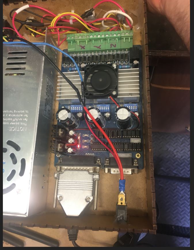

		Hi team.
I purchased a 2nd hand 300x400 cnc router that has the USB to parallel port conversion. See pic.
The previous owner was using madh3. Saw it running and have no issues parting with my Pennines..
So. I got it home, had a few health issues and then now finally after what seems like months I get it connected and downloaded the Mach3 software..
However connected the machine and my PC (windows 10/64) identifies it's there but I can't find the driver so I can connect.
It's identified in the device list as "CNC control via USB"
Would appreciate any help that you guys can direct me too..

		When you say Mach3  and usb to cnc, do you mean you have a UC 100 ? This would replace the parallel port connection. If this is indeed the case, you will find what you need here :-  http://cncdrive.com/UC100.html
If not the UC 100, then you would need to explain in more detail.

 I really don't know what it is, it doesn't have any writing if details on it.. it's a plug that fits in to the printer port on the board and has a USB port on the other end to allow me to plug a USB lead in to it.

 I have a picture in Jpeg but it won't allow me to upload it for some reason.. picture paints a 1,000 words. So to speak..
Just clicked the link, it does look similar but it's all steel and has a micro USB plug on the input end..
2 Attachment(s)
		Re: Mach3 and USB to cnc driver
		Picture of the adaptor and box.
Attachment 24581
Picture of message on device driver..
Attachment 24582

 Indeed, that is part of the confusion. It's not obvious from the outside but the UC100 is not a USB to PP converter. Yes, it looks like it is, but it actually has a lot of added intelligence inside. To drive a CNC machine, you need something to read gcode, analyse it, work out where the axes need to move, and generate several series of precisely-timed pulses to drive each axis. Plus a user interface and the various housekeeping jobs like homing, managing limit switches, etc. Mach3 is OK for most of this, but can struggle with generating the precise timing that is needed for the various pulse trains to make a machine run smoothly at speed. Actually, the limiting factor is Windows, for various reasons, but we don't need to worry about that level of detail. The UC100 offloads the time-critical bits of the job - the pulse generation - and leaves Mach3 to do the bits it's better at. Again, this is an over-simplification but the general principle is correct. The UC100 is designed the way it is so that you can upgrade an existing PP system just by inserting the UC100, and installing and configuring its Mach3 plugin. If you have a spare usb port, it's as easy as that.
The UC100 is in current production with full support from its makers; I've no idea what's inside the fake versions but they are notoriously unreliable. You could think of the UC100 a bit like a grbl board - it does some of the trajectory planning ("where is the machine going?") and pulse generation, but needs something else to feed it gcode. My limited experience of grbl is that it works ok within its limitations but the various user interface options available are very limited; the UC100 works very well indeed and supports full Mach3 user interface functionality.
Additionally, because the UC100 offloads the time-critical bits, it allows Mach3 to run on versions of Windows which do not use the PP.

- you said that you are running W10/64. You cannot run Mach3 with parallel port on W10/64 (it just does not work), so you are going to need an external motion controller. This could be USB or ethernet but using the parallel port is a definite nono with your Windows version. That is why just replacing the BOB isn't going to make a difference - you don't have anywhere to plug it in except for a proper UC100 as you cannot use a PC parallel port (if your PC even has one - they are becoming uncommon on modern machines)
- When I say "external motion controller" (and the UC100 is one of these) I most definitely mean motion controller. You cannot use a USB-to-parallel converter. These are available but are really intended for use with things like printers which are not very critical with respect to signal timing. CNC machines, on the other hand, are very sensitive to signal timing which is why the simple converters do not work. Your "external unit that is either flashed or direct USB controlled" is, in reality, a motion controller.
- what I have said here also explains A_Camera's comment - you cannot drive your machine with a simple BOB directly from the PC because the BOB wants to plug into a parallel port and even if your PC has one, it cannot use it with the W10/64/Mach3 conbination, unfortunately. So you need an external motion controller. The UC100 plus cheap BOB is probably the most cost-effective combination available and it is the kind of thing that everyone starting from scratch these days is going to need because of the W10/no parallel port issue. There are more sophisticated motion controllers available that use ethernet rather than USB, have built-in BOB functionality, etc, but generally these are going to cost more than the UC100+BOB option.

		The UC100 is a motion controller for use with either Mach3 or UCCNC.
The DDCS is a complete standalone controller, that requires no other hardware.

I have now installed the old PC and got it running through the PP for now..
Thanks for everyone's input and guidance of what the issues are and finally getting to the bottom of it as I didn't understand about the UC100 issue.

 A UC100 and UCCNC is most definitely an upgrade.
Silver
			Thank you, it was a misunderstanding on my behalf as I understood from your comments that I would need the motion controller UC100 no matter what I upgraded with.
That's what I couldn't understand.. But I do now..
Thankyou and now fully understand what's needed, it's purely me not wanting to invest in something just to get me going when I could upgrade it..
I will be surfing the forums for the upgrades solutions going forward..
Thanks again everyone..
 If it runs well through the PP and you are happy with it then just leave it as it is for now, until you know what you need. In my opinion the UC400ETH would be a better upgrade than the UC100, but again that's just my opinion.
You don't "need" the UC100, but you MUST have a motion controller if you plan to use W10 or W7 64 bits. The PP is not supported by Microsoft after W7 32 bits.
