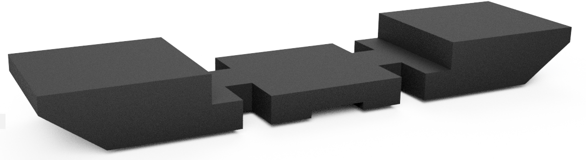

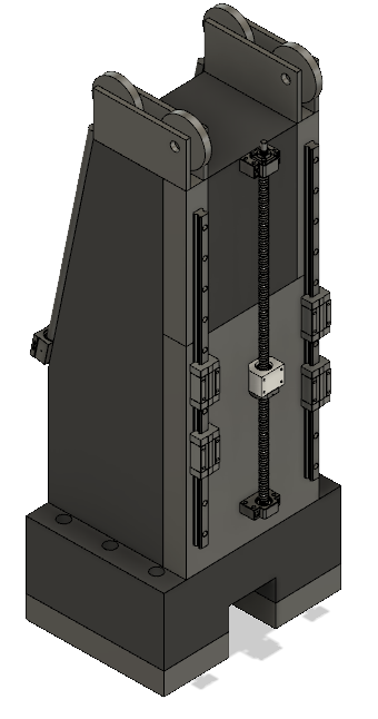

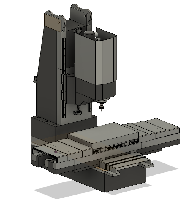

Right so I've started on an large cast iron/EG mill build. Plan is to use several cast iron surface plates I have bought on ebay and embeded in epoxy granite, the hope is this will give me a flat surface to mount the linear rails to.
This is the current design in fusion
Attachment 24628Attachment 24630Attachment 24631
Travel: X 400mm, Y 250mm, Z 400mm
Total weight 600-800kg
Rails: 20mm hiwin clone rails
Ball screws: Generic rolled Chinese ball screws, with a plan to upgrade in the future.

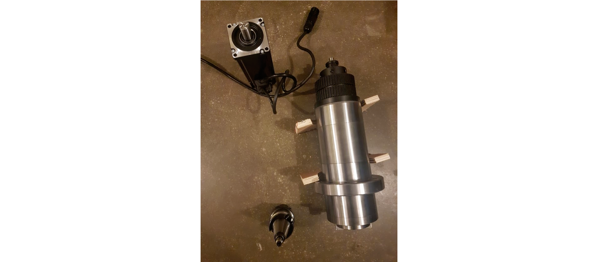

Spindle: Initially: 2.2kw water cooled spindle. The plan would be to upgrade to a BT30 and 1.8kw servo from AliExpress if I can get this made and then integrate ATC
Electronics: UC400 ETH, Initially steppers, with upgrade to 400W AC servos.
Epoxy granite: Silimix 282 + west systems epoxy 105/206 10% by weight, 0.25% black iron oxide

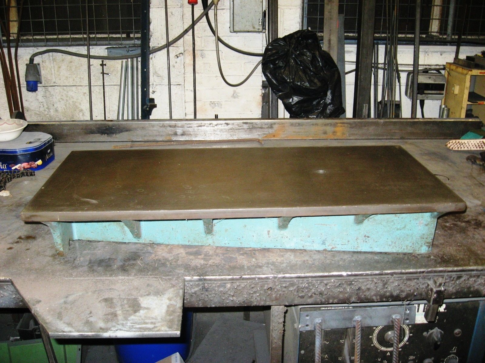

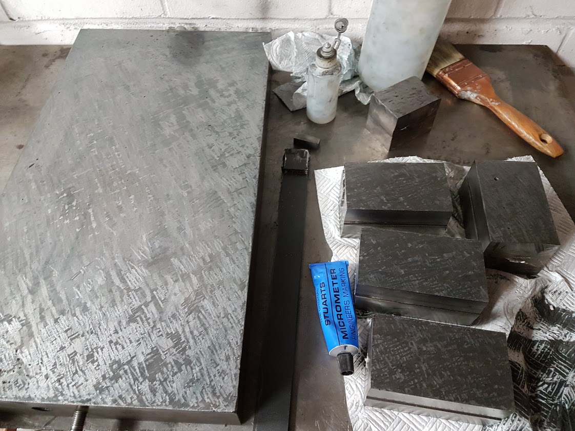

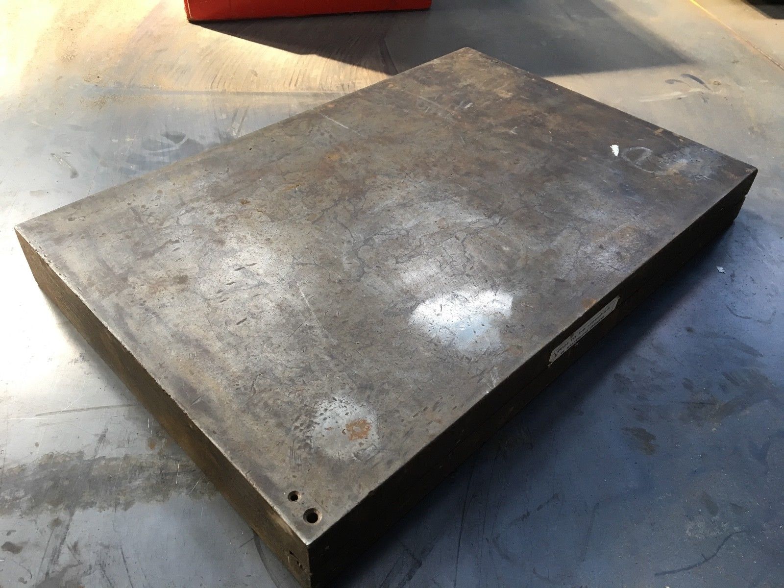

Cast iron:
I’ve got one 36 x 16 inch plate
Attachment 24629
Along with four of these 18x12x2in plates
Attachment 24627
The large surface plate is reasonably flat, however the smaller plates are out by about 0.05-0.15mm. I am planning on trying to hand scrape them flat.
Issues:
1. I have got to cut one of the cast iron plates into four for the column mounting blocks, I’m not sure how I will do this as they're 2 inch's thick, I think I will try with a cutting disc
2. The column and table will consist of more than one cast iron piece, I’m not quite sure what the best way to keep alignment is, I think I will have to use a flat surface, possibly the big surface plate to cast against and an angle plate.
I've got the epoxy and Silimix. I have made the mould for the base and I think I will cast this first to check that the epoxy granite doesn't warp the surface as it sets. I'll post back with the results!

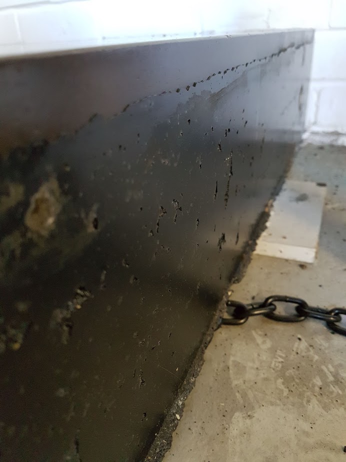

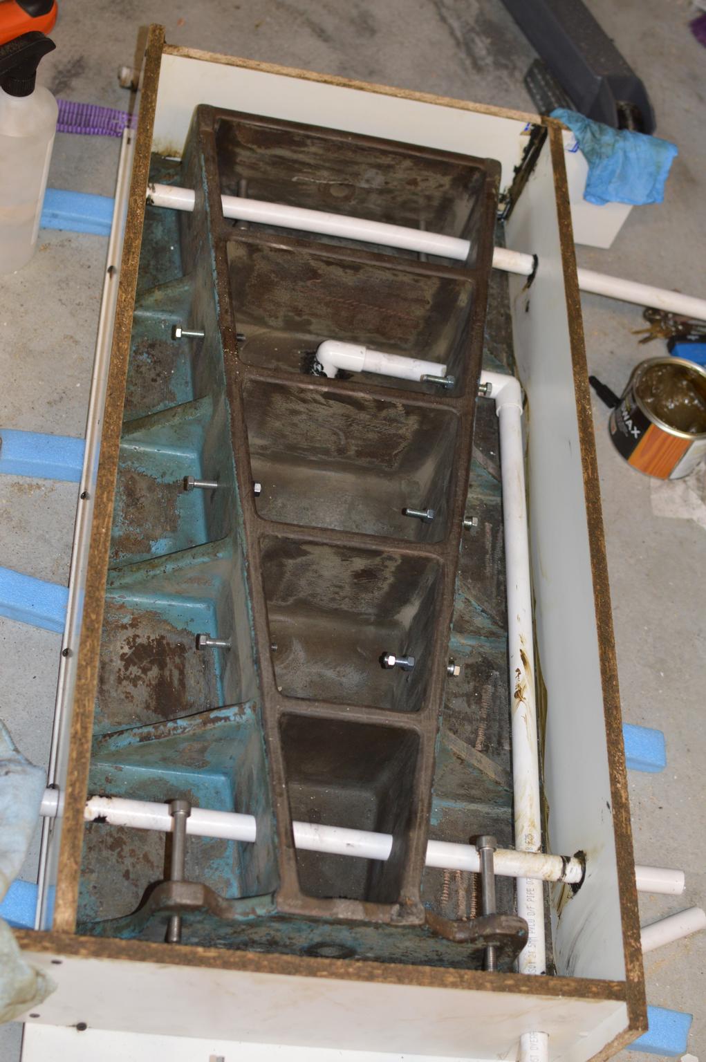

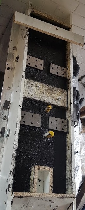

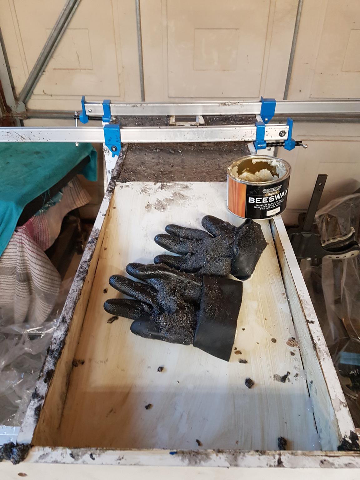

Right so I’ve casted the base. I started by preparing the surface plate, I cleaned the underside with a wire wheel and then drilled and tapped several holes for M6 and M10 bolts, so the epoxy would anchor.
The surface plate had a hole drilled in the top when I got it, I thought this might be helpful to run wiring/pipes through, so I routed some PVC pipe to the back of the surface plate. Before I decided to cast the surface plate in epoxy, I did briefly try and cut it, I sealed this cut with silicone. I also drilled two pairs of holes in each side and passed pvc pipe through, this will let me pass some chains through to lift it.
The mould was made of melamine "furniture" board I got from wickes, sealed with silicone and then three applications of wax were applied (three was necessary in testing, it's a huge pain when it sticks). The surface plate was lowered with an engine crane face down into the mould.
Attachment 24642

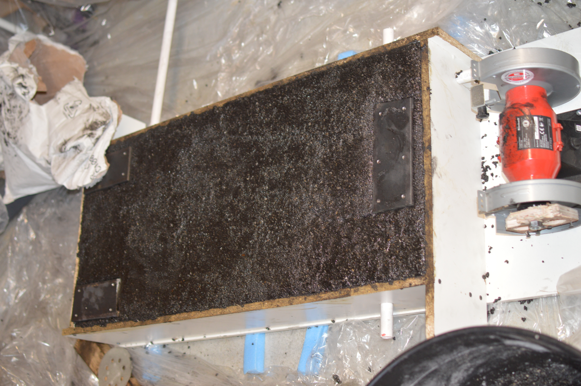

Mixing the epoxy granite was the hardest part, it took ages. We did it in 25kg batches, with one person packing the mould while the other used a hand held mixer. We also had a bench grinder attached to the mould, with an eccentric weight, but it quickly ripped itself free of its base. It took just under two hours in total and I managed to add some steel plate to act as mounting points later on and a small section of steel as a future motor mount.
Attachment 24643

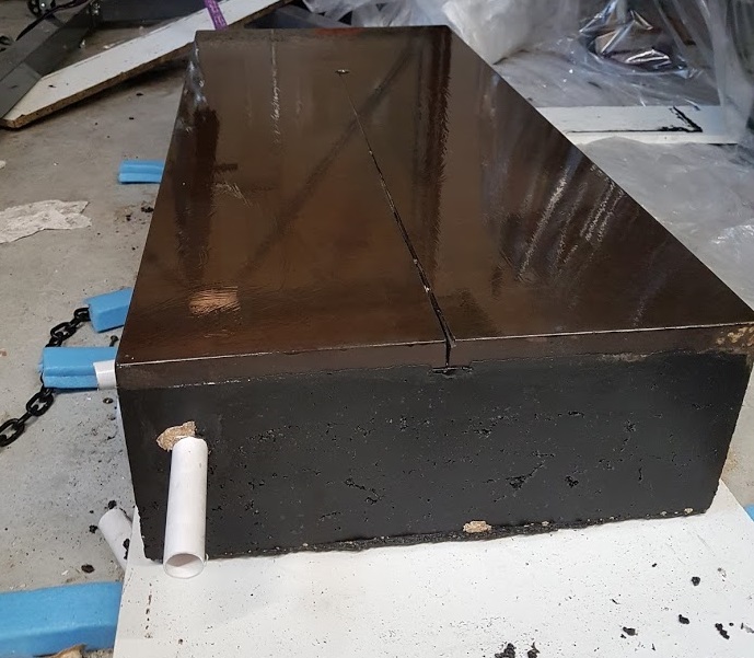

I let it cure for about 48 hours before removing the melamine mould.
Attachment 24644Attachment 24645
There are some areas that haven't fully combined and some air inclusion, this is worse on the side away from the bench grinder and I think related to poor vibration. But overall i'm fairly happy with how it turned out. As a very crude test, I've put a tenth indicator on a 30cm extension and jumped up and down over the base, I can't really get it to deflect. It weighs about 220kg now.
I was also concerned that the curing epoxy would warp the surface, so I tried to map out the base with a indicator, there is very little movement (apart from the end I cut which shows about 2 thou of deviation). I also used a 2 foot straight edge, I can't pass a 0.02 mm feeler gauge under it. I don't think its warped significantly.
Next step is to scrape all of the cast iron inserts for the column, I've started to do this, its slow work, but I think will be possible. I'm going to have to think of a way to level the end of the base, my surface plate isn't big enough so i'm not entirely sure how to do this?

Re: Epoxy granite vertical mill build log
The area to flatten is 900 x 400mm and my surface plate is 600x600.
Yeah I talked myself out of it a few times. I'm not sure its going to be very economical, the BT30 spindle itself is a substantial cost.
Chaz, I found your concrete build very interesting and I've thought about a moglice/DWH approach. I'm lacking a big enough reference surface though, any ideas on how I could overcome this?
I'm starting to wonder if I will have to leave the base as it is. If I could be confident in the way I was measuring it and I was sure it was flat to say 0.02-0.05mm I would probably be happy and just shim/scrape it later. Does anyone a good way to measure how flat a surface is that's bigger than your reference surface?

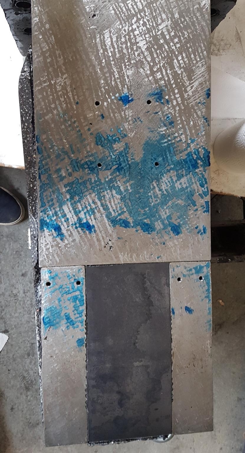

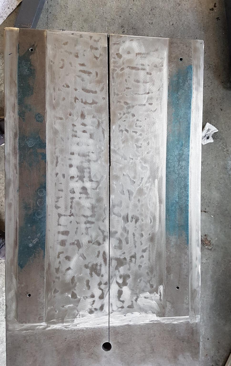

3 Attachment(s)

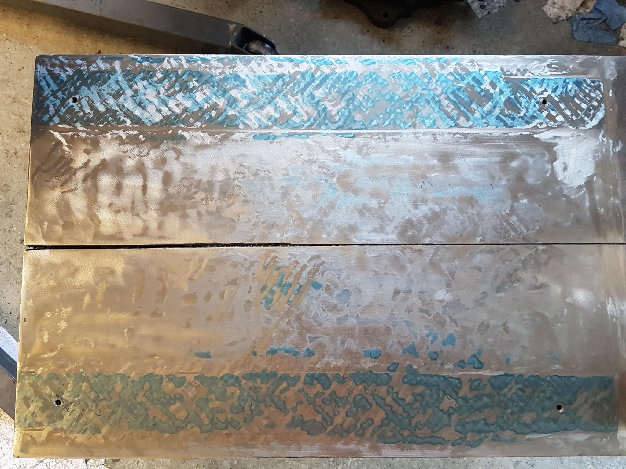

This is a bit delayed but I owe a big thanks to Chaz who has let me borrow his reference surface. It has been really helpful and I am not sure how I would of progressed without it. I tried to pick it up in a Fiesta, which unsurprisingly didn't work, thankfully it came on a pallet.
I've been making slow progress, I settled for an angle grinder for the cutting of the cast iron blocks, it took forever... I have managed to rough scrape all the surfaces for the column.
Attachment 24898
These blocks of cast iron are the ones highlighted below.
Attachment 24900

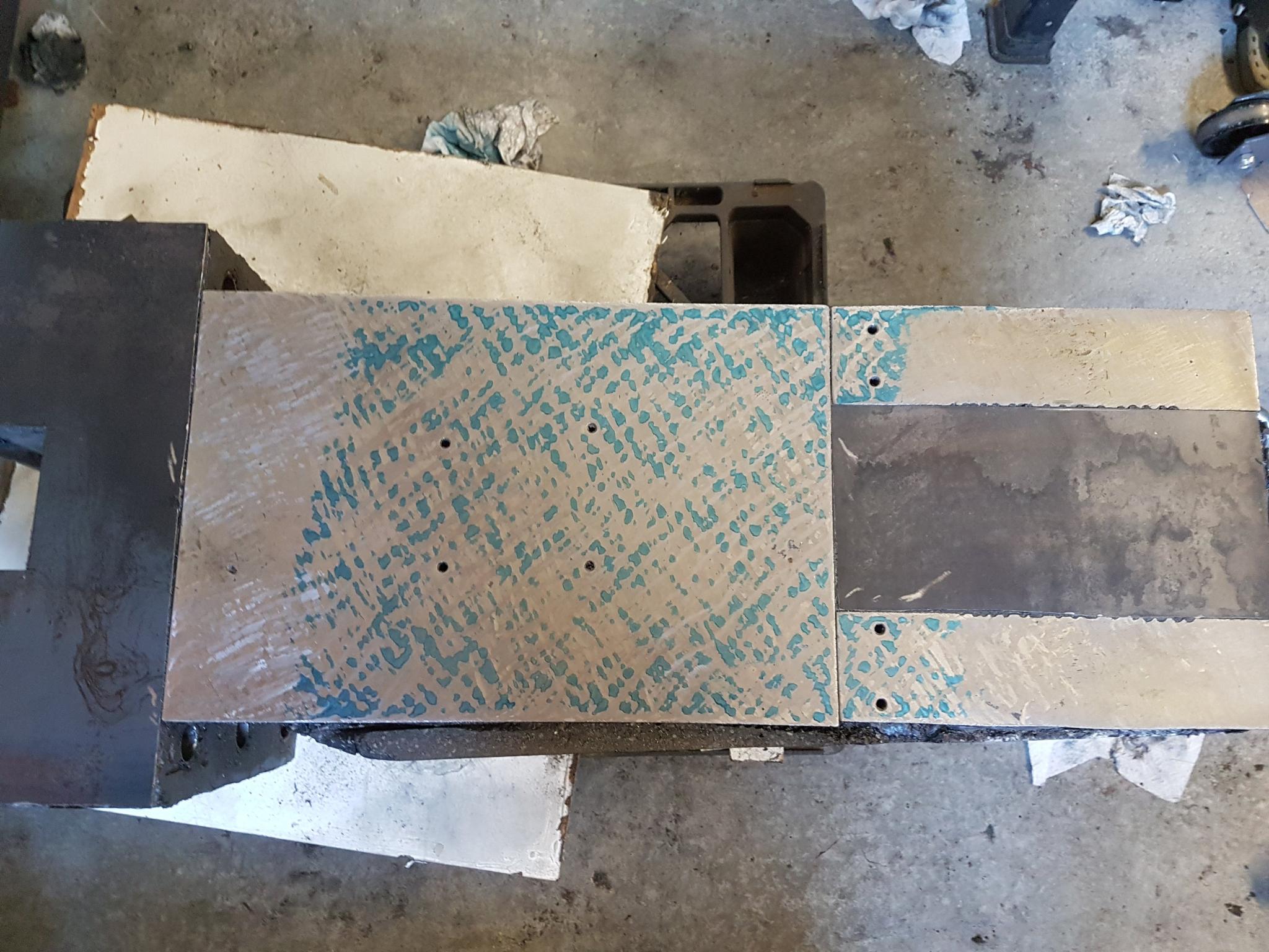

I have also scraped the main cast iron block.
Attachment 24899
They're not perfect but within 0.03 mm. I am making the mold and getting the inserts ready, I plan to cast the column next week. Just trying to work out how to drill 18mm holes through the 2 inch cast iron blocks, my drill press isn't up to it and I really don't want to have to buy a mag drill, I don't know if anyone has any other ideas?

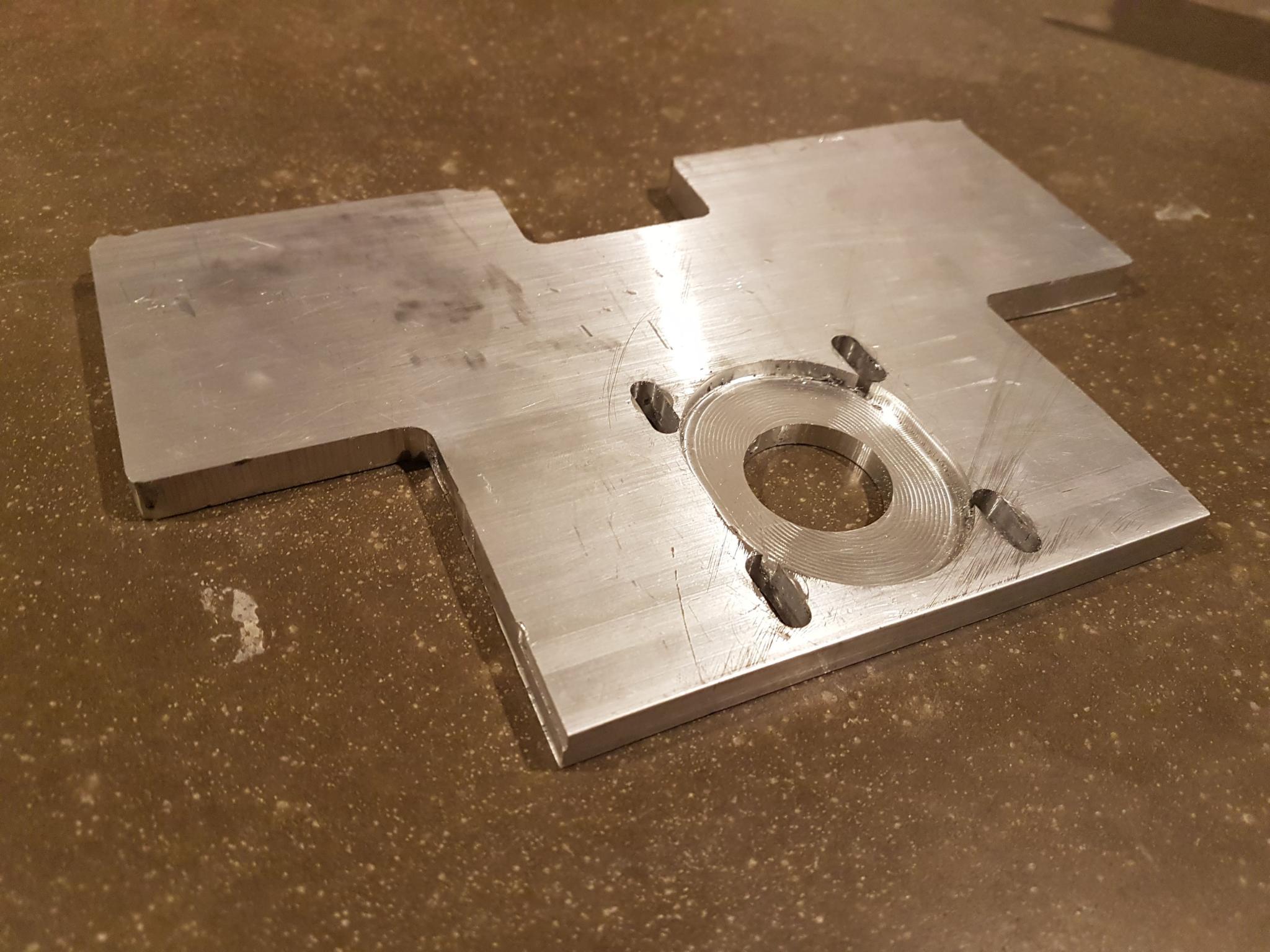

2 Attachment(s)
Quick update
That was a great idea with the lathe cross slide although I couldn't quite get it to work, having issues with its size. I ended up getting a mag drill... Drilled 60 holes and tapped for the insert bolts.
Attachment 24938

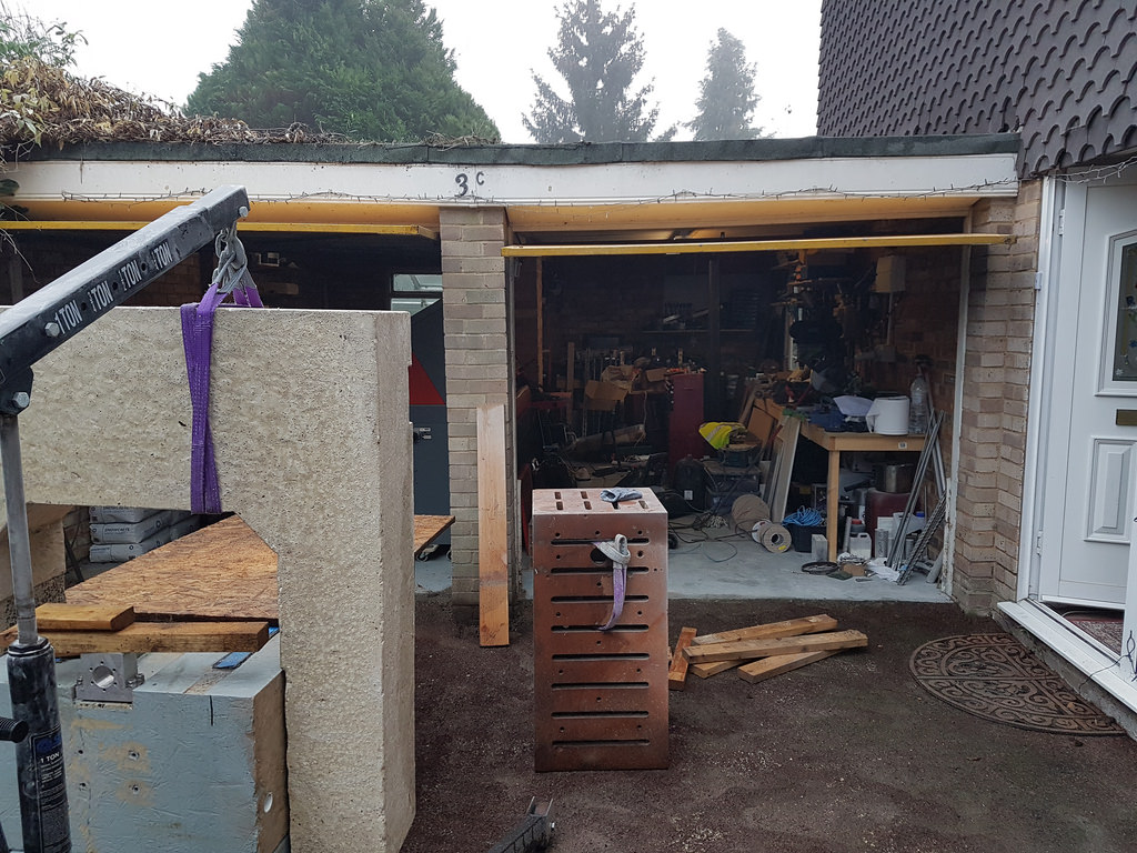

5 Attachment(s)
Small update

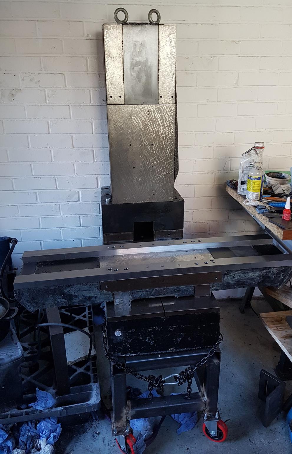

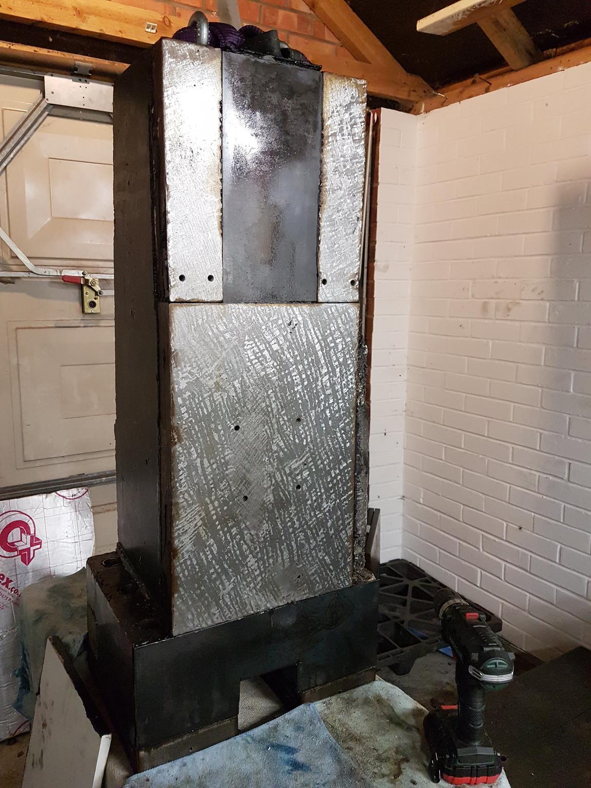

I've made a temporary stand and put the column on the base
Attachment 25159
I don't have a square big enough to see how perpendicular it is. Has anyone bought a granite square ? the only one I can find is this one
https://www.zoro.co.uk/shop/measurin...MaAg9CEALw_wcB

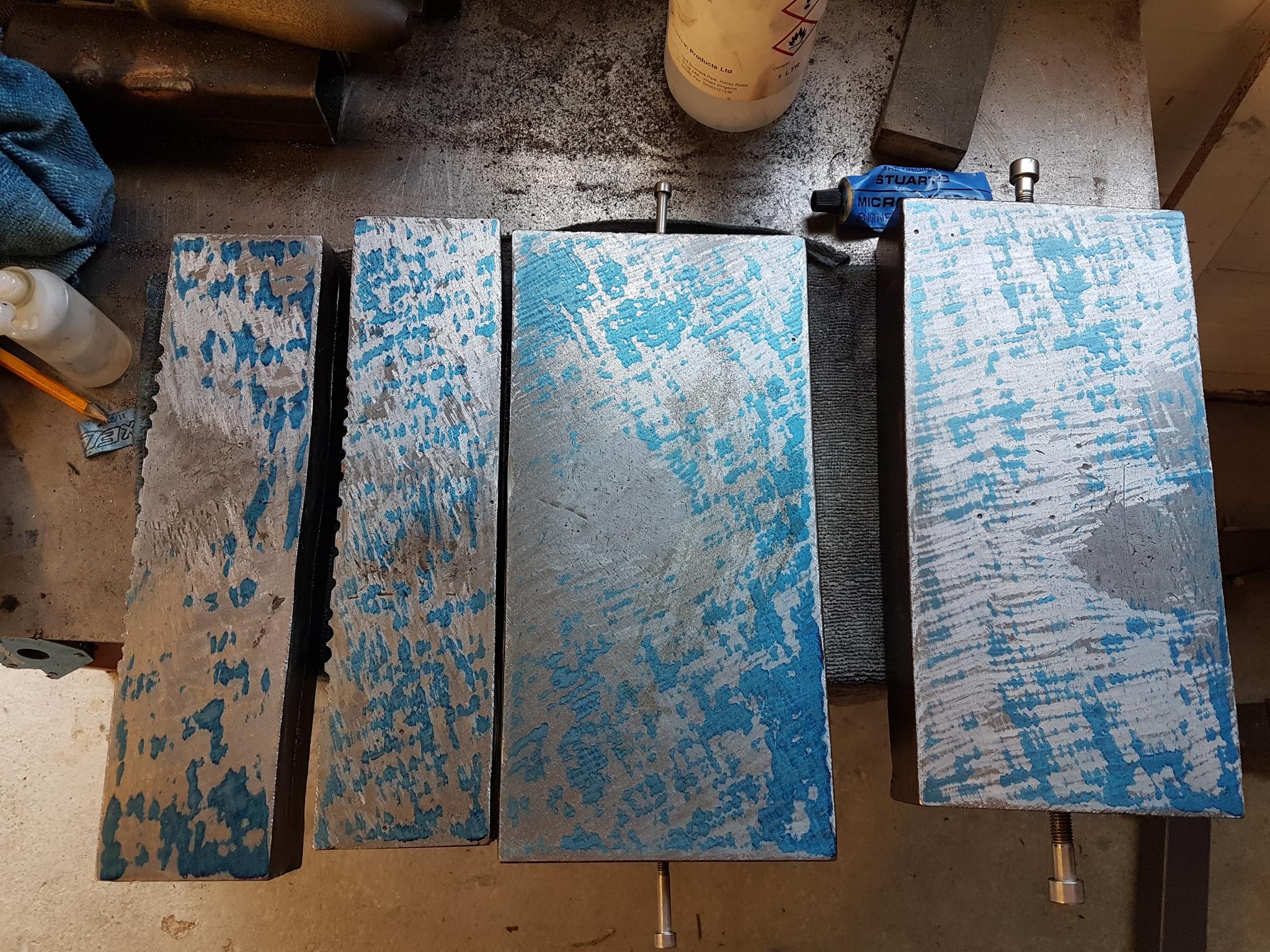

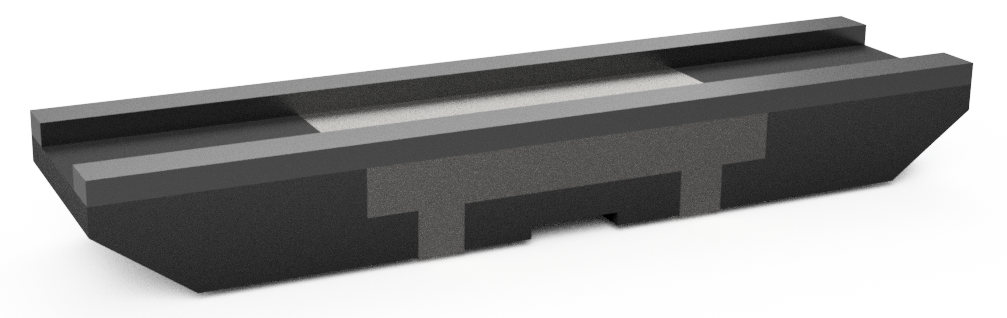

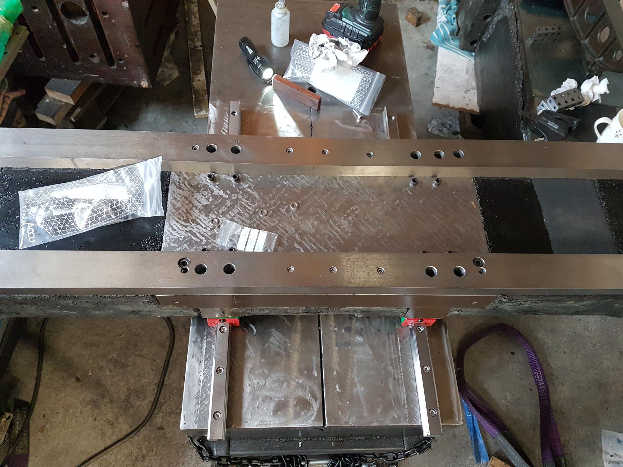

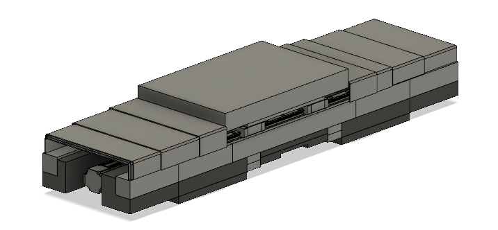

I have been making slow progress with the table, I have reduced the table width to 240 mm and I've got two ground 25x50x1000 mm bars to use as the rail mounts.
The table "offcut" from reducing the table size width has been cut into four and scraped flat and parallel to act as spacers. I was starting to scrape the table flat but the carbide came off my scraper...
Attachment 25158
I am slightly concerned that there isn't enough support under the steel bars and they will deflect. You can see this in the renders below, with the overhanging steel bars and the small amount supporting epoxy granite. I'm thinking about adding some threaded rod or increasing the thickness of the epoxy, i'm not sure if this is necessary though, thoughts on this?
Attachment 25153Attachment 25157Attachment 25156

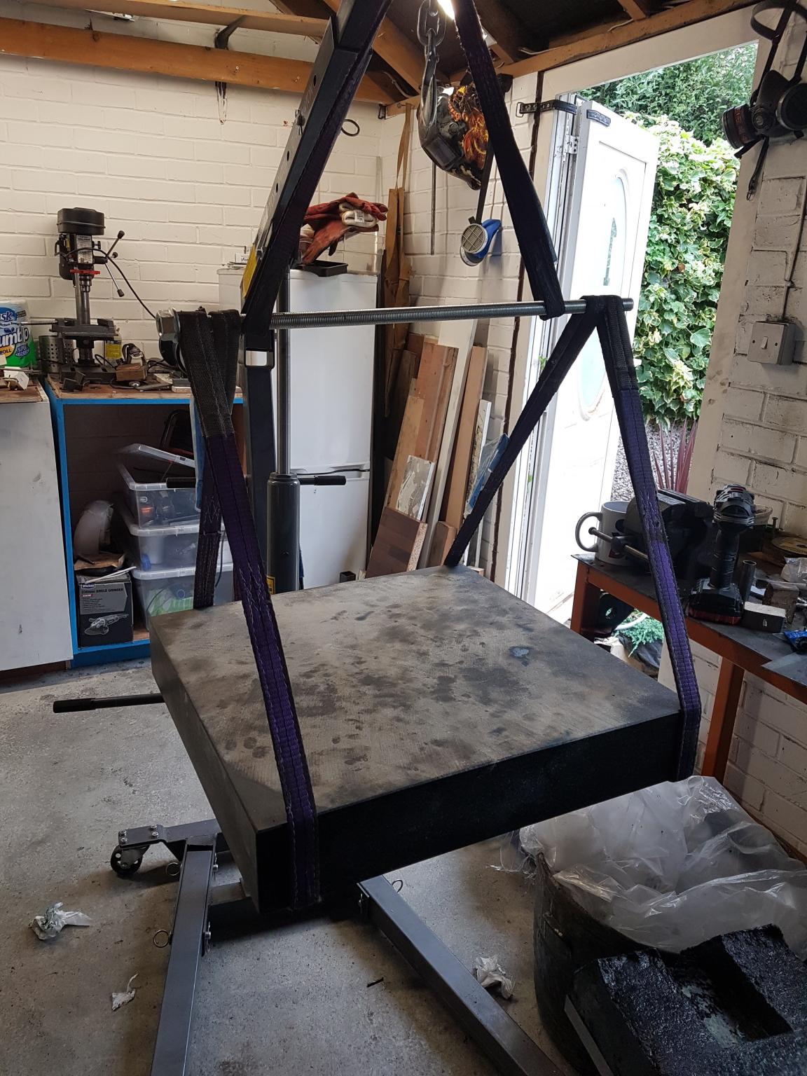

Some progress:
It started to look a bit like a mill:
Attachment 26698

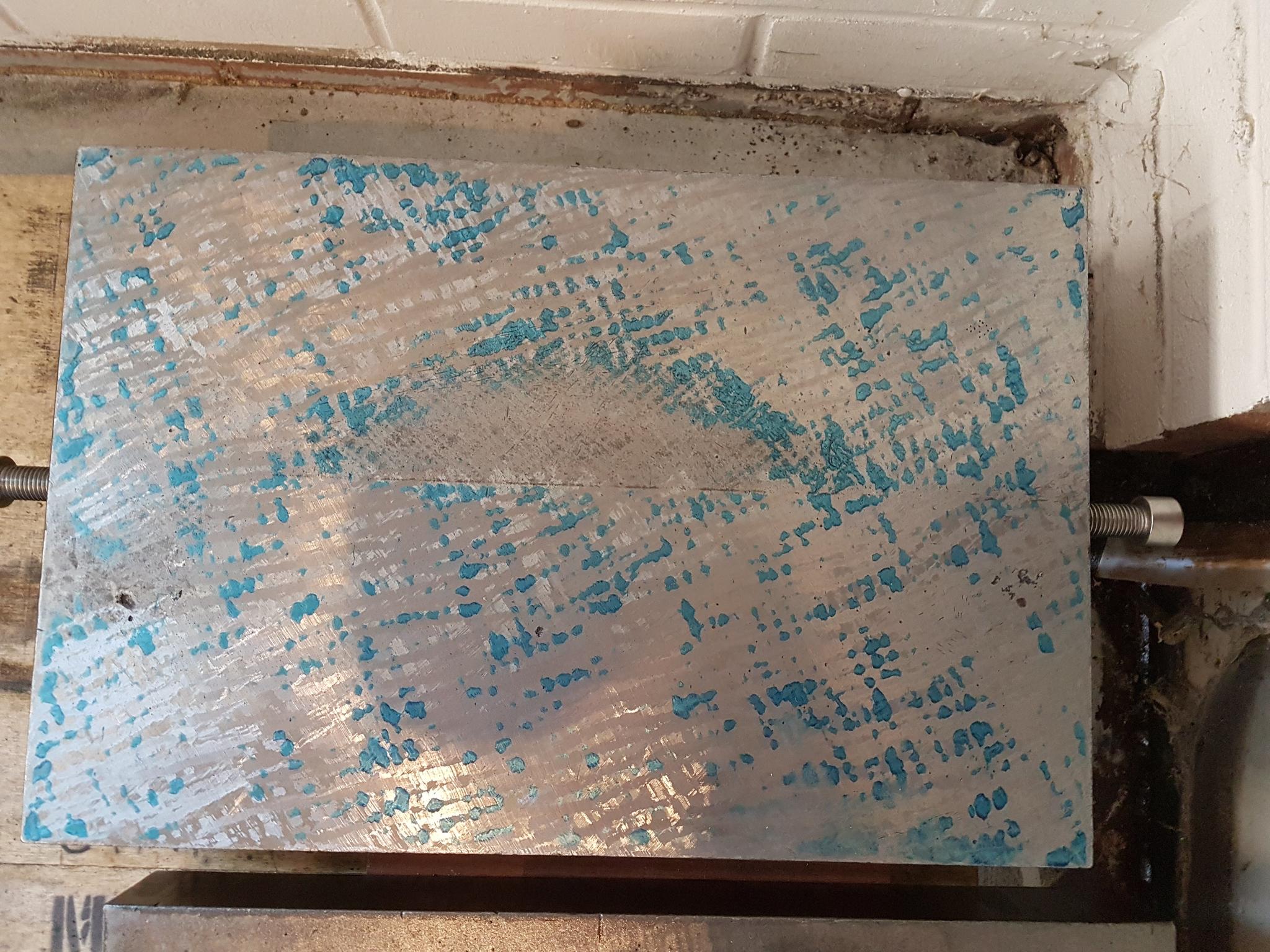

Next step was to flatten the base casting so I could get the rails on. It was to big an area to scrape and the reference surface and base were to heavy to invert. So I blocked off two rail sized areas with wood and then used an angle grinder to lower the rest of the surface, a bit crude but worked well.
Attachment 26694
I then flipped my surface plate and lowered it onto the base. It wasn't that far off, you could see damage from the previous owners of the surface plate.
Attachment 26692Attachment 26695
After several rounds of scraping, it is flat to about 0.02 - 0.03 mm
Attachment 26697
Y axis and saddle installed:
Attachment 26691
Next step is to flatten the Z-axis rails, im using the same process as with the base, flipping the surface plate, it's really slow going.
Attachment 26693Attachment 26696

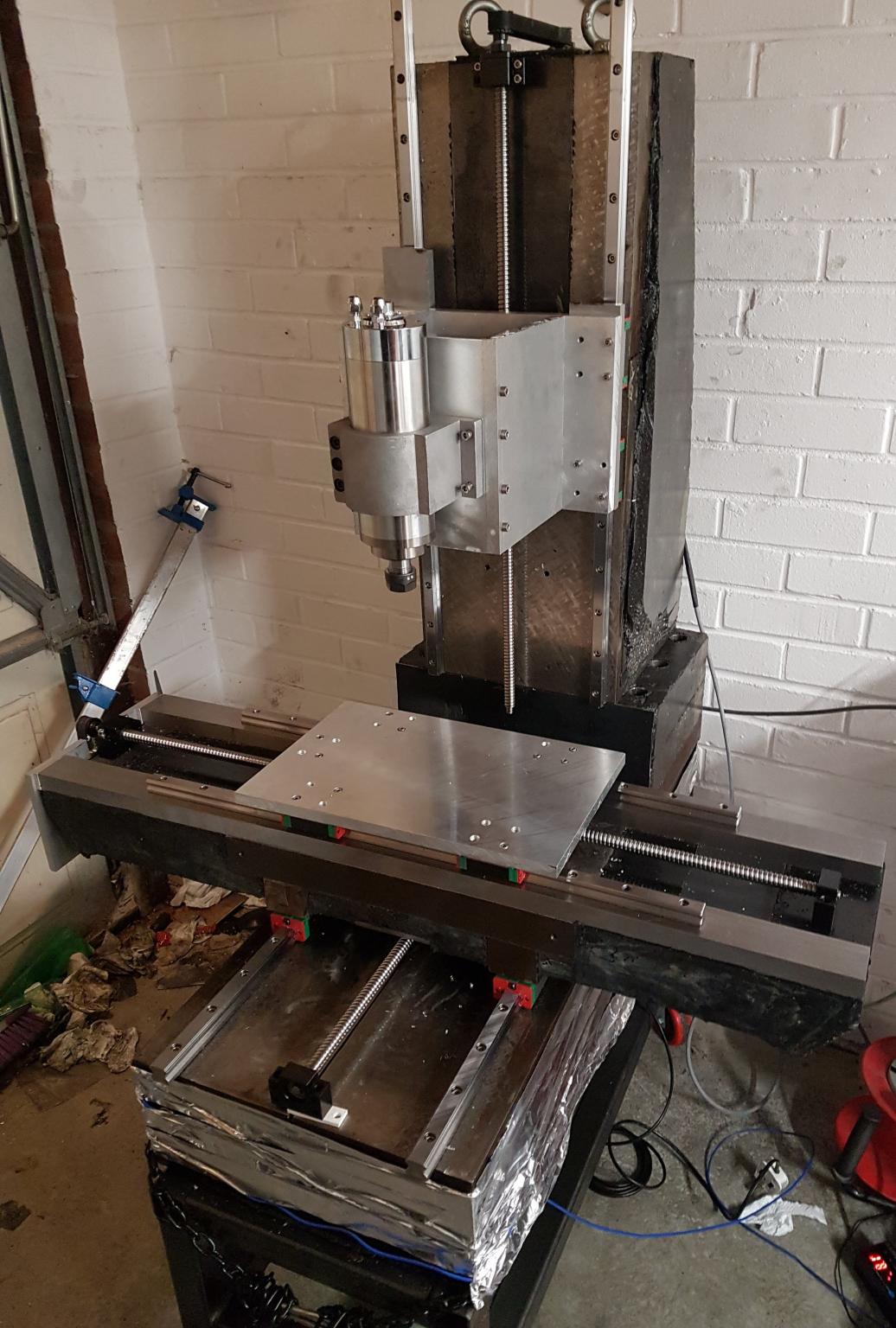

More progress, rails installed, steppers installed on temp 3D printed mounts, temporary head and spindle.
First axis movements (Y axis not working):
https://www.youtube.com/watch?v=rAVX...ature=youtu.be
Attachment 26993
Next steps:
Alignment, use mill to mill better mounts, mill permanent head BT30, servos, way covers.

Waiting for the servo for the spindle, pneumatic cylinder and mesa cards.
Made a start on the pneumatics, I've gone with a "mist cooling" system using the water filter approach I found on the here, works well.
Got a lot of time consuming jobs done, filled the spindle head with epoxy granite, got the y-axis movement working. Made a few chips with jogging.

I have made my first chips and broken my first end mill on the servo mount for the X-axis. There were lots of issues milling this the X-axis pulley keep slipping. It looks a bit rough, I left 0.5mm of axial so I had to file it down, no finish pass but I think it will be functional. Waiting for a new belt to try it out.
Attachment 27446
5mm 2 flute end mill: RPM: 8000-10000 WOC 1mm, DOC 4mm, chip load per tooth around 0.04mm, feed 600mm/min
8mm 2 flute: RPM 8000-10000, WOC 1.6mm, DOC 8mm, chip load 0.05?, feed around 1m/min
