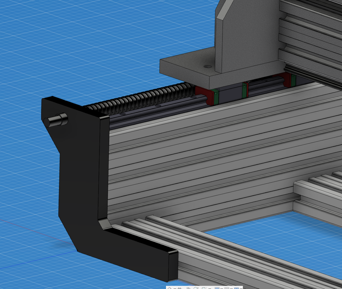

Engage sarcasm mode: I'm having so much fun learning Fusion 360 :Disengage sarcasm mode. Here's my part finished design:
Attachment 25016
Attachment 25017
Attachment 25018

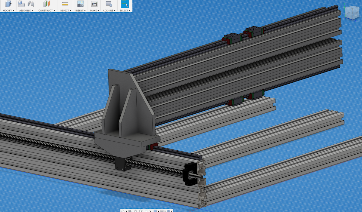

As you can see from my partial design I have opted to use tall profiles for the Y axis sides of the frame in order to reduce the height of the gantry support plates as much as possible. My thinking is that it will keep the CoG of the router as close as possible to the same height as the Y axis linear guides. On the X axis I have opted for 2 qty 80 x 80 profiles in the hope that it provides way more rigidity than I need. X Axis guides are mounted top and bottom of the gantry to minimise the router's extension from the gantry.
My current design considerations:
Direct or belt driven X and Y axes? I am currently leaning towards belt driven.
Reduce the Z Axis ball screw size to reduce overall Z axis assembly weight and provide a finer pitch, perhaps a 1204 or 1604 screw?
Use universal connectors or use L brackets to join the 40x80 of the bed to the 40x160?
Are my stepper going to have enough grunt if I use a 1:1 belt drive? They are 270oz rated, perhaps a 2:1 ratio?
Whether to make my own aluminium plates or have them made for me? I think I am plenty capable of making them but I have no mill or CNC machine so it'll all be hand work (I have woodworking tools such as mitre saw, jigsaw, router table, drill press etc.) so I question whther I can make them to the tolerances required for a really strudy machine.
I have given very little thought to the Z axis at this point but I am treating it as a 'module' that I'll bolt on towards the end of the project.
I think that's it for now. As I have more thoughts and ideas I'll vent them here.
Cheers,
Paul.

Re: First Build - Yet Another Alu Profile Router - 900 x 800
Agree the 24V psu and TB6560 drivers give very low performance and possibly lost steps under load.
You can hand make the large end L plates using a template and router with a carbide fluted end mill. Accuracy is not critical as the outline is mainly cosmetic and the holes can be drilled oversized. If you are fussy they can be the first things you remake with the machine.
Belt drive is often neater as the stepper can be tucked away. At 2010 you would usually 1:1 drive for wood and 2:1 ( step down) for aluminium.
Z axis should be sketched soon as the ballscrew location, ballnut, and stepper location at the end of the gantry all need to fit together. You also need to add the spindle plus a cutting bit to check the gantry is at the right height to give the range of movement you need on the Z axis plus clearance to machine over a vice.
1605 is often fine for Z but if you have bought the other size then use that.
Draw as much as you can before cutting anything because the details can catch you out !

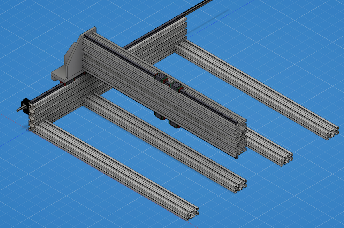

I have two different Y axis arrangements which I'd be grateful for some input on please. I originally designed my machine with top mounted linear rails but then thought I would give side mounted rails a try in order to lower the gantry by about an inch. The trade-off is that my bed will have to shrink by about 80mm from side to side as I've already got the gantry profiles (I know, design first, shop later - I've now got this tattooed on my forearms!).
Any opinions about the pros and cons of either would be much appreciated.
On top of the side beams is fine.
Using 2 separate extrusions for the gantry is a lot weaker than one big one. If you already have them, it is worthwhile using a plate on the back to join the two gantry extrusions.
Either of those two setups will work, but unlike pippin I'd favour the second one in which the gantry beam is bolted to the same plate as the bearing blocks. In the first you have an extra joint to complicate things.
Totally agree on the joining of the gantry beams though, they should be one solid unit, preferably in an L configuration.

I think that I am leaning towards the second option, it does make sense that the gantry beams and the bearing blocks being fixed to the same piece should be more rigid.
Great call on joining the gantry beams together, I hadn't considered that at all. I guess a few pieces of aluminuim plate or profile offcuts would do the job.

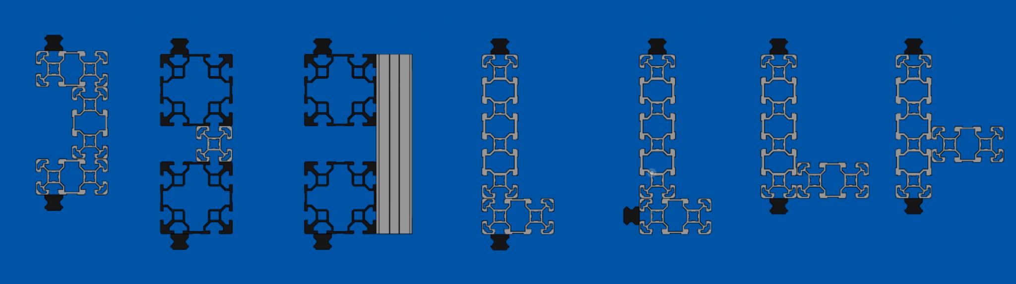

I've been paying some attention to my X and Z Axes design this week and I'm starting to question whether I have built my gantry too high. The fully extended Z Axis looks like it could be vulnerable to excessive deflection given the amount of extension from the gantry.
Attachment 27097
Attachment 27098
What I realised is that most of the work I'll be doing will be on relatively thin material (12-40mm) so the router will be operating at full extension most of the time. I also realised that this must be a problem for a lot of machines; do most people raise the bed in order to minimise the deflection of the cutter? I would like to work material up to 100mm thick and I currently have about 120mm clear travel on my Z axis.
Rather than compromise my design to accomodate thick material do you think I would be better to design a machine to work thin material well and accept that I just won't be able to work thicker material. Being able to work thicker material was a bonus rather than a necessity.
Well, first I think you need to rethink your Z-axis design because that cannot possibly work how you have it shown now.?
Regards the Gantry height then it depends on what your cutting. All the machines I build have at least 100mm of Z travel and most have 150mm and will happily cut aluminum at full extension with a reasonable finish quality and accuracy using correct feeds n speeds. If you require a higher finish quality or deeper cuts or higher feeds then yes it's better, even necessary to have a lower machine or if not then a machine that is built much much stronger than your typical router needs.
To be honest I'm not a fan of the open gantry design you are using with the profiles orientated in the vertical position which is there weakest orientation. Those same two profiles could make a much stronger gantry if you made it an L-shape and put the screw at the rear.

OK, I've gone back to the drawing board with my Z Axis and had another stab at it.
Attachment 27139
Attachment 27140
Attachment 27141
With regards to the gantry, the profiles that I have are 80x80 heavy which I intend to brace across the back with perhaps 3mm aluminium sheet or some flat bar. I had thought that would be sufficiently strong for my needs (I'm cutting wood, MDF, ply, plastics and possibly the odd bit of aluminium), do I need to beef it up further?

I had assumed that your previous drawings with the spindle back-plate were making it shorter so we could see past it, but your latest drawings seem to continue the theme. Are you genuinely planning to have the top of the linear rails for the Z axis hanging in mid air like that? Seems like quite a flimsy design decision for the minimal cost of some extra aluminium plate.
I'd also doubt that the ballscrew needs to be that long - but I gather you've already purchased it?
AndyUK
Yeah, I see what you mean about those rails being unsupported when the Z is lowered and yes, I have already got the ballscrew.
Three options then:
- Add more plate to lengthen the router mount plate.
- Consider shortening the whole linear travel by cutting the rails and ballscrew.
- Buy another ballscrew. (perhaps a 1605 would be sufficient?) Looks like I can get one for about £33 with the supports, nut bracket and coupler so that won't break the bank.
I had previously wondered about shortening the ballscrew using my ML7. I'm not a very accomplished machinist and my biggest concerns (apart from completely stuffing the job up!) were about the hardness of the ballscrew and whether the action of cutting into the thread might make the cut wander.
Three options then:
Nothing wrong with the ballscrew being that length; its just that you're not going to use its entire travel, so if the ballscrew hadn't been purchased you could save some money by getting a smaller one.
I'd argue the easiest option is just to extend the plate.
Second option is to swap the rails and carriages (as I think Phil suggests) but its quite nice to be able to remove the spindle plate in one go with just four screws on the ballnut; it can be a pain to remove the other way round.
I did try it with the rails the other way around and I wasn't keen. I think that you're right, extending the plate is the easiest option.

I've been looking at different gantry arrangements that I can build using the material that I already have.
Attachment 27203
From left to right they are:
A: 3 off 40x80
B: 2 off 80x80, 1 off 40x40
C: 2 off 80x80 with 40x40 or 40x80 bracing
D: 1 off 40x160, 1 off 40x80 'L' arrangement
E: 1 off 40x160, 1 off 40x80 'L' arrangement with lower linear rail front mounted
F: 1 off 40x160, 1 off 40x80 'L' arrangement with greater gantry clearance
G: 1 off 40x160, 1 off 40x80 'T' arrangement
My original arrangement was 2 off 80x80, one above the other without any bracing. On the feedback I've had so far I think that any of these new arrangements should outperform my original. I like A, B and C as they allow the ballscrew to sit in the gap but I know that strength and stiffness are more important. D offers good spacing between the two linear rails but I think that it may be a step too far as it limits the material thickness too much. E is my current favourite. The only thing I don't like is that the Z axis will protrude out further from the gantry but I think I can live with it.
Of these arrangements which do you think offers the best performance?
CaptainBarnacles
Your orginal would been ok if the profiles where bolted together without the gap. The gap wasn't required so bolted together the profiles are stronger.
CaptainBarnacles
The gap would just fill up with crap and shorten the screws life. Like wise being exposed to chips is why I don't like open gantry's along with being weaker. The L shape gantry helps protect the screw as it's behind and is also stiffer.
CaptainBarnacles
This would be my choice with the profiles you have.

How about a variation on "C", bring the 2 80x80s close together (ditch the crap collecting gap) and plate them front and back to make say a 90 something x 160 section? You could even slip a drop or 2 of epoxy where the extrusions meet if you were feeling keen :whistle:
Voicecoil
You sir are a brave, brave man.
