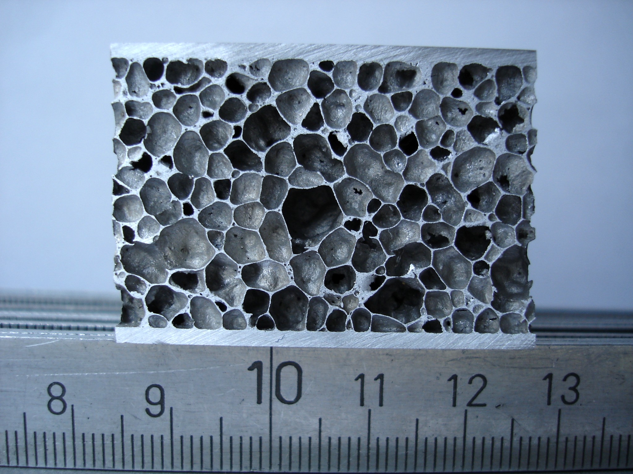

The gantry needs to remain lightweight. What could be used to fill the RHS to add damping, stiffness without adding to much weight?
This aluminium foam looks so sexy.. But how is it produced? How complicated/expensive? I couldn't find an answer yet.
Attachment 25162
And here's an article about it: Vibration Damping Analysis of Lightweight Structures in Machine Tools
Another idea is filling them with foam concrete.
But in both cases the filler will shrink by cooling/curing and maybe detach from the steel walls.

Interesting, will surely read the paper, but I doubt this can be DIY, and wonder if companies able to do it can be found easily...
Wow, never heard of this! Veeeery interesting. You just added another option to investigate to my list.
About shrinking/retraction, I don't think this such an issue, or at least that it can't be solved easily, as this is a construction method used daily in buildings. Quite sure there should be something in Sika or other product range for this problem.
This is actually my champion ATM! I find this Constrained Layer Damping technique very interesting by its use of multiple materials, smart mechanical principle, and affordable materials and build techniques.
Visco-elastic mat used in the thesis can be found and is not insanely expensive, and I'm sure can (and most probably will) be replaced by other cheaper and/or more easily available products. I'm currently thinking to asphalt mats...
They also use (IIRC) aluminum oxyde in concrete mix as an expansion agent, which should also be an answer to the previous retraction issue.

I don't think the PU foam has any damping characteristics. If you knock it the sound is very well propagated.
I see a few books cited on wiki about ally foam manufacturing. I need to get my hands on one of these books.
Here's an experiment but the result doesn't look that great. https://www.youtube.com/watch?v=8FHTK2LZNTY
Exactly here's my problem. I need a lightweight machine, and being light allows me to use steppers and the price difference to servo I can use to improve damping and stiffness without adding to much weight.
I doubt the expansion agent will work with foam concrete as it will tend to put pressure on the air bubbles in the concrete not against the walls of the mold. This chart shows that the shrinkage increases as concrete density lowers.
