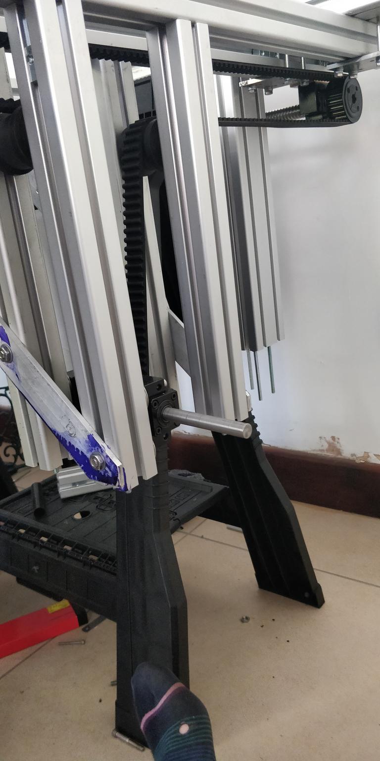

I have got it rigged at the minute with a crude belt drive to drive the gantry ball screws (so i can move gantry up and down with a power drill while im building it). I have considered running it from one motor but when i move the timing belt (20mm wide 8mm tooth pitch) manually there seems to be to much resistance. Hence why im thinking of direct drive and slave method. If i do choose the latter im thinking of putting a thinner timing belt at the far ends of the ball screw just to mechanical sync the ball screws in addition to electronically slaving the motors (this would be a safety / gantry allignment consideration).

Excuses :frown: It helps to see pics. Its not a good idea to have a belt joining the two screws and then using two motors . Either 2 motors or 1 motor with one belt over both screws.

6 Attachment(s)
Re: New member lots to learn
Hope you can see these pictures of my machine that i have attached.

chillybo
*head in hands* My mother-in-law has the same rainbow drawers - just seeing them makes me nervous about what her next 'job card' entails.
Looks like you've made some serious progress there - and your workshop is far tidier than mine I can assure you!! What are the dimensions of the machine? Looks like its got a decent amount of Z clearance.
As Clive mentioned though, you may find that a single beefier motor (I'm thinking Nema34 > 8nm) will be more appropriate with the belt drive. If they're physically connected, you won't loose sync between the screws, and you don't want to get into a situation where the motors are fighting each other.
Dropping the slave motor potentially frees up an axis and saves you buying another motor driver - it might also make a homing routine less confusing!

Z axis travel is about 130mm. I can adjust the clearance by sliding the assembly up or down the gantry uprights (the benefits of extrusion). Ive built it so I can either use a belt as you suggest or slave it without any new modification. I think your right about using the belt. Only issue is I've only got 4.6 Nm Nema 34's. I could give it a try and see if one can move the gantry ok. If not Id have to splash out on a bigger stepper motor and then id have 2 spare motors.

nema 23 motors probably would have driven the machine fine.
