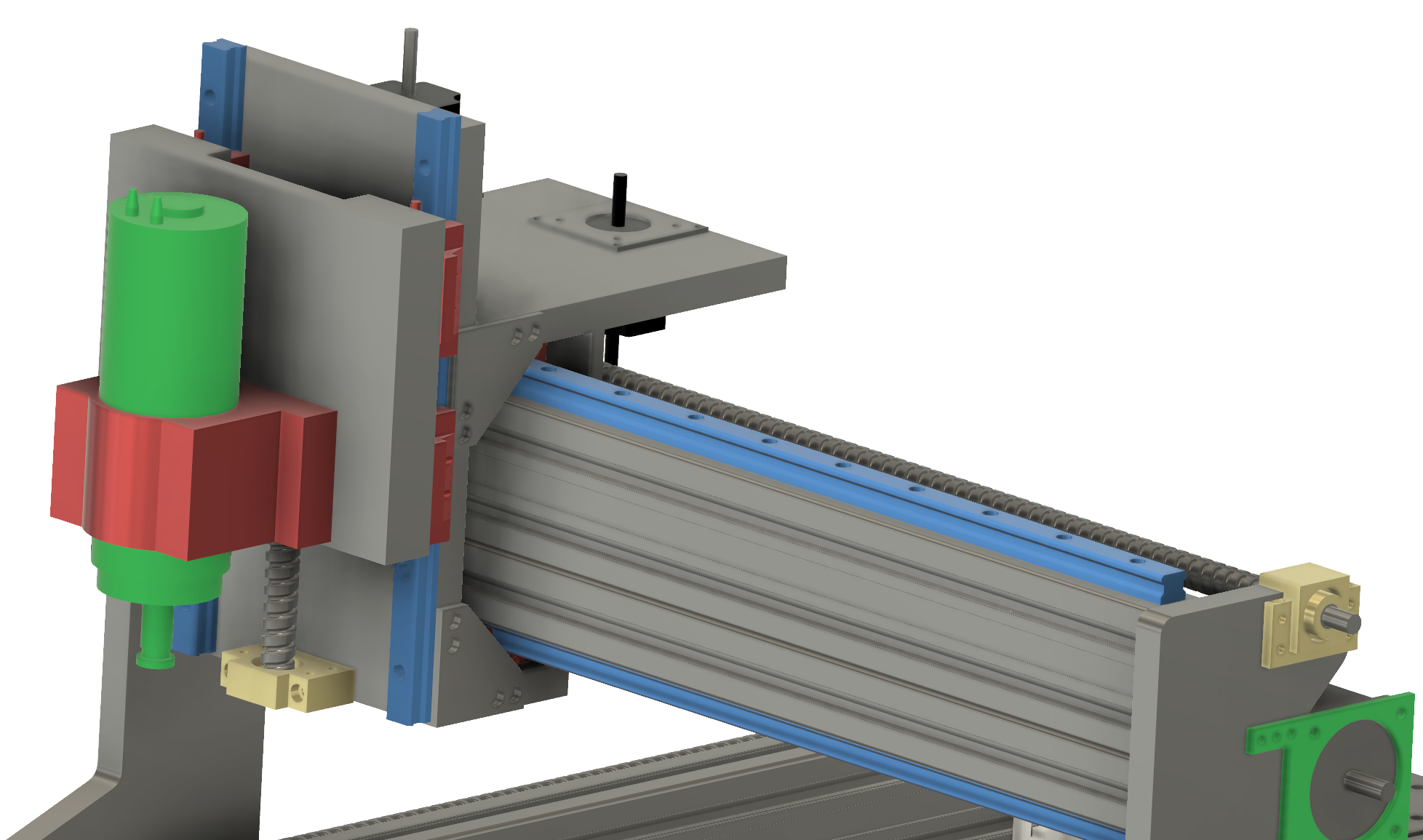

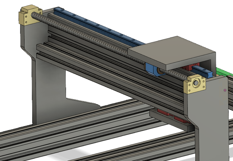

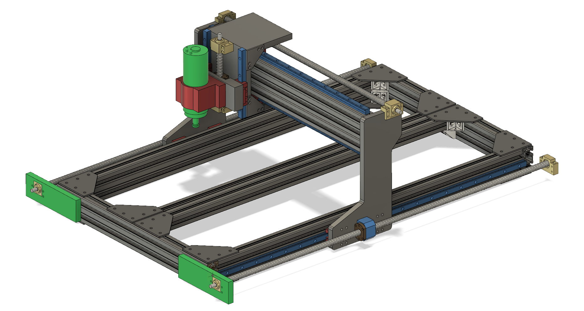

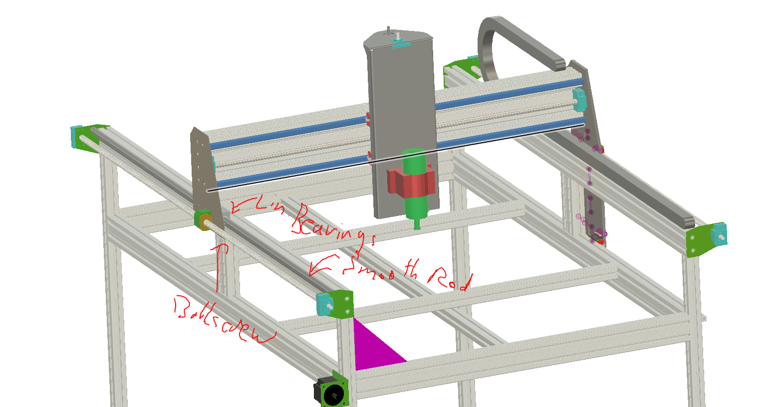

Hello everybody!
I have been reading posts here and designing my own CNC for a while now. I have been sitting on this and not continued for quite some time, but I now have the opportunity to access a lathe and a well-equipped workshop for a couple of months, so I want to finally move this forward.
Before I go into the design, I want to quickly state what I want to achieve with this machine: I want a relatively large (read: Around 1m x 0.7m x 0.1m) area machine to cut wood, plastics and aluminium. At the same time I really want to constrain the cost as much as possible, not wanting to go over a cost of 4000€ (at this point I should probably mention that I am located in Germany).
Now with the information I have gathered, this is the design i came up with to satisfy these requirements:
Attachment 25732
Attachment 25733
The Profile is Motedis 45x90S B-Type Slot Aluminium Profile, The rails are HIWIN rails and I am planning on using ballscrews for the motion. For the Rails and Screws I plan on buying a bundle on Aliexpress which will likely dictate the exact dimensions of the machine.
Now to the questions I am still having:
- How would you go about connecting together the Profiles? Would angles suffice, or do you use something else there?
- What would be the best way to mount the Rail Bearings? The green elements in my Model are just placeholders, since I struggle to find a good way to mount them.
- How would I place Drag Chains on this design, to protect the cables? Would I need to make sure to have extra flat space to route these?
- I was planning on using NEMA 34s with Timing belts to drive the screws. Would I need two of them for the Y Axis?
- The Spindle Plate hanging on the Gantry looks huge to me, compared to the rest of the machine. Did I misdesign this?
- Is a machine like this even capable of milling Aluminium? Would it be able to cut thin (not more than 10mm) steel sheets?
- And finally, is this design even any good? I mostly worked off the information I found in various posts on this forum, especially for the gantry design, but I have no idea if the result has any glancing flaw.
Thank you for any help!
Re: Starting do design out my build, looking for critique
Chrono
Others will be able to say, but should be able to take light cuts in Ali. Steel is probably out of the question - for that you're better off converting an existing mill.
Chrono
Can't see it in the renders? The carriage plates look reasonable - but obviously there isn't a Z axis yet which will change things.
Chrono
This size of machine should be fine with Nema 23, but that's just a mounting size. On your long axis, you can either go with a pair, or you can use a single motor with a timing belt connecting the screws. If a belt across the CNC isn't a massive inconvenience to you, my vote is for the belt - otherwise dual drive. There is a motor calculations spreadsheet on the forum which will help direct you to which motors to use.
Chrono
You can tap the ends of the profiles and stick large bolts in, you can use angles, or you can use T-nuts. There are probably other ways - look at a Profile supplier's website for inspiration (e.g. KJN).
Chrono
Looks like you're on the right lines to me - I'd carry on by improving the detail of the CAD.

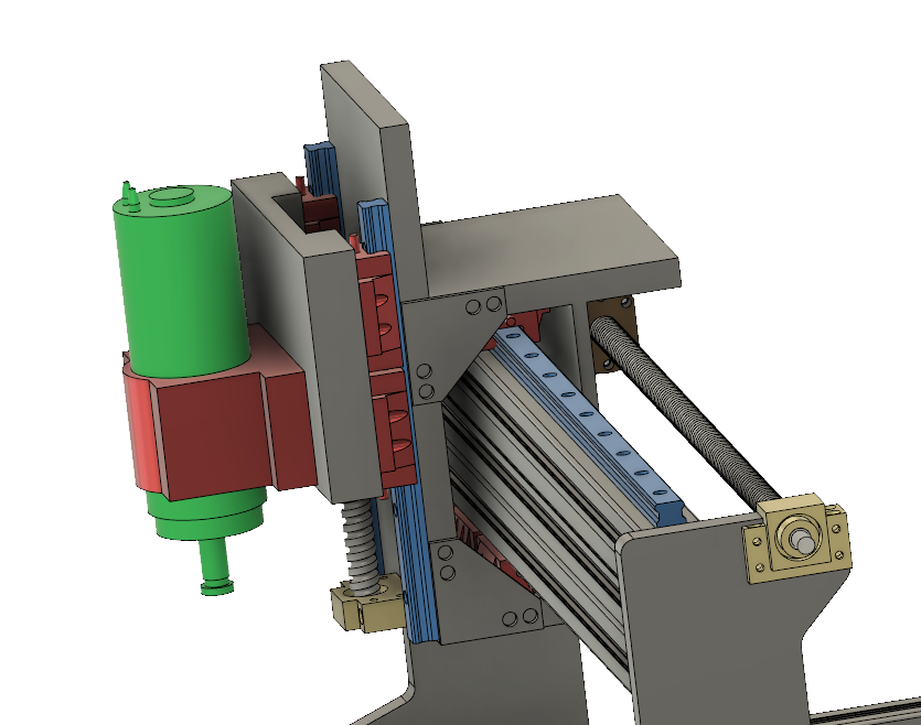

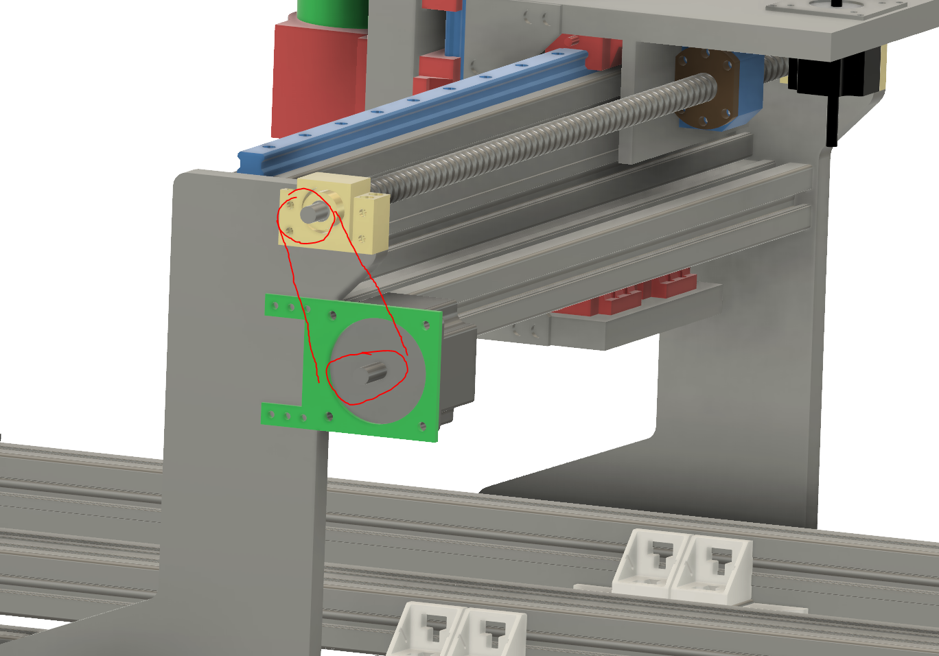

Hi Chrono
Andy beat me to many bits of good advice, but I'll add:
Whilst some of the details are missing the green plate method, provided the plates are thick enough should be a good approach, as you will be able to adjust the plates to get the ballscrews aligned properly. In fact being able to make adjustments for alignment of ballscrews and stepper/servo motor mounting should be your aim when designing the mounting points/plates (with rigidity of course :-) ).
Your Z Axis carriage/box will likely need some side bracing of some kind to stiffen it - could be as easy as some triangular corner plates to tie the right angled joint together.
Hope that helps.
Chris

Washout
There is a reason I picked which questions to answer and which to avoid!
Washout makes a good point about the adjustment of things. I like your ballscrew placement idea on the gantry, but it doesn't leave a lot of room for height errors - the location of the top plate will be defined by the carriages, which may or may not co-inside with the height of your ballnut support. You may want to design with say, a 5mm shim under the BK/BF12, so that you can adjust the shims to get the right height. This is why the ballscrew on mine is on the back of the L shape, it allows me to adjust for height relative to the carriages - but leads to a slightly more flimsy 3-sides of a box shape.

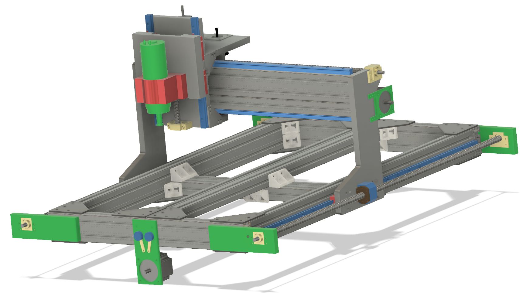

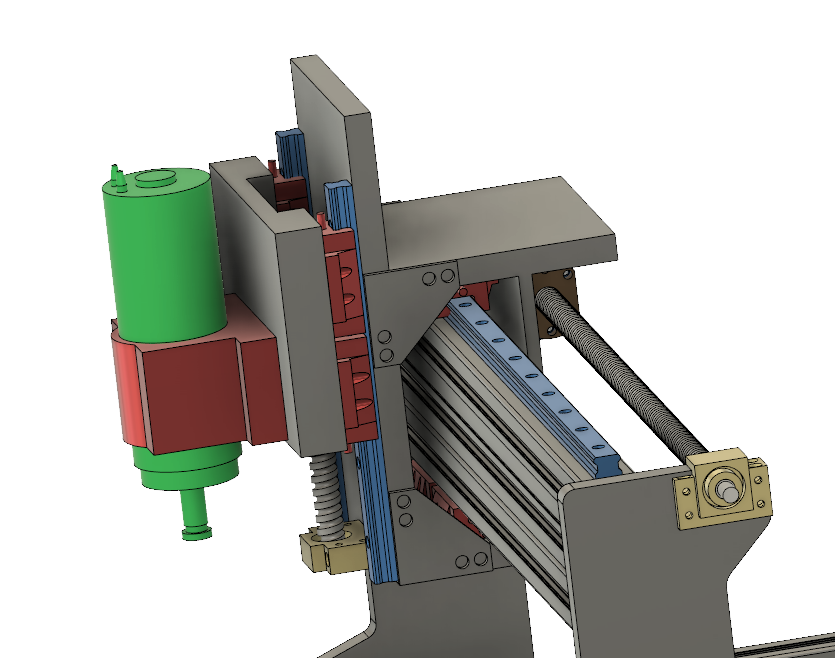

Thank you two for the replies! I have been implementing some of the things you were talking about in my spare time, but much more needs to be done yet.
Attachment 25743
What I changed:
- I added angles and connector plates. My plan is to mount the spoilboard on the angles.
- I added the Z-Axis. Currently, due to the different heights of the Rails and the Screw-sleds, the plate holding the spindle has a weird U-Shape. I could cut into the Z-Carriage and sink the screw into the gantry a bit to make this flat, but thus sacrifice gantry rigidity. Any thoughts on this?
- I also added Angles to help support the Z-Carriage, like Washout recommended.
What I am yet to do:
- I understand the thought about keeping the mounting plates adjustable, thus I will design out those green plates to make actual mounts. The same for the back bearings.
- I want to add motors to both the Gantry for the Y-Axis and the Z-Axis. For the Y Axis I thought about mounting them in the sidepanel holding up the gantry. For the Z-Axis I thought about lengthening the top plate and hanging the motor there. Would this be a problem in terms of placing extra torque on the Gantry?
I also have a couple more questions:
- Should I put in two more profiles to brace the bed in the Y direction? Crossbracing will be hard using only Aluminium profile
- How thick should the different Alu plate parts, like the bearing plates, sidepanels and Z-Carriage be? Currently, I have all those set at 20mm thickness.
- What about endstops? I have access to a 3D printer, can I use that to print mounts for the endstop sensors, or would those be too flimsy? I do not see them having to take much force, but maybe I am missing something here.

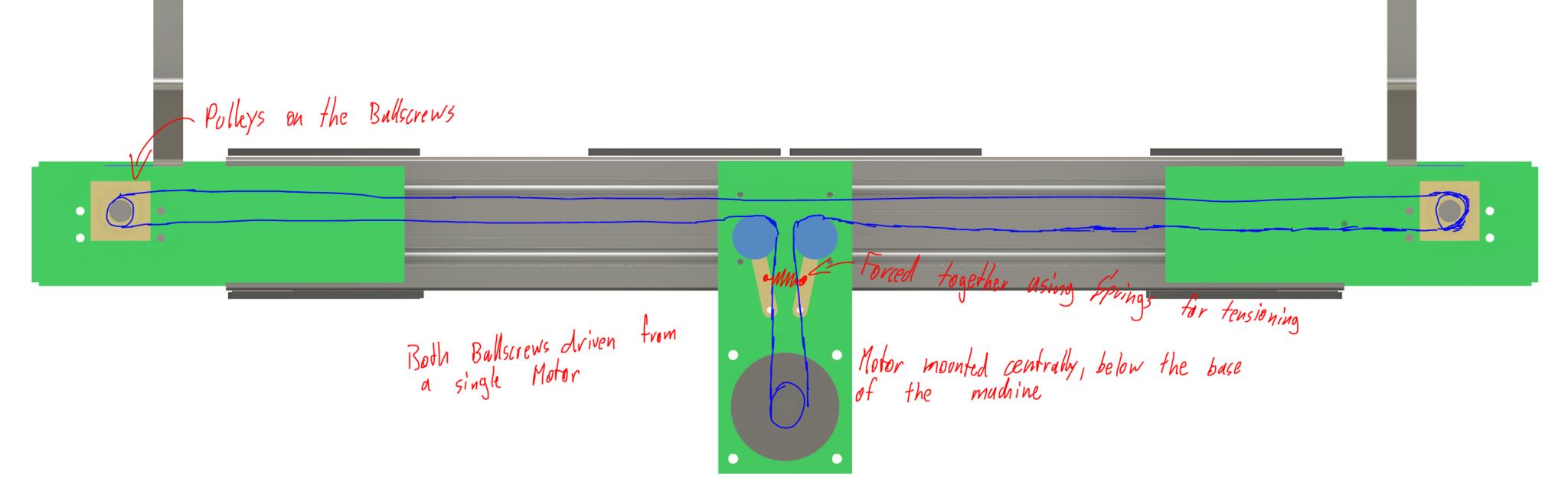

AndyUK
What would be the advantage using a single motor? I am guessing the, more or less, guaranteed synchronization of the ballscrews?
I'd certainly be putting a second pair of bearings on that Z axis and lengthening the rail to retain your travel. Remember that the moment on that axis is Force x Distance to pivot - currently the pivot is the centre of your single bearing, the forces are at either end of the same bearing. With two bearings, the pivot becomes the point between them, and the forces are acting on the bottom of the bottom one, and the top of the top one. Your deflection in that direction will be significantly reduced.
Spot on - once you've set the relationship between the two screws with the timing belt, you don't need to worry about the gantry racking, or homing the motors independently every time you use the CNC to ensure a perpendicular X and Y. If you miss steps, they're missed on both sides - which is probably safer. Then theres the reduced complexity in limit and homing switches, and you don't have to buy yourself an extra servo/stepper driver which is £50-100 right there. You can also use a 4 axis controller and still have a spare axis for development later on.
... basically, I'm mildly regretting going for dual motors. But I didn't want the timing belt across the entire machine, so I'm paying the price!

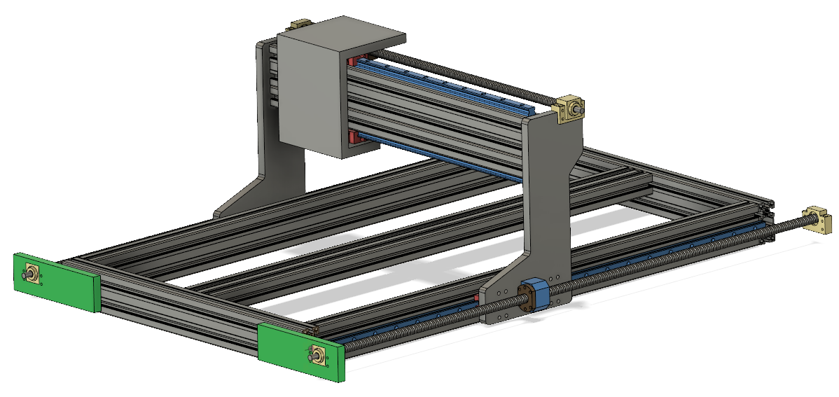

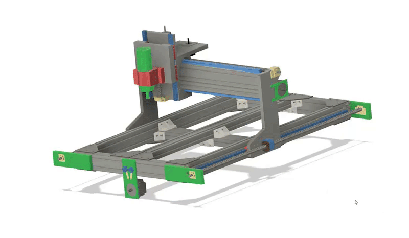

Sorry for the long radio silence, things have been quite busy here and I could barely find the time to work on this.
I took the advice with the Y-Axis Ballscrew and the Z-Axis sleds to heart and changed the corresponding geometry:
Attachment 25776
On the to-do-list are the following things: - Add a mounting point for the Z-Axis NEMA 34 behind where the Y-Axis ballscrew currently connects to the Y-Axis sled.

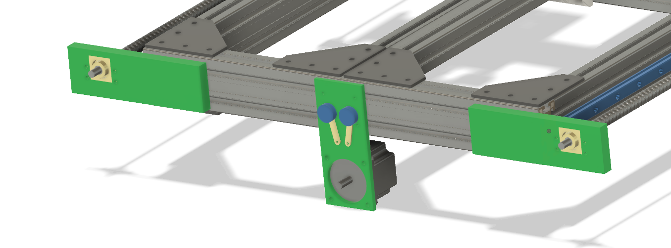

- Add an "Omega-Drive" belt structure to the front to run the two X-Axis Ballscrews from one NEMA 34 stepper. The "Omega-Drive" structure is there to maximize surface contact between Belt and Gears
- Finally add that back ballscrew-bearing plate to connect it to the base structure
- Add a Spot for the Y-Axis Motor to sit. Due to clearence with the Y-Axis sled I am still unsure where to put that, but maybe even below the X-Axis rails on the bottom?
Do any of these plans throw up a red flag from something I have not considered yet?

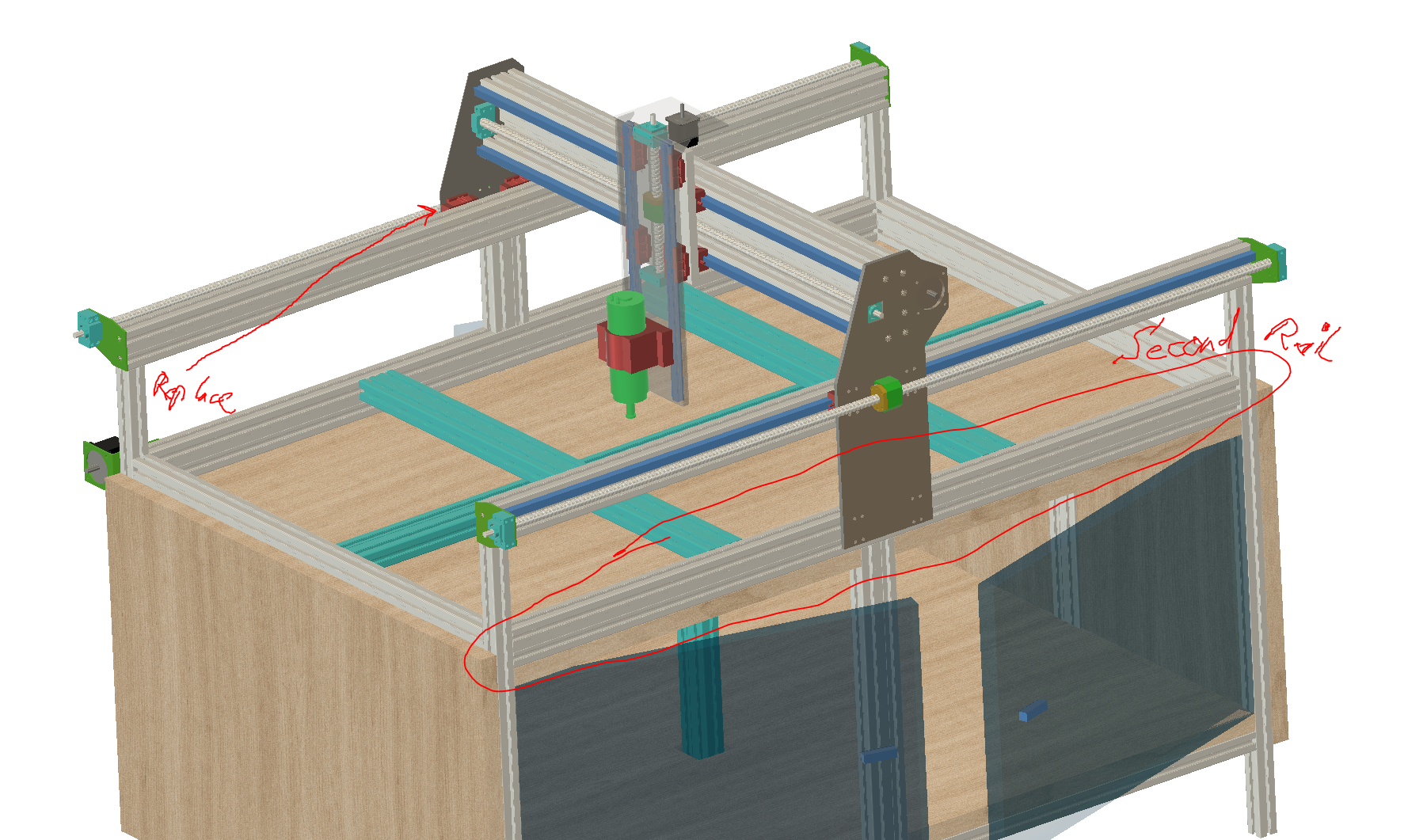

I have also been talking to the mechanical engineers in my workplace, who came up with a plethora of ideas to alter the design, so I am seeking a second opinion on some of these:- Substitute the Aluminium Profile for Steel Box section and weld it. The warping should be controllable in a machine this size, is what I am hearing.
- Change the Y-Axis gantry to a design that has a Profile up top and one below with the ballscrew sandwiched in between. The rails would go to the front and both profiles would be held together at the sides, like they are now, and with an extra plate at the back. Alternatively manufacture this out of steel section.
- And now to the weirdest one to me: Mount the gantry to the X-Axis like it is now, but only on one side. Then have the other side be out of thin steel with only a loose connection to the gantry beam, thus only inhibiting rotation, but not translation. This would "solve" the problem of the gantry being over-constrained, since the second beam would only brace against torque, but allow the gantry to move over it, in case the rails are not exactly parallel. I know that in theory this makes sense, but it still seems counter-intuitive to me in terms of rigidity.
In the mean time I will work on getting the steps on my to-do list done and report back once I am done with that!

Cool, changes look to be in the right direction. Z axis will be much more stable - even more so if you can space those bearings apart a bit.

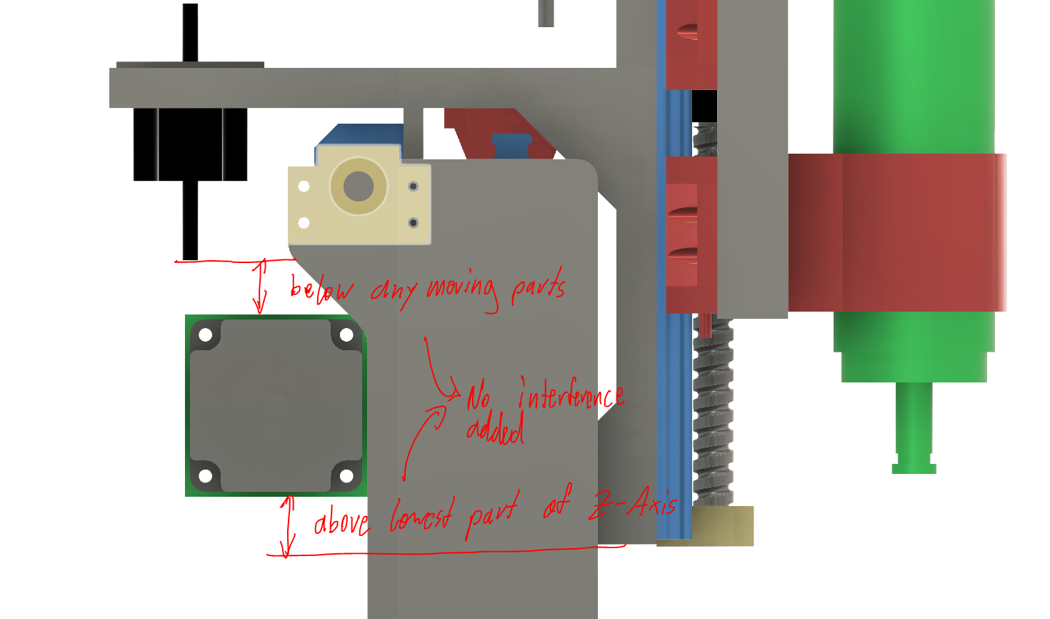

Woowwww there cowboy! Hold up a second! A Nema 34 for the Z axis? That's a little overkill. Get a much lower inductance Nema 23, gain yourself some performance by not having a big inertia to overcome (and take the extra mass from the moving carriage), and give yourself more space up on the Z. Something like 2-3Nm - even that will be more than sufficient.
So, two tubes with a large gap between? From memory of my deflection calculations that's a far less rigid structure. The L shape is good because it resists deflection both up and down, as well as twisting around it's own axis. I think that design would perform poorly in both situations.
10 Attachment(s)

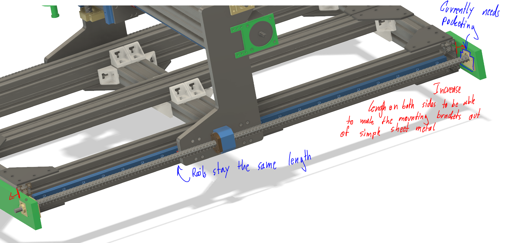

Wow, took me 4 weeks to finally find time and gradually work on those 4 items, huh... I really need to find more time for this :D
Anyways. I did get everything in order, and took your comments into account, so let's go over the changes.
Attachment 25915Attachment 25916
Y-Axis Motor Mounting:
Attachment 25907Attachment 25908
For a long time, the only place i saw to mount the motor without it interfering with anything was below the base. This would have been achieved by lengthening the side part below the linear bearings/ballscrew. Luckily, after taking a step back and looking at the model again, I found a much better place to do so, right next to the Ballscrew for the Y-Axis itself. The spot there is pretty much perfect, since it is below any part of the Z-Axis' top part, even if the Z-Axis motor is mounted on the back, but at the same time, it is above the lowest part of the Z-Axis, meaning it does not add any constraints for the workspace inside the machine. I would plan to get those mounting plates(the green ones) cut from steel sheets, since I can get that rather cheap.

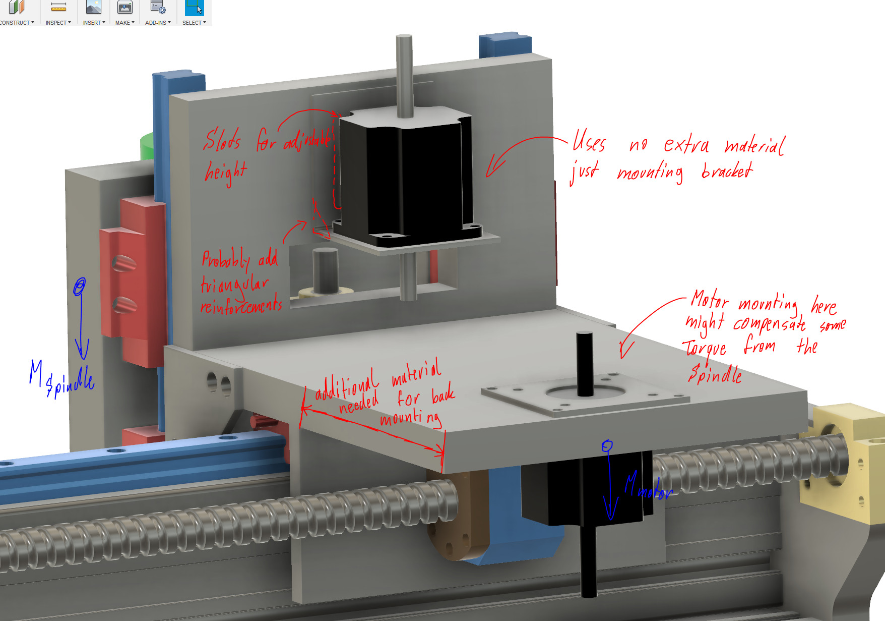

Z-Axis Motor Mounting:
Attachment 25909Attachment 25910
The second picture carries a lot of annotations, but I will go into the important parts again: I found two possible mounting spots for the Z-Axis motor, both are shown. Following your advice, I went for a NEMA 23 Motor on the Z-Axis, instead of a NEMA 34, like I am using for both the X- and Y-Axis. I now have the option of mounting the motor on the back, possibly compensating some of the torque the spindle places on the Y-Axis carriage. This, however, means that I need one more part to assemble the carriage, since I cannot just take two bent sheet metal parts. I would also need quite a significant amount more material, as you can see. The mounting on the back of the plate carrying the Z-Axis Bearings, would simply be using unused space that would already be there, and it would be relatively center on the axis, but possibly add to the torque of the spindle, since it is a bit forward. Using slots in the mounting bracket, I could easily change the height of the motor in that position to fit the mounting point needed, however.
I am unsure what spot to choose here. The top mounting position has quite a couple things going for it, but the back position does offer torque compensation at the price of significantly more complicated carriage assembly...

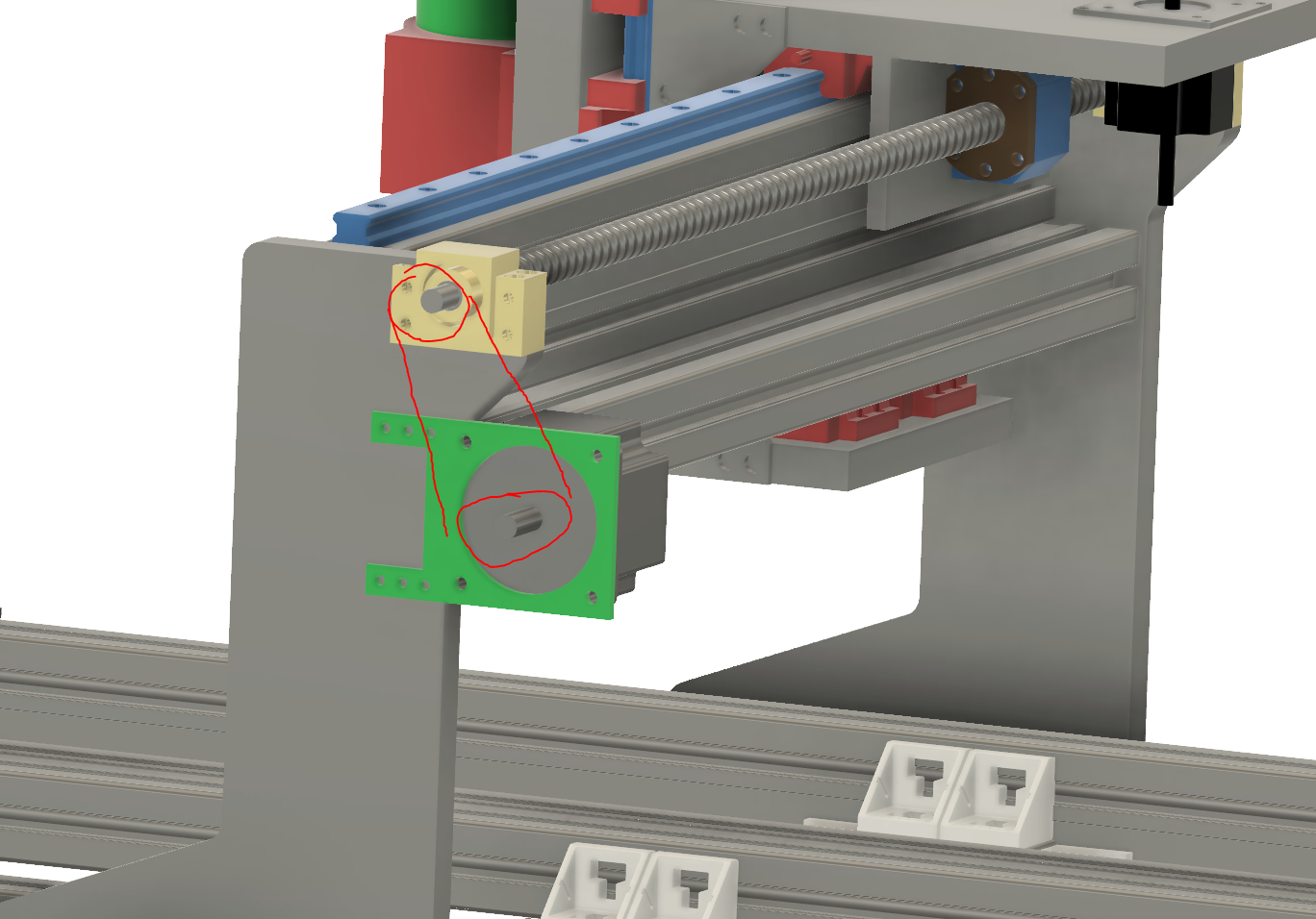

X-Axis Motor Mounting:
Attachment 25911Attachment 25912
The X-Axis mounting was easy to do, since I already had a good talk with one of the mechanical engineers in my workplace about that one. It is a simple Omega Belt Drive structure, driving both ballscrews from the same motor, just as you advised me to do. The two pulleys on the movable arms are tensioned using springs, not only to tension the belt, but also to increase the contact area of belt on both the ballscrew- and motor-pulleys.

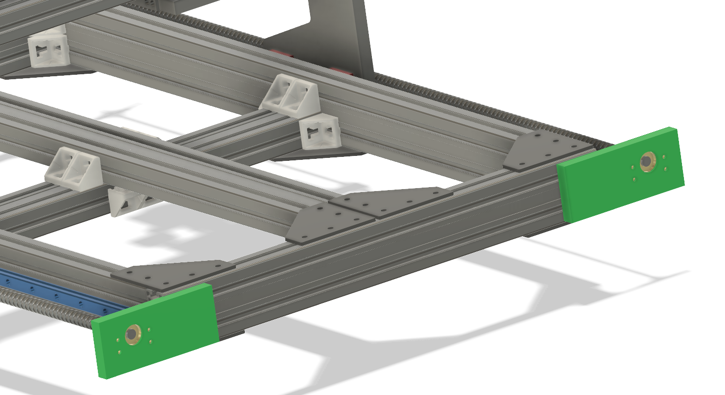

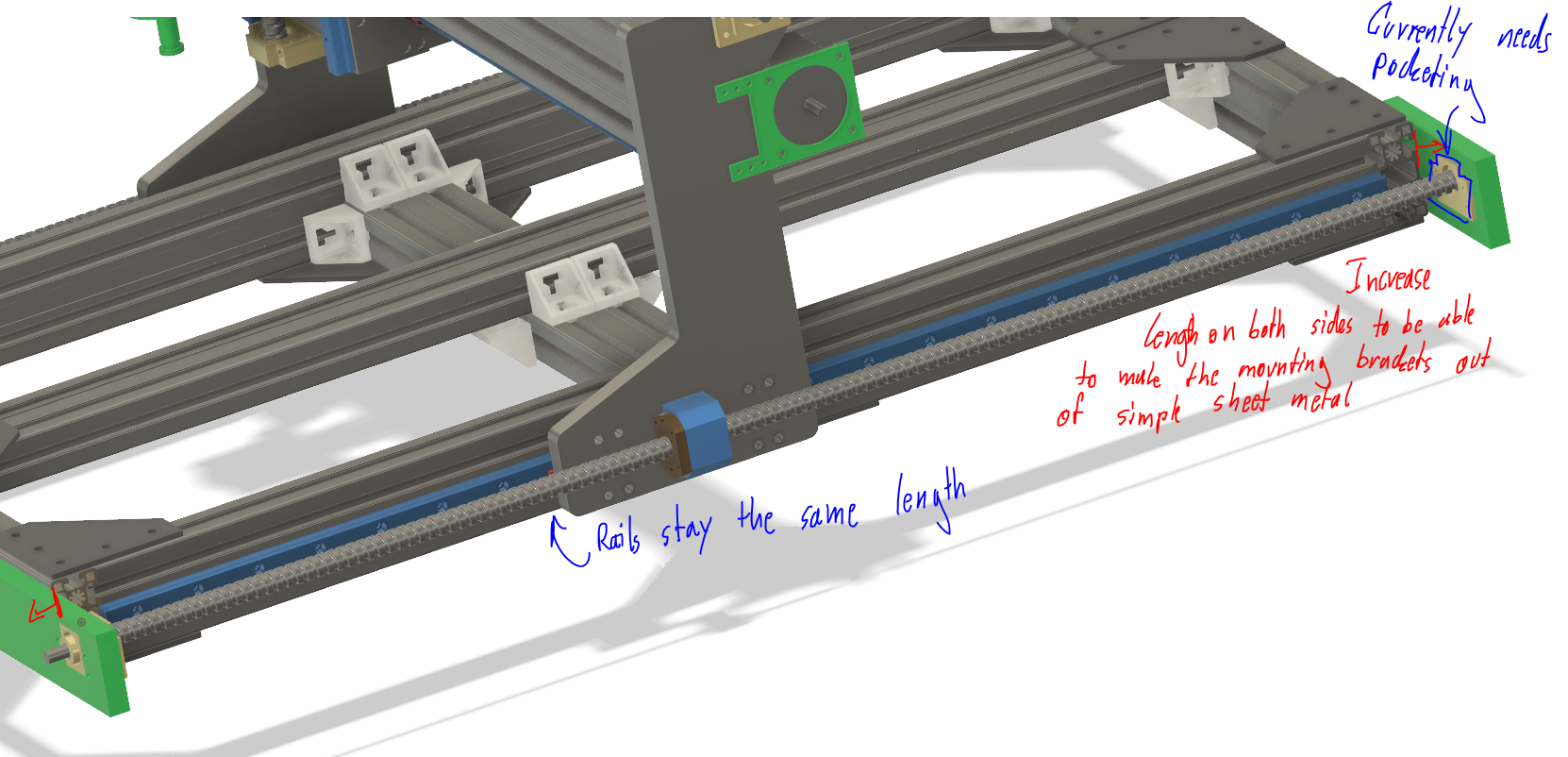

Finally: The Back bearing mounting plates:
Attachment 25913
These are basically the same as on the front and just simple metal pieces to hold the bearings of the ballscrews. The problem I currently have with them, however, is this: They are three-dimensional 20mm plates with pockets milled out of them. A better idea I had, to make them easier to manufacture, was to instead buy some longer Ali extrusion in the X-Direction, to bring the front and back edge of the machine more in line with the front face of the ballscrew-mounting-blocks, both in the front and back. Then I could use simple flat sheets of metal with some shimming underneath to equalize any tolerances. This would make those mounting brackets easier to manufacture, but add some "dead-length", when it comes to the ali extrusion, where it becomes longer, but the rails or axis are not. Still, I think that would be a better approach.
Attachment 25914

I did decide to design out the Z-axis a bit and plan on how to build it up, especially since one of my coworkers asked me the fateful question of: "Well it is technically possible to manufacture, but are you sure, that you can actually put it together like that, when it is in front of you?". With the earlier draft, I have no idea if that would be possible to actually assemble without a huge hassle, so I thought about it and came up with a better design, using screws and bent steel plates. The pink plate I will probably be changing out for a thicker aluminium one. Also something of note is that the bends and such are not accurate. I simply don't have enough time in Fusion's Sheet metal work-space, so I just went with the default settings for convenience's sake. After taking another look at your machine, since I was asking myself how to get more length out of the Z-Axis, I will probably also switch the rails to be on the sled and the bearing blocks to be on the gantry, like you did.
Attachment 26013Attachment 26014
I also changed the size of the machine in my Fusion design to reflect my "updated" plans for size. This broke a couple things that I did not yet get around to fixing, like the floating plates and angles, as well as those two Z-Axis bearings floating in the middle of nowhere. The original size was guesstimated around 1m x 0.8m x 0.2m while I was still messing around with the base design. The "new" size I plan on having is: X: 2m, Y: 1m to 1.2m, Z: ~0.3m to a max of 0.5m. I am not quite sure about what a good measurement for the Z-Axis would be, so if there are any values that have generally found agreement in what not to exceed, let me hear it :D
Attachment 26015

Current progress is the following: The table and X axis are done, except for the X axis ballscrews. The Gantry and Y axis are complete. What is yet missing, is everything concerning the Z-Axis, pending a complete revision, Motors and timing belts, and E-chains, that I want to account for. All in all, it is progressing nicely.
Attachment 26021

Hey everyone! More progress on the redesign. I sat down and actually worked on it everyday this week, and got some real progress done, finally. I am much more satisfied with how that one turned out, compared to the old one. Here is a side-by-side:
Attachment 26043Attachment 26044
It is probably obvious, but the old one to the left, the new one to the right. This will be the convention for pictures for the rest of the post as well. (On a side note: The blue extrusions are going to be changed from 45x90 ones to 45x45 ones, to save money. I just have not gotten around to fixing them in CAD, since they were pretty low on the list in terms of priority)
While being at it, I also changed a whole couple of things: Like the Z-Axis
Attachment 26045 New: Attachment 26046Attachment 26047
The Z-Axis got completely changed. Where it was a complex part before, it is now a rather simple bent sheet steel piece. The motor is now also affixed to the Z-Axis itself, and is moving with it. This is to keep the Gantry-side Y-Axis sled small. It also theoretically means, that I don't need to change anything but the Z-Plate, the rails and the Gantry sideplates to add more Z-space later on, if I ever decide on it. All in all, I like the design change of putting the bearing blocks on the Gantry sides, and the rails on the Z. Allows the parts to shrink a bit. That is one design change I picked up from AndyUK's build. The Ballscrew is also mounted on the moving Z-Axis, with the Ballnut being fixed on the Gantry Sled. One question that I still have, however, is how the cutting spindles actually get mounted to the Z-Axis. I understand that the spindle itself is mounted in the red aluminium ring, but how is that ring mounted? None of the pictures I could see in the offers showed any mounting holes. Are you meant to drill those yourself?
The Gantry itself got a revision as well!
Attachment 26048 New: Attachment 26049
The obvious thing is probably the size and shape change. I went from an L-Assembly to a C-Assembly. This is so that I could move the rails up front, which should not only give me more rigidity overall, but also allowed the massive simplification in assembly for the Z-Axis and Y-Axis Sled. This is one change I really took a liking to.
Something that was not quite obvious from the last post, but was already in it, is that one of the side plates fixing the gantry beam to the X-Axis is much thinner than the other one, in this case the left one is thinner (3mm of steel) than the right one(10mm of steel). This is to give the machine a way to have a bit of play, should something not be fully aligned, and off by a tiny bit. Another measure to the same effect has been brought up by my colleagues multiple times now: To only put linear rails and bearing blocks on one side, and have the other only constrained against translation/force, not torque, and we finally came up with a workable example, I want to discuss here:

Let me explain. The plan would be to put the second linear rail on the lower extrusion on the right (looking from the front of the machine), and have both of them on the same side. Then, instead of a rail, have a supported smooth steel rod, and a cylindrical type round linear bearing on the left side, to replace the rail. That way, the linear bearing still constrains the movement on the translational axes and takes on the forces, but it would permit torque, which would fix the problem with it being statically overdefined. What do you guys think of that? None of the Logs and posts I have read here, so far, have reported any real problems with any of this, but one of my colleagues who has had contact with similarly built machines, with a different purpose (cannot exactly remember) is bringing it up as the thing they and their competitors did, to avoid problems in the same vein. And looking at the budget, one rail with linear bearings should not be the point that bankrupts me here :D
Another question I am having is regarding the long ballscrews on the X-Axis and the motor calc sheet. As discussed way earlier in this thread, I want to stay with a single stepper for the X axis, even though I have two ballscrews, linking them with timing belt. Now my question is, in the Calc sheet, don't I need to input a "times two" into the calc of the torque needed to spin the ballscrews, since the stepper needs to drive both of them at the same time? Since I want to go to 2010 or even 2510 ballscrews, that is one hefty variable to think about. From my initial messing around, I can either go less fast with a 2010 ballscrew (Around 6.3m/s rapids) with a weaker stepper, or find a much stronger one to drive the 2510 ballscrew at the full 7.5m/s rapids. Of course, cutting is another thing entirely, and I am still not quite sure what speeds to aim for here, but for reference, I have managed to get around 2.5m/s with 50N of cutting force, in my testing. Another way would be to stay with 1610 ballscrews and scale the X down from 2m to 1.7m, but that is something that I only want to be doing as a last ditch effort, so to speak.
And another on the ballscrews: Would I just mount normal timing belt pulleys to them, to connect them to the motors, or would I need special machining or parts here?
Hi Chrono
No broken etiquette as far as I know. You're probably doing a great job and nobody has much more to add ;)
A few comments I would have from your last set of design drawings are:
- whilst 4 rails looks like a good idea, you will have a devil of a time aligning them I expect. Maybe 2 rails of a larger size might be better?
- Also consider the CS-Labs kit for the controller - many on here use them, including the venerable JazzCNC (which is always a good sign imho)
- Proximity switches if they are the type in a threaded housing, will give a nice amount of adjustment for the trigger point - you can do the same with micro-switches, but they then need a plate with slots to mount them to to achieve that
Keep going and I expect interest will pick up once you start building :thumsup:
I'm still aware I haven't gone through your calcs yet... Finding time is hard! Sounds like with the design changes though I may wait a little longer :)
I second Washout's comments about the CS labs stuff, looks brilliant. The thing that put me off was that the base model is only 4-axis, and it doesn't handle slave axis homing native-ly (although there are decent workarounds posted on here). Anything more than the base model is horrendously expensive, and I wanted future expand-ability to add a 4th axis which is gone if you use the 4th for a slave - but you avoid both of those issues by having a connecting belt and single motor.
Also, on the four rails idea, I think you'll definitely end up spending a few days becoming best mates with your dial gauge - but it could pay off in the end?
First impressions on the redesign; I think your CAD is coming along nicely, really shows. I do have a few concerns though:
- I question the Z axis travel length and why the plate is so large - Don't forget you'll have a bit attached to the end of your spindle, and its going to have to be quite a long bit to make use of your Z travel. I've got 18cm, and honestly, its probably far too much, most of the time you're really only needing to cut say 18mm plywood! The distance between the bed and the gantry looks huge - All that Z extension reduces the rigidity of the machine. Have a think about what you really need - can it be acomplished in other ways, such as an adjustable height bed or overhang section which keeps everything stiff for the majority of the time, but when you need to use the router on something large you can?
- How are you going to assemble the Z axis? Look through the design, building it up step by step, and imaging when you will or won't have access to each screw and what that implies. I've got my ballscrew and motor on the fixed bit because I can easily get to the four screws holding the ballnut onto the Z plate, undo them, then slide off the rails. Your design looks a little harder to physically assemble.
- The C beam - how are you going to attach those profiles to each other? Any weakness here will be quite problematic and you've got two joints which need to be constrained.
- 10mm of steel looks quite beefy for a side plate, but 3mm seems quite weak in my head. I realise its intentional, I'm just not convinced!
[LIST][*] I question the Z axis travel length and why the plate is so large - Don't forget you'll have a bit attached to the end of your spindle, and its going to have to be quite a long bit to make use of your Z travel. I've got 18cm, and honestly, its probably far too much, most of the time you're really only needing to cut say 18mm plywood! The distance between the bed and the gantry looks huge - All that Z extension reduces the rigidity of the machine. Have a think about what you really need - can it be acomplished in other ways, such as an adjustable height bed or overhang section which keeps everything stiff for the majority of the time, but when you need to use the router on something large you can?
Something like that came up when talking to my colleagues as well, today. We came up with inserting angles to hold up the sides, which could be removed if needed, but when there, would make it a bit stiffer. I really quickly added one in the picture above, highlighted in pink. Imagine four of those in the corners.
Could you maybe elaborate on how an adjustable Height bed and that "overhang" would work? I have a hard time imagining those two.
AndyUK
[*] How are you going to assemble the Z axis? Look through the design, building it up step by step, and imaging when you will or won't have access to each screw and what that implies. I've got my ballscrew and motor on the fixed bit because I can easily get to the four screws holding the ballnut onto the Z plate, undo them, then slide off the rails. Your design looks a little harder to physically assemble.
Good shout! On the first look, I should be able to do a similar thing, but with removing the screws of the Z-Ballscrew Bearing Blocks instead, but I will definitely check that again.
AndyUK
[*] The C beam - how are you going to attach those profiles to each other? Any weakness here will be quite problematic and you've got two joints which need to be constrained.
I have enough space between the screw and the profiles, to be able to insert some angles to bolt them together (that is going to be some fun fiddling with angled hex drivers, however :D) and I can also bolt them together on the back side as well. With the sled in front, forming a closed frame and additional bolts in the side-plates, that should be enough then, right?

Hi Chrono
It seems I have messed up my explanation here. I do not plan on using four rails, but instead three. Two linear HIWIN-style rails on one side, mounted atop each other. The other side only has one rail, and a different type, namely the cylindrical Igus-Style rails that you also often find in 3D printers, like the Prusa MK3. That will still take some work aligning, I get that, but it should technically work to help let the machine compensate. I know, technically is a nice word, but practically often takes precedent :D I have added another picture, with the HIWIN rails in their place, to hopefully make that more clear.
Attachment 26063
When I first saw this design, I couldn't help but think that was far, far too flimsy
Now with your explanation of the gantry driven from one side only (above)......it's getting worse!
Don't forget that to reduce cutter breakage, wear, chipping, improve accuracy and surface finish, the whole machine must be as rigid as possible and subject to as little resonance and vibration as possible. This is why machines traditionally are made in cast iron or synthetic granite (Granitan etc) that are "dead" materials, they don't "ring".
In the latest design, you are driving the gantry from one end only (and I still can't understand what the benefit is of the lower ballscrew). This goes against evrything that you will read on this forum, "ballance your forces", " place the cutter forces in between the bearings" etc. It is akin to digging a hole in the garden whilst standing on a diving springboard!
And the 6mm thick gantry sideplate.......
Compare yours
Attachment 26063
with this from Boyan.
Attachment 26062
Yup, Boyan's is built like a brick sh!thouse. Some may say that it's over the top, but I bet it does the job!
Or just taks a look at Andy's build
http://www.mycncuk.com/threads/11552...-2x1-0m-Gantry
Sorry if I seem somewhat hard on you but I don't want you to waste time and money unnecessarily.
Any other of you forum guys have a comment?
Good luck Chrono, you'll get there.

First up, I am still driving the gantry on both sides. Just one side is resting on two HIWIN rails, while one is resting on a linear bearing on a smooth steel rod-type rail. Here is the model if you want a more detailed look.
Secondly, I appreaciate the feedback, but what exactly are the problem areas here, what needs to change? Most design decisions come from advice I got from the mechanical engineers at my place of work, some of which have been building similar highly-dynamic gantry machines for Zeiss, taking measurements. This is also where the rail division comes in. Looking back at my technical mechanics textbook, this should protect the linear rails from having to take on torque, while still handling static loads. So that is the reason why. I, obviously, cannot tell you if that will work or not, but that is why I am here, after all :D
Edit: Some pictures to illustrate the whole X-Axis setup, excuse the dreadful mouse-written writing.
Attachment 26064Attachment 26065
Another constraint I am having, is that steel box section, for example, is pretty difficult for me to work with. I do have access to people who can weld for me, etc., but I pretty much have no way to assemble the machine where I need it to, in my workshop, or get it out of there, once assembled. It is on the first floor in my garage, with the only access being a small staircase barely wide enough for one person. Hence the aluminium profiles. If that is a no-go, the only other option i have, is a small hatch, not even high enough to kneel in, which will severely limit the machine's size, overall.
Then there is also my budget, which is pretty close to being used up, even with that design.
On a side note: do you have a link for the post from boyan? I would like to further read up on that build.
Thanks for the feedback,
Chrono

Chrono, apologies for missing the second ballscrew, that makes a big difference. You at least have a brick under the end of the springbard:thumsup:
Most builders here use rails both ends of the gantry to as best they can, constrain "flexy" elements (don't forget, most materials are looking for any excuse to bend, twist or vibrate).
Attachment 26070
When your spindle is cutting at the 6mm plate end of the carriage, Hiwin rails will help resist the twist on the gantry better than the Igus ones. And either way, increasing the distance "C" between them will help.
I mentioned Boyan Silyavski's build
http://www.mycncuk.com/threads/6457-...my-first-build
not to push you towards steel, Al is fine, but to demonstrate by design, reducing the chance of flex and vibration.
Re. the 6mm gantry end, I think that you mentioned that it is to "...let the machine compensate". I guess that you mean "to accommodate assembly/build errors" One way that others achieve this with rigid side rails and substantial side plates, is to mount the Hiwins on the top so that with clearance holes in the sideplate mounting, they can find their own best position on the carriages. See AndyUK's approach. Again, I am not pushing you to change, just showing other approaches to your best friend "rigidity". Also, bracing across the end is another approach.
Attachment 26071
I have a background in manufacturing with machining centres and lathes with capacities up to 1200mm, precision grinding and measuring with CMM's in controlled environments. Whether it be a CMM or a cutting machine, we want to be assured that the probe or cutter is in a specified and known position. The difference betwen the two are the forces in the system. Those in a cutting scenario being far greater....
Regarding the side rails, it wouldn't harm if you added one or two extra pillars and fillets per side. Also, bracing across the end is another approach.

Attachment 26074
(also seen in the picture, in the front left of the machine, the WIP of new angle plates. The right is not in yet, because I still need to move the right ballscrew vertically in between the two rails)
What do you think of those measures to address these problems? Is there anything else I should be doing to increase the rigidity?

4 Attachment(s)
Long time no post, was busy these last couple weeks, but I am finalizing the build. Pretty much everything is done, except for the timing belts and the electronics layout.
I solved my motor problem by simply shrinking the machine to a tiny 1.8m on the X-axis. This allows the use of the smaller 2010 ballscrews, and, in turn, a single motor.
Other than that, I have been verifying dimensions and hole placements and been putting in manufacturer CAD files for all the rails and screws. I have been putting together some angles for the inside (the yellow one in the left side of the machine in the picture) that I can remove if I need the width and otherwise keep in. Since the CAD file already takes ages to change anything in, I only put in one, to keep the computation time down a bit, but the plan is to have two per column.
I guess I only have 4 questions left:
1. I have seen that people usually use transformers for their steppers, and I understand that that is because regulated PSUs may have problems with the current spikes (at least according to the app notes). I could not find a proper post on how to do it on here though, so If anyone has a good source on that, that would be perfect.
2. How do people usually tension their belts? I am still trying to figure out where to place my tensioners.
3. Where do you even get belt long enough for something like this, and what type of Belt? Using a manufacturerer's tools, I have been able to calculate that my belt would be approximately 4.8m long, for the X-Axis. I have not found closed-loop belt in that size yet.
4. Is there anything you would still change in the design? When I say finalizing, I mean that I am compiling prices and sources for my parts, and ready to pull the trigger whenever I am done and move this over to the build-log section, so this is the "final chance" to change anything, so to speak.
Attachment 26188Attachment 26189Attachment 26190Attachment 26187
As always, here is a web browser accessible version of the model if you want a more detailed look.

Hey guys! Sorry for the radio silence, I had hoped to be able to post a finished schematic, but mine and the person helping me with that part's schedules just did not meet up yet, so that has not come to fruition yet.
So first up, thanks to all the tips for the PSUs. I think I have a firm grasp on the matter now.
Instead of a schematic, I worked on finalizing the budget and getting everything priced out, and so far, the only thing missing from the budget are timing belts and the control box parts (like contactors, etc.), but so far, everything is savely in my 3.5k€ budget, even with a couple hundred of wiggle room. So, since I have not posted this before, I "present" the semi-finalized list of electronics to be used:- A smoothstepper ESS. From all the controllers I have looked at, this one seems to have the highest price/performance ratio. Compared to the UC400eth, for example, I get one more port for a similar price point. And the CSlabs are just too expensive for me, in comparison.
- A 3kW watercooled chinese Spindle with ER20 collets, able to reach up to 24 000 RPM with a packaged submersible pump
- A YL-620 VFD for that spindle
- AM882 Stepper drivers for all three steppers, supplied with around 60V
- X-Axis Stepper: 86 HS155-5508-01
- Y-Axis Stepper: ACT 34HS1456
- Z-Axis Stepper: 60BY G401-03
- 6x Inductive Proximity switches to be used as Limit/Homing switches
Other than that, not much has changed on the mechanical front: I have had a two parts re-drawn in a different CAD program by someone well-versed in designing sheet metal parts, but other than that nothing has been altered. I hope to be able to get the schematic done in the short term rather than the long term, so I can finally move this to the build log section ;) Anyways, until I have more news!
Re: Starting to design out my build, looking for critique
