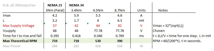

I had another read through that thanks Kit - it's a good resource but I wanted something more concrete.
I think this is my answer, in the simplest terms:
UPDATE 05 June 2019: To anyone that reads this in the future I think I arrived at some wrong conclusions. I've' added a new post explaining why (Post #18). I'm very much an amateur!
All About Circuits: Maximum Stepper Motor Speed
The problem I was having was with the result of the last Max RPM calculation t=4LI/V here:
MassMinds: Estimating Stepper Motor Size
From the calculations I've now done comparing a few motors (from Zapp) in this table**:
Attachment 25816
I get a max theoretical speed for my present parallel-configured 8-wire motors of 759RPM, which agrees with the problems I've had trying to run them at 800RPM. A serial-configured version of this motor (or a standard 4-wire bipolar stepper) would run at a max 379RPM according to the same t = 2LI/V equation when plugging in the values on the datasheet. This makes sense because the specified current and inductance of this serial configuration is 0.5x and 4x respectively. These values increase the top line of the equation (and thus the value of t) by a factor of 2. And since t is on the bottom in the equation: MaxRPM = 60/(200*t) if t goes up by a factor of 2, the RPM comes down by a factor of 2.
I think the author of the article added this '2 factor' into the equations top-line artificially so that when you enter the real ("datasheet-specified") values for an 8-wire stepper motor in a serial configuration, you end up with an RPM half of what it should be.
This is what confused me so much - I struggled to believe that the 3.4Nm, 4.5Nm and 8.7Nm NEMA 34 motors could only reach maximum RPM's of 359, 265 and 195 (at voltages specified in the table). This seemed too much of a drop in RPM from the 759RPM the 3Nm NEMA 23 parallel-wired motors should reach.
Do the values calculated seem like reasonable figures to be expected from stepper motors or could I expect higher from modern stepper drivers?
Maybe because they're using chopping and PWM as opposed to AC waveforms for example, or reducing the coil current at the higher speeds shown in datasheet graphs to achieve them perhaps?
Now I know everyone says that 'bigger isn't always better' in stepper motors and I feel this goes some way to explaining (at least in simple terms) why.
I hope this information might helpful to someone else in the future.
I welcome any correction or any addition to my understanding!
Matthew

Hey Guys,
My apologies, I think I've made some real errors of judgement above! I'm still very much an amateur but here's what I think is happening for anyone that reads this and gets as confused as I did, in the future:
A coil in one phase will have current go from all in the +ve direction, through 0, to all in the -ve direction, and then back through 0 to +ve again in one revolution of the motor. In the case of a 4.2A motor it has a total of 16.8A to move (+4.2A --> -4.2A --> +4.2A) - so massminds worse-case calculation I linked to in an earlier post, I think, is correct after all (although in contradiction to the calculation on All About Circuits website - how?).
For my motor (I=4.2A, L=3.2mH, V=68V) I thus get a max speed of 380RPM. The first time I calculated this it didn't feel right so I did more reading and convinced myself that my gut was right (that 759RPM should be my max). Reading the info on the All About Circuits website seemed to persuade me of this - but it didn't expain why the graphs on some spec sheets for motors were shown with usable torque at even higher speeds.
BUT, it just dawned on me that this (380RPM) is the CORNER SPEED, NOT the MAX SPEED!! This is the speed under-which the coil should be able to fully saturate (build the maximum field strength) in both directions and thus maintain full torque (or very near to) upto this speed. This is what Geckodrives graphs show with the flat portion: https://www.geckodrive.com/support/s...or-basics.html
At speeds faster than 380RPM there is fall-off in torque because there is no longer time to fully saturate the coil with the maximum current. Torque drops off after this speed because its proportional to current and reaches its max speed when insufficient current can be pushed into the motor to make a step.
