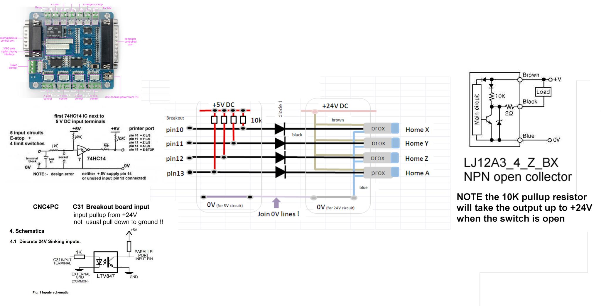

In terms of proximity sensors :
I would go for the 4mm distance sensing type
Prox sensors are more sensitive on steel targets compared to aluminium
They run on something like 12V -30V, typically 24V. When triggered they output this same level so they can’t go straight into a 5V BoB ( is my experience) without doing something to the signal. If your BoB can take this higher voltage then no problem.
Re: About homing and switches...
Have a look at this thread
http://www.mycncuk.com/threads/10262...oes-nt-it-work
You can regard the LJ12A3-4-Z/BX as a normally open relay, where the output is switched to GND when activated. The fact that you supply 12-36V to the electronics of the induction sensor is a red herring. The unswitched output virtually floats and usually pull-up resistors in the BOB strap it to 5v. Meter your BOB input and you should find 5v. If you don't, then you have either buggered the BOB with mis-wiring or the BOB needs a 5v external pull-up resistor. I'll just clarify that last phrase - a resistor to pull the BOB input to 5v, I use a 10K if necessary.

You have mentioned that you will be using the CSMIO IP-M controller. This controller is using the industry standard 24V inputs and you can use either PNP or NPN sensors, the 10-30V type.
JW1977
As i understand i will use 6 of them and one of each axis will double as home switch right?
If you put the sensor on the moving part and have two metal triggers on each end of the axis you will actually need only 3 sensors, one for each axis. And yes, the sensors can be used as both home and limits.
For security reasons it is advisable to also have limit switches that will cut power to the machine before reaching the end of axis travel.

You can use one sensor on the moving part and two targets, one at each end. In normal operation, this acts as the limit switch but during homing, Mach3 and the IP-M know that it is being used for homing and it does not act as a limit switch. As soon as the homing operation is complete, the switch becomes a limit switch again.
I use Mach3 and IP-M. I use a proximity switch at each end (so two swtiches on X, two on Y, and one on Z as it is difficult to use a limit switch for the bottom of Z travel). It is easy to wire the switches on one axis in series so that upper and lower limit switches are connected to one IP-M input. This means that you can home X and Y at the same time. My machine is configured to home Z first (to get the spindle to the highest point to clear anything on the machine), then X and Y together. This saves a little bit of time on a bigger machine and works well.
If you just use one sensor per axis with a target at each end, then you can still wire each sensor to a separate IP-M input channel, obviously, and get the advantage of homing two axes at the same time.
I had one small problem with my Z axis homing. As I said, my machine first homes Z, then the other two axes. However, these proximity switches sometimes have their on and off trigger points very close together. What this meant was that when my Z axis was homed, the switch was so close to the target that a tiny amount of vibration could cause the switch to trigger accidentally and this often happened while X and Y were moving. The answer is to configure Mach3 so that the home position is very slightly offset from the actual switching position - I use about 1mm. This avoids accidental triggering.

As you are using CSMIO, as Paulus mentioned, this will take the prox sensor 24V directly. It has taken me a while to find my original drawing but for anyone with a cheap 5V BoB this is what I had to do to get it work. Without the diodes it was very unreliable at triggering. With the diodes it is 100%. Maybe these should be fast acting types, but mine were regular types and the homing is very repeatable. Sorry for the side track on the OP.

As usual
the devil is going to be in the detail
when looking for the solution to problems connecting limit switches to breakout boards
for instance the LJ12A3_4_Z_BX proximity switch does not have the simple open collector NPN transistor output you may expect going by some adverts and data sheets
It has a hidden 10K pull up resistor connecting the output to the positive supply !Attachment 26401
with ref to the diagram in post 24
Attachment 26400
adding the diodes works with the usual TTL inputs found on most BOB's
that requires the switch to either ground the input or go open circuit
some Chinese BOB's have opto isolated inputs with a PC817 input LED and current limiting resistor connected to +10V
the Geckodrive G540 has its opto isolator connected to +12V and has a 2K2 current limiting resistor
Attachment 26398
so you don't always see 5V across the BOB's open circuit input and ground terminals !
BOB's like CNC4PC's C31 need a positive 24V input
so if you are using proximity switches you need one with a PNP output
to pull the BOB's input up to the positive supply
many Chinese BOB inputs connect to either a 74HC14 or 72HC245 logic
IC input
(see the upper left hand corner and centre of this diagram for the Chinese BOB input
Lower left hand corner for the C31 )
Attachment 26403
( I prefer N/C switches because a broken wire will be trip the axis limit
with N/O switches a broken wire will not be detected )
John
As per reply #17 to this thread:
John, this topic was discussed (with the internal circuit you reprint) in 2016, till I got sick of it. The LJ12A3etc is designed for industrial 24v control sensing, but it works equally well switching amateur 5v (without diodes) if your BoB pulls the pin to logic 1 at 5v. The supply voltage to the device electronics has to be min 10v max 36, it will work below 10v, but not reliably, presumably because the oscillator duzzn't buzz. It has an internal 10k, but even so, the thing operates for practical purposes, just as if it is a NO relay on the blue and black wires. I happily use them with a 12v supply with the black wire connected directly to the BoB input.
Peace and Love
Rob-T

So, anybody got a good source for proximity sensors?
As i have understood, im in the market for the inductive kind. 4 mm sensing distance would do it and NPN/PNP should not matter with the Csmio IP-M. Emergency switch, some resistors and a main switch is also on the shopping list right now...
Don't waste money buying the expensive switches Just buy the cheap Chinese switches off ebay.
I've fitted 100's and probably had about 3 in total that was faulty out of the bag. I've had about 5 fail in use over a 10yr+ period all on different machines.
The accuracy is more than good enough for any Router or DIY Milling machine.
The IP/M doesn't care which you use but I always fit NPN switches.

Why the resistors.? You don't need any for the IP/M
Maybe you got confused with all the chatter of 10k internal resistors, pull-up resistors and so on. You paid good money for a quality controller and therefore the prox sensors just plug straight in !
I think I used resistors on the 12V front panel LEDs to run off 24V but that depends on how, or if , you want indicator lights for status and so on. For example they can also be mains powered indicator lights.

However, havent got to it yet, collecting the final parts right now but, i read about one resistor in the driver manual.
Remark:
VCC is compatible with 5V or 24V;
R(3~5K) must be connected to control signal terminal.
If im not mistaken i think i read about it in in the Csmio manual also but they recommend a 2K resistor there!?
Couple of odd comments:
IP/M is very happy with direct connection of prox switches running on 24V. Works well.
IP/M drives the usual stepper drivers directly without needing any resistors. Use differential connection if your drivers support this - better noise resistance.
Unlike Jazz, I've not been too lucky with prox switches from eBay. I bought a box of ten. One was the wrong type (unbelievable! Two-wire, quite obviously not the same as the rest of the 3-wire switches), one was faulty straight from the box, and one failed very shortly after fitting. However, the rest have been working fine for a couple of years now, and the whole box probably cost less than one "professional" quality switch. That's the difference between home building and commercial - commercial machine could not stand that level of quality, but it suits my pocket!
