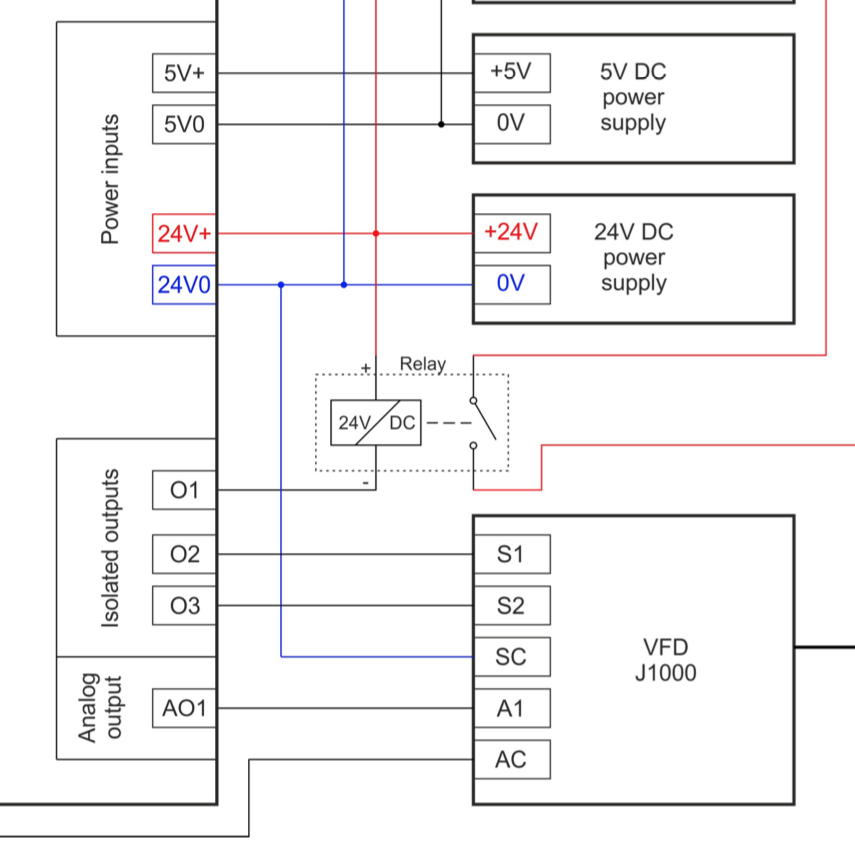

In the AXBB manual it shows the following
Attachment 26444

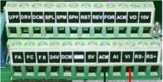

and the VFD has the following
Attachment 26445

Connect the VFD ACM (analogue ground) to your 0V/GND level, and the AXBB analogue AO1 output to VI input to the VFD. That gives you your 0-10V control.
Now, I expect O2 and O3 outputs are designated forward/reverse, so connect these to the FOR and REV inputs to the VFD. As these are digital inputs to the VFD you'd best connect the DCM (digital ground) to your 0V/GND as well.
You say you've set PD00... : so I guess you've unlocked PD000, PD001 = run control = external = 1?, PD002 = operating freq = external = 1, PD044 = FOR = 2, PD045 = REV = 3, PD070 = 0-10V = 0 etc?

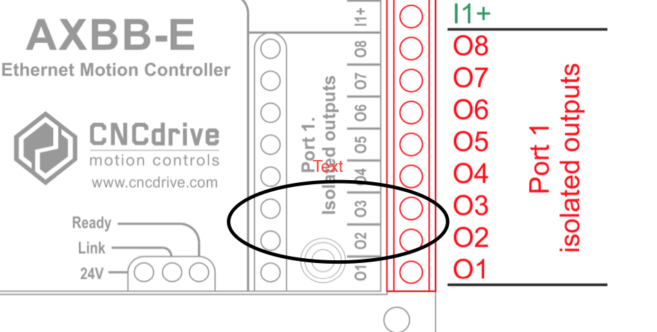

The digital inputs to the VFD are referenced to the digital ground, DCM. The isolated outputs that you're using on the AXBB are open-collector outputs to the AXBB's 24V0 supply. So, rather than connect DCM to 5V0 connect it to 24V0. It's possible, of course, that your 5V0 and 24V0 are commoned in any case depending on your PSU wiring.
Question for you - when you enter a M3/M4 command from the MDI on the RUN page, do the corresponding LEDs on P1[2:3] illuminate?, just a check that you're getting the digital drive for the motor selection. Secondly - according to your settings a "M3 S5000" command into the MDI should set the AO1 pin to 10V, and e.g. "M3 S2500" should set to 5V. Does it?

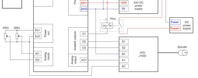

The AXBB manual shows the 24V0 being used as the ground reference to the digital outputs to the VFD controls.

Also, there's a jumper next to the terminals on the VFD that needs to be set correctly.

The 5V0 is simply the 0v reference for the 5V supply. Similarly the 24V0 for the 24V supply. You *can* connect these together - it just means that the supplies then share a common reference.
The isolated outputs from the AXBB are (I said Open Collector, from recent posts it's clear these are Open Drain - difference in transistor technologies - FETs vs Bipolar, but ignore that). This does mean though that the output FET Source is connected, in the case of the AXBB to the 24V0 supply. Therefore, to switch the digital input to the VFD (which is to provide a low-impedance path between VFD DCM and FOR/REV) then you need to connect the FET's source (24V0) to the DCM line on the VFD and the drain (O2/O3) to the FOR/REV input on the VFD, or it simply won't work.
One other thing to try, to help diagnose your problem - you're 3-core CY cable - with the DCM/FOR/REV wires - just try shorting the other end so DCM & FOR are connected - you should see the VFD display change (from memory it goes from a flashing display to a solid 00000 to indicate a demand for 0RPM... but that's just a distant memory).

Nope, that diagram shows the analogue output AO1 referenced to 5V0, so you need to connect 5V0 to ACM (which I believe you said you already did). (or connect 5V0 and 24V0 together).
You could try connecting the VI input to the VFD to the 5V+ supply (obviously, having disconnected it from the AO1 output first). Then M3 should command a 12000RPM output from the VFD (not variable) - that would confirm that the VFD analogue input is correctly configured. And that would leave just trying to work out why both UCCNC and the AXBB aren't playing with the PWM output control. It feels like a UCCNC configuration thing but your screen shot looks basically right. I can dig out my settings for my Starmill (I have UCCNC driving EITHER that or the Sieg, but it's currently wired into the Sieg which has a manual spindle control).

finally got it going no relay needed
removed jumper then
A01 = VI
ACM = 5V0
DCM = 24V0
FOR = pin 7 port 1
REV = pin 8 port 1
