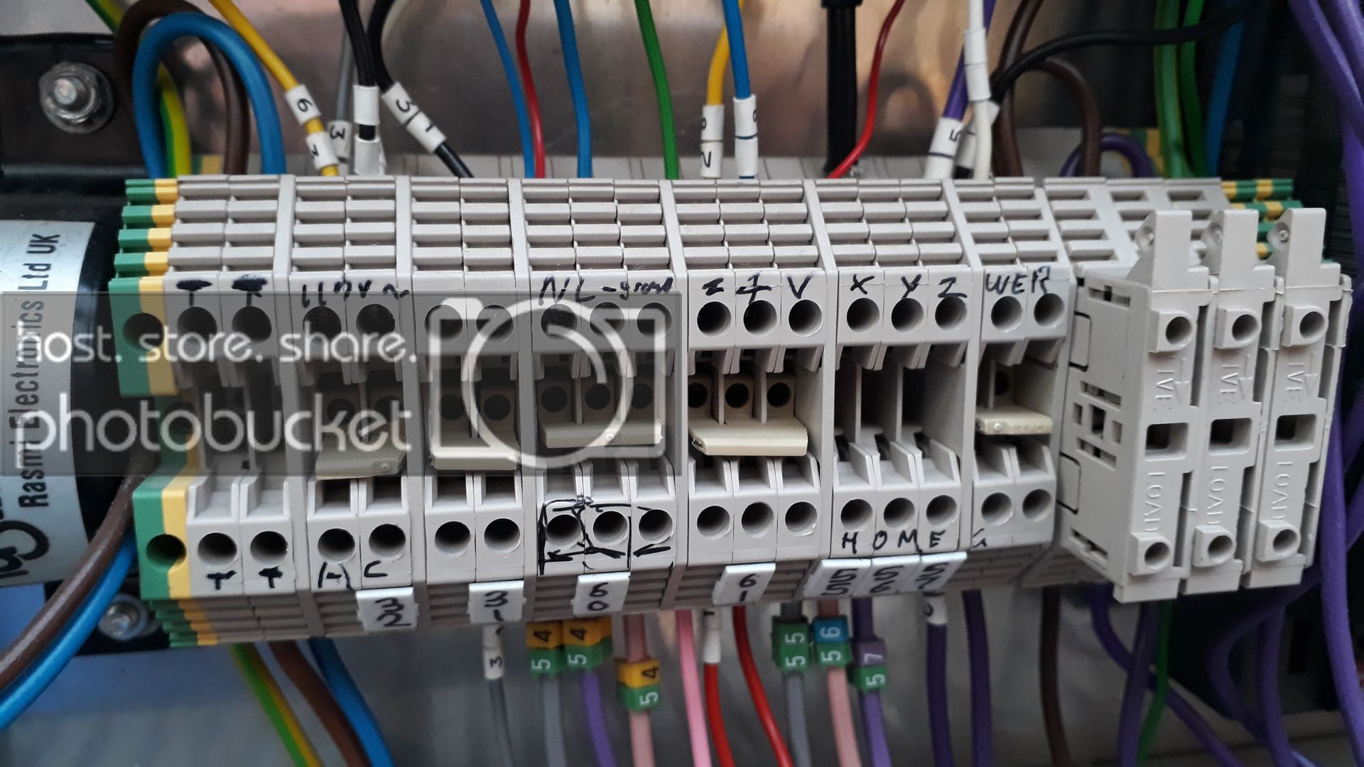

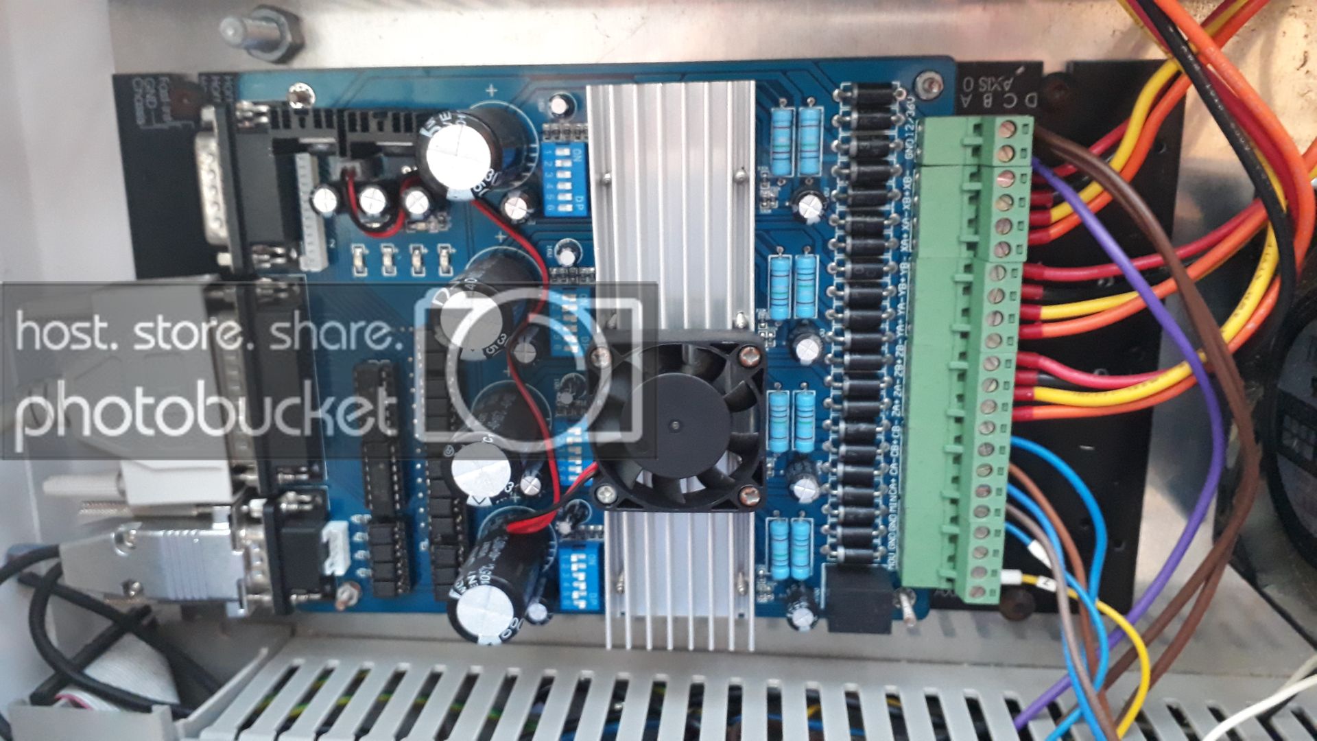

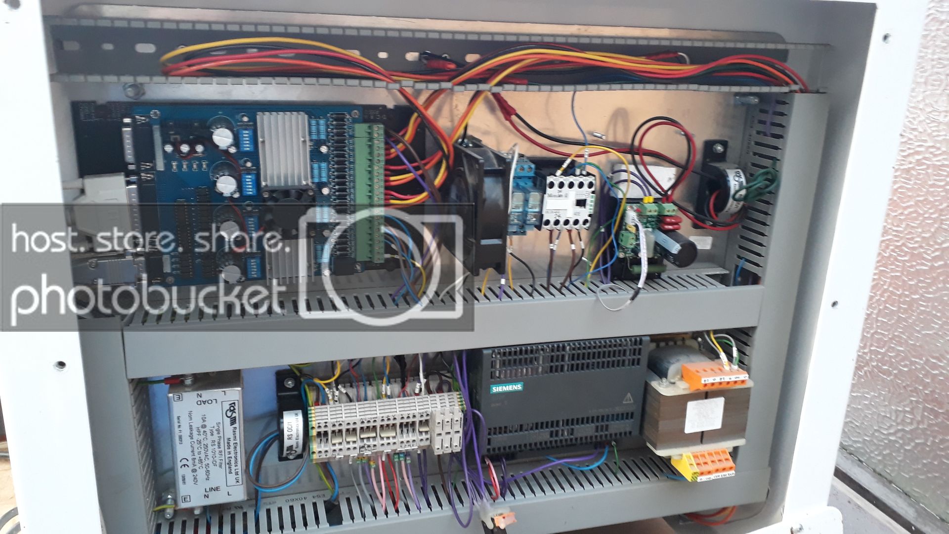

OK, right, sorry for the delay, you know how life is sometimes.
I opened the back up and was confronted with this:
Attachment 26881
Question 1, Am I correct in thinking the control board is the one on the top right? This thing here:
Attachment 26882
If so, it looks like a non original part and is probably part of the mach 3 conversion. How am I doing? on the right track? lol I don't think the drivers for my pci card were installed correctly. I had to install them manually into the right folder, so I either haven't done that right, or I installed an incorrect driver. Either way, it's doing my head in, which leads me to my next question.

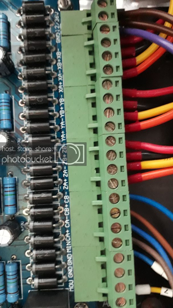

Question 2, Starting again, what software and peripherals would be required to get going again? By peripherals I mean pci cards, boards etc.
Question 3, If I wanted to go down the route of using a standalone controller, like a ddcsv2.1 for example, would that simply be a question of extending the wires that go into here:
Attachment 26883
and here:
Attachment 26884
and wiring them in to the back of the controller? Is that a question for another section or can it be answered here? Any info or recommendations appreciated.

It looks fairly well documented / labelled so certainly a retrofit would be on the cards.

# 1 Yes but unfortunately it's not good news because that board is a All-in-one board so the drives for the motors are built into it. So to replace you'll also need new drives for the motors.
#2 If starting over then I'd advise you to go with an Ethernet-based Controller. Most modern PC's have ethernet so you won't need any PCI cards etc Regards software then you'll only need the control software ie: Mach3 and any Plug-in for the controller (Nearly all external controllers require plug-in)
#3 If you had drives then yes, in theory, it would just be a case of re-wiring to the stand-alone controller.
But warn you if you can't get your head around this setup then you have no chance dealing with the DDcsv2.1 or any of the cheap chinese controllers. So unless you speak Chinese and like puzzles then stay away from is my advice.!

First of all my apologies, for some reasom I thought you had the 3 axis board but you have the 4 axis one. That manual is here https://wiki.shapeoko.com/images/9/9...ler_4-axis.pdf I don't know what you use the 4th axis for, it is wired in - is it for the spindle as the spindle interface does not look to be used.
Re: Problems continue and don't know what to do
Ok, thanks Rob. Was nearing end of my tether. Had searched online for the board previously to find additional info but I didn't twig either.
Put those settings in, wildly different. I can now move axis with arrow keys, but intermittently, if i hold key down it only moves kn steps and I have to release then re press again.
