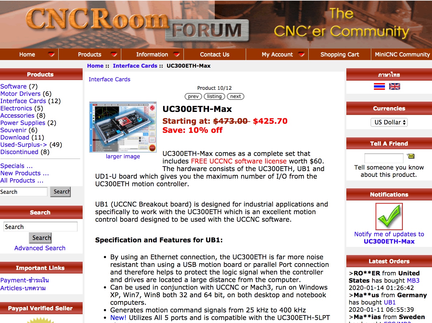

Re: Laptop for connecting to CNC?
Or maybe I only need this?
Attachment 27071
https://www.cncroom.com/interface-ca...7b9jgm13v1aj83
PS: Just noticed that with the above the UCCNC Licence is included but not with this package.
MCmec
That is a good setup and you won't go wrong. Just buy the license separately. You won't need the UD1-U board as you will have more than enough I/O from the UB1 for even a complex router setup..

I'll look more at the AXBB. but for some reason I like the idea of the UC300ETH with a UB1 (lots of inputs and outputs).
I still have a lot to learn before I make any final decisions.
Just click on those links and their web page opens. CNC Drive is a Hungarian company.
CNC room is in Thailand, not the USA. If you're buying a UB1 I don't know of anywhere else to buy it, and CNC room make it, so they're the best place for support.
Regards the UCCNC license, sure buy if from Hungary, but prepare to pay VAT. Alternatively buy it from CNC room, don't pay the VAT and save £20.
