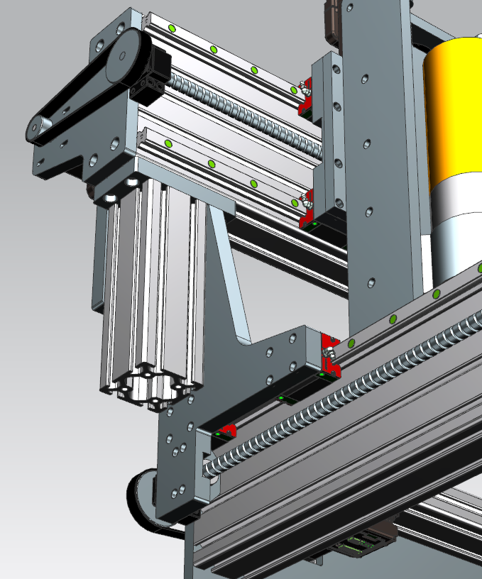

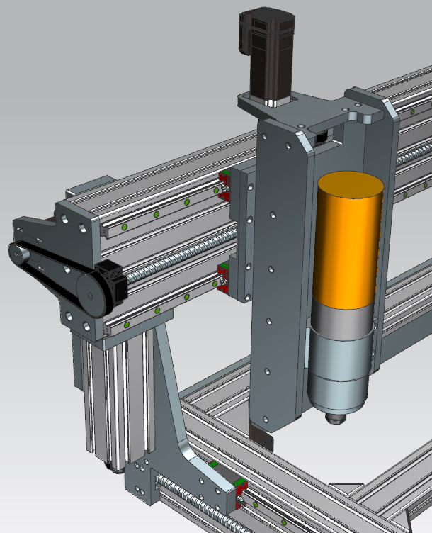

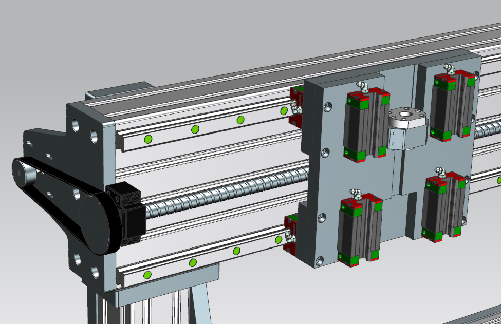

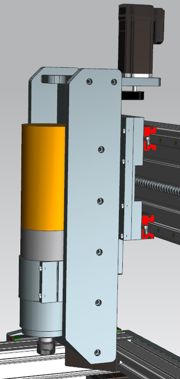

12 Attachment(s)
Re: Thoughts on Sorotec alu-line machine
JAZZCNC

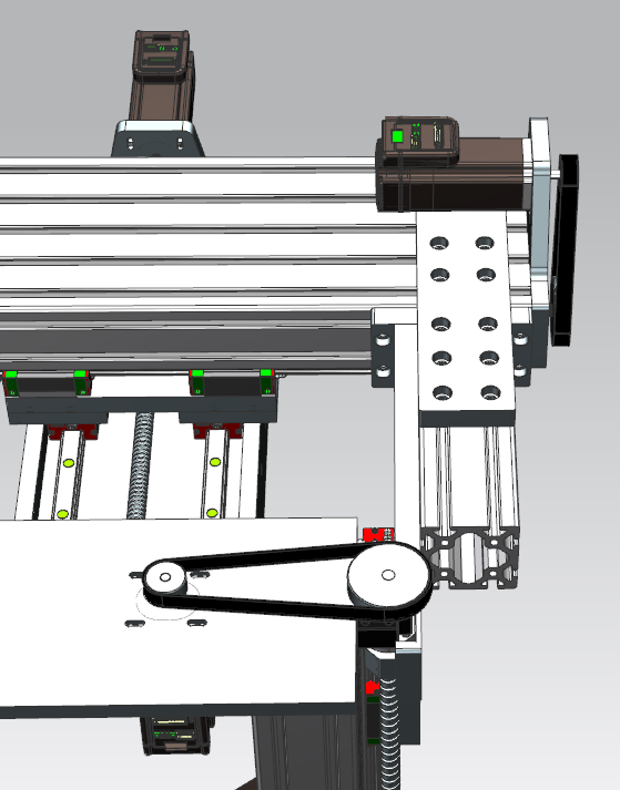

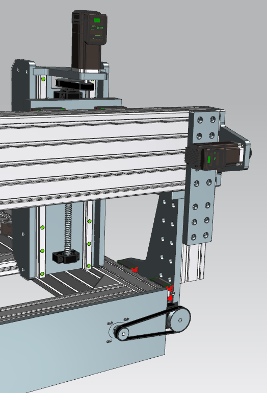

I have taken some inspiration from the gantry design in your machine. What I've done differently is:
- It is far from done and many details are still missing. One gantry side is still missing completely.

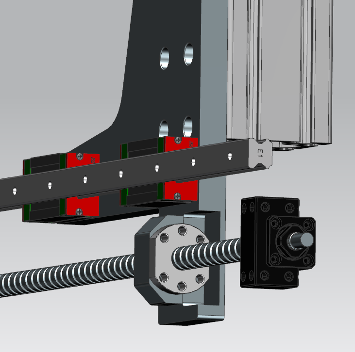

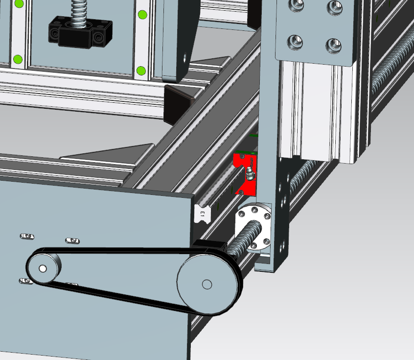

Attachment 27394 - Y-axis linear rails are side mounted to the 160x80 item profile. This allows a larger work area and the ball screws can be mounted to the same piece of aluminium plate, with a little bit of machining.
Attachment 27385 Attachment 27393 Attachment 27396 - Gantry side plate is on the inside and an 80x80 item profile is mounted on the outside of the plate. The 80x80 item profile is mounted to the X-axis 200x80 item profile with a back plate and a bottom plate.
Attachment 27387 Attachment 27386 Attachment 27388 Attachment 27389 - The X-axis ball screw and linear rails are all on the front side. With some machining on of the aluminium plates, I am able to squeeze everything in the with custom made ball screw nut brackets.

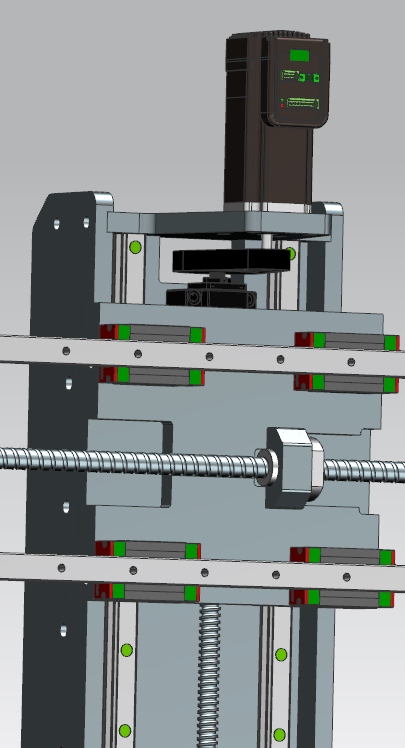

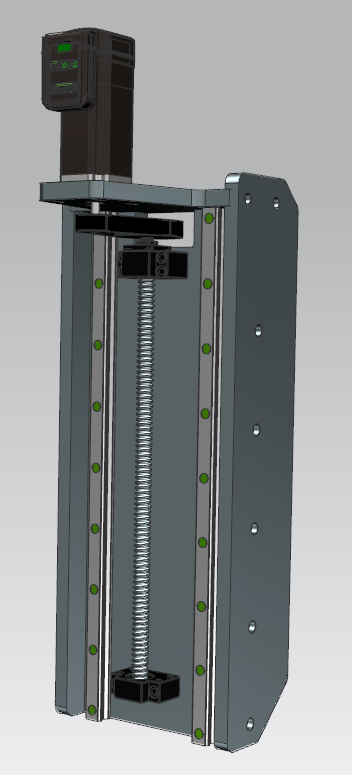

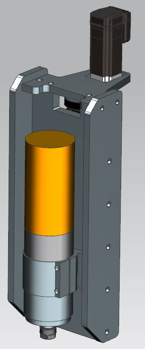

Attachment 27390 Attachment 27392 - The Z-axis is made stiffer with side plates bolted onto the same plate to which the linear rails and ball screw is bolted.
Attachment 27391 Attachment 27395
Please let me know what you think! Are there any significant improvements I could do to make it better?
The main issue I see is the Z-axis and the unnecessary weight of it.!
You don't need or want the motor and ball-screw on the front plate because you are just moving around dead weight which will affect the z-axis negatively due to high inertia. Those 180W servos won't handle that weight, especially if your planning on using a large spindle or ATC spindle. You will also need a brake to stop it dropping when unpowered.
Ideally, you want a light but strong front plate with no excess baggage to affect inertia. The ball-screw could easily go on the rear plate and be shorter, the motor could mount to plate coming off slightly longer rear plate. This longer rear plate will also allow more spacing of the bearings which will stiffen things up a little.
The other thing I don't like is the ball-screw on the front. If it was me I'd mount it at the rear out fo the way of chips etc and have the ball-nut mount to the plate which the Z-axis motor mounts onto. Don't worry about the ball-nut not being in the so-called theoretical ideal central sweet spot of the front plate because in real-world the difference isn't noticeable. However, weight in the wrong place very much does affect the machine.

Thanks man, Ill revise my design and start a build log to collect more feedback!
Do you still recommend that the linear rails stay on the Z-axis front plate? It would be significantly less weight to move if they are on the Z-axis rear plate, but not as stiff of course. Stiffness could however be increased with some aluminium strips.
Skickat från min SM-A530F via Tapatalk
NordicCnc
Do you still recommend that the linear rails stay on the Z-axis front plate? It would be significantly less weight to move if they are on the Z-axis rear plate, but not as stiff of course. Stiffness could, however, be increased with some aluminum strips.
If I'm honest I don't find there's a lot of difference between them. I used to build all my machines using rails on the front plate and yes it is slightly stronger but it does have some drawbacks. The weight is one but the other is tool height or should say gantry clearance because of the tool length sticking down below the gantry.
With the rails on rear plate, you can raise the tool above the bottom of the gantry allowing for longer tools or a lower gantry clearance if you don't need the height for the material.
The machine in the video as the rails on the backplate.
JAZZCNC
Thats a good point with the tool length. Although I am struggling to think of any kind of tool with that length other than some extremely long drill. Also the distance between the tool and the rear plate in the y-axis and x-axis direction limits the work area in that case. And as you said, it comes down to if the material requires a larger gantry clearance.
I really think the extra stiffness with the rails on the front plate may be worth it. I also think that I will need the gantry clearance for material at some point and less long tools.

Regarding the budget I have planned to stay within 6000-7000€. I have already bougth the 180W JMC servos and power supplys. What is left of the budget is then 5150-6150€.
I am definately going for an all round build. Requirements are:
- 180W JMC servos.
- Work area of approximately 1000x1000x200mm. More is appreciated. Work area is needed for making furniture occasionally, custom signs etc.
- The machine needs to be moveable later when I build my own garage. I am currently using my fathers. This is why I am opting for aluminium profiles instead of a welded frame.
- Machine needs to be able to handle aluminium with good finish. The idea is that I could also potentionally use it to build a VMC later that would be for milling aluminium and steel.
- ATC spindle would be nice but it is not a requirement if it means that my budget will not be enough in other more important areas. I am looking at Jianken ATC spindles but I am open for suggestions!
Have I shoot myself in the foot with the JMC servos?

I have already bought the 180W JMC servos and power supplies. What is left of the budget is then 5150-6150€?
Cannot comment on the JMC servo's as I've never used them but power is power and 180W isn't massive so you'll have to be mindful of the weight and mass your moving around.
The budget is healthy though so definaltely possible to build a very nice machine.
NordicCnc
The machine needs to be moveable later when I build my own garage. I am currently using my fathers. This is why I am opting for aluminum profiles instead of a welded frame.
Well if that's your main reason then it's the wrong way to think because while Aluminium is lighter than steel the total weight of machine this size will still be heavier than 1 or 2 men can handle safely so you'll still possibly need some lifting equipment. So why not just build the best machine you can and don't worry about the weight too much.
NordicCnc
- Machine needs to be able to handle aluminum with good finish. The idea is that I could also potentially use it to build a VMC later that would be for milling aluminum and steel..
Again I wouldn't let this dictate the design of this machine because a VMC worth the effort requires building from steel and this machine won't machine steel to any great accuracy.
If it was me I'd look more along the lines of using this to make money and learn CNC then buy a used VMC that you can retrofit with new components. Or buy old Iron manual Mill and retrofit it to CNC. Both these options will be much better and far easier done than trying to build a VMC with a Router, no matter how well built it is.!

Anyway I managed to find a similar machine to yours (please no offence, it is most likely not better or even comparable): http://www.cncrouterparts.com/pro484...kit-p-251.html
What do you think about this one? Can you see any glaring issues?
If you can't see the difference with all the advice you have been given. I , we give up.
NordicCnc
The only thing that's similar is it uses a profile.!
NordicCnc
Not a Lot.!... and Many.!. .But like Clive says if you cannot see the differences by now then either we have been wasting our time or you are taking the Piss.! . . . Either way, you're on your own from here. Good luck.
JAZZCNC
I am extremely sorry for any inconvenience and if I have been annoying! I can promise you, that your time has not been wasted. I have learned a lot from you! I agree that my last question is unjustified and the statement about similar machines is very incorrect. Again, apologies from my side.
