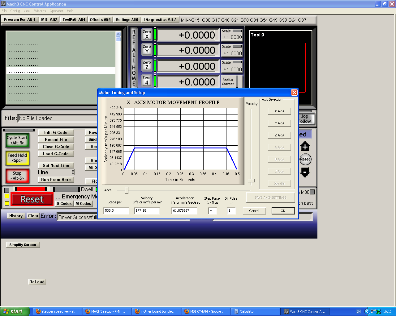

It is the velocity and acceleration figures that adjust the speed, what are they set to?
Attachment 1072hi
i have tried various settings in here
Right the maximum you can do with this is 177.18mm / min if it can get up to speed in time hence your 88mm/min or suchlike.
Leave the steps alone and increase the velocity to 2,000 to start and acceleration to about 150 as a start point.
