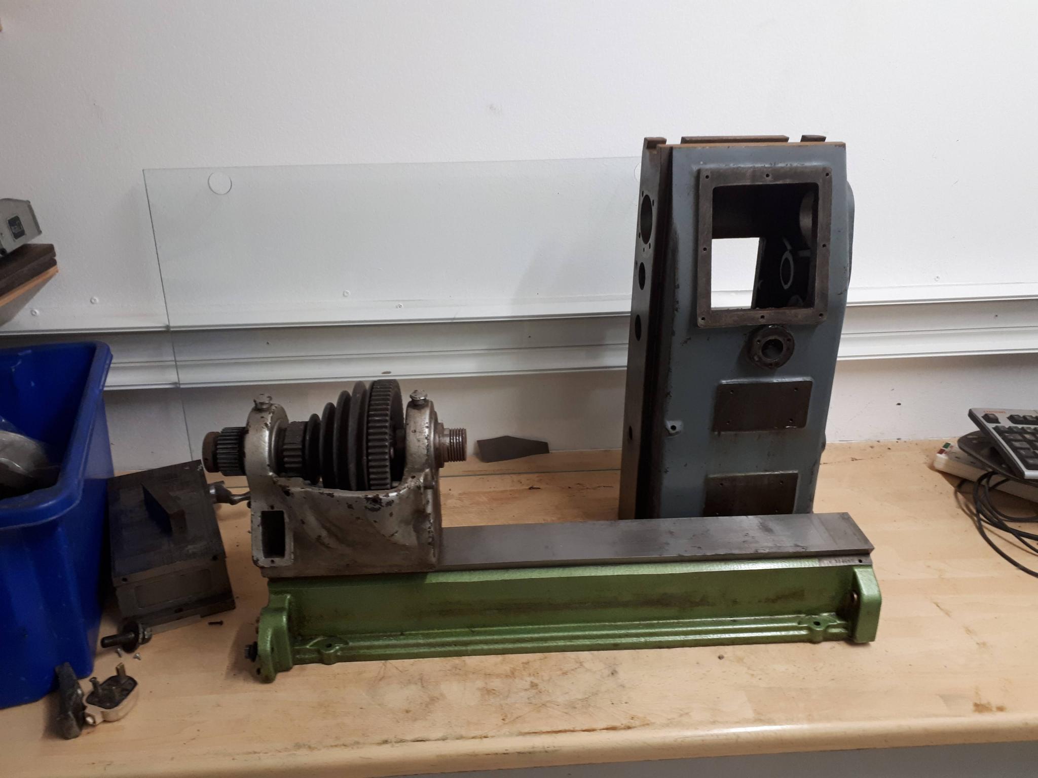

So far I have a Myford ML10 bed as the lathe base and a Centec 3b column for the milling base. Attachment 27710
What's the best way to move this forward? create a spec list and work through it?
Attachment 27710
What's that Column off Ross, that's a weird looking thing.! . . .It's like a cross between a bed Mill and wood burning stove..:joker:

Jazz, it's a small horizontal mill column, which would normally have a gearbox in the 'window'.
Thanks, I've since found a pic.
