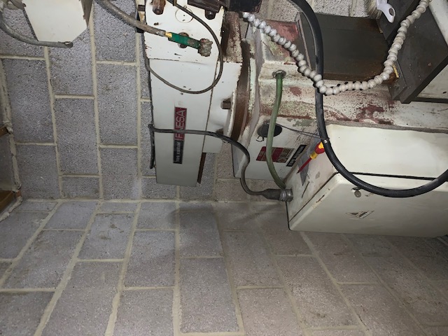

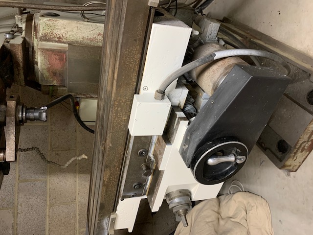

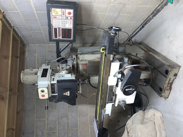

haha! definitely not going to be getting any boats in the garage any time soon! I've added some photos to help give you an idea of size but its not really much bigger than a standard Bridgeport to be honest. table length is a little over a metre..
Attachment 27814
Attachment 27815
Attachment 27816
Attachment 27817

Re: TOS-KURIM CNC Upgrade
That should be a simple upgrade you have most of the hard work done in the form of mountings etc, just a few adaptor plates for different size frames with motors will sort it.
I'm presuming you don't want to CNC the Knee.?
You just need to decide if want servos or steppers.? Quite a lot more work in setting up along with big learning curve involved with servos but they do give higher feeds, more power along with smoother operation and accuracy.
The downside is they also cost more money and require a higher level of the controller to get full use out of them. They can be much more temperamental than steppers and very unforgiving on poor wiring quality or practices.
Steppers, on the other hand, are much simpler to set up with hardly any learning curve involved and quite a bit cheaper. They can be run on a lower level of controller.
The downside is they are limited to roughly 1200 to 1500Rpm so feeds are lower. Resolution is lower compared to servo's but still more than enough for milling at this level.
Choosing the correct drives and size is critical with large steppers because you don't have lots of spare power as you do with servos. So if you take this route then look for 220V Mains powered Drives rather than lower AC/DC drives running say 80Vac or 100Vdc.
I've used these many times and they are a great set up with lots of power and provide reasonable torque even at high feeds. More than enough for your machine.
https://www.aliexpress.com/item/3279...3cac6f37OxW5VA
Hope this helps, got any questions just ask.

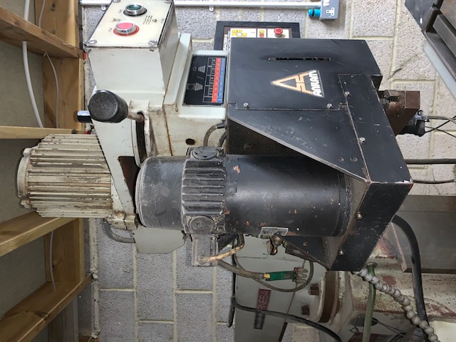

4 Attachment(s)
Ok, so some info I have found about the motors which also seems to match what's on the motor plates (photo attached):
permanent magnet DC servo motors
2000RPM
170V DC
tachometer mounted on rear (I think.. photo attached), but no idea of what output this gives...
with regards to the backlash and scale accuracy asked previously..
They are Anilam linear scales with 0.01mm resolution, again no idea of output type but photo attached if anyone might recognise it.
Done some measurements on the backlash, it's a lot worse than I thought to be fair!
X: 0.15mm
Y:0.04mm
Z:0.06mm
On a side note, the X axis moves faster than the pitch of the ball screw, does that mean there will be some kind of gearbox on the ball screw itself?
Like I say accuracy isn't of too high importance with this, I can sneak high accuracy stuff into lunch breaks at work if I do need that.
The main type of work I will be doing on it is very agricultural low tolerance stuff that I can't always get away with at work :whistle:! In all honesty I don't really need CNC functionality for most of it, its just a nice bonus to have!
With all that taken into account, Is a stepper setup going to be best for me? I know its probably not the best end result for the machine but it will keep it nice and simple for me to convert and use for now.
It would be nice to keep all the original motors but its sounds like it may be a bit more complicated to get running?
Or will this be realistically unusable as a CNC with that amount of backlash until I get that sorted?
That is a tacho you are looking at. They have no purpose nowadays, what with digital drives. You should try to remove it to see what the end of the rotor shaft looks like. A rotary encoder typically has a small (6mm or so) shaft and creates negligible torque drag, so mounting one in place of the tacho could be quite simple. Something like this Chinesium clone would be suitable https://www.ebay.com/itm/OMRON-Rotar...g/332386539771
One of those CNCdrive brushed servo drivers would be fine for a motor like that and the encoder would connect directly to it. https://www.cncdrive.com/DG4S_16035.html The bigger one is rated at 160V / 45A and although your motor is rated at 100A, it's a beast (47Nm!), so you can probably manage very nicely with half of that. The advantage of going this route would be minimal messing with the mechanical parts. You can probably just leave the encoders where they are for now unless you could hook them up with one of the Chinesium DRO displays just to frighten yourself.
This would be a good time to get a parts list / exploded / section view / manual for the machine. There's a good chance TOS would still have documentation, or you might find a user who could scan one for you. Then you can see how to dismantle it and how it works.
I would expect that the ballscrews will be fitted with double ballnuts, so you'd have some degree of adjustment for taking up some of the backlash. There's likely to be two ballnuts with a shim between them. You can fit additional shims to reduce backlash, possibly without having to even remove the ballscrew. Going to the extreme of fitting bigger ball bearings would likely require you to dismantle the machine, which is quite a large beast.
