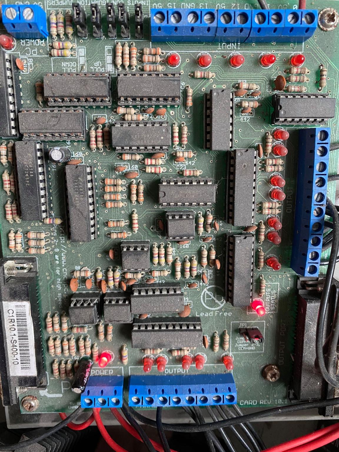

This is my first forum post so first of all, hello everyone! I am at the stage of building the first cnc plotter, quite large and heavy as for the first machine (about 1.8m x 0.8m) and I would be very grateful if you could help me with electronics. Quite a long time ago I inherited second-hand electronics, theoretically complete set, after amateur coversion of a mini milling machine, although I have problems with it and I hope that this is my lack of knowledge. I would love to use as many components already bought as possible .. but to the point:
Breakout board - CNC4PC model C1
1. The motors do not spin despite the fact that Mach software shows movement using the arrows on the keyboard. The motor is locked, it cannot be turned. There are diodes on the breakout board, it seems to me dedicated to outputs, not activated, only the 'outputs status' diode is on, what should I check step by step to verify if the board is ok?
2. How to check if the drivers are ok? The voltage is fine, 42V on each of them. The voltage between A + and A- and B + and B- in the case of one motor connected is 1.7V, in the other 1.4V. Where there is no motor connected, 42V between A + and A-. Is this correct?
I would have more questions, but for now, the most important is to verify whether the board and drivers are in full working order and configured with Mach3. The attached photos show Mach3 settings, previously configured with current set up. Thanks in advance for your help, I will post a full 3D project and a schematic after completing the project here. I’ll post more details about my design soon.
Regards!

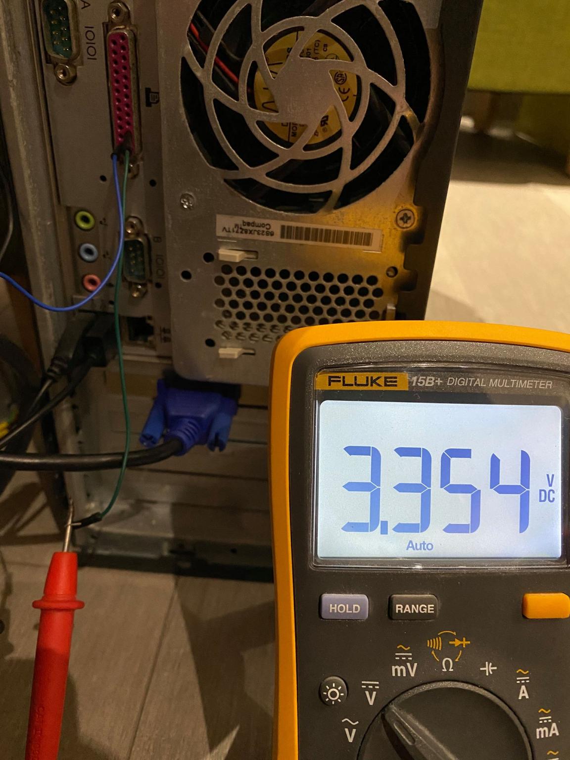

1) My first question is - has you witnessed the actual computer that you're using with Mach3 successfully drive this board?, I think from your description - no? The problem here is chasing a potential ghost - if the PC is not set-up correctly then you can probe the board all you like and there'll still be no life.
2) Are you using a full 25w wired parallel cable between the computer and the BoB?, have you tried a quick continuity check to make sure pin-1 goes to pin-1 etc through pin-25? (if you found a random 25w cable it *could* be a serial cable with only a small number of wires connected, and some of those possibly swapped). Check the basics.
3) Of interest - on the BoB - there's a 3-pin jumper header labelled "JP1" - there should be a shorting pin connecting two of the pins together - which two?
4) Would you be confident to ***CAREFULLY*** measure the voltage on pin-1 of the 25-W D-type that the computer plugs into, with the system powered. I'm talking about connecting the meter black lead to 0V and carefully probing the PCB where the pin-3 is, and measuring the voltage with the X-Axis moved in one direction, then again with the X-Axis moved in the opposite direction. In one direction you're expecting a voltage less than perhaps 0.8V and in the other direction greater than perhaps 2.5V.

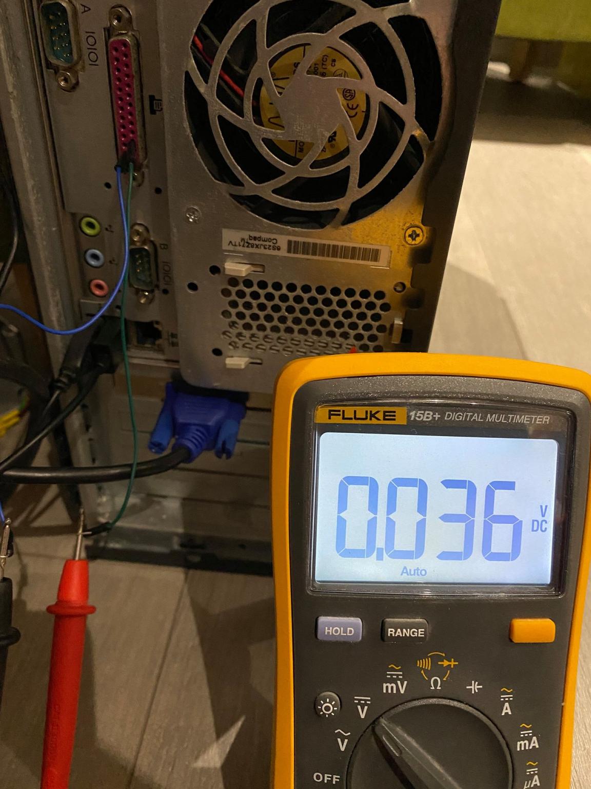

5) Much easier - could you do this again on the PC. insert a couple of pins or bits of stripped solid strand wire (paperclip?) into pin 3 and pin 25 of the PC parallel port and measure for each direction of X-axis travel. If you can provide a photo of this for our amusement (and validation) - this is getting to the point where we should be able to understand the PC->BoB communication - I think the BoB's basically functional, so this is important to understand why the BoB is not seeing the commands from the PC.
I managed to measure a voltage for X, Y and Z axis (just in case) and I was getting just a little bit above 2.5V and 0.07V (not too low?)
Doddy
Take a look at the pictures attached, for your amusement :) I’m measuring 3.35V & 0.036V, almost identical on pins 3 to 9.
From what I understand, there is a communication between PC and BOB, but there is no signal to the outputs .. as you can see at the picture, BOB is a little bit messy so would it be a good idea to give it a good clean with isopropanol for example?
Another thing that I have spotted is LED next to PC power terminals which was illuminating for some time while PC was running but the rest of the system wasn’t powered. At some point, it disappeared .. is it normal?

2 Attachment(s)
Re: CNC plotter 1800 x 80cm, first build, questions and queries.
Okay, some weirdness now understood with this BoB.
The parallel port, pins 18 through 25 are supposed to all be grounded, at the PC side. A 25-way parallel cable should be expected to be fully wired, pin-1 to pin-1 through pin-25 to pin-25.
The "CNC4PC model C1" pulls the pin 18 high, and monitors this to be dragged low by the insertion of the parallel port cable to the PC. Without this, although the PC and the board supply voltage may be present, the outputs (at least) are inhibited.
Solution - a fully wired 25W parallel cable (and similarly wired parallel port), or short pin 18 to PC ground (pins 19-25).
Pic 1 - board with separate 5V supplies (PC and Main) - and EN set high. Power LEDs for the two supplies on, but the output-enable LED (on, if the main PSU is on, but extinguished with the PC power supply added). Shorting link from a ground to pin-1 to extinguish Output 1 LED (note: they are all off because pin 18 is floating).
Attachment 28134
Pic 2 - Added a ground to pin 18. Output-Enable LED is illuminated as are all other outputs, except for pin-1 because of the aforementioned shorting link.
Attachment 28135
All other outputs and inputs tested okay.
