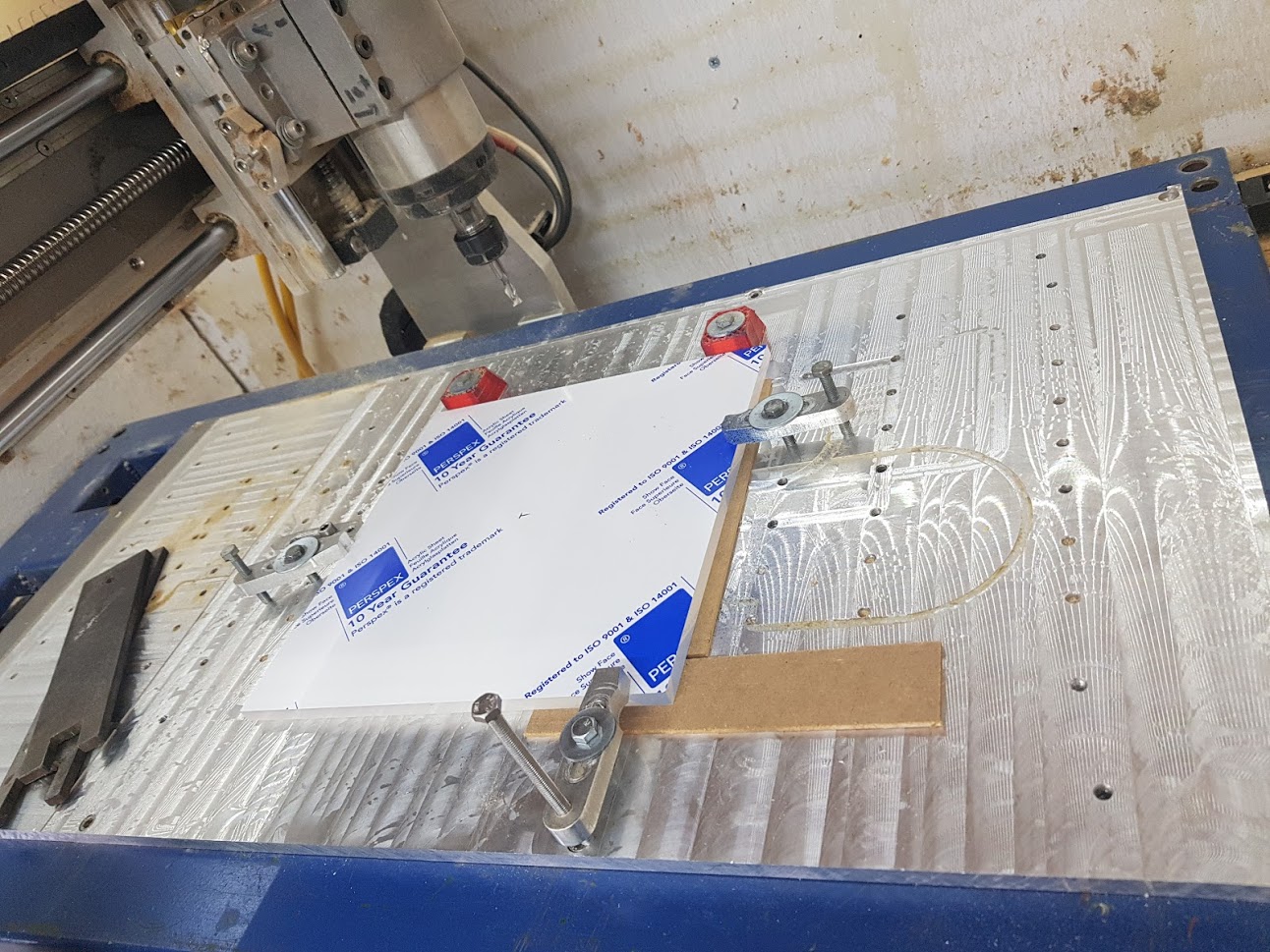

I do quite a lot of milling wood, composite woods and hardwoods. Most of the time you need not bother if you are working with mdf or an engineered one as they are perfectly flat most times. Raw unfinished wood, so band sawn or rough sawn generally yes face them either side if you are wanting clean finishes on either side. Generally when I do my hold down which I use 20mm x 50mm x 10mm aluminium bolt down clamps I milled I will mark out on my work piece the dimensions and then give myself a good 3 or 4 mm to spare. Being aluminium you can get away with the odd scrape instead of steel where you get no chance of getting away with such. My clamps are all sorts of shapes on the tips :whistle:
Be it a messy setup, it works flawlessly so i never changed it. Attachment 28417
Regards to the last cutting, I tend to leave that specific task for the cutting of the very final edge before it would disconnect from the main body that is clamped down. Ensure you have triangular tabs. Most times with wood I'll let it drop down to the bed once its been cut free as there is normally sawdust within the slot which acts as quite a good temporary restriction to stop it moving sideways.

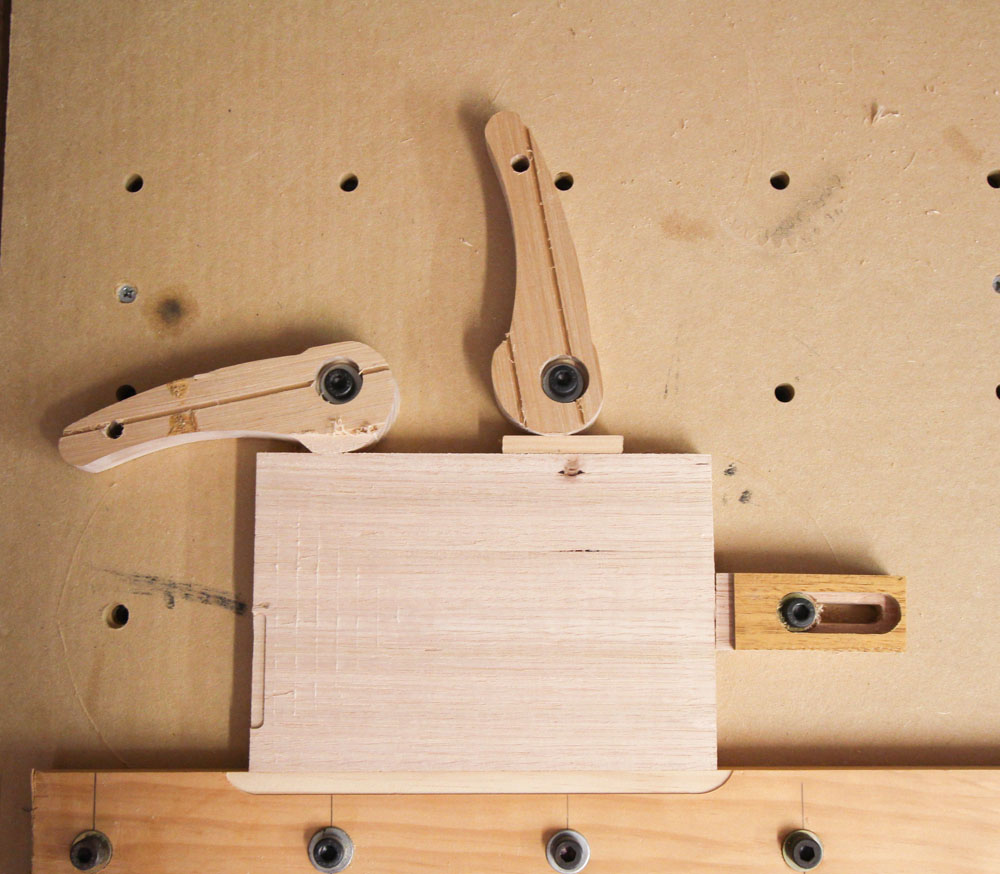

Slightly off from what you need, but I made these cam clamps on Sunday just to try out the idea. They are based on a design from Marius Hornberger on YouTube but I'll design my own if I decide to mass-produce them. To make sure they dont slip I fix them to the base with an M8 bolt, just loose enough to turn then lock them down once in place. Worked OK holding the test piece for surface skimming with a 22mm tool and being quick and easy to make from scraps of wood they can be treated as sacrificial.
