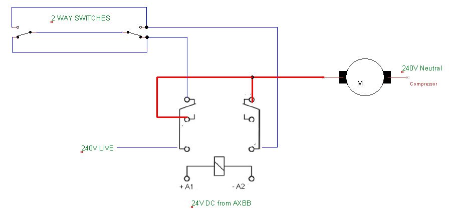

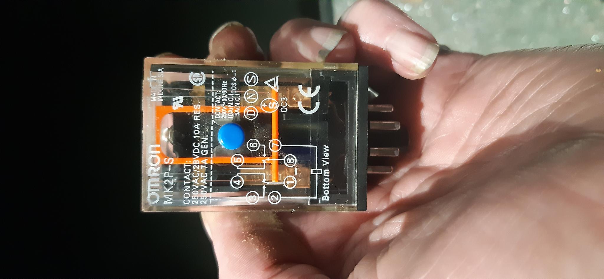

EDIT: I have found this OMRON MK2P-S relay left over after my retro-fit. With my limited electrical knowledge I think it fits the bill? Attachment 28887
Re: Unusual use of M8/M9 to control a compressor
Something like
Attachment 28888
All depends on your use-case. In this example UCCNC simply bypasses the manual switches to force the compressor on. Set the M8 command pin/port on setup/spindle page.
You would still be able to turn on the compressor with the existing switches, but not turn off the compressor with the switches if enabled by the AXBB.
That relay?, if it's the right coil voltage and current to suit the AXBB?
EDIT: You could glam up the circuit but there's a certain KISS approach to the above.

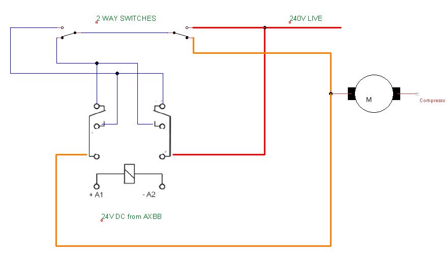

I had a play and came up with this Attachment 28889
It does what your diagram does but also isolates the live from the 2 way switches when UCCNC has control.

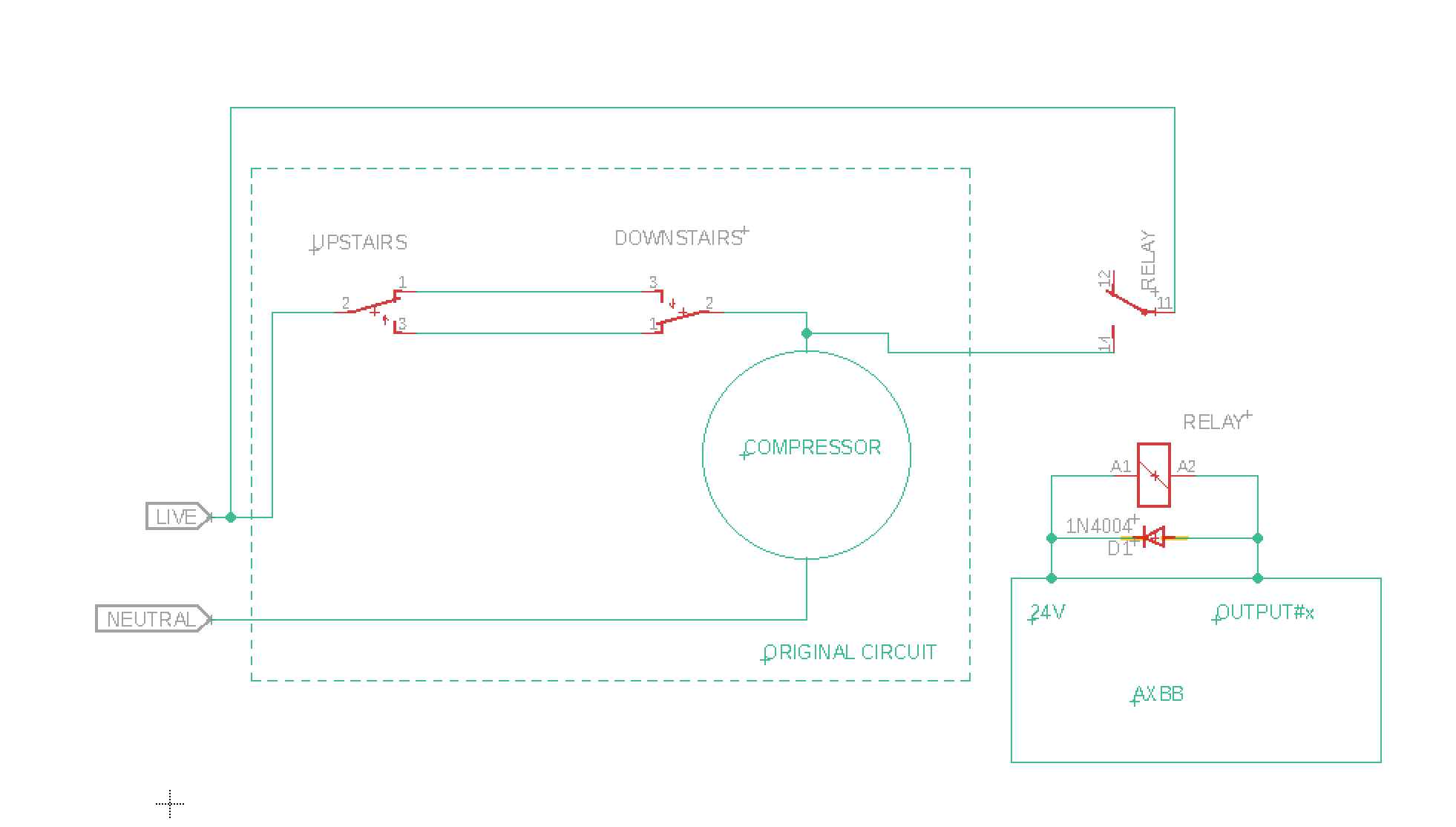

Doddy - is my circuit in post #5 feasible? If so UCCNC has control so the manual switches have no effect.
Regarding the compressor being left on I already have a signal lamp which comes on when the compressor is powered - this was put in before the 2 way switches as the compressor was often left running! The lamp is visible from our in workshop CCTV camera and we have a networked smart switch so the compressor can be turned off remotely
Perfectly viable.

Cautionary note - I can't recall previous conversations and the details of the relay and whether it has an integral diode - just remember to add a diode if not part of the relay to protect the AXBB against back-emf - pretty sure it's covered in the AXBB documentation.
Doddy
I did mean to ask why you had a diode on, thanks. The manual doesn't mention anything about back-emf or diode when connecting a mechanical relay to the isolated outputs.
ngwagwa
Hmmm, you're right - it instead refers to a relay coil with a +/- nomenclature on the coil - okay if the relay integrates a back-emf diode - I've seen relays with these - but never experienced them myself. Worth being vigilant on that topic - otherwise you can risk damage to the AXBB. Or drive the relay through a transistor amplifier (I'd always belt-and-brace that solution - but that's just me) - either way the solution requires a back-emf diode to protect the switching device.
The MK2P-S does not integrate a diode - you need to add one. Psst, if you don't have one PM me your address and I'll pop a couple in the post - I'm heading to the PO this afternoon anyway.
Doddy
Thanks, you have PM
Thanks for all the help folks - M8 now turns my compressor on and off - next step find a cheap solenoid valve to allow air to the cutter.

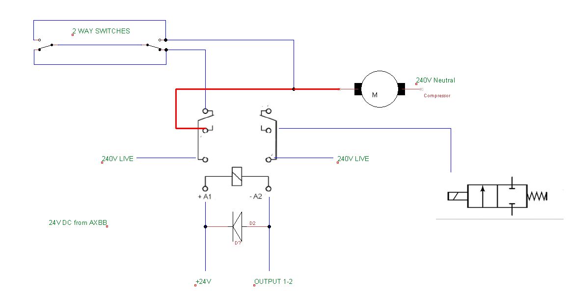

It was actually an after thought to make it 100% automatic, if you have a 24V Normally Closed valve knocking around would you swap it for a Normally Open one? No problem if not as I will just wire it up so the NO valve closes when the compressor is powered on with the manual switches.
Ah!, 240VAC coil N/C (powered to open) - from memory.
Doddy
I will have to look at my wiring - Attachment 28914
