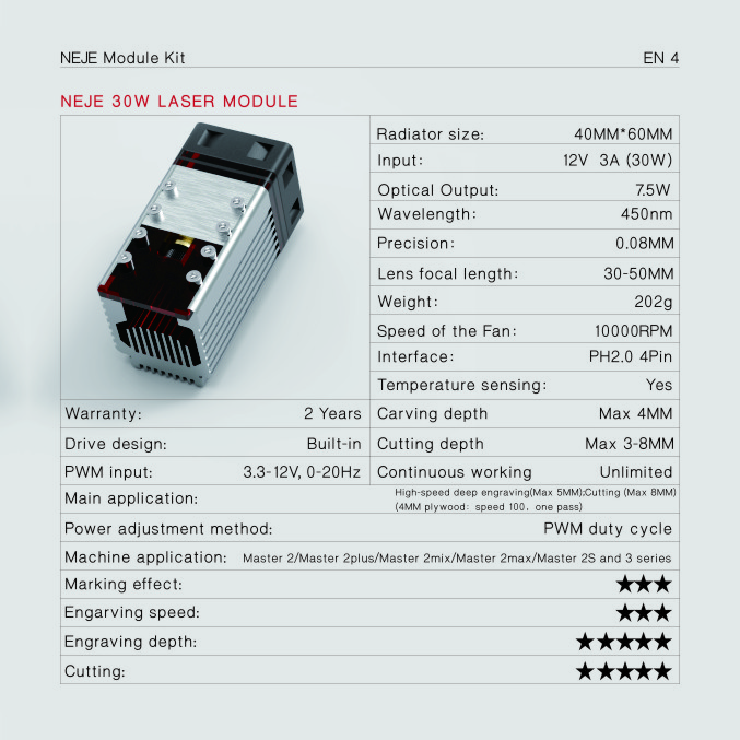

So I'm looking at hooking one of these lasers onto my 1040 cnc.
Says it can cut ply single pass 8mm was skeptical but then saw someone demo it on YT
I think at that price I will take a punt , really mostly doing some etching for my daughters Etsy wooden stuff. And a few ply coasters for a friend. Anyway I'll let you know how it goes.
Attachment 29339
Specs
30W General Specification:
Model:NEJE Module 30W
Heatsink Material:Aircraft Aluminum + Brass Shell
Luminous Color:Blue
Section Size:40mm x 40mm
Cooling Mode:Temperature sensor intelligent control + 10000 rpm 40mm cooling fan
Dimension:60 * 40 * 40mm
Adapter Plug:5.5 2.1 port
Can Engrave:MDF/Balsa/Paper/Wood/Fabric/Plastic/Leather/Plywood/Foam Paper/Anodized Aluminum
Can Not Engrave:Metal/Glass/Stone/Ceramics/PCB/Stainless Steel/Reflective Material/ Transparent Material
Technical Parameters:
Module Input:20-30W
Optical power output:7.5W (7500mW)
Wavelength:445-450nm
Beam Shape:Dot (Focusable)
Working Voltage:DC 12V
TTL&PWM Modulation:YES, Compatible with Both TTL & PWM Modulation
Input Voltage:DC12V 3A
PWM/TTL Input:DC3.3V-12V
Input Interface:PH2.0-4Pin (+,-, PWM/TTL, Temperature), 3Pin (+,-, PWM/TTL) , 2Pin+2Pin (+,-) + (PWM/TTL,-)
NOTE:Temperature interface can be disconnected,NEJE provides text instructions for temperature acquisition on wiki.
Drive Mode:External ACC
Safe temperature range:<60 ℃
Module weight:202g ( The lighter the weight, the smaller the move inertia, the better the performance )
Life Time:10000-20,000 hours
