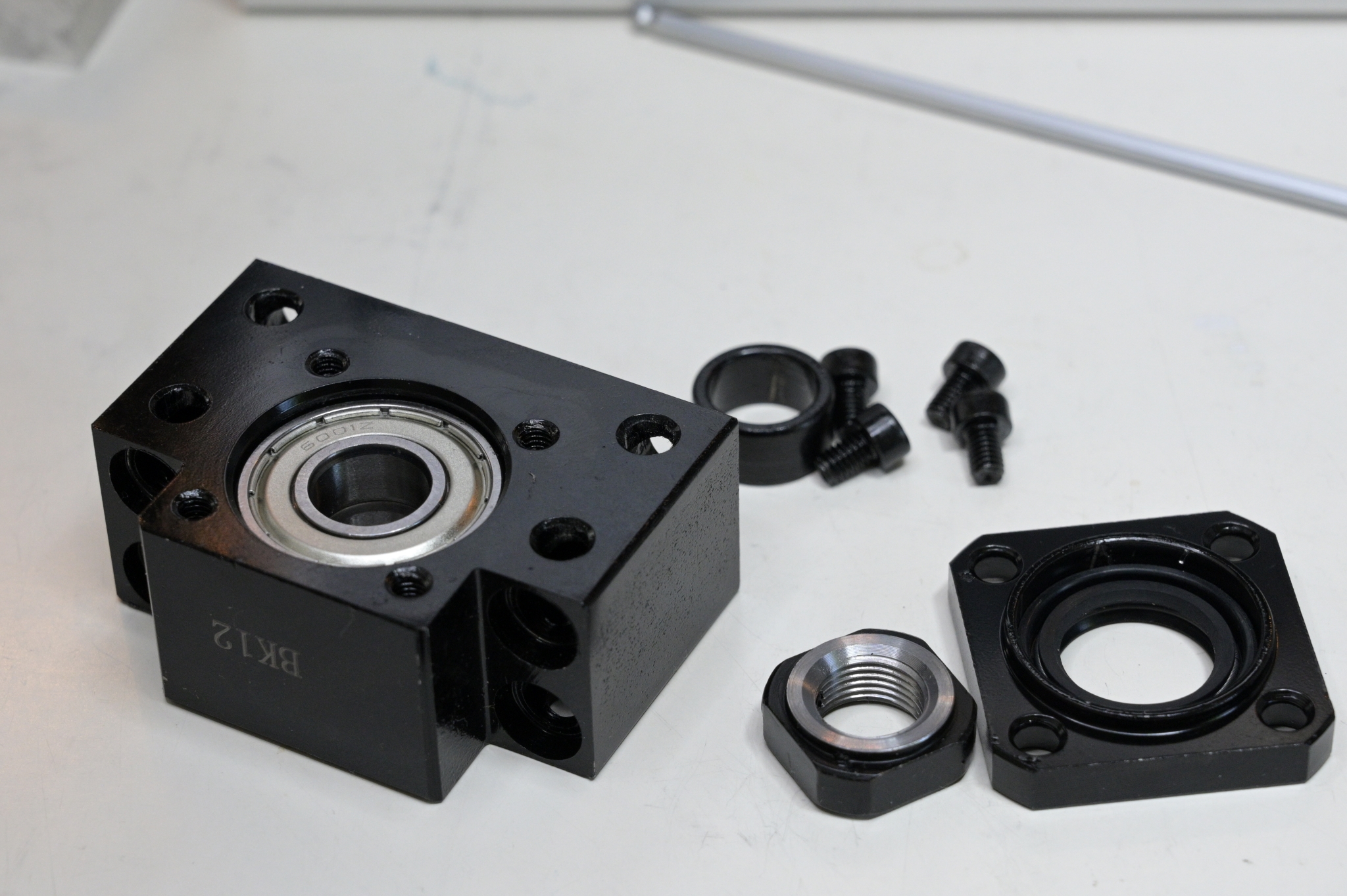

They always come with bearings, one double bearing in the BK and one single in the BF part.
Once you remove the four screws holding the dust cover of the BK12 you will see two bearings. I think the BF12 has a similar (but only one) bearing, but that is the floating end, so it isn't really critical. They are simple 6001Z 28x12x8 bearings.
Attachment 30081
Attachment 30082
These are cheap, but never the less can be very good. 6001Z is one of the most common type, so they are cheap, even if you'd replace them with an SKF or similar. https://www.skf.com/sg/products/roll...oductid-6001-Z
Of course, if you replace them, you might as well replace them with the best ...or not. Replacing 8 BK bearings if you have four screws can cost between 250 - 400 USD (maybe even more), so you must take it as a fairly large cost for an improvement of a hobby machine. There is no need for rushing, it's easy to do even later on, once you have everything up and running.
Never the less, I would not recommend you to start with replacing them, since there is really no reason, unless you really feel some serious issue, or play. I know I can't feel any, so even if some people laugh at them, let them laugh. Replacing is easy, but you need a proper tool, because these are really tight sitting in their seats. Don't use a hammer to get them out because that might damage the seating. There are tools to remove bearings, get one if you not already have one. Anyway, I don't think you will need to replace them unless you really feel there is something wrong with them. When it comes to wear and tear, I don't think you'll ever wear out these cheap bearings. It's a difference if you'd build a professional placing machine with high speed servos running H24/7, but as a hobby machine with slow rotating ball screws you will never come near the performance limit. In fact, inlines and roller skate bearings get a lot more beating than these, after all, these always rotate on smooth surface and at comparably very low speed.
But they should be AC bearings back to back to get the preload. This is why I asked him to check !Quote:

Those bearings in the BK mount are completely wrong for the application as they are not designed for lateral loads, they should have Angular contact bearings, not deep groove bearings like 6001ZZ.
They will wear excessively and they will introduce backlash, even if fit with SKF bearings because they are not designed to operate with lateral loads. Also, to get preload on the bearings and reduce backlash puts extra load on the bearings causing friction which robs power from the motors, again causing extra unnecessary stress on other components like drives, PSU, and lowering performance.

That's the point they were not specified that's why I asked him to check. They are being sold in a kit with rails so should be AC type.Quote:
Yes, they do use these simple bearings, but unless it is specified otherwise, there is nothing wrong with that, they didn't fool you. It's not for industrial use, if it was then I'd be more critical about them.

The BK bearing blocks should use two angular contact (AC) bearings, which get preloaded (aka you can tighten the nuts up so the bearings are loaded, unlike the before mentioned thrust bearings which would just collapse), and provide co-axial retainment of the screw.
Personally, I'd redesign the machines you're looking at, to make use of BK and BF support bearings (BF is just a basic deep groove bearing to support the screw).
The reason the mentioned machines don't use them, is they add cost. They cost more than a couple basic thrust bearings, and you need additional mounting plates for them.
The issue with cheap BK blocks, is it could be a gamble as to what bearings are fitted, the quality of the bearings, and if they're actually fitted correctly.
