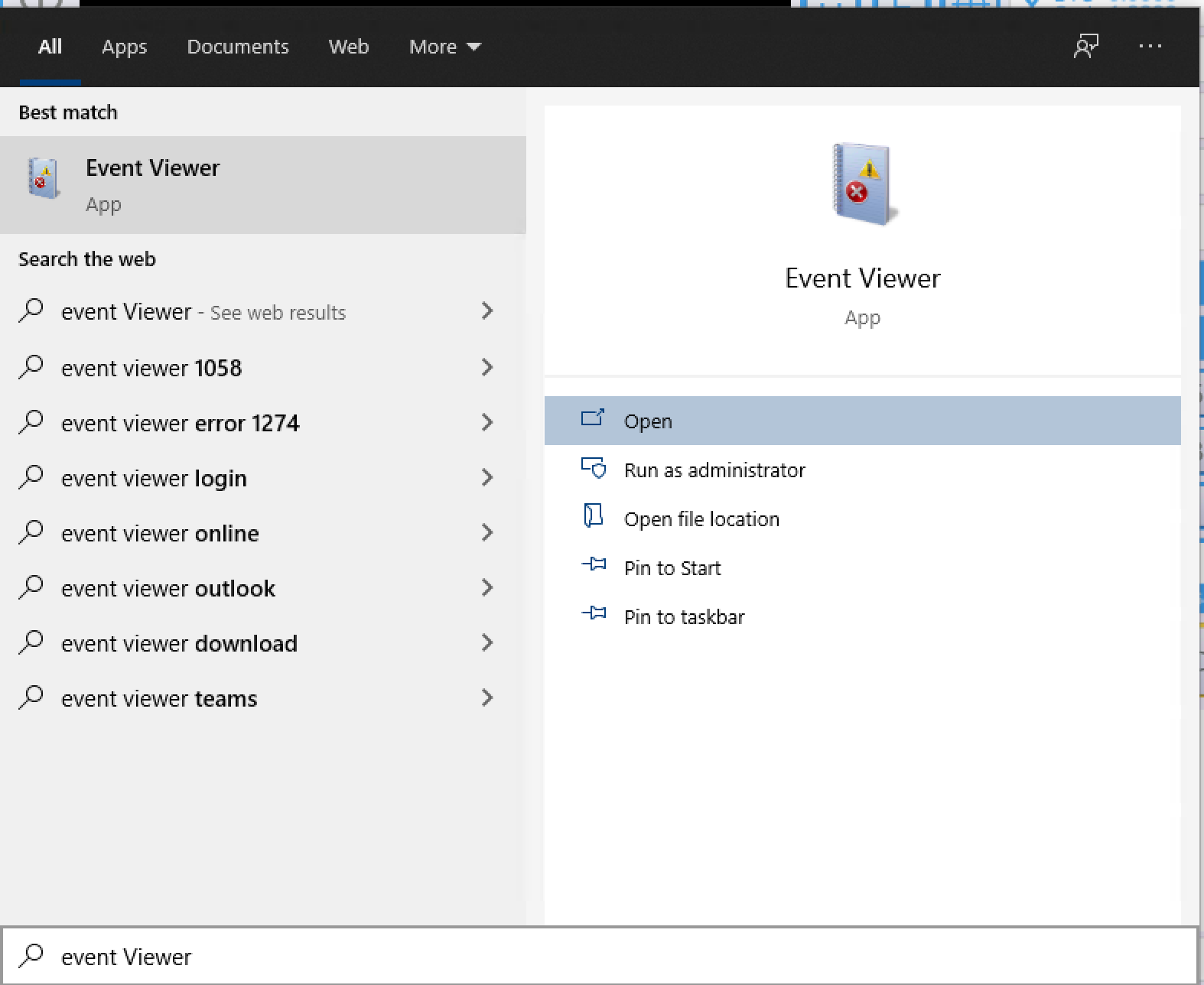

Hi Kit,
Looks like you've got two good responses to explore already; I'd add that you can find more information out using event viewer which may help figure out what has gone on. For the uninitiated, here are a couple of screenshots which should help show how to get there and what to look for. Gold dust would be finding an application error on UCCNC at the time of the crash, and you can use the other tabs to see if anything else on the system was happening simultaneously.

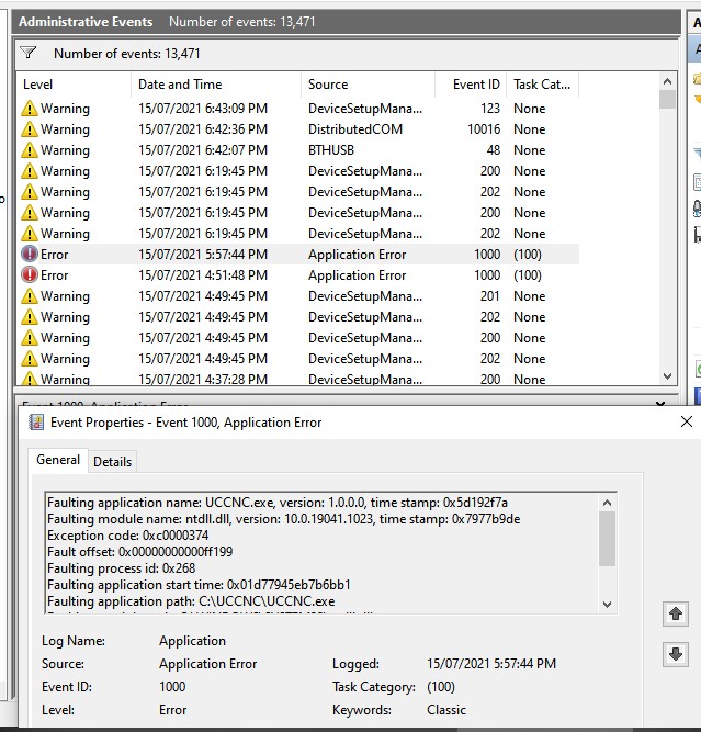

Looks like we have gold dust Andy! I wasn't aware of Event Viewer but the two errors in the picture below would be about the right times. I owe you many, many HobNobs!. All I have to do now is work out what on earth the explanations mean. At least I have something to work on.
The only plug-in I'm using is the X-Box pendant one. I'll have to try running without it and see if that makes a diference. It worked fine for quite a while before this problem reared it's ugly though.

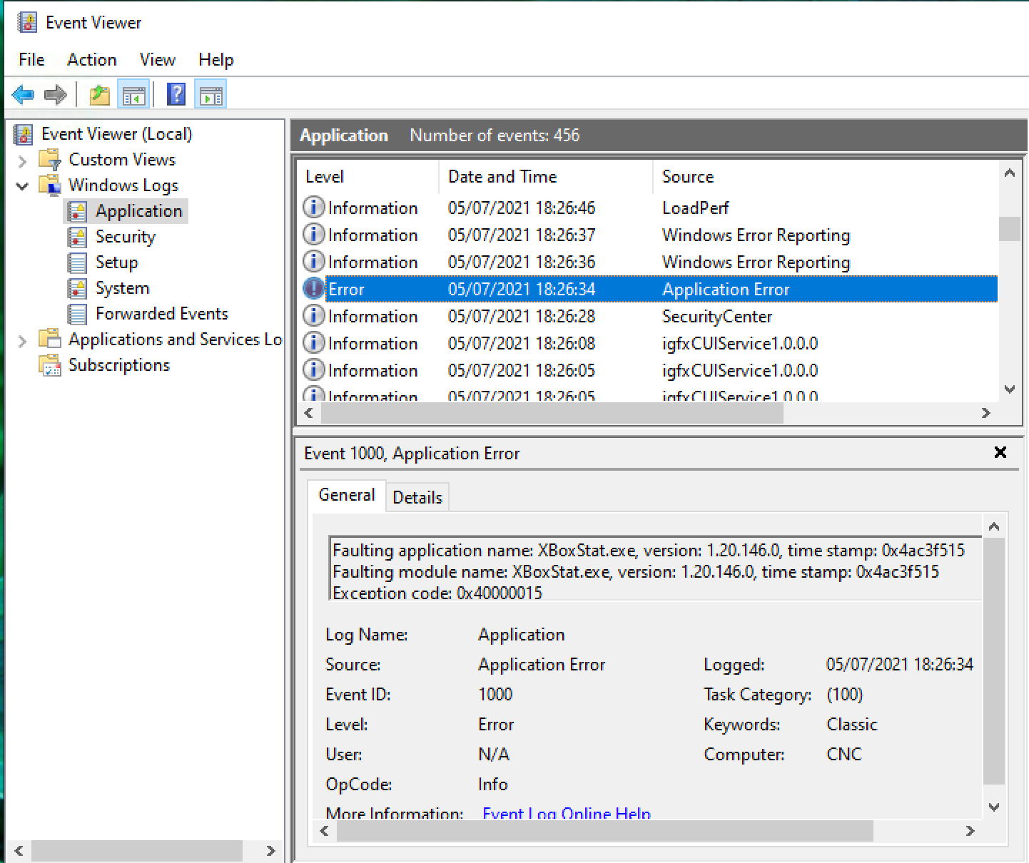

Attachment 30248

I am using V1.12111 but as you will have sen above, Andy's pointing me to Event Viewer in W10 has thrown up some evidence. As a simple first option I'm gong to try re-loading UCCNC itself (after ensuring the configuration is saved!) in case there's been a corruption of the .dll file mentioned in the error report. If the problem shows up again at least I know where to find the error log which I can send to Balazs if necessary.
EDIT:
Having done some research on the ntdll.dll file blamed for the problem, this turns out to be a Windows issue as suggested. This little file has been part of every version of Windows since NT (hence the name) and it's corruption is a know cause of crashes of all sorts.

Hi Kit,
Unfortunately the ntdll.dll error is quite a common one, but common because it can have a wide array of causes. It's basically the Windows kernel is freaking out and killing UCCNC. The status code it's given (0xc000374) is telling us that the reason is memory heap corruption - i.e. UCCNC is trying to use a bit of memory that it thinks should belong to it but Windows thinks otherwise. If you can copy paste / screenshot more of the details that screen shows it might be helpful, also slightly worryingly you have a lot of other warnings there which could give some clues.
This can be caused by a new update introducing a bug, a new bit of software that is being evil and corrupting the memory, a bad device driver (or a device misbehaving), or the PCs RAM is starting to fail.
I would try the following in this order:
Swap out the RAM for fresh / alternative sticks if you have them handy. If not, but slightly less conclusive, run a memory test tool like memtest86
See if disabling that plugin helps, could be the Xbox controller device / driver is faulting.
Swap to another ethernet card if possible to rule out the ethernet driver or NIC dying.
Try the windows SFC repair tool - long shot but if it works then easier than reinstalling everything.
Fresh reinstall of Windows, preferably on a new SSD (they're a lot cheaper than they were!)

A brief update for anyone who suffers similar symptoms.
As I've said before, I'm using a USB Nintendo style game controller as a pendant with the UCCNC built-in Xbox 360 plug-in. UCVCNC is running on a ten year old HP laptop with Windows 10.
Today the machine was sitting idle for several hours with no problems and then had a shutdown while idle again after an hour-long run of cutting. Interestingly I'd had a Notepad document open over the top of UCCNC for about 30 mins or more when it happened. Later, some while after restarting but not touching the machine, I found that whilst everything seemed normal the pendant would not work. Jogging direct from UCCNC was fine. Unlug/replug the pendant made no difference but closing and restarting UCCNC brought the pendant back to life.
I've since disabled "Allow Windows to stop this device to save power" on all the different USB controllers listed on Device manager and have disabled 'Auto suspend" when plugged in on the USB options in the 'Power' settings menu. I'm still thinking it's a USB problem related to this plug-in and controller and will be putting a real CNC Drive pendant on my Christmas list.
