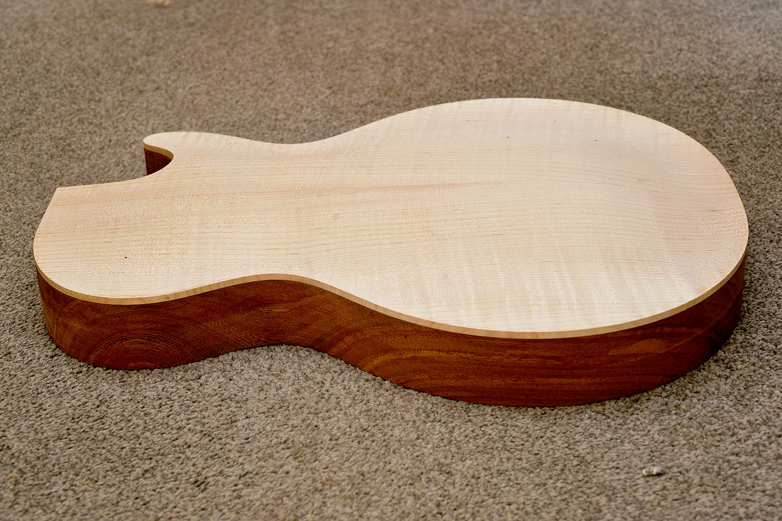

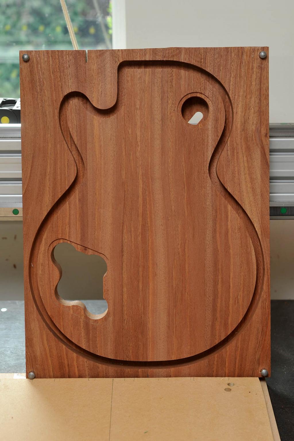

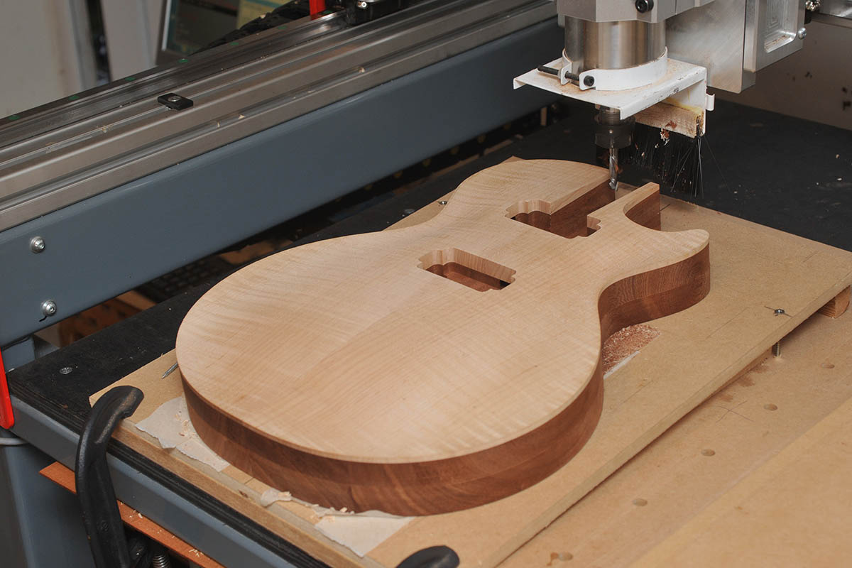

Ive recently been working on building a Les Paul style guitar using my machine and have successfully now got both a fingerboard and body made for my guitar. The fretboard for this guitar is ebony and uses celluloid for the inlays . I designed it in Fusion and successfully machined and then fretted and bound my fingerboard ...
Attachment 30264
Attachment 30265
Attachment 30266

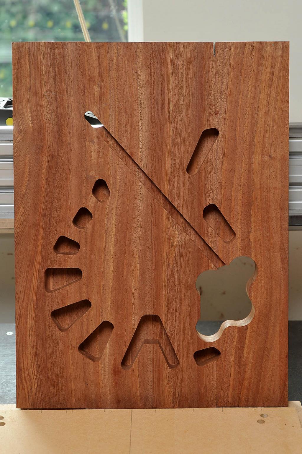

The body is made from African Mahogany, its actually a four piece body, primarily as I got the wood cheap and figured if I end up mucking it up, then I wouldn't be as devastated as if I trashed a pricey Brazilian Mahogany body blank. The body requires machining on both sides so I had a bit of homework to do in regards to flipping the workpiece over and realigning with steel pins. The mahogany was routed and weight relieved in preparation to having a maple cap added ....
Attachment 30267
Attachment 30268

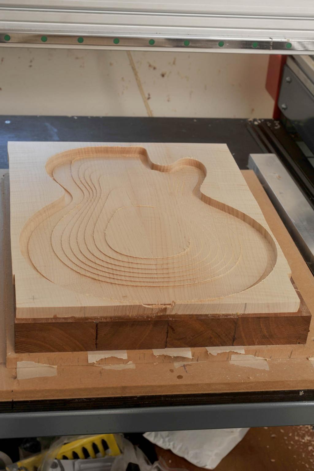

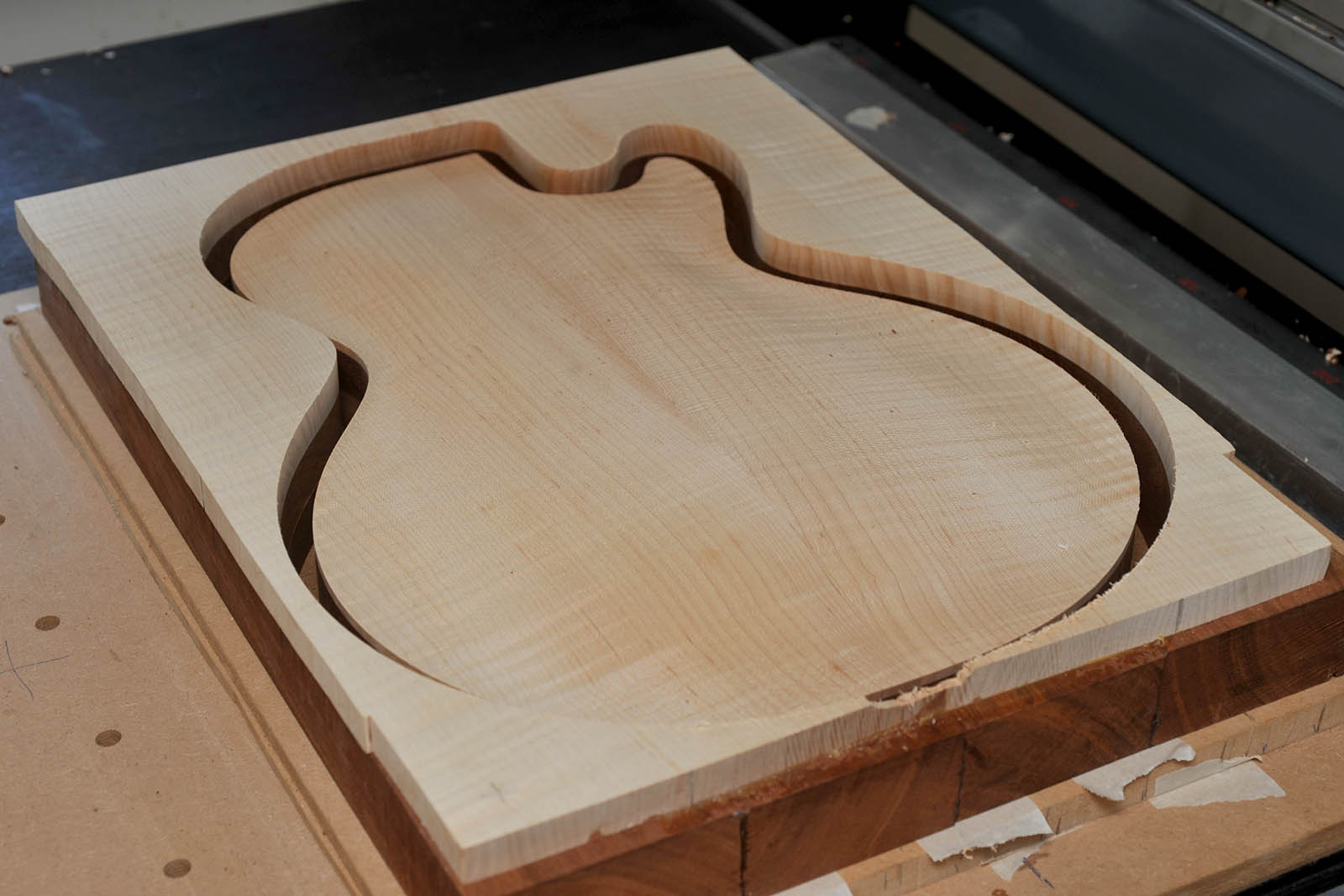

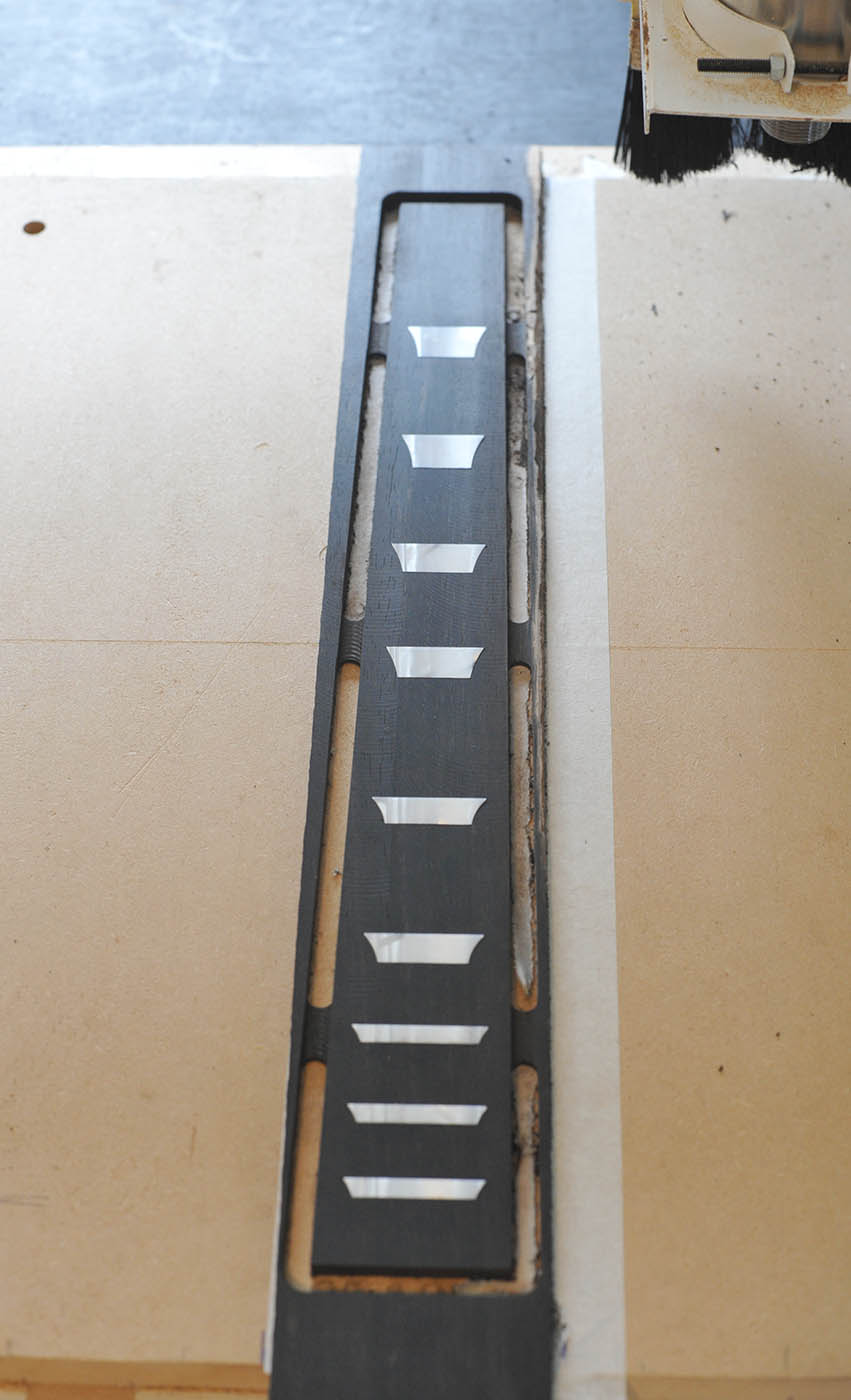

The maple for the top was prepared again using the CNC to flatten and thickness the two halves and also joint the edges of the boards, which it did brilliantly. I created my toolpaths in Fusion and ran them on the machine...
Attachment 30269
Attachment 30270
Attachment 30271
Attachment 30272
https://youtu.be/VIiyef8TqXc
https://www.youtube.com/watch?v=J04wwVrkMgw
Once again, it performed brilliantly, I cant say enough good things about Deans machines. Especially as a beginner in the world of CNC'ing , I think I would have thrown in the towel if I ended up with a machine that didn't really work as it should or just caused ongoing problems that as a beginner I wouldn't have a clue how to solve. The fact that it just works as it should is brilliant for a newbie such as myself as it allows me to just get on with making stuff and not having to faff around with the machine itself.
Next up is to design and make a jig to hold the body at an angle in the machine in order to route the neck and pickup cavities at the correct angle in relation to the body ( they aren't parallel to the back of the guitar) and then crack on and get the toolpaths sorted for the neck as well. Ill hopefully have some more to show in the near future !!

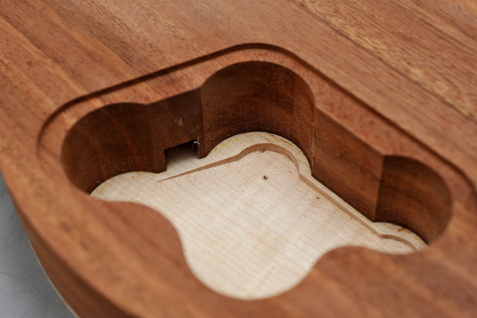

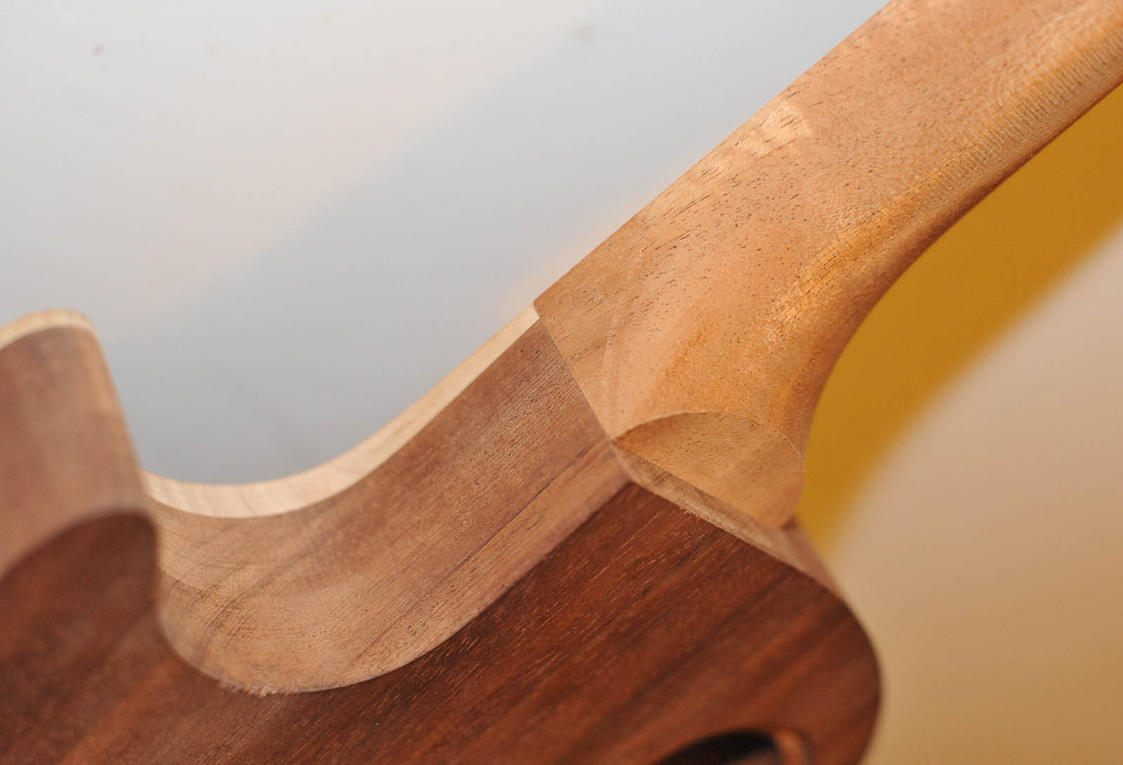

So since my last post, I have managed to cut the neck and pickup cavities for the guitar. These are perpendicular to the plane of the neck which is 4.2 degrees in relation to the back of the guitar. I built a simple jig which is angled at 4.2 degrees and fixed the guitar to it, this way, the machine is doing simple 2.5 cutting. If I were to cut it with the guiar flat to the CNC bed it would end up a mess as the cavities are essentially undercut.....
Attachment 30343

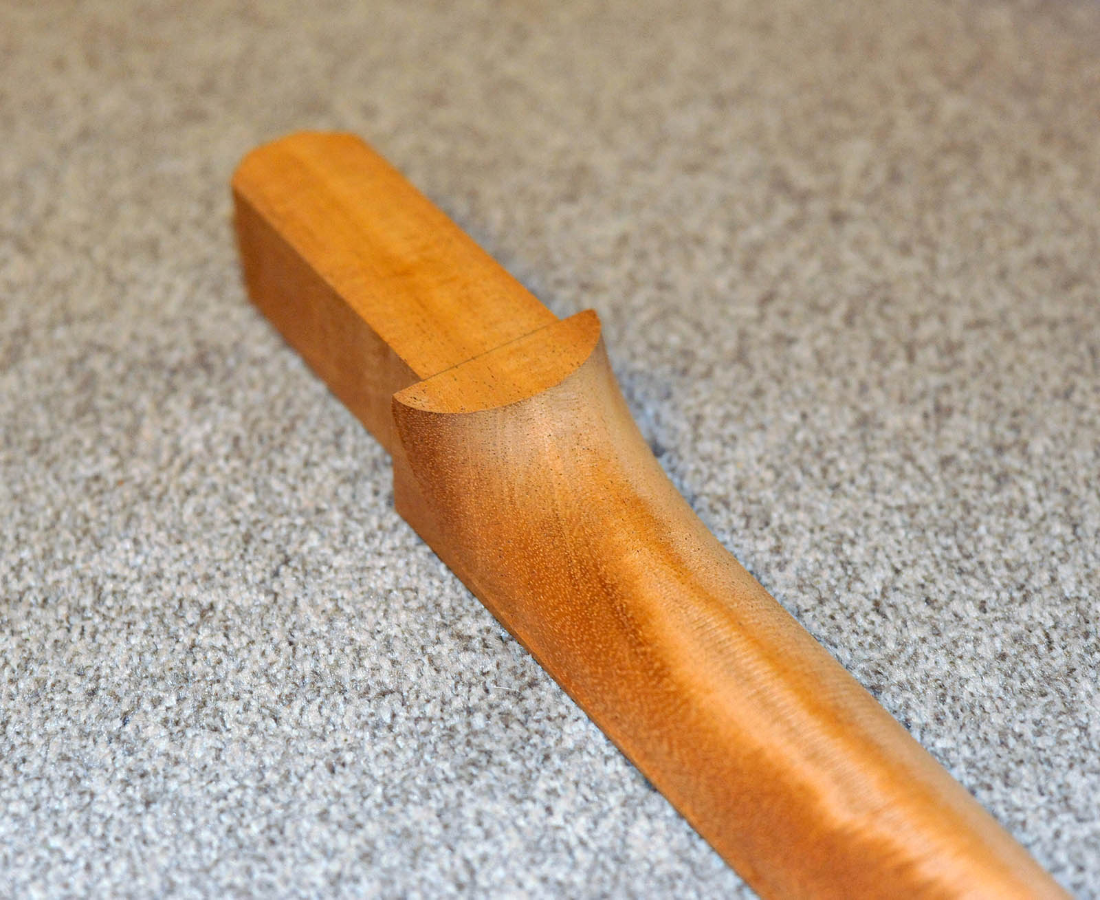

Next up to create a neck. I dont have a lot of photos of this, but essentially I cut the cheeks of the tenon joint which are again 4.2 degrees using the CNC and a 4.2 degree wedge that allowed me to simply cut a straight vertical line for the cheek of each side of the tenon and then just drove the CNC around and machined the waste wood away. I then created my G code for the neck and machined just the shaft of the neck and the transition into the headstock using a combination of adaptive, parallel and "steep and shallow" operations in Fusion....
https://www.youtube.com/watch?v=pldfTEF5RfA
Came out really really well , the more I use this machine the more I love it !!
Attachment 30344
Attachment 30345
Its really starting to look like a guitar now !!
Attachment 30346
I need to glue two "wings" onto the headstock to make up the full width and then cut the final headstock shape which I will do on a normal router table for speed and convenience. Once that is done I will glue the fretboard onto the neck, blend in the stock that I left proud on the edges of the neck and then we are onto the home stretch !!

Nice to see your work. I'm in talks with Dean at the moment regarding a CNC machine for me to make jazz guitars. A similar process in some ways to a Les Paul.
I noticed you have a lot of tooling marks left on the neck and further bits to sand, could I ask why that is?
I'm hoping that I can do necks with less work left after machining but I might be unrealistic about what I can achieve.
Issues for me would be that jazz guitars don't have have wings glued to the headstock and the heel is taller.
So without sounding like an arse, are the issues (you may not see it that way) you have purely down to lack of experience, or is it simply as you state, easier for you to do more post sanding. I'm hoping to do asa little sanding as possible as this adds in a margin of error and lack of repeatability.
Also how well did carving the top of the body go? Did you have to do a lot of post sanding to get rid of tooling marks or was it pretty much good to go?

Hi Archy,
That neck was finished with a 1mm steover parallel pass. I could have quite easily set it to something lower but it would increase machining time. Hell, I could have set it to 0.1mm stepover but personally I dont see the point. You are going to be sanding the neck anyways, It may appear to you like there are alot of machining marks, but 120 grit sandpaper will have that neck smooth in a matter of minutes. Plus, with something like a neck it is going to be refined further before completion, the shoulders of the neck will need blending with the fretboard as I have left the neck a little wide to give me a bit of wiggle room when glueing the fretboard on.
The top carve went really well. I believe on that I ran a "Morphed Spiral" operation from fusion 360 and in that instance set my stepover to 0.5mm as the top is maple so a bit more effort to sand. At 0.5mm stepover you would have needed a magnifying glass to see the scallops.

First, let me say this post isn't intended to sway your buying decision because by now after speaking with you at length I'd like to think you realise I that's not my style or way.!
The surface finish you can achieve is all down to the size and step over amount, mostly this is a trade-off between time and effort in sanding. With a small stepover, you will get a finish that is perfectly smooth. However, the cycle time could quite easily quadruple or more. But it's certainly possible to get a perfectly smooth finish.
This trade-off between step-over and sanding is why in my post congratulating Ben I said "you seem to be getting to grips with it quick enough, those feeds n speeds look nicely dialed in with a good balance between speed and sanding regards the step over(scallop)" The time saved in machine time compared to the small amount of extra sanding required is in my opinion worth it provided it's used in the right areas.
This is the beauty of CNC and having your own in-house machine, you can decide where the accuracy warrants a smaller step-over and where you can tolerate a little more sanding to lower overall build time. Plus you can tweak fit etc.
Like most things in manufacturing, Quality is a trade-off between time and effort. CNC just allows you to choose how much of each you save.

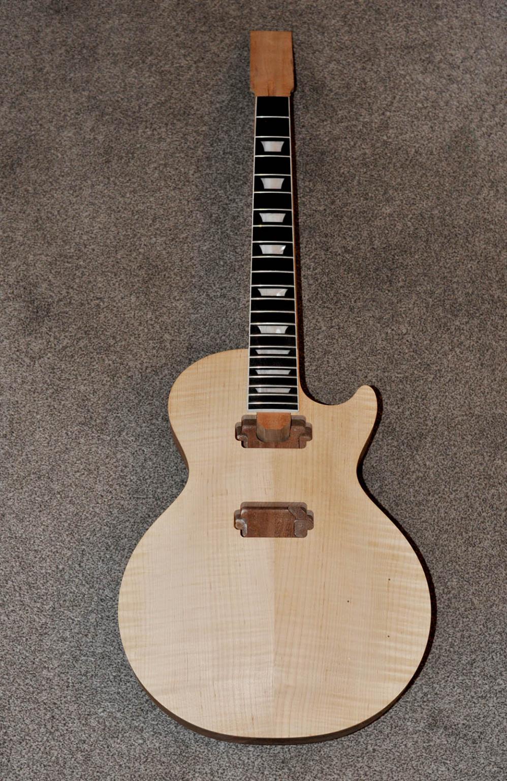

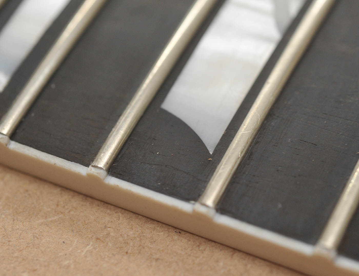

Well Ive been continuing to work on the guitar. Pretty much all the CNC side of things was completed at the last update and its on to more "traditional" methods of guitar construction . Hence the slowdown in productivity !! ;)
Ive bound the body and drilled all the holes on the guitar body as well as installing the bushings and ground wire and added a round over on the back.
Glued the "wings" to the headstock as well as a maple veneer. Shaped the headstock, drilled for tuners and added a logo inlay as well which was cut on the CNC out of the same cellulose nitrate material used for the fretboard inlays.

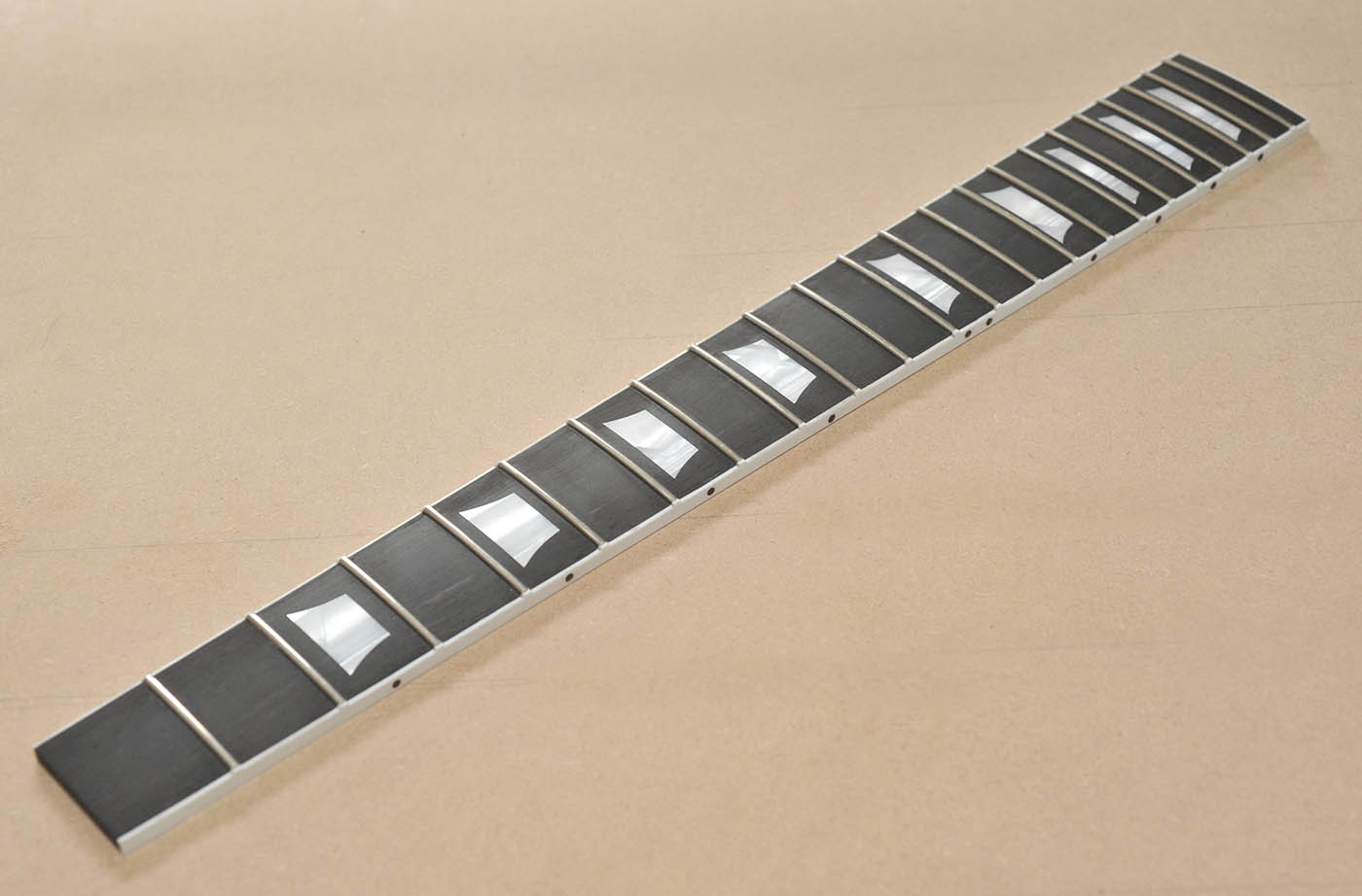

Fingerboard is now glued to the neck and its pretty much ready to glue the neck into the body, just keeping them apart for now as its easier to work on each piece individually.
Once glued itll be finish sanding and then onto finishing ( as long as the weather plays ball and I can find a window of opportunity with low humidity ) .
Hopefully will have something to update you all with in a couple of weeks when I start on the finishing as long as the weather and humidity play ball ) ....
