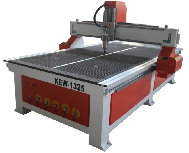

Q: Does anyone have any suggestions on how to best move a 1325 router table around the workshop?
I purchased a secondhand KEW 1325 router (8' x 4') back in July/Aug 2021 and it's been in storage at a friends farm since then, but I have to move it into my garage/workshop next week. My issue is, my concrete floor is quite a rough finish (Tamped down 25 years ago by hand) and I need to be able to move the CNC router out again in 6-8 weeks times, when I'm having 3" of flowscreed poured to give me a smooth floor throughout.
I have a gravel driveway right up to my garage door, which I know isn't ideal for moving a cnc machine around, but I'll lay some 8x4 boards down to assist movement in and out of the workshop.
If anyone has any suggestion/tips about moving their cnc machine around the workshop, I'd be very grateful, thank you.

If the frame rails are strong enough to lift the machine,it could be quite easy.A pallet truck and a couple of machinery moving skates would probably do it.You may be able to hire skates for the job.On the gravel drive it may pay to get hold of some scaffold boards and use them as tracks.I hope for your sake the drive is near to level as a steep slope would be a nightmare.Securing the gantry and the Z axis may be prudent.
If the lower frame sections are a bit flimsy you may have to use a crowbar and a pile of plywood packers to get the machine off the ground and you can -very slowly- roll the whole thing around on short lengths of metal pipe or scaffold pole.Don't rush and don't put any part of your anatomy in places where it might get crushed.

Thank you @routerdriver, I appreciate your response, very helpful. Some moving skates look like the perfect idea once inside the garage and I have a friend who has a pallet truck. Securing the gantry is a great tip and something I hadn't thought of, thanks. I've been shopping around for moving skates, either purchase or hire. I'll update here on my progress for future reference that might help others. Thanks again.

We deliver machines this size and larger using the pallet truck and skate method, in fact, delivered a 10 x 5 yesterday using this method across a rough Chicken shed floor.
one skate on each corner at one end and pallet truck at the other.
Just make sure that the skates don't sit metal to metal as the machine will slide off if they stick or jam, 2 ton doesn't exactly stop instantly when it's rolling and will try to slide off the skates in a blink of an eye. Put some wood or rubber between the frame and skate.
Also, it's a good idea if possible to connect the skates with a bar so they both travel in the same direction as they have a tendency to follow the floor and can easily go in opposite directions, or have one person on each skate making sure they steer them in the same direction, if not they will jam and potential for falling off skates.
A Trolley jack also works in place of a pallet truck.!

As a temporary measure just for moving you could always just bolt-on 6" or 8" castors like these on each corner. We use these on frames which we built for delivering machines where we have to move them down garden paths and thru narrow doorways with the machines on their sides and they easily handle rough terrain and roll nice.
Just for rolling out of a workshop, they will work a treat and not silly expensive. Also, they don't mark painted floors being rubber wheels.

Hi Phil,
I Might be a bit late to the party but I thought you might appreciate some advice - I do this sort of thing on a daily basis.
The ideal option is buy 2 x toe jacks and a set of skates. You jack the machine up from each side and do the 2 rear skates, connected with a rear bar, then lower the jack, then jack the front up and insert the steerer (if you have a pallet truck you could probably do one side at a time):
Something like this:
https://www.safetyliftingear.com/pro...0aAoReEALw_wcB
Once its on skates they're surprisingly easy to move. If the ground is very bad you would want some running plates (thin sheet metal that the skates can travel over) which can be moved to make a track. Once you've got it on these running plates you're away.
If you don't want to invest in jacks and skates I believe these are available for hire from HSS Hire.
Another option is 2 x pallet trucks, one on each side, jack them up evenly, and youll be able to move it reasonably easy.
To get it out the workshop build a platform with your 8x4 boards, and then lay a sheet of ply (or similar) over the top to give you a full and level platform. To bridge the gap between workshop and platform use your steel running plates. Taking your time to make this platform level and flush is well worth it as it makes relocation to the outside very easy. Get 2 friends over to do the actual shunt, each one watching a skate to ensure it doesnt slip over.

Hi Danny, thanks for your input, I did pretty much what you suggested. I purchased a couple of moving skates for the rear of the CNC and one with 3 wheels for the front, so it could pivot round and they worked great. I was able to move them around from the workshop to the office or studio, (adjoining rooms), whilst preparing the floors with tanking slurry, in readiness for flowscreed. Should have it out and then back in within the next few days, so all going well.
