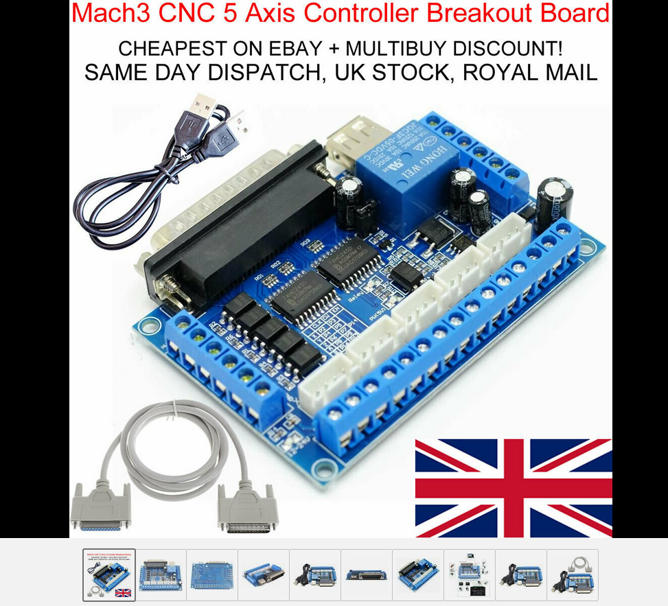

This is what I have, but the break out board has a parallel port connection.

Here is my breakout board
Attachment 30863

So. Are you saying you have that kit but don't have the STB5100 cotroller, just the stepper driver board and generic 5 axis parallel bob?.
One would assume that you could get a jst-xh cable and link the 2 boards that way.
Have to check the manuals to see if the wire order is correct but the little connectors inside the white plugs are easy to swap around.

PC+ (5V+) To ALL pul+, Dir+ (&En+ if you use it) on the drives.
Pul- (pins 2,4,6,8 on board) to Pul- on drivers.
Dir- (pins 3,5,7,9 on board) to Dir- on drivers.
For En- I used p14.
Or the little white plugs. Mine are marked +5v, CLK, CK, EN. (CLK is pul, CK is dir).
Then used p16 for coolant and p17 for a relay NC position (had grief with the onboard)
Is all here:
https://warp9td.com/images/BOB_Vendo...line/ST-V2.pdf
To be honest. ANY board that has pulse, direction, enable, 5v+, 5v-, can run a stepper driver.

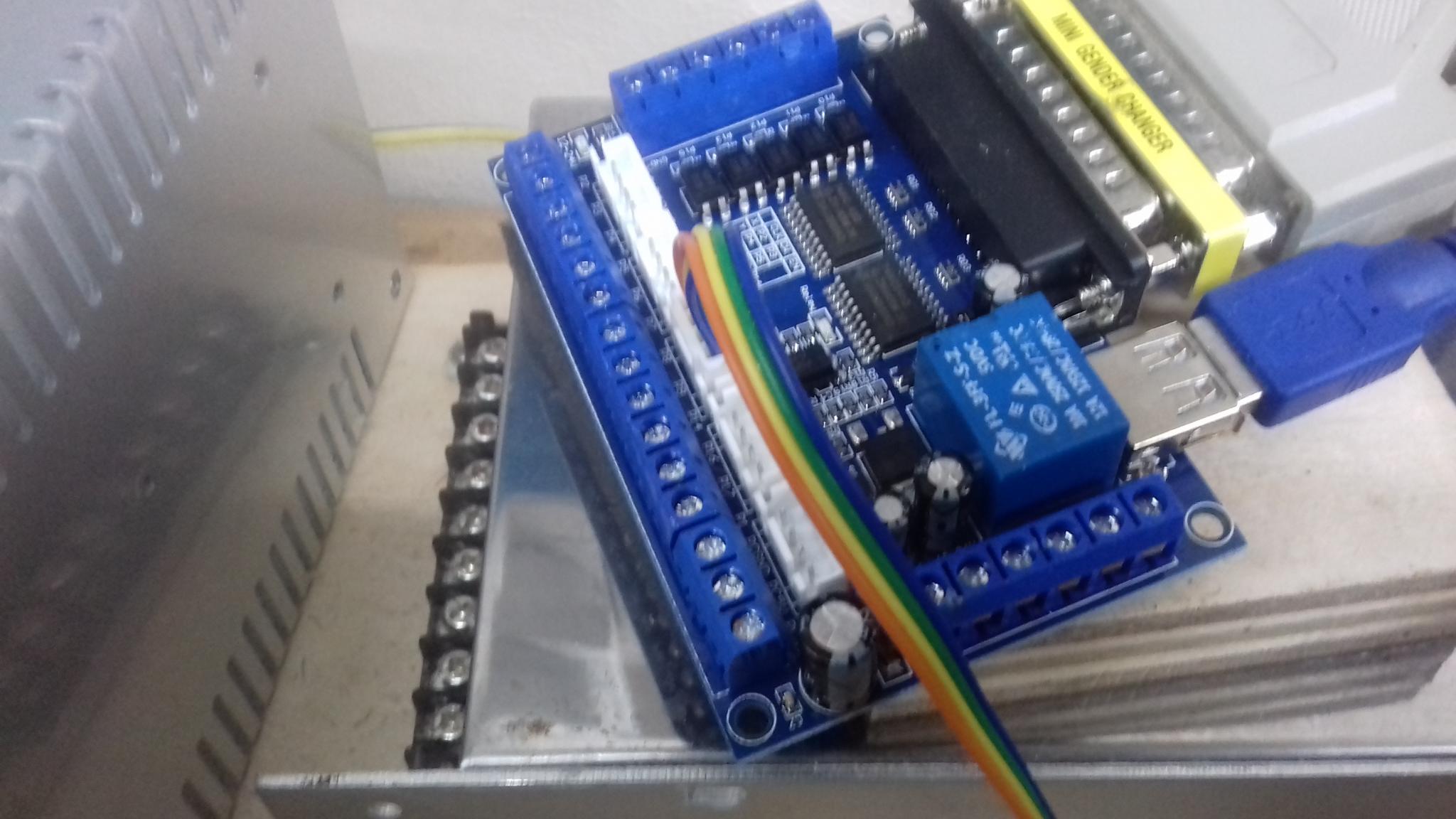

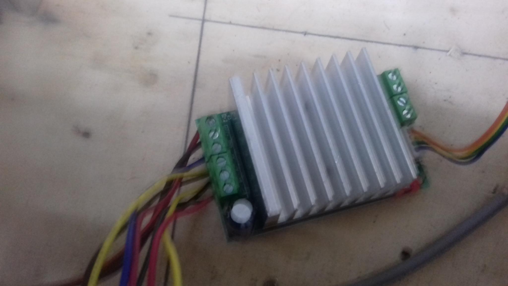

Attachment 30923Attachment 30922
Hi, I have attched two pics I have used a four lead from driver to breakout board is this OK
Mike
Not very informative. Do you have it wired as per post #12?.
These boards do require a 12-24v supply added on the right hand side to run the spindle control AND the inputs. The 5v usb supplies the outputs only.
I see you don't have the larger supply yet so....
Is E-stop turned off in Mach3?.
Do you have power to the driver?.
Some drivers require the enable signal to be used.
Are the wires actually the same config on both board and driver?. Or did you not look and just plug it in?.
I need a close up of the driver connectionns showing the symbols/names, or written down. Pul+/- dir+/- en+/- etc.
Blurry pictures are as good as useless, and you need to give more specific info. If you can't take a good picture then at least draw a little diagram showing where each wire connects. Also, show the settings you have in Mach3, screenshots work best.

Hi Thanks again for your help. I now have power to stepper motors but they will not run, they sound stalled or trying to run to fast so do not rotate
Do you have any idea ??
Mike
Hi Thanks for that, My steppers are 60BYG301B
Mike
This may help-
https://cnc4you.co.uk/resources/Step...1B%203.1Nm.pdf
Ah!!!!.
I see 8 wires.
Best balance for both speed/torque is parallel. Also lowers your inductance. Twist pairs together and connect as folliws:
A+ RED & BLU
A- YEL & BLK
B+. WHT & BRN
B- ORG & GRN
Then 10-45v power supply in the other 2 terminals (marked 32v & GND I think).
Try that.
I see your motors are 3.2mh inductance in parallel (it's lowest level avail). Not great for trying to get fast rapids on only 36v or less. Fine for general cutting speeds.
Most likely happening because your motor tuning in mach3 is set for the Gecko drives and these cheaper TB-based drives cannot handle the same tuning setup. Try backing off the velocity and Acceleration by 50% and try again. When you have it working stable then slowly increase them one at a time until they start to stall again then back off again by 10%.
