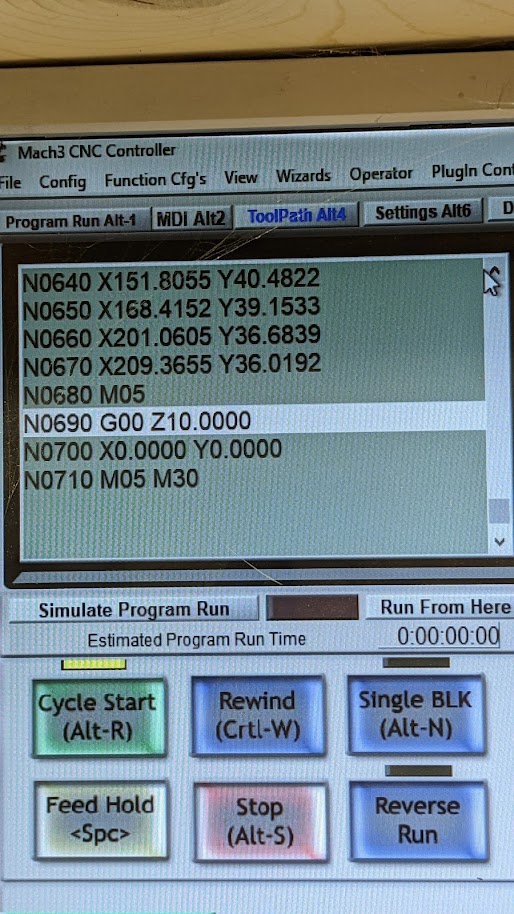

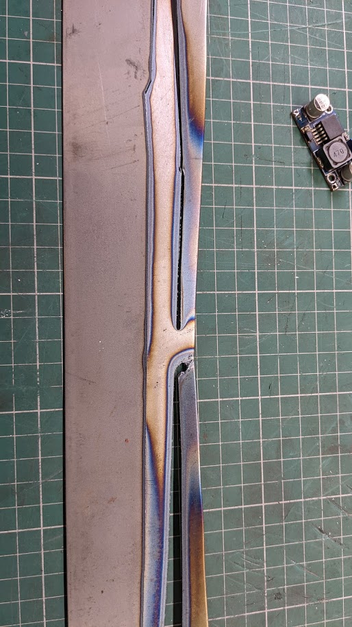

Help Finally got plasma running working great apart from the last 20mm where the cutter turns off, I have tried on 5 or 6 different bits any ideas why please

		No no matter how big the piece i cut, cut always ends up 16mm short of start
		Re: Please Help me before I find Hammer
		What M-codes are you using to activate/deactivate the plasma? M3/M5?
Also, what happens if you change the feedrate?
m_c
tail end of code in picture
will try today to increase feed rate, strange when watching machine speed seems fine but when watching video its so slow to other videos ive wached

 Tried at 2000mm min double speed and cut ended at 38mm before start

		N0010 (Filename: SATTOP.tap)

N0680 M05
N0690 G00 Z10.0000
N0700 X0.0000 Y0.0000
N0710 M05 M30

		here is a video of running at 2000mm min cut ends 36mm short of start

		I know nothing. Less about CNC. Less still about plasma. But I'd slave an LED on the NVUM output to trigger the torch and re-run, re-video a cut with the LED and torch in shot when it completes. If the LED on the NVUM extinguishes at the same time as the torch extinguishes, then the problem is likely one of the NVUM motion controller. The G-Code that you posted indicates no problems - once you get over the lead-in that it adds presumably to generate a clean cut from firing the torch. That the distance uncut lengthens when the feed rate is doubled suggests to my poor addled brain that the motion controller is running ahead of the pulse generation and shutting the tool (torch) off early.
Might be worth experimenting with a G04 instruction before the M05.
e.g. was:
			N0680 M05
N0690 G00 Z10.0000
N0710 M05 M30
 becomes:
			N0679 G04 500
N0680 M05
N0690 G00 Z10.0000
N0710 M05 M30

		That linked thread partially explains why I was asking what happens if you change the cutting speed.
It's all to do with how the trajectory (motion) planner calculates movement, and combines that with other non-movement commands.
Trying exact stop mode (not always ideal for plasma cutting, where you really want speed to maintained as much as possible), or a basic G04 pause might be enough to alter exactly where the M5 command actually gets executed.

 Thanks I changes speed from 1000mm / min to 2000mm / min and "undercut" more  than doubled to about 36mm  may look into changing NVUM to maybe a KK01 I have and a UC100,  seems nvum has issues
