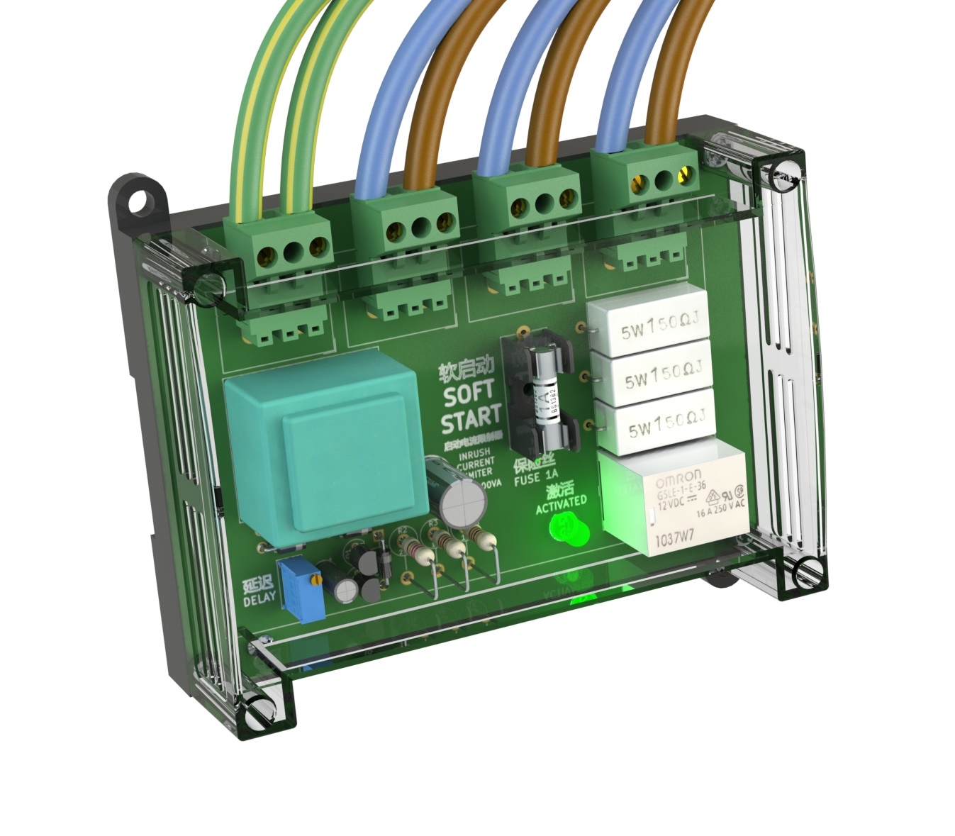

Hi folks,
I hope you will be interested to take a look at my latest shared project at PCBWay. It's a Soft Start Inrush Current Limiter designed to be used with a toroidal power transformer up to 500VA or 12A. This should be sufficient to supply 3-4 NEMA 34 stepper motors.
https://www.pcbway.com/project/share..._026d2a0e.html
The original circuit design by Rod Elliot can be found here:
https://sound-au.com/project39.htm
Any feedback on the design and layout would be much appreciated
Attachment 31965
Thanks for looking!

Wow that is a massive overkill. You can simply get a timer relay and a metal clad resistor from CPC or Farnell to do the job. I used a Finder timer relay - I think it was this one last time https://cpc.farnell.com/finder/80-21...0timer%20relay
Worst thing is, Rod Elliott doesn't seem to understand what causes the periodic / random current surge when the transformer is connected. The effect is called "remanence". During normal operation, there is a fairly large AC magnetising current flowing in the primary due to the primary inductance, resulting in an alternating magnetising flux in the core. This is independent of the load on the output. At the instant when you disconnect the mains voltage, much of the magnetising flux at that instant remains (hence "remanence"). If you tried to dismantle the transformer at this point, you'd find the cores were magnetised and wanting to stay together. The magnitude and polarity of the remanence is random, as the interruption is not synchronised to the voltage waveform. When you now come along and reconnect the mains voltage to the primary, you superimpose a magnetising current / flux on top of the remanent flux. Depending on the instant at which that reconnection happens, you can now end up with a higher flux than you would ever see in normal operation.
The steady state magnetising flux of most transformers is actually very close to the saturation flux of the core, so it doesn't take much additional flux to saturate them, which is what causes the random massive inrush currents. The current during saturation is only limited by the voltage, winding resistance and the impedance of the mains network. And these large surges are a random function of the instantaneous voltages at connection and disconnection of the mains, which is why you only seem them from time to time rather than at every power on. You may have wondered why they only happen every so often.
To implement a resistive soft start on the transformer primary, you need to use a resistor that is small enough in value to drive the magnetising current close to its equilibrium value but high enough to limit the current if there is saturation during the first few cycles. This is why the soft start resistor value needs to be selected according to the specific transformer. For the range 1kW - 3kW, I have found values in the range 3 to 22 Ohms work well and the delay timer only needs to be set to a second or so.

Thanks for the feedback, Rod's design produces a much shorter delay, he says the optimum is around 100ms, just 5 cycles. With the 100K variable resistor my version should produce a range of 0-500ms. The combined resistance of the parallel resistor bank is 50 Ohms. This should only protect against initial inrush, and hopefully won't cause much heating of the resistors. It won't do anything about the problem of remanance though. I guess a solution to that might be a switching circuit which is synchronized to the AC? This would involve zero cross detection. I know there are relays out there which have built-in zero cross detection. It still wouldn't solve the polarity though, it could start half a wave out of sync.

SSRs typically switch at the zero crossing point, however that is the worst point to switch as it'll cause the biggest inrush, which is why they're a poor choice for switching transformers (plus the fact they generally fail short circuit isn't good from a safety perspective)
It only takes a couple cycles for the transformer to fully magnetise provided it receives enough power, but it usually takes longer than a few cycles for the power supply voltage to recover, which is why you want a slight delay.
Personally, provided the transformer isn't going to be switched off and on regularly, I just use a thermistor. Not technically perfect, but adequate and far less likely to go wrong if sized correctly.

The issue is actually about the transformer cores periodically saturating when connected to the mains, something that happens on a fairly random basis as I explained. The tendency for them to saturate depends on how much magnetising flux has been designed in and how close that is to the saturation flux limit.
Some transformers run very close to saturation and are more prone to the effect than others. To increase the margin requires higher inductance which in turn requires more steel and copper and higher material cost. There's a commercial decision involved, which is one reason we see variation between different examples.
You may notice that apparently similar transformers from different suppliers behave differently - this may be seen as different steady state (unloaded) temperatures, for instance. I'm guessing your toroidal audio transformer doesn't run a high magnetising current / flux, which is why you don't see tripping breakers. I have 2 yellow site transformers that are both rated at 3000VA and are of similar dimensions, yet one sits at around 50C and the other barely warms up (perhaps 30C) when left powered but unloaded.
