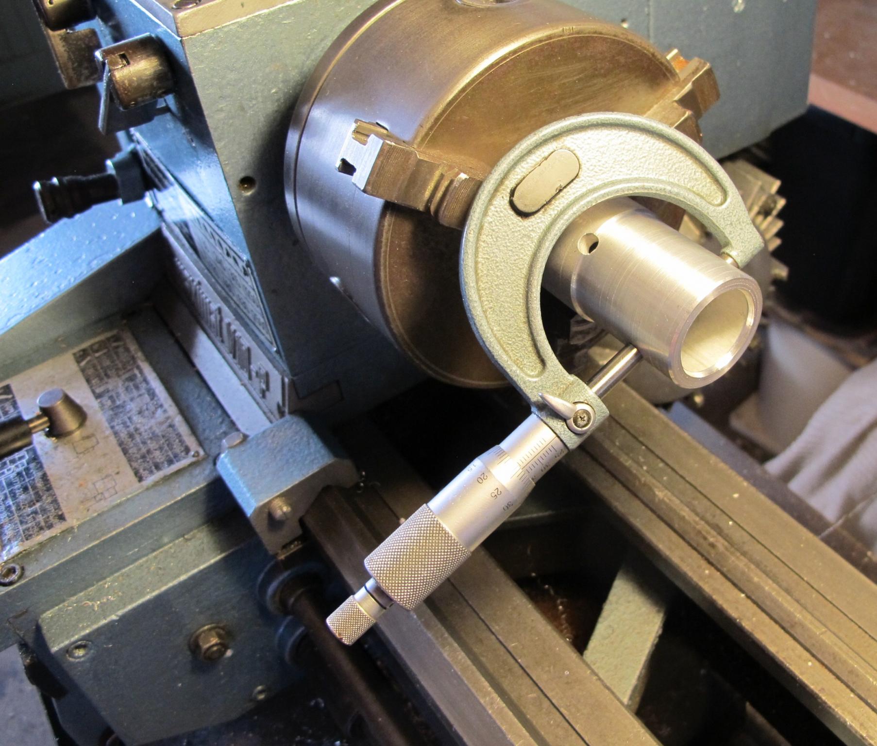

As I have had it some time now I have sorted out certain issues and serviced and cleaned it, it has the one issue though, if I have a shaft in the chuck and run a machine tool along it towards the chuck the run out is 0.003" in only 1 9/16" which is way too much.
I have tested the run out from both sides of the shaft being cleaned up, cutting from the front it will cut deeper towards the chuck, if I then machine from the other side of the shaft it will undercut and by the same 0.003".
I see no way to adjust the gear head shaft, or the entire gear head box either, is there a fix for this problem?

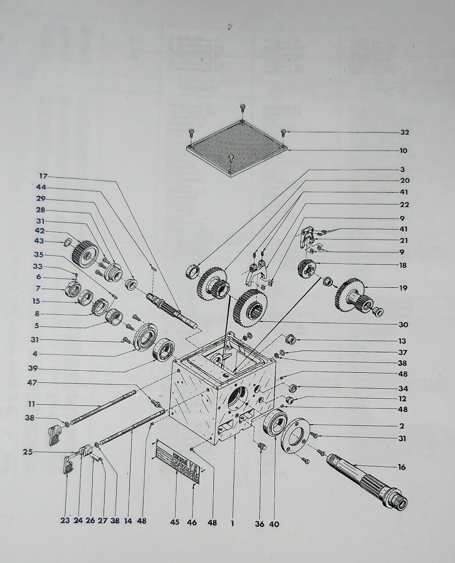

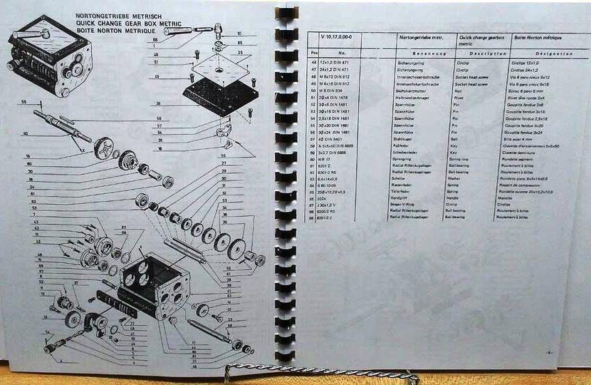

Thanks, I do have the exploded parts page, it shows that shaft and with a bearing each end, no shims, I did read about paper shims, which makes little sense?
My steel square on the beds shows the traveling bed to be spot on, so it is the head stock shaft.
I have tried to up load the drawing of the parts but it does not work.
Re: Maximat V10P runs out
I have managed to up load the drawing of parts in my opening page, the main shaft has a bearing on either end, I see no sign of a shim or adjustment.

The spindle itself won't adjust.
The entire headstock assembly will need to be adjusted.
It's possibly done by the grubscrews (No. 48), but there will likely be some correct order to do the adjustment. Probably slacken the main mounting bolts, adjust the grub screws, then re-tighten. You may need to fully remove the headstock to work out how they adjust, but you'll have to be aware of any shims that might have been used.

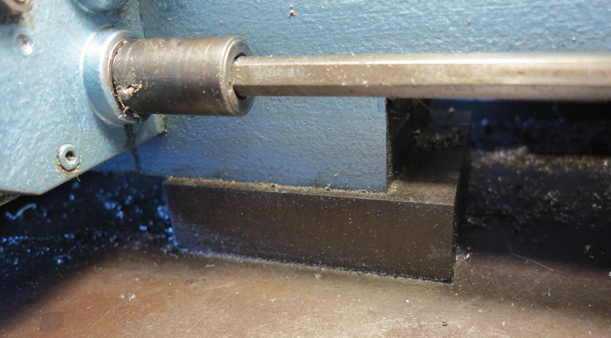

The lathe cupboard was not bolted down when I bought it, seems that my late friend saw no reason to do that?
It is mounted on two thick steel blocks and one each end of the machine, a single bolt in the center keeps things in place.Attachment 32063

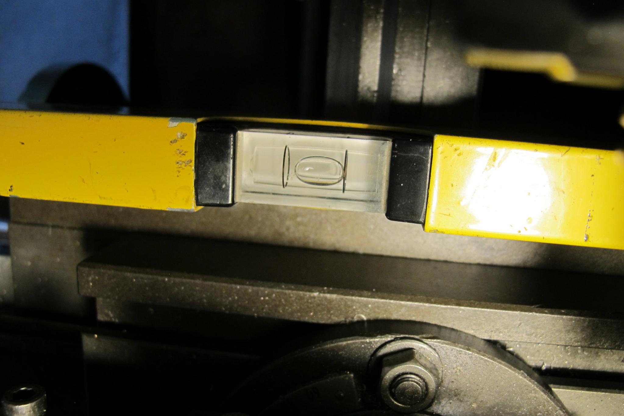

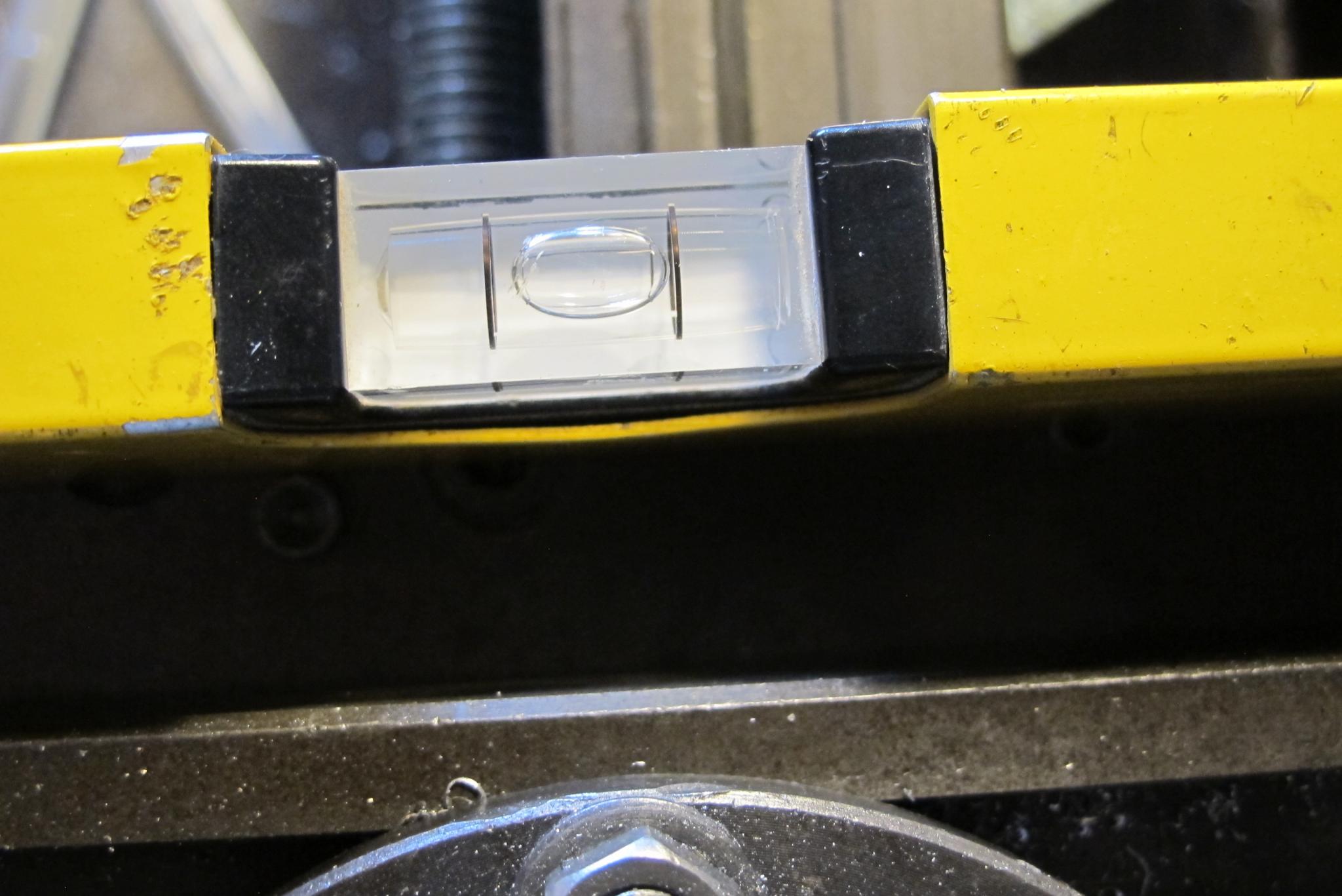

I have a lightly used Stabila level, ok its not calibrated but I am a trained carpenter, so am well used to reading such things.
For sure I see twist in the beds, one end to the other, if I remove the twist would that affect the headAttachment 32065Attachment 32066 stock I wonder?
Yes, a check with my level shows that the bed has a twist in it, I can shim the mounting cabinet easy enough, will it correct the headstock I wonder?

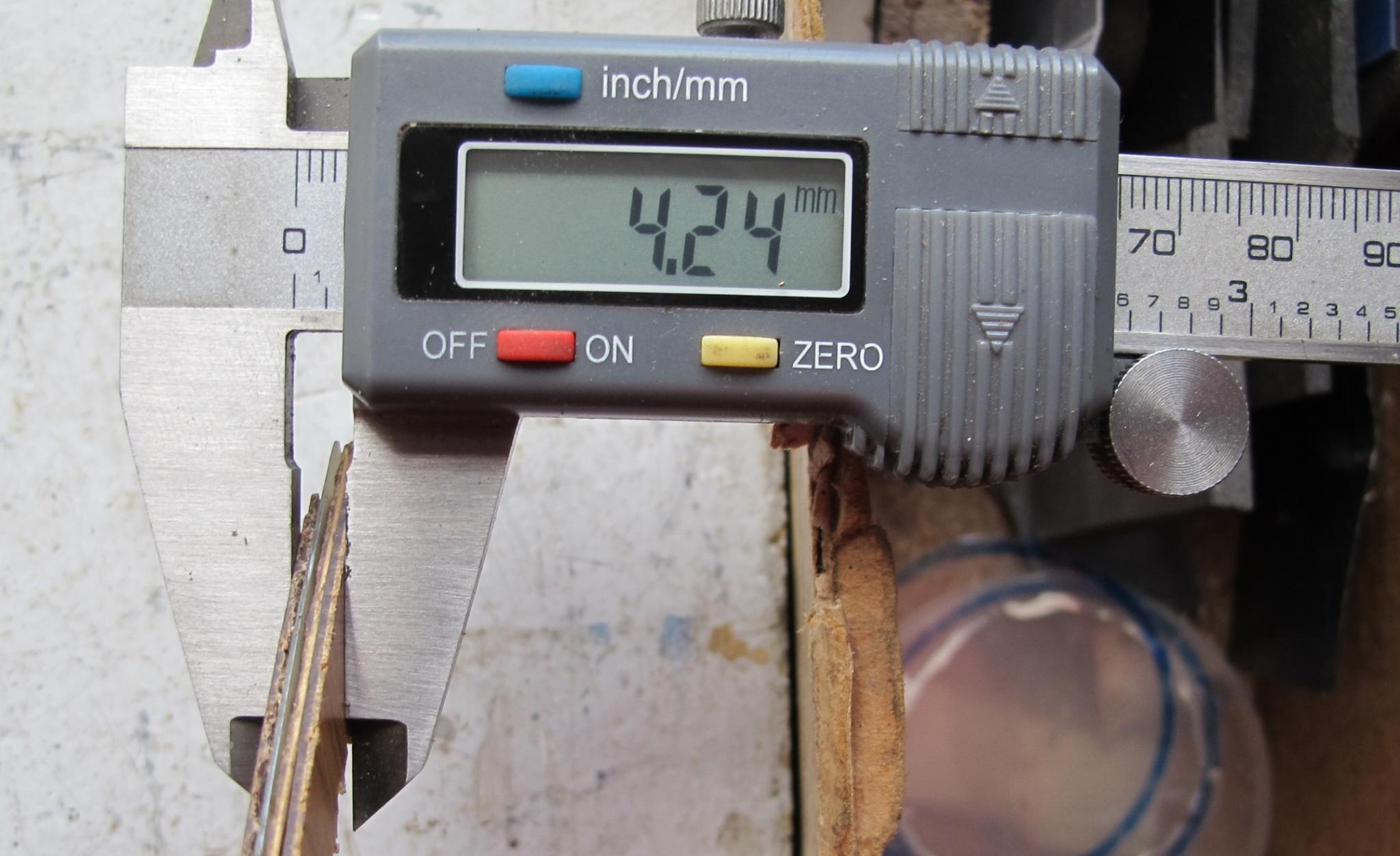

Ok, job done and it took a couple of hours, adding Formica shims until the level read the same at either end of the beds.Attachment 32067
The test on the alloy tube run again and the run out is still showing 0.003" , so no change there .

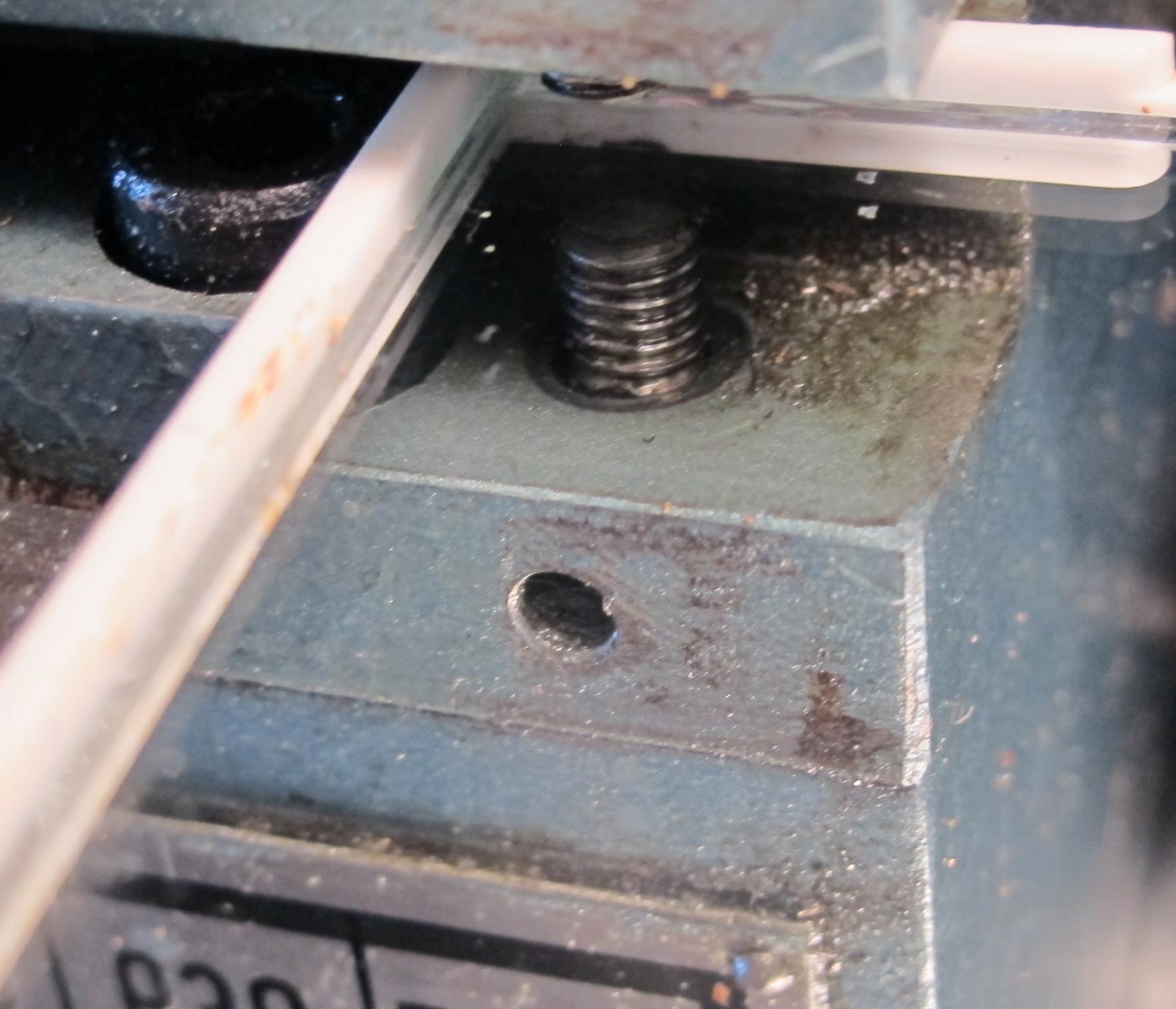

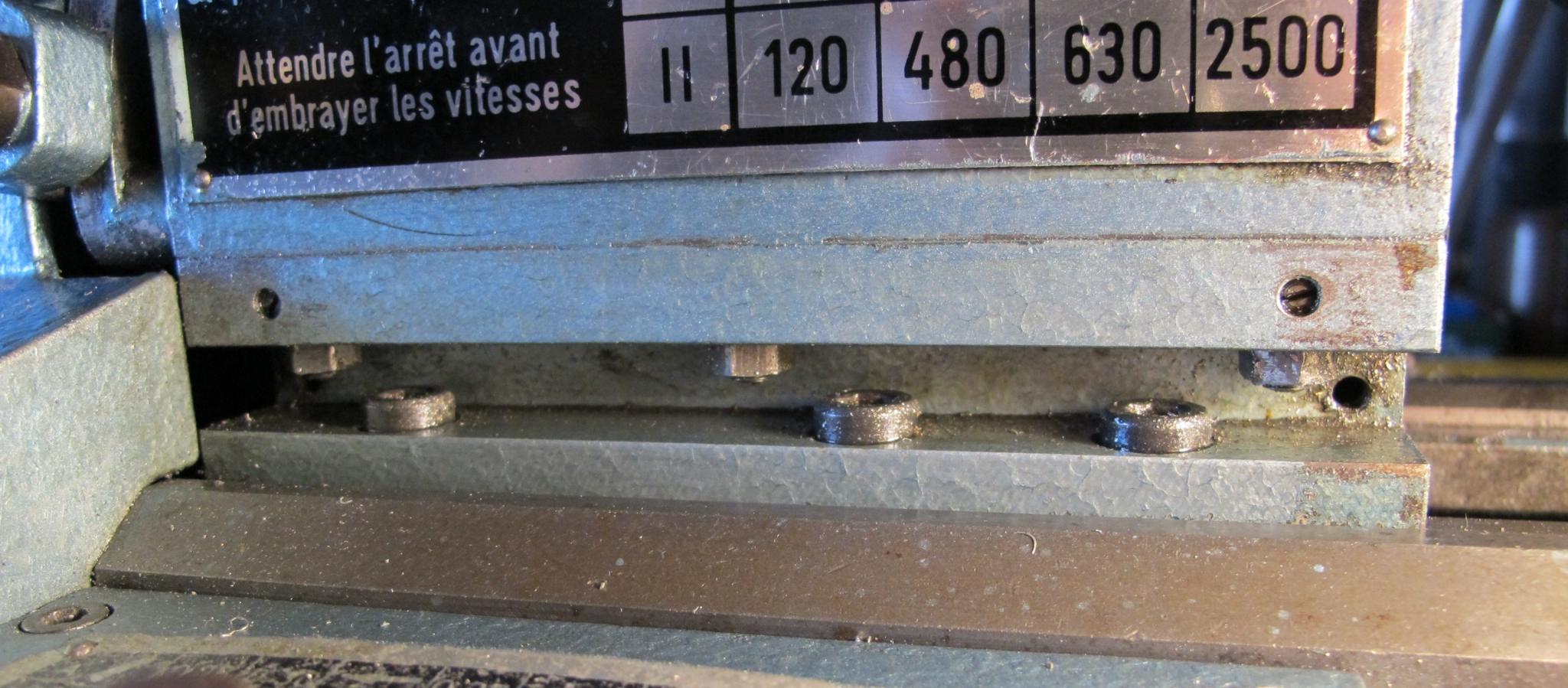

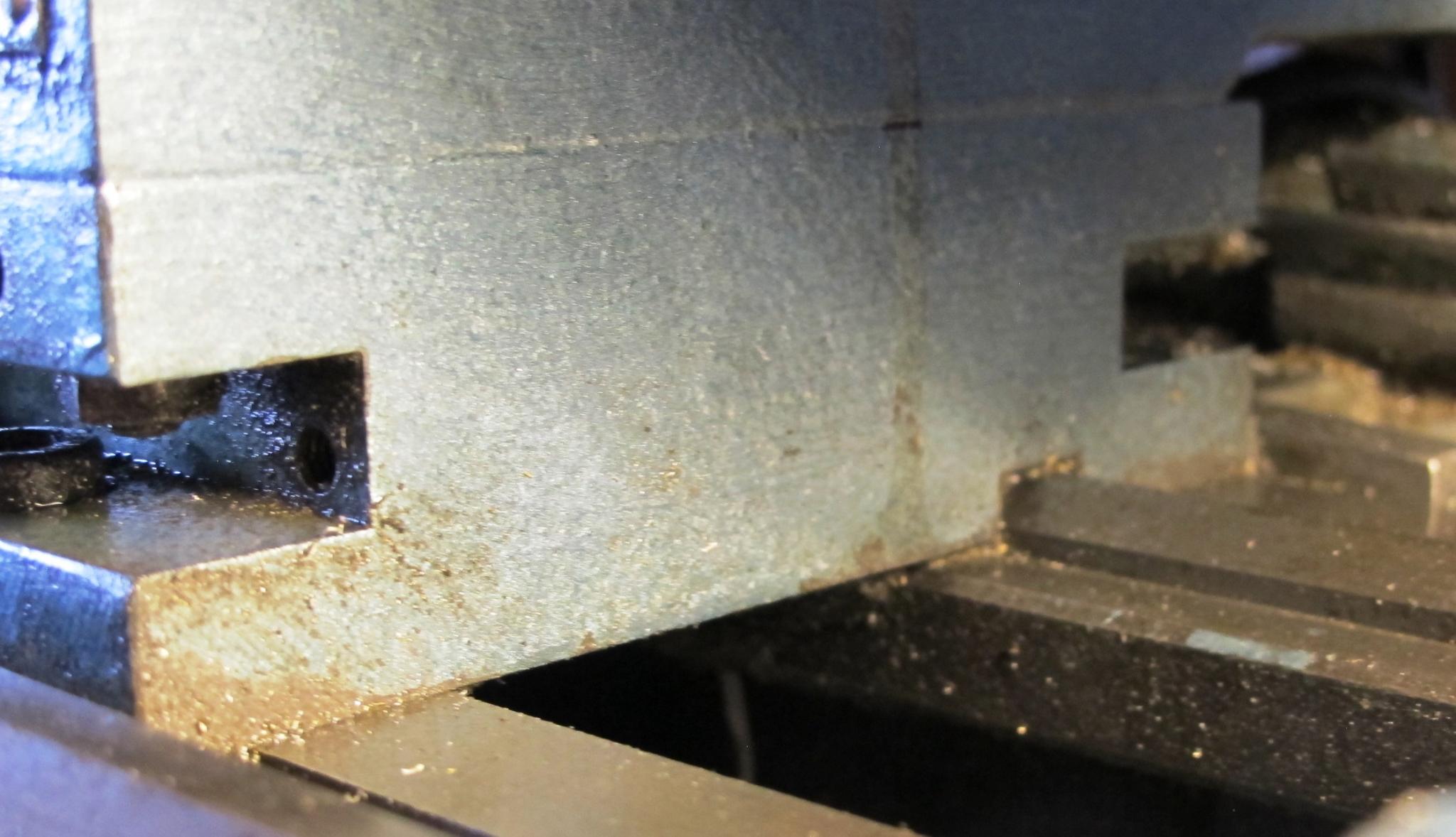

These pictures show how the gear head is fastened and located to the rails, there are no adjustments.Attachment 32068Attachment 32069
the first of the 2 pics shows the the 2 scerews i mentioned earlier, looks like these could inpinge on the mounting screw body allowing it to have some slight allignment
They are lock screws to the threaded rod they are going into?
But why would the threaded stud have a lock screw ??
Are they there to push the gear head into line, as in the threads are say 8mm diameter in a 9.5mm diameter hole, that would give plenty of adjustment?
Its the same on the other side.
With the nuts removed and a mirror inserted underneath I may see that the stud hole is large enough to allow adjustment?

if it is as i thought, screws on both sides would allow you to scew the headstock. i seem to recall on some of the youtube vids that i have seen that the headstock is located on the V of the bed, there's a few video's that might be worth checking, will have a look in my manual as there is some V10 stuff there

The base plate is indeed located by the V section but the way I see it the gear head could have adjustment by screws numbered 48, I cannot find a reference to those screws, will it say lock screw or adjustment screw, this is what I need to find now?

Before you start trying to realign the headstock, look again at bed twist. No point in using a carpenter's or builder's level, you need a proper machinist's level which is much more sensitive. This topic has been discussed to death over on the model engineer site:

By the way you are not seeing runout, it's taper. Run out is when a shaft is not running concentric.

An idea that the gear head box can be adjusted via the grub screw numbered 48 in the parts list holds no water, this is what I see in a mirror when the nut has been removed, there is no extra space seen for adjustment that I can see? Attachment 32072

Thanks for your comments, I am working with what is available, right now the Stabila construction level is what is to hand, if a more accurate one becomes available I will re do the job. I did however find that the tailstock end was out by 4.25mm which was a surprise.

My search for a parts name page has found the parts drawing and a list of names, part number 48 is a Socket Screw, so its not for adjusting the gearhead?Attachment 32075

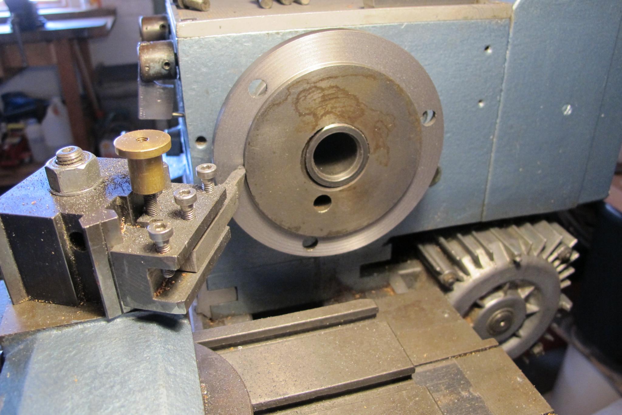

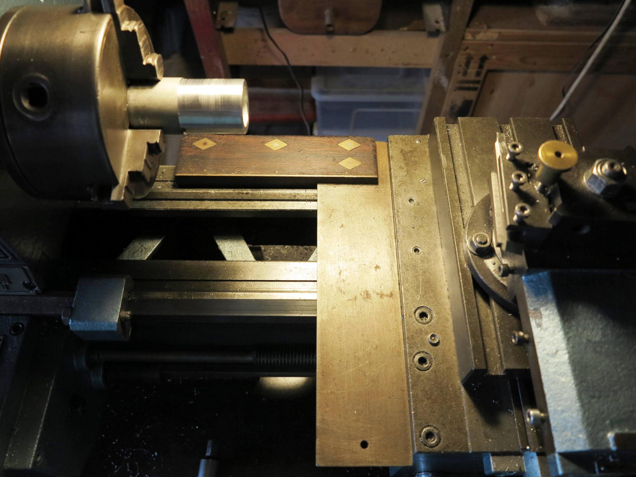

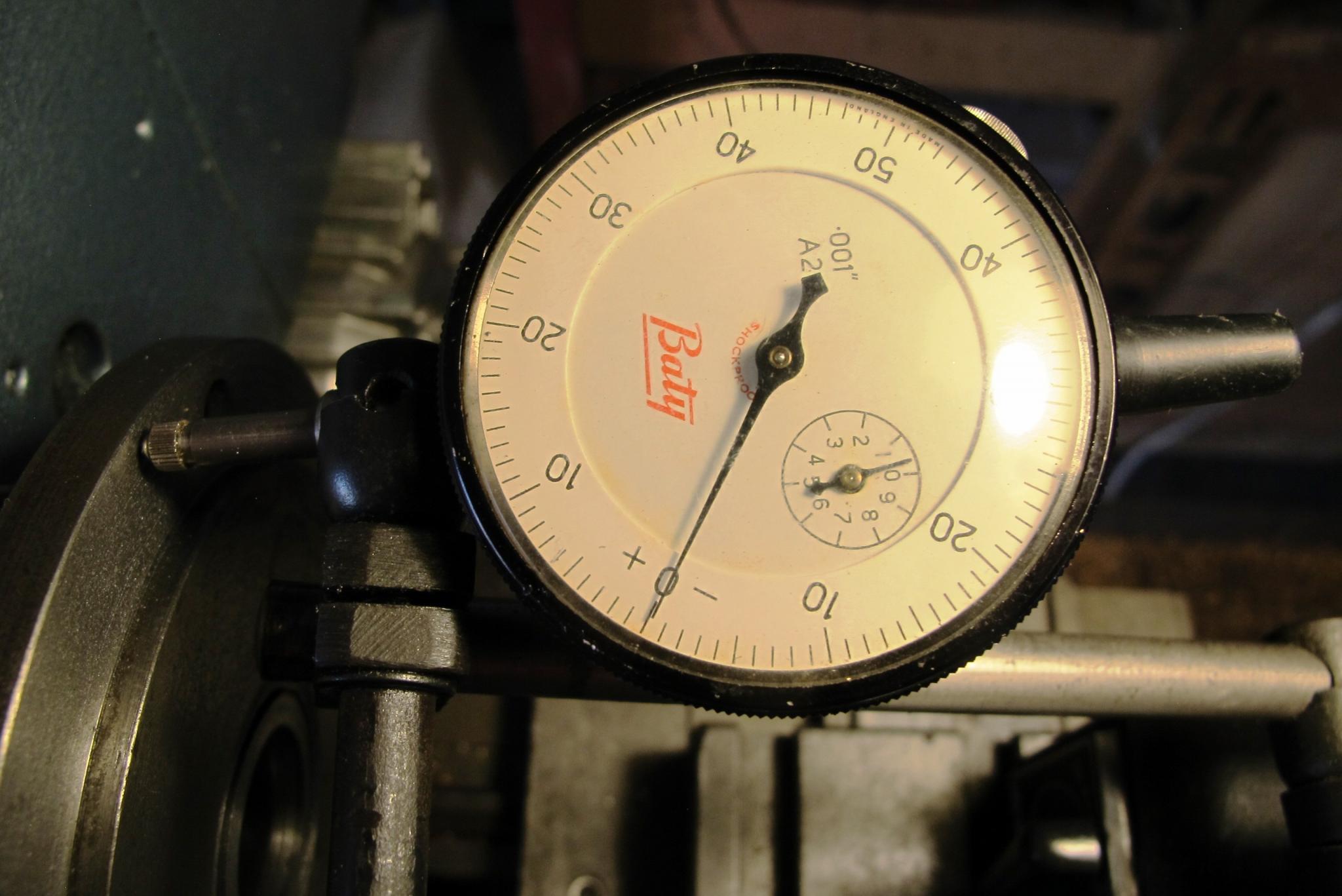

I mentioned the chuck back plate was refaced, well as a way of running through the possible errors I have rechecked the back plate and found that it had an error of 0.0003" which is what the error in my machining is, could that be the reason for error?Attachment 32076

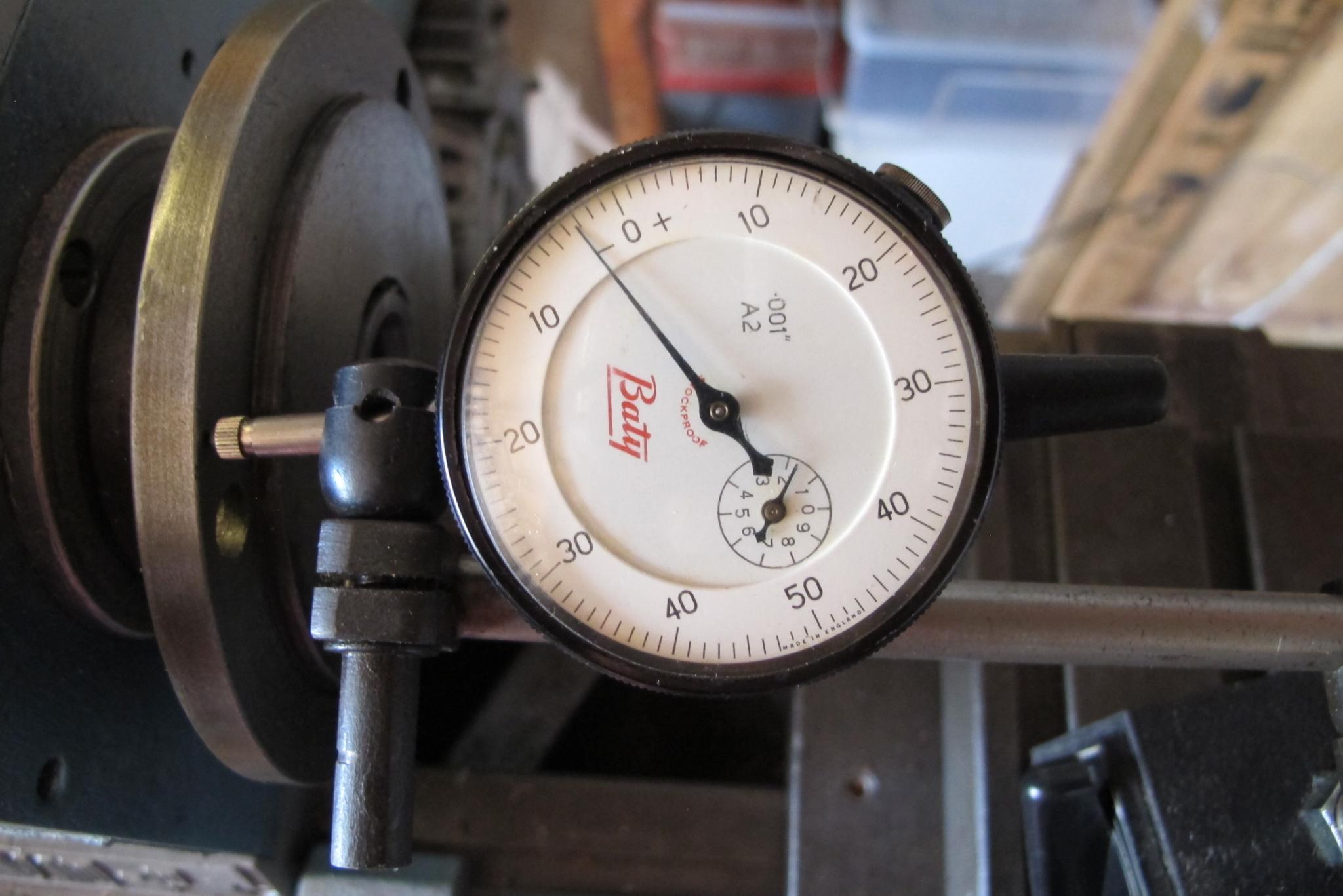

I then refaced the back plate and the dial gauge gave me a very nice zero read out, as in nothing. The center shaft required a small trim as well, otherwise the chuck was going to ride on it. Attachment 32077
With the recut of the back plate I saw a zero reading on the dial gauge in all areas! Plus I had also removed the problem with the 0.003" Taper error that I thought the gear head had?

I recut the alloy tube I have been using, this time the work was good and I have a lathe that I can trust now.
My thanks to all of those who have offered advice in this matter. Attachment 32081
