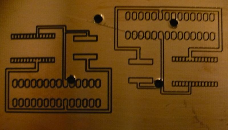

Attachment 2259
This was done on a KX1 mill as a test for someone who wanted to do roughly the same prototype boards with no lead time.
Not knowing sod all about PCB's, only JCB's, I asked for a file, this was code generated direct from one of the PCB software packages.
On the left is the code as sent but the tool depth was too deep so it was edited and the one on the right run again.
You may recognised the pad layouts but as scale the holes which were in the scrap sample board are 3mm.
A Krees spindle will cut these tracks with no problems, no bearing update needed, I do finer work than this with no problems.

Attachment 2259
This was done on a KX1 mill as a test for someone who wanted to do roughly the same prototype boards with no lead time. ..... You may recognised the pad layouts but as scale the holes which were in the scrap sample board are 3mm.
Looks like 2.54mm pitch through-hole, and 1.27mm SMD. The job on the right is close to what I need. Do you happen to remember what tool you used to mill this?
Just looked at KX1 specs - shame about the exchange-rate, because that would otherwise have been an option for me. The stated linearity and repeatability are well within my needs, and 180mm z-axis travel would be really useful.

Re worring about offsets.....in cambam you can import a gerber, fine tune the offset & see the cut width onscreen...the trick is to get the offset so that the midlines of ajacent pins of your smallest IC pitch so they almost share the same path. Difficult to explain, but look here...
http://img694.imageshack.us/img694/3982/isolate.jpg
the IC pads are black, the tool cut width is turquoise & the midline for the toolpath is the dark blue thin line in the middle ....it's important to set your offset to get these midlines to almost kiss, but not go over, else you'll be unintentionally cutting into the neigbouring pad.

Attachment 5474
That's about 80 x 80 mm.
Re: Opinions sought on cheap desktop PCB milling machine
That's a large track width, all through hole and no tracks between the pins - I'd have been amazed if anyone had problems with that. A lot of SMT IC's have a quarter the pin spacing of DIL, which is when it gets more difficult.
If it's a circuit which is running at relatively high frequencies I do engrave it in the 'normal' way or etch it.
I cut plenty of PCBs on the Roland PNC2300A (same as one John S has) at school with a V-cutter. It's a very weak machine, yet did what I needed at the time (up to SOIC). So you don't need a massively rigid machine for PCBs, since the cutting force is minuscule, however if you're happy with the travel on the table and expect to use it for other things then clearly rigidity is good.
