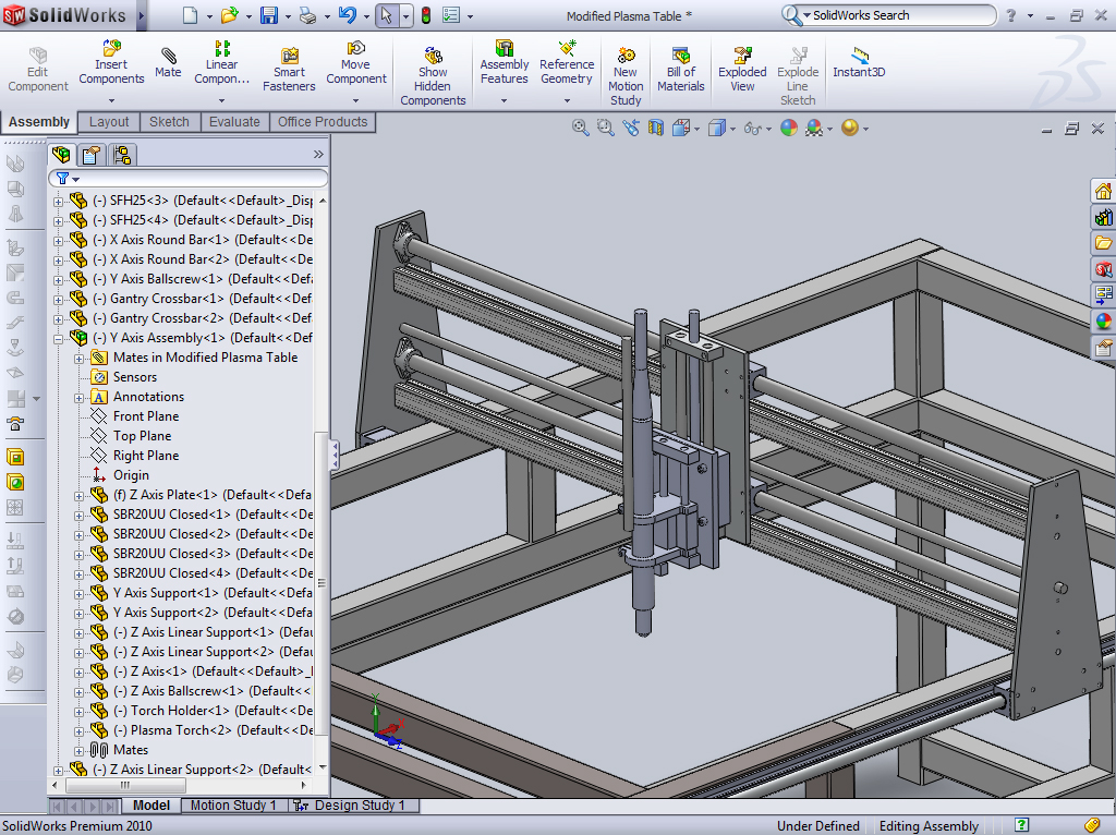

Could someone do me a quick calculation
I am upgrading my Homebuilt Plasma by extending the table, this is the design so far :smile:
The Y Axis has two unsupported solid rails @1500mm long (See Picture) the centre bar is the Ballscrew.
I still need to add some form of aluminium extrusion to stiffen up the Y Axis Gantry.
It has the Z Axis assembly hanging off of it and also the Plasma torch, not sure what that will weigh.......
I think I might need to put some form of support under the rail, I had to do that on my first machine, I had small angles welded at 45° under the rails, and setscrews to bear onto the rail
Thanks in advance :smile:

You didn't state a bar size so a quick calc using 25mm dia. 1500mm span and 250N (25 kg) load the best case deflection would be just over a mm but worst case is 5mm depending on the restraints.
You really need additional cross rails to support the gantry sides as at the moment the rails are taking all the loads as well or you will have to assume simply supported. :eek:

Thanks Ross, that version loads fine :smile:
I have added a couple of lengths of 40mm aluminium extrusion to the model
Attachment 2360
I have one small problem of the unsupported rails being 30mm too short :redface:
I may need to move the X Axis rails on top of the box section to give me a bit more room to play with :smile:
I think the biggest problem you will have is the bounce caused by vibration. but that can be sorted by not letting the torch travel at resonant frequencies and keeping the acceleration and deceleration down.
One thing I want from the new machine is to keep the speed up on corners etc
My current machine has a really heavy steel gantry (I originally built is as a Router), and I have to keep the acceleration and speeds down on corners.
On straight sections it cuts parts to almost LASER Quality, when the machine has to slow down for corners it causes dross to build up on the corners :cry:

Your machine is starting to look really good. A suggestion (from a non-plasma expert!) is to consider running a simple bearing from the back of the Z axis plate onto the top and bottom of the upper 40mm rail. This would give a bit more support to reduce the sag, and possibly help with the resonance (if that is due to the round unsupported rails vibration). Just a thought . . .
In terms of running the x axis rails on top, rather than on the sides, I've always wondered if this was easier from a build point of view. As drawn the gantry has to be very precisely made so that it is a nice fit onto the rails. The rails or gantry might need to be shimmed to achieve this. If you put the rails on top then everything can be bolted together and settled before finally marking the holes into the frame. Maybe there is another way but this seems a bit easier to me.
Good luck with it,

Your machine is looking good. what CAD package is that?
With regard the rail orientation then I don't think it really matters for a plasma machine. Mounting them on the side will make the most of their strength and equal out the load capabilities but as you are only moving a light gantry then you shouldn't be getting any where near the max strength of the bearings. There is also the point that the cheaper open bearings can bend and open up even more if mounted on their side.
I've not had anything to do with plasma or even looked into it but it seems to me that if the z axis only has to hold the weight of the torch then there is scope to really reduce the weight of it. Which will help with the deflection and vibration.
I would have thought that you could use sheet metal instead of the plate, get the smallest dia ballscrew (or use belts) and 8mm round rails. Really lean it out.
Is that a double travel arrangement that you have on the z axis, again not a plasma expert but it looks like its just adding extra weight :smile:
It was drawn on Solidworks :smile:
I am lucky in having use of Solidworks thru' the Company that I do work for
It is a brilliant package for designing CNC Tables, you can animate all the gantry movements etc
The picture I posted was created after I loaded the assembly into Photoview that creates a 'Rendered' view of the model
This is what the model looks like when actually designing it.
Attachment 2363
The weldments tool is brilliant, I drawn the complete framework for the table in 20 minutes :smile:
That is a vital part of a Plasma system :smile:
It is a 'Floating switch'
What happens is Z axis lifts up and moves to its pierce position, the Z axis then lowers until the Torch makes contact with the material.
The torch is fitted to the second linear slide, and just rests using gravity.
When the torch touches the material it trips a micro-switch, this then sends a signal to Mach3 and zeros the Z DRO
I will start a new build thread for my new machine, keep the suggestions coming! :smile:

I've just found that SolidWorks calculates moments of inertia, including second moment of area. I just drew out the SBR20 rail (20mm, supported) to try and compare it to unsupported rail. Here's the results for just the aluminium support on the rail:
Section properties of the selected face of SBR-20 supported round rail
Area = 400.80 millimeters^2
Centroid relative to assembly origin: ( millimeters )
X = 22.50
Y = 5.85
Z = 0.00
Moments of inertia of the area, at the centroid: ( millimeters ^ 4 )
Lxx = 8228.45 Lxy = 0.00 Lxz = 0.00
Lyx = 0.00 Lyy = 41748.33 Lyz = 0.00
Lzx = 0.00 Lzy = 0.00 Lzz = 49976.78
X is along the width of the rail, Y is the height and Z is the length.
I for the 20mm steel bar is 7840mm^4 ... so how do I combine these two values? Solid edge will calculate them as one but of course doesn't take into account the different moduli(?) for aluminium and steel.
EDIT: I've just found out how to do it - 'Parallel axis theorem'. Why can't it be simple!
Re: Unsupported Precision Round Rail Calculator
Right I've worked out I for the 20mm supported rails in both directions.
In X direction I=53643mm^4
In Y direction I=22257mm^4
To account for the two materials used in the rails I've just scaled I for the bar by 67/200 so if you enter the above values and select steeel in the spreadsheets in this thread it should work.
For comparison the 20mm unsupported rail is 7854mm^4 - so it's roughly 2.8 to 6.8 times weaker than supported rail which is just 'floating'.
(I'm fairly confident that these values are correct, though I've literally only learnt about moments of inertia in the past 2 hours and it's like 1am so no guarantees!)
