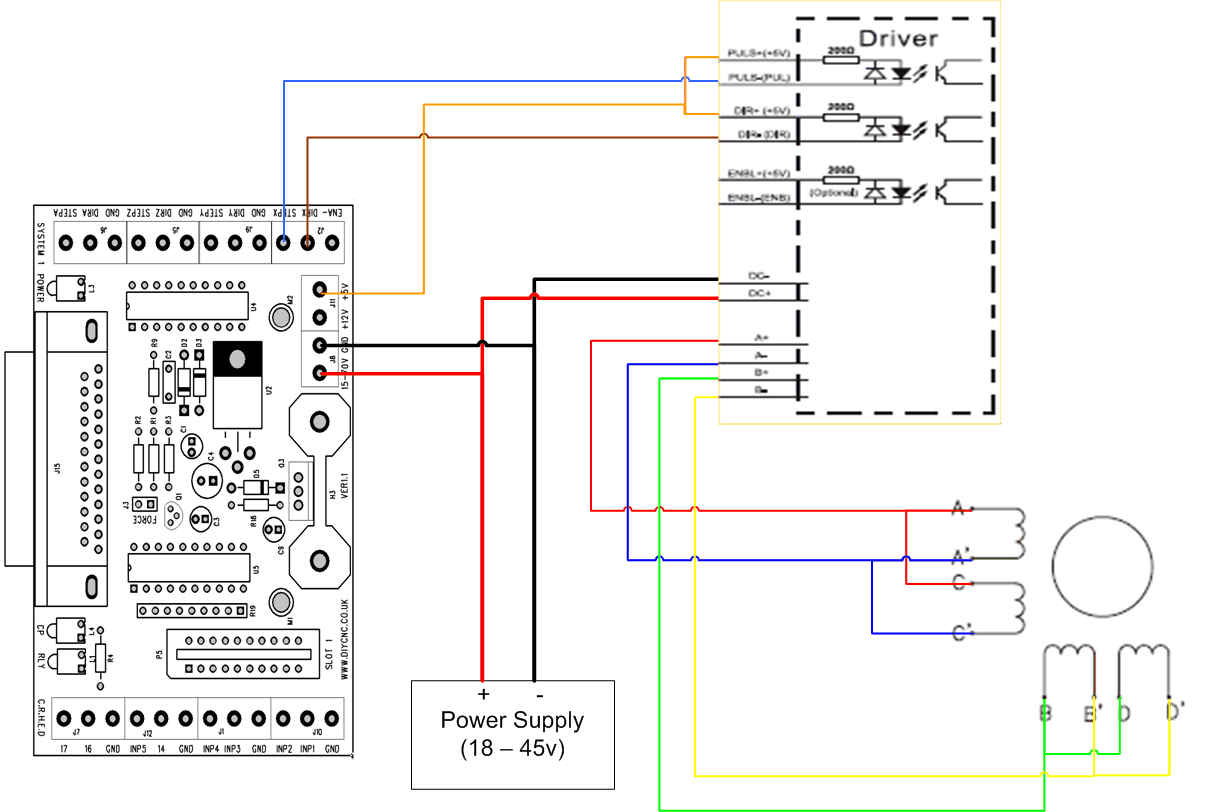

I'll submit a drawing of how I've wired them up if this helps anyone?

Re: Need helpwiring up from scratch
hi george
this is the wiring for msd542 driver from zapp to the pcpps bob from diycnc might help you
Irving,that diagram doesn't show the enable +&- does that mean they are dismissed?
There's one wire there that I had in "ena-"

George,
In the Outputs tab, disable the 'enable #1,#2,#3 and output #1,#2,#3 lines (red X them) but enable the ChargePump line on pin 1... I suspect thats the reason its not singing... assuming wiring is OK

The Chargepump circuit on the DIYCNC board acts directly on its outputs so for a stepper circuit it makes no difference. The external enable would be used to power down a servo where there is external 'intelligence' driving the motor. The reason I'd leave it disconnected here is that the DIYCNC board outputs an 'Active Low' enable signal, but the drivers use active low to "enable the motor for manual operation", i.e. disable it!
If you suspect the problem is the chargepump not enabling the outputs, jumper J3 on the DIYCNC board - which is normally left off - can be fitted temporarily to override that and enable the outputs permanently...

However in the Motor tuning setup I cannot get anything out of the motors,they jut won't turn....they work fine if I load a G-code.
Going through the PDF of how to set up Mach3 and this is the first thing it explains to do but it ain't happening for me :cry:any ideas?
Thank yer vey kindly :wink:
Dang! hold the front page chaps...I reread the PDF and must have overlooked the part where it says "Now press the up&down key on the keyboard" :rolleyes:
GeorgeD
Ummm, think i said that in post #30...
So you did Iving,:heehee: I gotta blame it on her indoors,she keeps me awake half the night :naughty:
Success,seems it wa the chip after all.
I got a couple at 30p each and also the other type as well.
Good job I put them in DIL sockets rather than directly slodered. :-)
