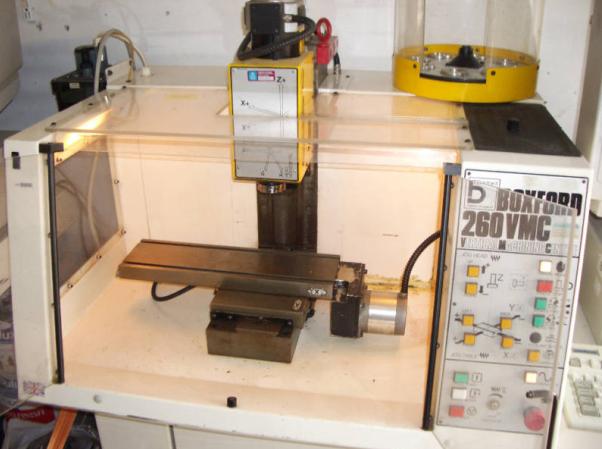

2 Attachment(s)
Re: The illusive Boxford 260vmc
Ok here is a look at the machine before i picked it up.
Attachment 2499
