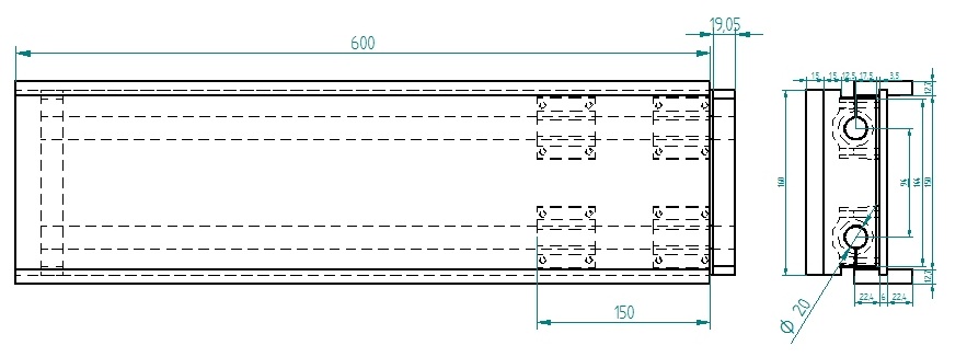

I'm trying to design a Z-axis for the CNC router I'm building to have 400mm travel. My current thinking is to use two of the 20mm linear rails from Zapp with two bearings on each rail...not the supported rails. I think the deflection of the rails themselves should be fine with this size?
The rails will be mounted to 15x160x600 alu plate so the bearings are 200mm apart and the rails spaced at 150mm (ish). I then intend to use another 15x160x600 aluminium plate to mount the router. This works out at over £50 in aluminium...ouch
Is this going to be strong enough? Using the 'gantry stiffnessv4' spreadsheet I've found on the forum and putting in these numbers I get a deflection of 0.58mm with 100N which is clearly unacceptable.
That's made me think instead of using aluminium plate for the router/bearing mount thingy I should use say an I section. I'm currently thinking of using 6x160x600 aluminium and fixing some 2"x0.5"x600mm 'strips' onto the edges of the aluminium plate to make an I cross section. I would mill a 6mm slot in the strips to fit the main sheet. According to the spreadsheet this reduces the deflection to 0.027mm which I think is fine....it's also a lot cheaper!
So, which option is the best - am I missing something here?
Thanks in advance!

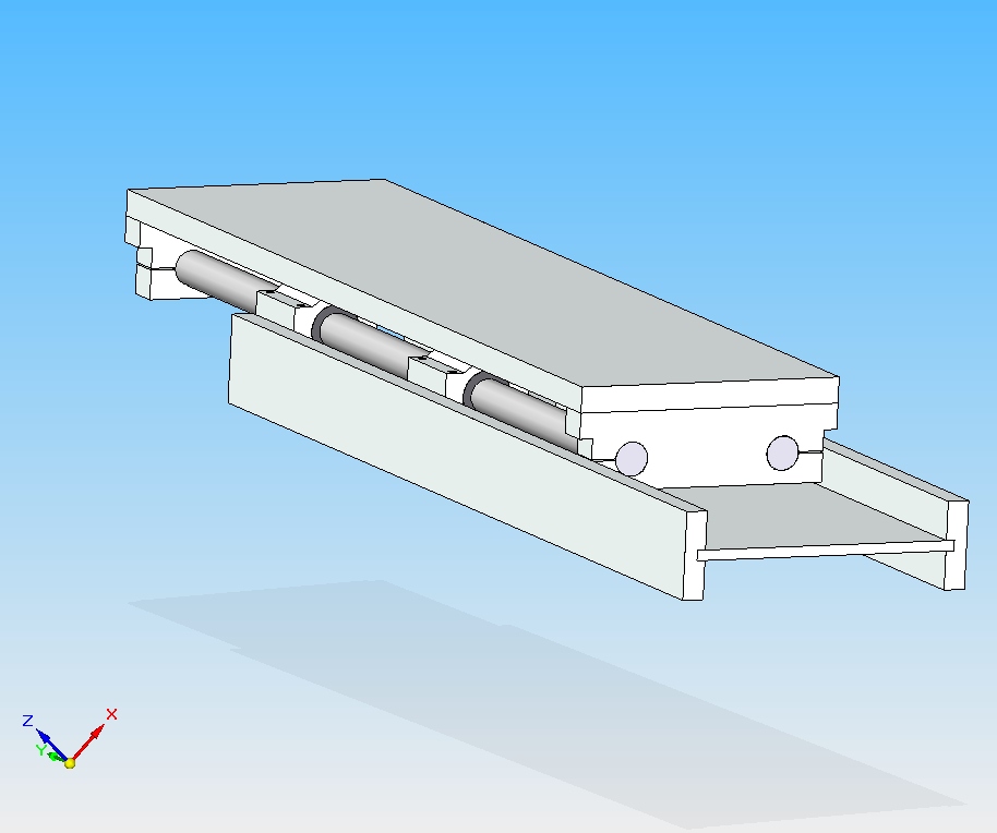

Just done a quick model to clarify the plan:

Re: Z-axis design - help sizing materials please!
Hi Jonathan,
I posted that gantry spreadsheet so am pleased someone is trying it out. However, it is not configured to do the calc you are trying directly, unless you are moving things around and doing some extra calcs. Can you tell me a bit more about which of the above pieces you are modelling in the spreadsheet and how you are doing it? I think there are moments which are not being considered with your approach. Don't forget that the cutting is taking place some distance away from the Z axis which will lead to moments in 2 directions.
Maybe even post the spreadsheet with it set to your parameters (you need to zip it to attach it).
How far down is it from some reference point on this Z axis down to the cutting tool?
Are you doing the calcs on the rail, the I beam or the plate etc?
If you are really looking at 100N, then can I suggest using profile rails instead of unsupported rail. I think this will always be a limiting factor no matter what sections you use elsewhere. I bought a used pair of 15mm profile rails and carraiges, about 400mm long, from Ebay China for around £80 if memory serves.

I'm currently dimensioning the drawing - I'll post it as soon as I'm done. But basically the 4 bearings are currently spaced as a square, 100mm between centres - hence the rails are also 100mm apart. The rails are 600mm long (the above prices are for 700mm just to be safe) which leaves a nice 400mm or so travel.

Here's the dimensioned drawing:
Attachment 2810
Hi Johnathan
personally I wouldn't go for that length of travel on unsupported rail. The calculation you need is for a cantilevered beam, just you have it mounted vertically. As a rule of thumb I look at third points, so for a cantilever of 400mm you would need a 1200mm rail with the mounts 800mm apart. (not very feasible)

Hi Jonathan,
The drawing helped, thanks. Wow, alot of overhang.
You could design a lower 'floating bearing'. This is where the lowest bearing block has two or more alternative mounting positions on the Z axis part which holds the router. For long reach work you bolt it where it is now, and accept the deflection. For shorter reach work you bolt it further down, spacing the bearings out so that the loads are taken towards the ends of the unsupported beam, rather than towards the centre. You need a moveable limit switch with this idea.
Another thought, although it doesn't really work with your requirements, is to support the rail at the centre, as well as the ends. The bearing blocks then run in the 'upper part' above this centre support, and the 'lower part' below this centre support. Your rail deflection is instantly halved, but there's a compromise with Z range.
It looks like you are using an 'I' beam for the router mounting plate. You're only considering the bending in one or possible two directions, which will give you good results on the deflection for these load cases. But since the router or spindle will be mounted off this, and the cutting forces will be offset, there will be a twisting force (Y direction cutting) and this section choice will give you poor results, particular with that overhang. Overall it might be worse than the original plate, all loads considered.
For such an overhang, you might want to choose RHS for the part which attaches to the router/spindle. This is good for all the load cases you are requiring. Ideally any bolting into this section should go all way through with spacers inside to get the loads into the section, rather than locally deflecting the wall. The calcs all assume good load transfer.
As Ross has already suggested, I suspect you don't need to mill down 400mm into things, but rather you want to be able to machine to a depth of perhaps 30mm into things which are up to 400mm deep. If this is the case you could limit your Z travel to say 100mm. You then block up the workpiece with spacers to suit. This would be fairly stiff for all cuts, but give you options in terms of workpiece sizes.
Yes! I was thinking that just hadn't got round to posting it...I'll allmost certainly do that. Maybe have 75mm or 400mm travel. Thinking about it I may as well have the lower bearing with several positions - it's only a few more holes after all.
With regards to supporting the rail at the centre I could do this when the Z range is limited, as above. It would make it take slightly longer to change between the two set-ups though.
routercnc
It looks like you are using an 'I' beam for the router mounting plate. You're only considering the bending in one or possible two directions, which will give you good results on the deflection for these load cases. ...
For such an overhang, you might want to choose RHS for the part which attaches to the router/spindle... bolting into this section should go all way through with spacers inside to get the loads into the section, rather than locally deflecting the wall. The calcs all assume good load transfer.
Just to clarify I'm not using actual I beam, just 3 aluminium bits slotted and bolted together to make an I. I can't find RHS in the right dimensions so I guess I'd have to use a similar approach, just now with two 6mm aluminium plates instead of one. I'm concious that using RHS is going to further increase the horizontal distance from the router to the Y axis. Would it be ok to cut the front out of the RHS (to make a C shape) just where the spindle mounts. It's either that or get big enough RHS to fit the spindle inside?

I've edited the drawing to include holes to mount the bearings further down when I want only 75mm travel:
Attachment 2818
The thing floating around is a support for the middle of the rail. I've designed it in two parts since that means I can fix it on without removing the bearings from the rails.
I've not put the box section in yet. It's just occured to me that mounting the bearings to box section sturdily is going to be a lot more difficult! Would fixing the bearings to just one side be ok, or should I put a spacer inside the box section and use a long bolt?

Here's my latest plan for the Z-axis:
Attachment 2819
I've changed it so that the rails move and the bearing are stationary. This significantly reduces the weight / cost. The supports in the middle of the rail limit the travel to 75mm, so I'd remove them when I need the full travel. I guess I'll mount the stepper motor on the top of the slide - shame about the added moving mass there.
The aluminium plates in that drawing are 15mm. I'm thinking I could make the bigger one 20mm thick, to better resist torsion, then *if necessary* add side pieces like in the previous design.
So, do you think I should go ahead with this design, or spend another whole day designing :lol:?

Have you considered to make the bed rails adjustable at each corner? this way you could keep the 'Z' shorter and do the machining in stages? It would make t machine very flexible for different uses.Spacers or a wind up/ down mechanism could be done fairly easily.
I had considered making it so that I can bolt the Z axis to the Y axis at different heights which, if I understand you correctly, would have the same effect as your idea. I don't like this idea so much since it means I've got to zero the axis to the part multiple times. From my experience with the smaller blades this is definitely not something I want to be doing.

There's no easy way to commit to an own design, and you'll no doubt end up tweaking whatever you make anyway. Making these CNC machines is a mix of previous experience, guesswork, copying parts of existing designs, understanding forces, making calculations, and fabrication skill. You've obviously thought about the problem, the risks, and the compromises, so it's probably time to give it a go.
My concern on drilling the hardened rails is that I don't know if they are stress relieved as part of the hardening process. If not then drilling a hole may allow the stresses contained inside to distort the rail. The bearings won't help you to 'make it straight again' between the span. But I'm really interested in a second opinion on this as well. I'm going to post this question seperately to put it to a wider audience.
Yes I tend to agree. I think I'll wait a bit to see the what the conclusion is on drilling these rails first. Is there any loss in buying the rails and open bearings and if the drilling doesn't work still using the open bearings unsupported?
If I do go down this route which bearings are a better bet...the adjustable or fixed ones?
I could always support the rails underneath without actually fixing them (hmm loctite!?). That would at least stop them deflecting in one direction.

How about putting the bearings either side of the centre rail support? That way you increase stiffness but still get reasonable travel.
FatFreddie
I think that would increase the length of the rails too much. Either way I've just found this on eBay, don't know how I missed it before:
