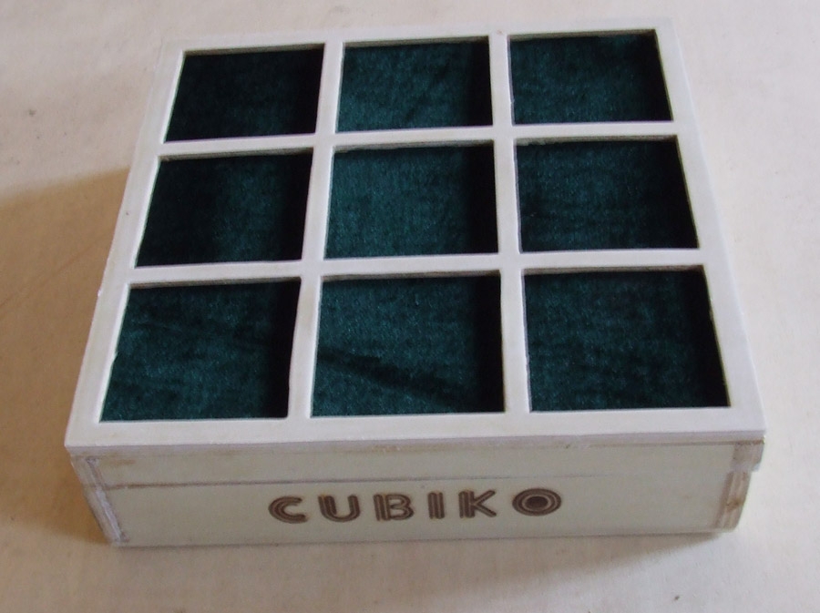

		This is my game. It is being made in China, they do not use cnc.
Attachment 3756
It is 246mm square. The green fabric is sandwiched between 2 x 4mm ply grids.
A year on and Quality control is still an issue so I'm looking into the possibilty of making the games myself.
Would a CNC machine like the 3040T from cncdiy.org do the job?

		I never considered buying a CNC router ready made. For me the interesting bit is to make it and improve it.
Remember when working out the customs charges that they charge the 20% VAT on the value quoted on the customs form, which may well be a lot less than what you actually paid! This happened to me with the X axis rails and ballscrew that I bought together, but the actual amount charge was only a couple of percent of what it cost me.
I'm pretty sure it would end up cheaper to make a similarly capable machine yourself, especially if you're careful with the choice of materials. For instance if you can get away without using aluminium profile that will save a LOT of money. You should certainly buy some of the bits from china/hong kong - spindle and linear bearingse.
You could use the router to cut much nicer joints on the sides of the box. Fingerjoints, or even dovetails are quite easy if you can fix the wood on to the end of the bed 'vertically' and machine the joints with the corresponding cutter. You don't need much travel to do this. You don't actually even need cnc for that...

		Having looked at the site and video for the game, do you really need CNC?
By the looks of it, you need a grid, which could be as easily made from strips of wood, notched + glued together, 4 sides, and a top & bottom.
All that could be done with a table saw, and a router table (cross cut saw would be far safer/more accurate, but cost more to buy), along with a few jigs, so you can machine parts in batches, then assemble them.

 Thanks for looking at the website and your suggestion. The first 100 grids I commissioned were made in a similar way to what you describe, but I can't see myself making the grids by this method again.
Cost is an issue but it is secondary to time. If I take production into my own hands I will need a quick way to produce a 1,000 games. I'm thinking that CNC would be like having a second employee doing the time consuming grid whilst I get on with the long list of other operations.
My next game http://members.webs.com/MembersB/Edi...geID=203738312 could be improved by having 1mm grooves cut into the ply to create lines. So looking to the future CNC would probably save my marriage!

Initially I will be working with 3.6mm ply. I need to cut out 60mm circles, 72mm squares and make 1mm grooves.
A 3mm end mill came with the machine is it a good tool to cut ply?
I imagine it is better to get the tooling set up right before starting to try and make cuts so can anyone advise me...
1)what tool would be best to cut out circles/squares in 3.6mm ply?
2)What tool would be best to cut a 1mm wide groove, 1.5mm deep
3)What speed should be set for the spindle?
4)What speed should I set for the spindle to track around the toolpath?
5)Can 3.6mm be cut in one pass?

1) If you want to do it in one cut, then at least 3mm I think.
2) Does it have to be only 1mm? 1mm tools are not cheap and your feedrate will be limited. If you really need a 1mm groove then a circular saw/slitting saw would be faster.
3) Depends on the size of the tool. In general the smaller the tool the higher the spindle speed. If the tool gets too hot reduce the spindle speed. Google it.
4) Depends on the diameter of the tool, depth of cut and all sorts, again google it.
5) Depends on how rigid your machine is. But probably yes.

I should be able to tweak the game to allow for a 2mm groove. Anyway, I just ordered a 2mm left-hand spiral flute from Drill-service.com. Can you tell I'm eager to get going?

 Step over is the distance you move the cutter into the material for each subsequent cut. It defines the width of the cut. It is often expressed as a percentage of the cutter diameter.
However for this particular excercise you're just cutting a slot in one pass, so stepover isn't really relevant. Effectively it's 100% stepover though...

		Update; cut a few boards, wow this machine is brilliant...broke a couple of bits...
This is now a CNC project so I will post updates elsewhere.
