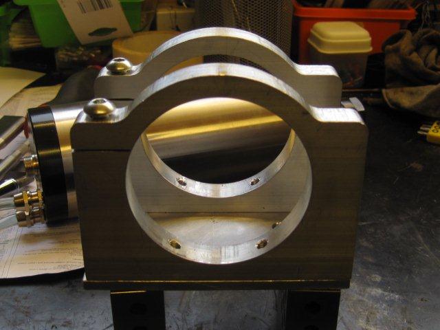

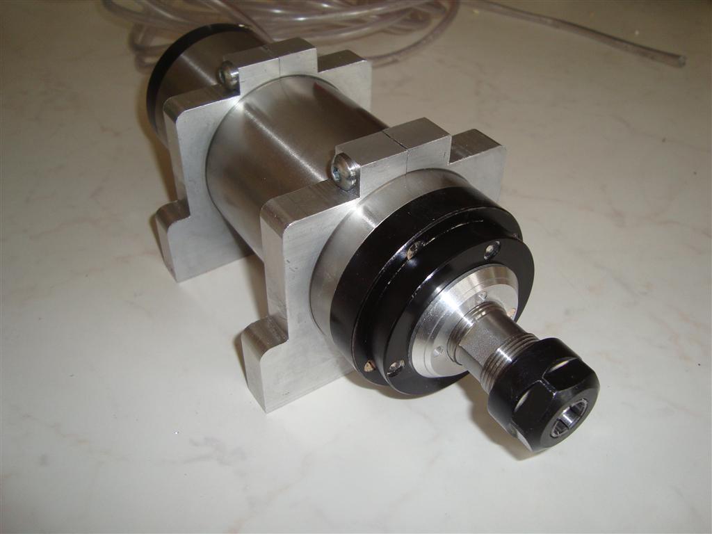

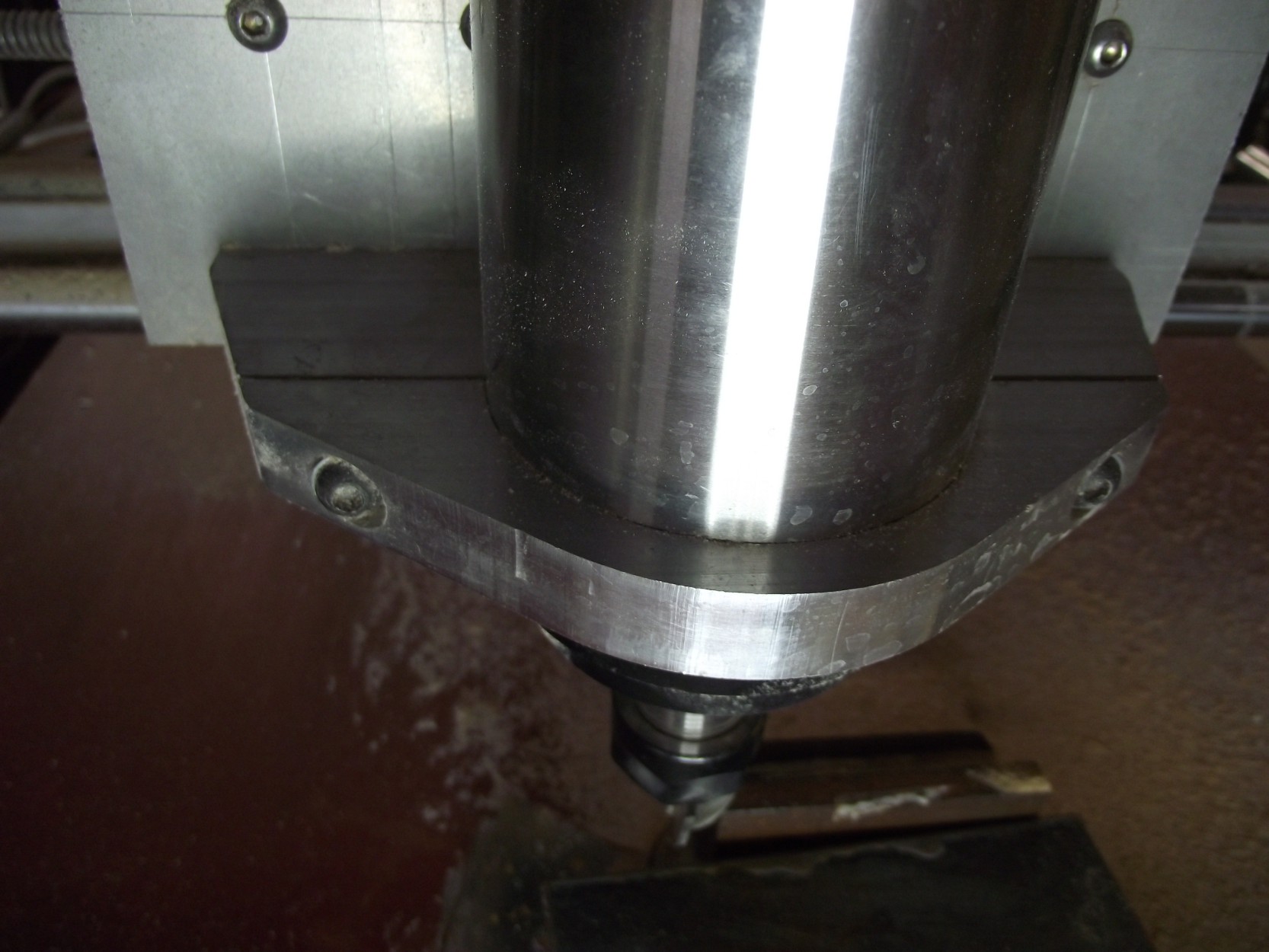

I've made a few 80mm spindle mounts (only one picture shows finished mount):
Attachment 4293
Attachment 4294
Attachment 4295
Attachment 4296

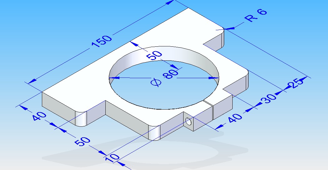

The drawing is just an example - if you want a different size or to draw your own that's fine. I have got aluminium in stock to do up to 150mm wide and 1/2" thick, or 5/8" thick and 125mm wide.
If you're interested send me a PM or make me an offer...
Re: Spindle holder for 1.5kw Chinese spindle.
Jonathan,
Do you think that mount is strong enough? it looks to be very thin near the clamping bolt (If my maths is right, 4.7mm) and you have a sharp internal corner at this point too. With this stress concentration and the cyclical loading that a spindle typically gets, I wouldn't expect it to be too long before a crack appears.
Yes I thought that looked like a weak point when I'd made it. Once it's clamped on to the spindle it can't bend, so fatigue shouldn't be an issue. It seems perfectly solid.
That's why on the next version (last photo) I rounded off that corner and moved it further from the spindle to make it stronger. Changing the drawing is not a problem.
If it breaks naturally I would replace it free of charge.

Jonathan,
have you been copying my design ? :smile:
Only kidding. Mine is very similar, basically the same shape but without the rounded off corners seeing as I made it on the milling machine then lathed out the inside.
I have just cut two more alu plates today at work and I am going to make two more spindle mounts and see if I can get two identical mounts that are a better fit for the spindle than the last one I made.

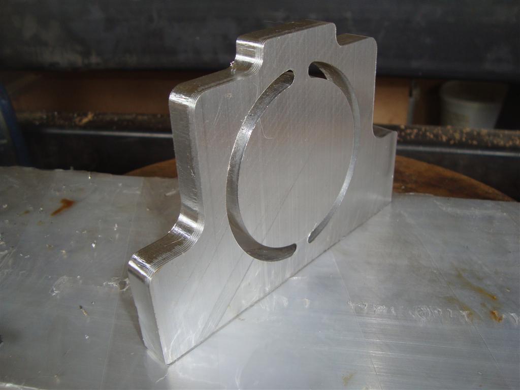

I see, same as the one I made with my CNC router then bored on the lathe...last photo in post #2 shows it before boring.
Jonathan,
I would have loved to make them on the router, that way they would have been identical. Why didnt you mill out the inside completely on the router?
Ian
I did them on my router as it's far quicker than the milling machine. I left small (1mm thick) tabs so that the middle bit didn't go walkies on the final pass. Boring the hole is more accurate (by accurate I mean it's closer to a circle, and better finish) than milling it.

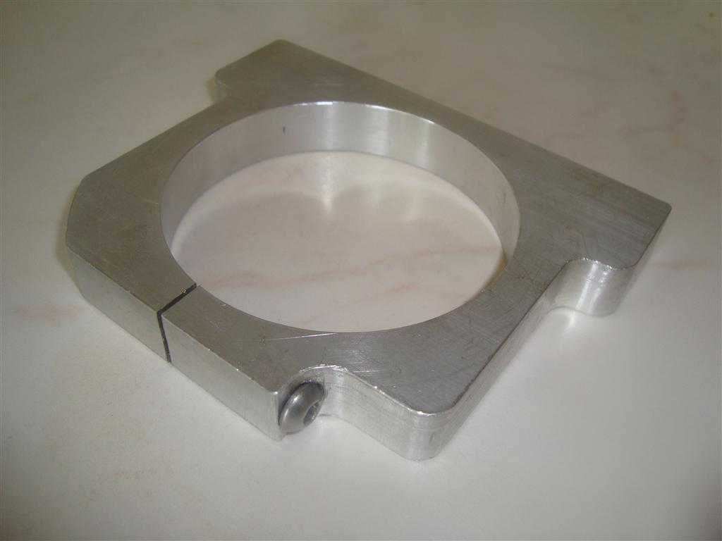

2 Attachment(s)

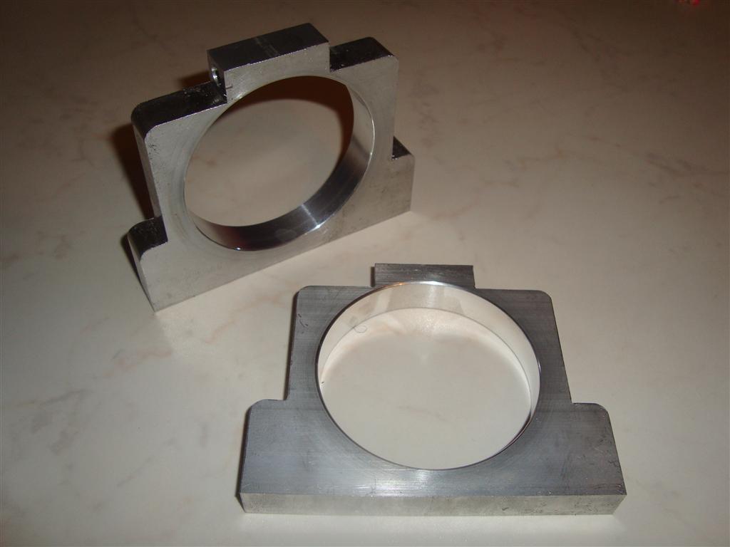

Possibly a bit late now, but just in case anyone reads this and is interested in one here's the 'latest version' without the aforementioned weaker point:
Attachment 4352
One with the clamping bolt at the side:
Attachment 4353
Nice bit of work Jonathan.
I like the second design with the clamp at the side, nice and tidy.
Ian
Nice design, but I don't think you were going to have any problems with the originals apart from the sharrp corners. These are tidy though.
Peter.
I agree entirely, but most people immediately point out the sharp corner and start complaining - I though it would be best to rectify it.
Web Goblin
Thanks...I wasn't so sure about the clamp at the side as the clamping pressure is probably less even, and if the spindle is a little too big it won't open up much. Still it's marginally quicker to cut so no problem there!

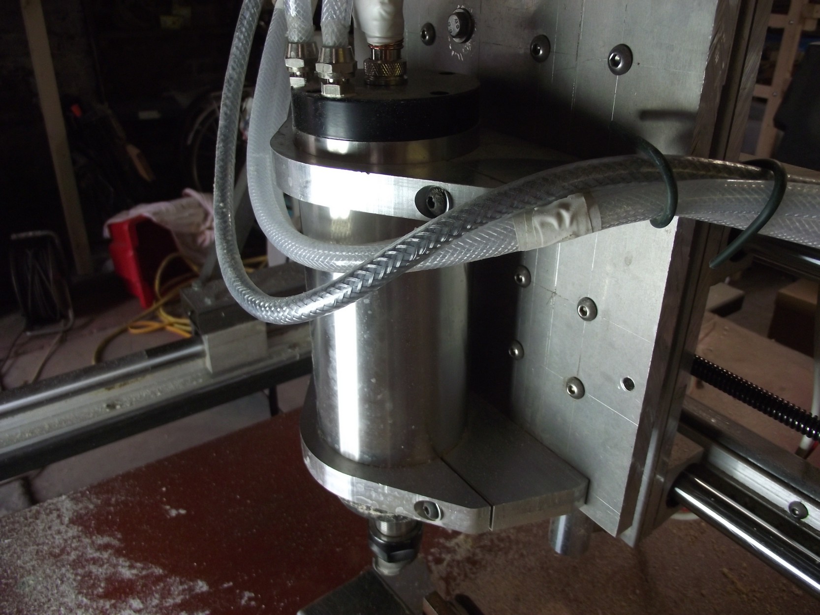

Sorry to hijack, but as it goes, I'm presently knocking up spindle mount in CAD for my spindle which has a 43mm throat (or collar?)
What diameter should I make the spindle holding hole in the mount - bang on 43mm ....or is it standard to say add a 0.5mm, 1mm to the diameter etc?
Also if adding a little bit to the diameter (to aid getting the actualy spindle into the mount), what 'gap' do you then allow to pinch the bolt onto the spindle?
I'd personally go for bang on, that way you get more even, and better clamping force. The more undersize/oversize you go, the more the collar has to deform to clamp, resulting in a less uniform clamping force on the spindle.
As for the slot, if you get it bang on, then a hacksaw blade cut should be more than enough, and if needed wedge the slot open a bit with a plain screwdriver until you get the spindle in.

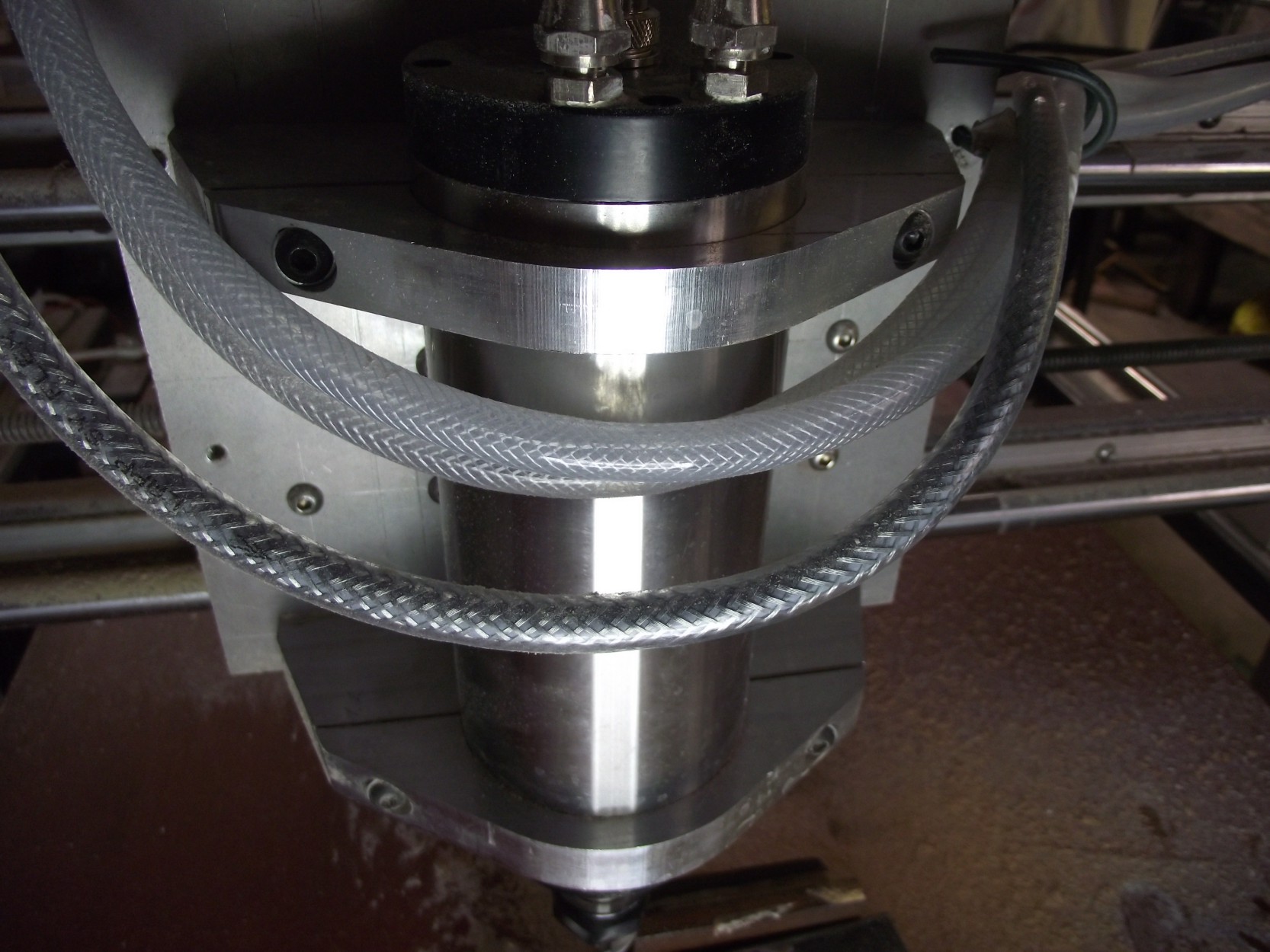

3 Attachment(s)
Oh also, here's some pictures of yet another one:
Attachment 4741
Attachment 4742
Attachment 4743
It's 188mm wide if I recall correctly.
