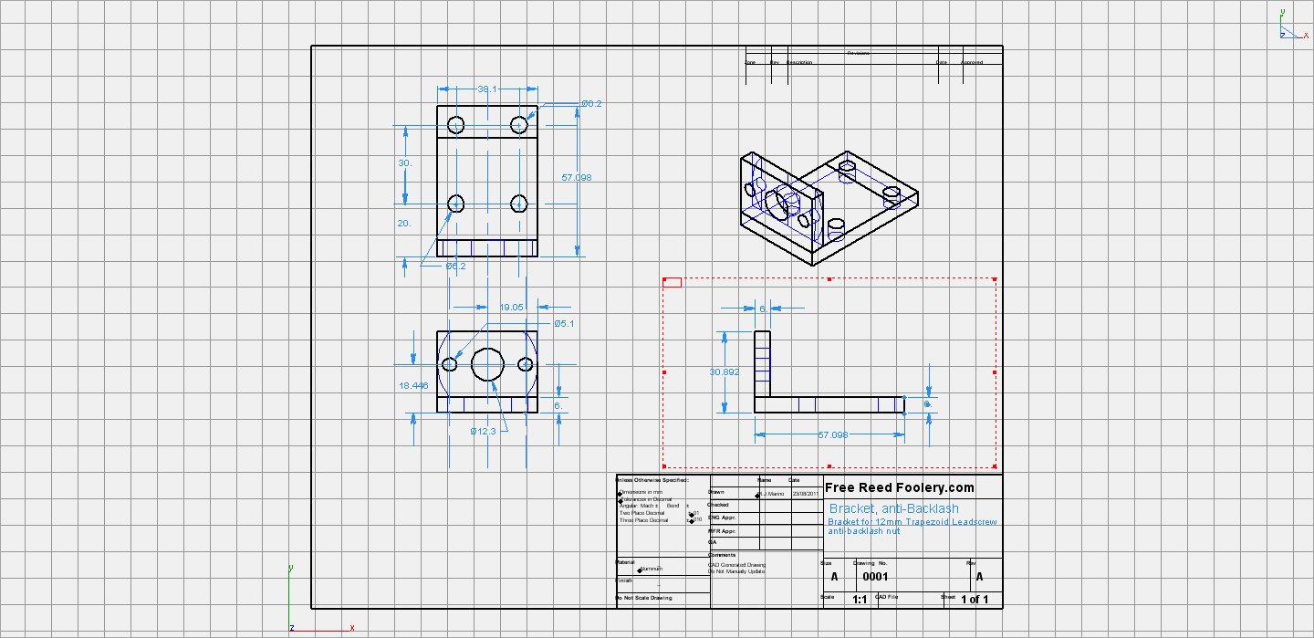

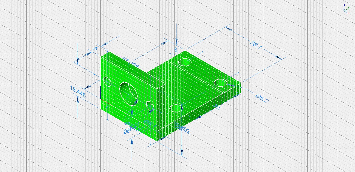

2 Attachment(s)
Re: 1st Build, Second machine
Okay,
Let's see if I can get these files up properly.
Attachment 4375Attachment 4374
Sorry that they are jpeg's as it would not let me load the .dwg or .iges file format. That is the bracket I designed to go with a dumpsterCNC anti backlash nut for a 12mm trapezoid leadscrew. Clearance is only 40mm in height. Any opinions???
Also Checking on available box Aluminium in the area but is looking like I have a really good source of off cuts (some over 2 metres) of 12mm Aluminium plate. Any and all views would be greatly appreciated.
Michael
How are you joining the two pieces together? That joint needs to be strong so that an axial force on the screw does not bend the bracket. I'd be inclined to either make it out of one piece, or use something thicker for the vertical part.
Looks fine. If you can't find a bit suitable angle, it could be roughed from a bit solid alu with minimal effort.
Or if you could survive with steel, I might even have a bit suitable angle lying around (I think I came across some 2 or 3" angle during a search for something else the other week!).

The idea was for it to be of a single piece of either angle or mill from block. That should insure the rigidity of the piece. As far as the Aluminium is concerned drop me a line folks and will try to arrange something. I need to be going down there any how to see if they have any square tube stock that could be drilled and bolt together for the new frame.

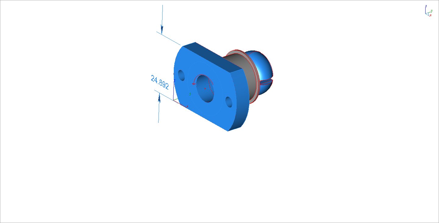

2 Attachment(s)
What took so long and what is taking time. Is a drawing I am working on to improve my skill working with the new program. I really like ViaCAD 2D/3Dv8 for CAD work over the program I was using. To give you an idea of what I was doing here is a Jpeg of the Nut.Attachment 4382
So that is one of the projects I am working on. Also designing replacement combs for Bends Chromatic harmonicas (48's,56's,64's)as the business closed their doors down in Brazil (but have not sold off their stock so who knows). Hohner Meisterclasse acrylic comb and once the new mill is built acrylic mouth pieces for the Hohner and Suzuki Bass harmonicas. As well as slowly plugging along at reverse engineering the Hohner harmonetta (which I am now considered and OEM parts provider for that instrument by Hohner). That and other odd bits and pieces. Then milling them. Oh, yeah and jigs to make for more accurate set up.

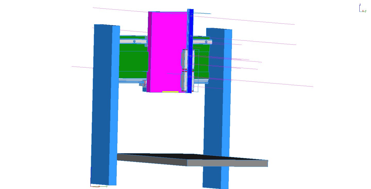

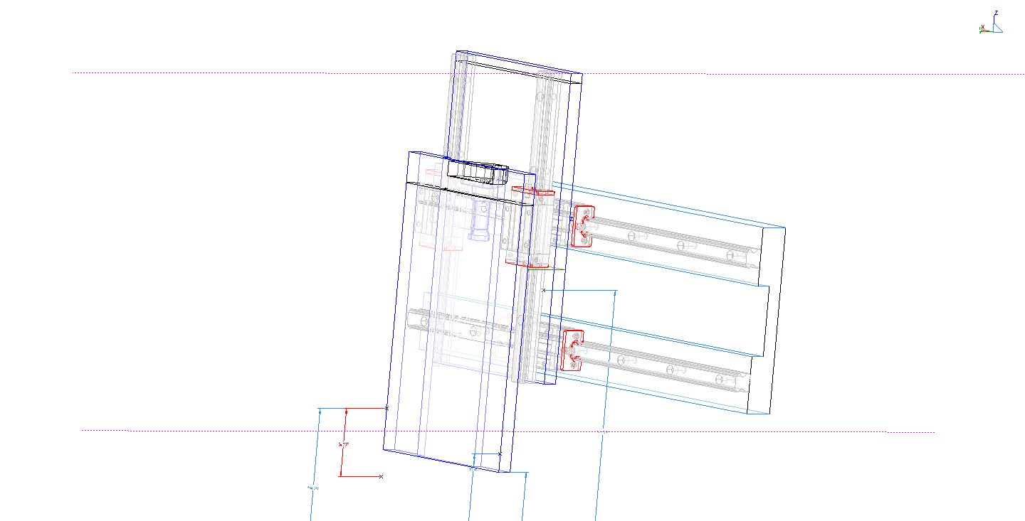

Okay with the advice given and working in ViaCAD to get things set up would like folks opinion of the following set up for a Y Z axis set up.
Attachment 4390
The dimension marks are left over from getting the height right from the table surface and still having space for the 4th axis.
So please folks opinions. This is not complete. The Y is a little to long (was learning how to download files from Hiwin, great set up they have) and the screws on the Z and the Y are yet set in, nor is the anti back lash nut for Y (it will be between the two rails).
There are 4 carriages holding the Z axis to the Y even though you only see 2.
opinions please.
Michael
Put the rails on the front plate and the bearings on the back plate. This way the rails help stiffen the front plate.
The carriages then go low on the backplate and it makes for a very stiff z axis with max support where it's needed.! close as possible to the cutting end.!
Edit: Also if you pocket the bearings into the back plate slightly you regain some of the lost stand off from gantry. Also you can use one of the pocket edges as a datum ref point for alignment of the bearings. If you also do the same with the rails into the rear of the front plate, (but not quit as deep) this as the same affect and also another datum ref edge.
The net affect of both brings the stand off from the Y axis down slightly and also creates accurate ref edges to work from which are essential for setting up profiled linear rails correctly.
Hope this makes sense.! If not just ask and i'll try to explain better.
JAZZCNC
If the rails are contributing significantly to the stiffness of the material you are using for the Z-axis then that material should be made thicker/stronger. Still definitely put the rails on the front plate, but primarily for the second reason - the supporting carriages are closer to the bed.
Okay will do rework with those ideas in place and try to add the rest of the pieces in place as well so that it makes sense. I have to say that i really like working with ViaCAD 2D/3Dv8 (yes I am an unpaid broken record but it is soooo easy to get things right where you want them and surfacing is extremely easy. Will make the changes and see what other gems and insight you will be willing to teach me.
Michael

Okay,
Here is tha much promised and hard to get around to drawing of v2. You will notice that it is not complete. I am still working away at it but would like some input. Will let you know any other problems might be having in the near future. Due to problems (flex of Y axis and Z axis dropping up to 1.5mm from a set position) this rebuild has to be done like yesterday and been working on it the last three days non-stop. This is what has made far enough to be label a version and put before you folks for opinion and evaluation.Attachment 4546
Any and all opinions would be greatly appreciated as will be burningthe candle in to the long hours. Need this done to get product back up to stocking levels for a convention at the end of October. Yes thing s do go wrong at just the wrong time. Yes I know I need to increase the rail for Z to get 150mm.
Anyone wanting a DWG, STP, IGES file of this or the completed gantry router let me know.
Michael
id think about putting both Y axis rails top and bottom or you are going to lose valuable space...
the way you have them now will have your spindle over hanging further than it needs to buy quite a long way
try to keep your spindle as far back as possible... every little bit will help, it may not alter the flex by much but im pretty sure that each little fraction of stiffness you save will reduce sympathetic resonance or vibration by a sh*t load
good luck:smile:
